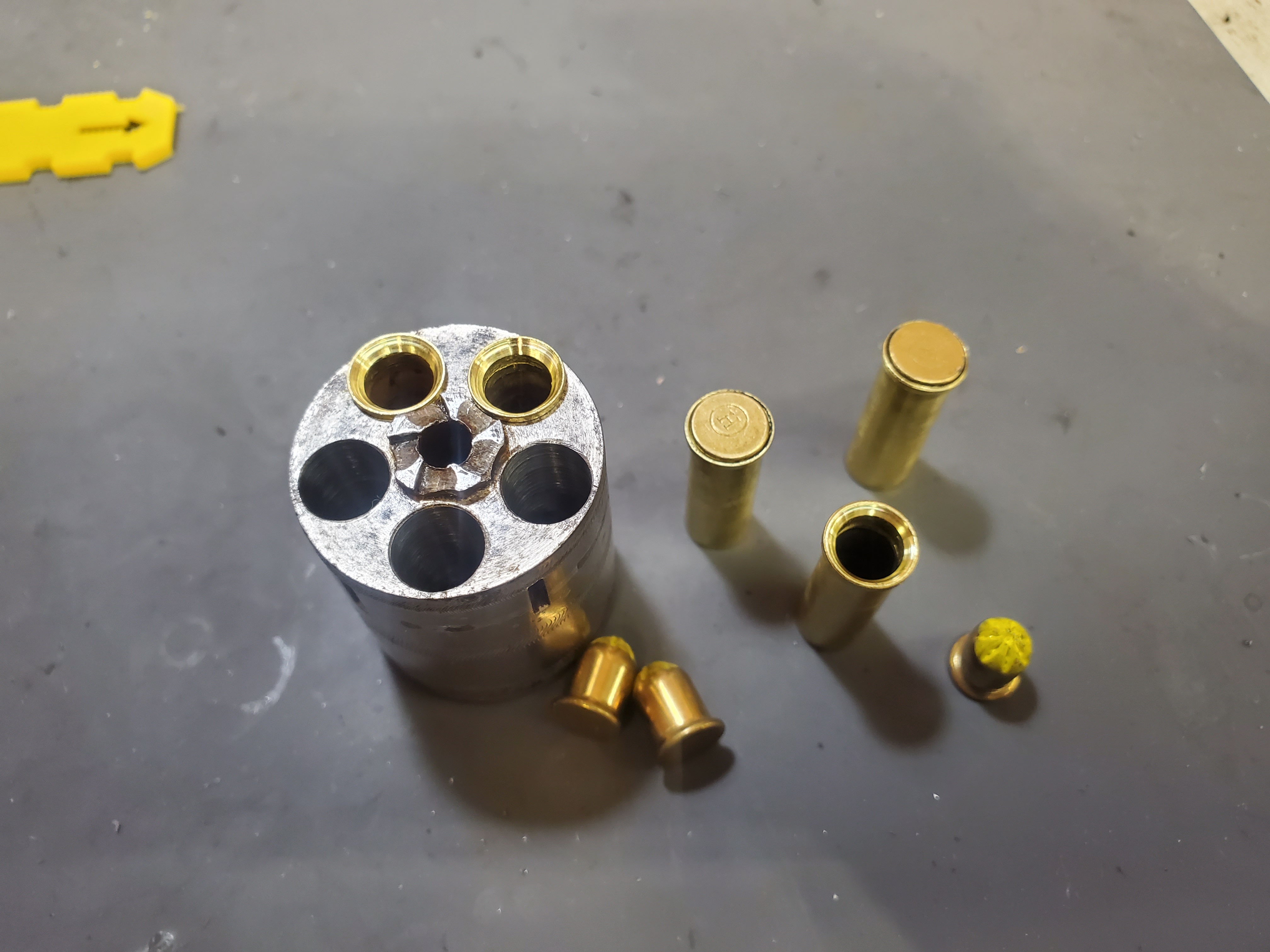

I picked this up from a neighbor for a steal. I've been looking for one for a while because it fits my niche of weird and obscure and I've been wanting to convert ammo for one for a while. It's a 32 rimfire that i can't remember the weird brand of and I'm too lazy to get out of my recliner after doing yard work ๐Ÿ˜.
It locks up solid and the timing is good. The closest brass I have on hand is 32 Long but the diameter is about .013 too big so I made a sizing die that works stupid good (I wasn't expecting good results.) People use 32 Colt brass but it's hard to come by and I use what I have.
The first one I made I offset drilled and reamed the back of the case for a 22 ramset and it worked fine, but you had to index the cartridge in the cylinder. By chance I was at Lowes yesterday for the honeydoo list and walked by the isle with the ramsets. They have 27 caliber ๐Ÿค”. I grabbed a pack and they work fantastic. You can keep them centered and the rim is capable of being hit by the hammer.
I probably should have grabbed the #3 ramsets and not the #4 because these things are hot. You can tell by the noise alone. Thankfully I've been using .310 roundballs for testing when it's supposed to use .316 heeled bullets. It probably would have blown up otherwise but it's good enough to mess around with.

Thank you both. It's not something that I'll be firing alot so I figure the 5 cases is plenty for now. Plus, they're incredibly easy to reload since they don't even require a powder charge in them. I thought about getting a proper bullet mould for it, but it's not really necessary. I just hate to have a gun and no ammo fo it.

I've done something similar with a single round that I lathe turned because a customer wanted to fire his old Crackshot just 1 time. That one I ended up using a little .22 caliber acorn blank with a small powder charge and it worked good so I'm sure I could convert your brass to either the 22 or 27 ramsets.

I'd be using pure lead, or whatever the hell it is I have that I bought in bulk from ebay. It sounds like I'll have to experiment. That'll be easy enough by just drilling and reaming a hole then filling it with lead and measuring the slug.

Does the rimfire firing pin mess up the case when you shoot it, or does it just hit the ramset?
Re: Another 32 revolver but with a twist.
Posted: Thu Apr 24, 2025 6:42 pm
It just hits the ramset. It protrudes just enough to take all the brunt of the hammer. The cases are completely reusable.
