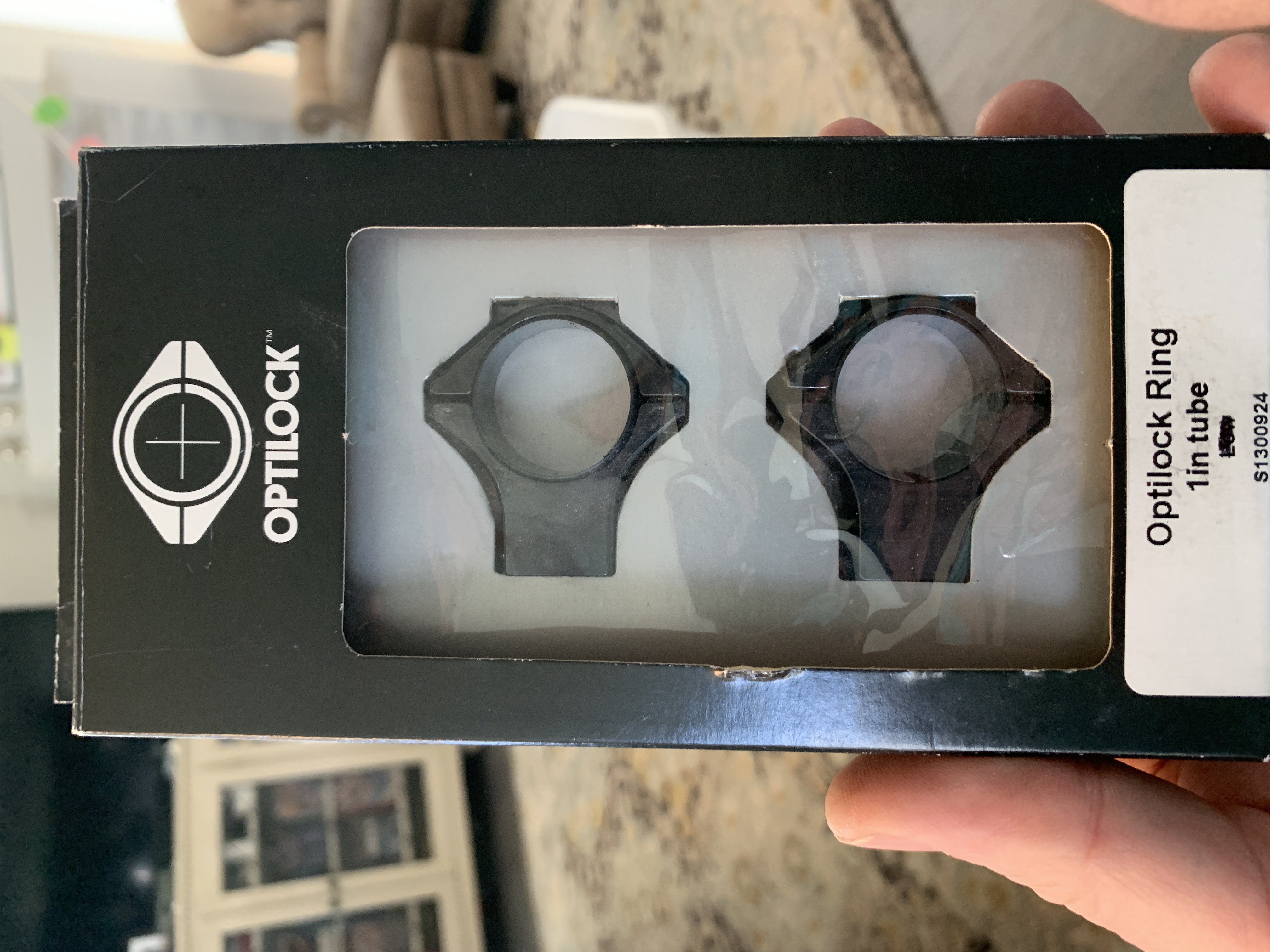

These were on a 7mm I had some years ago. If you can use them, they are yours. thought I had the bases as well but can't find them.
No idea if they are any lighter than th QD you had but thought I'd offer.

Are those bases and rings or just rings? And how high are they? I think I need a medium height as I have a Zeiss 3x15x42. If those will work for me, I'd gladly take them. If you want the EAW 1" quick release mounts you can have them, I understand they're pretty expensive but I have no use for them.

Went back and edited the post, no bases but they are available on amazon I see. Rough measurement is 0.610 without taking the centering insert out.
