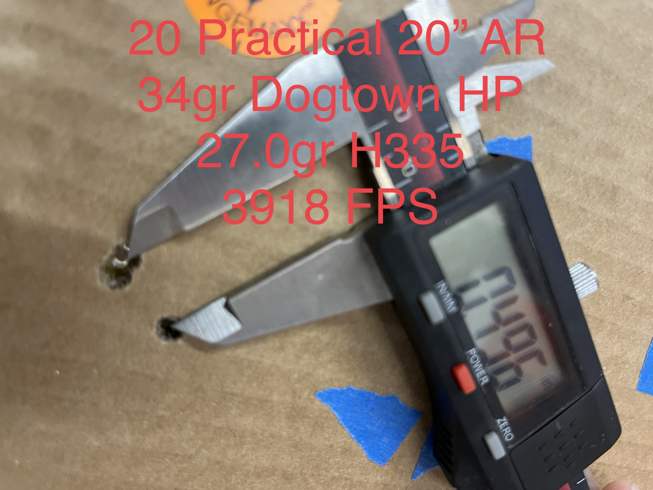

by Jay
I keep a note pad for load work. I measure new brass to the datum point and measure after firing so I know where the shoulder went and how much I want to bump it back on the next load. I also measure seating depth to the ogive. Once I’ve found a load that I want to stay with, I use my own load data tags in my ammo boxes that contain all the info I need to recreate that load.
I’ve also went digital on load work. I used to cut out the groups on my target, measure them and save them in a binder with their data. My phone does that for me now.
- C2A8C9A2-45EE-4B86-8D27-398112D323C1.jpeg (659.05 KiB) Viewed 1963 times
