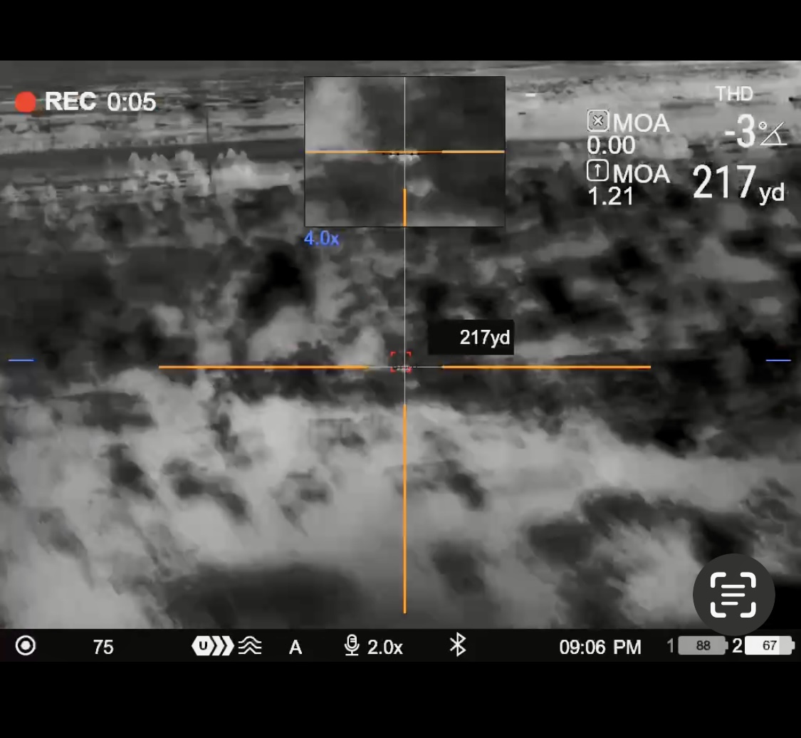

Screen grab the moment the shot broke. Coyote. 217 yards. 75gr Vmax just over 3200 fps. With the ballistic info in the scope, it was recommending 1.21 MOA hold up. So, call it 2.5”.
