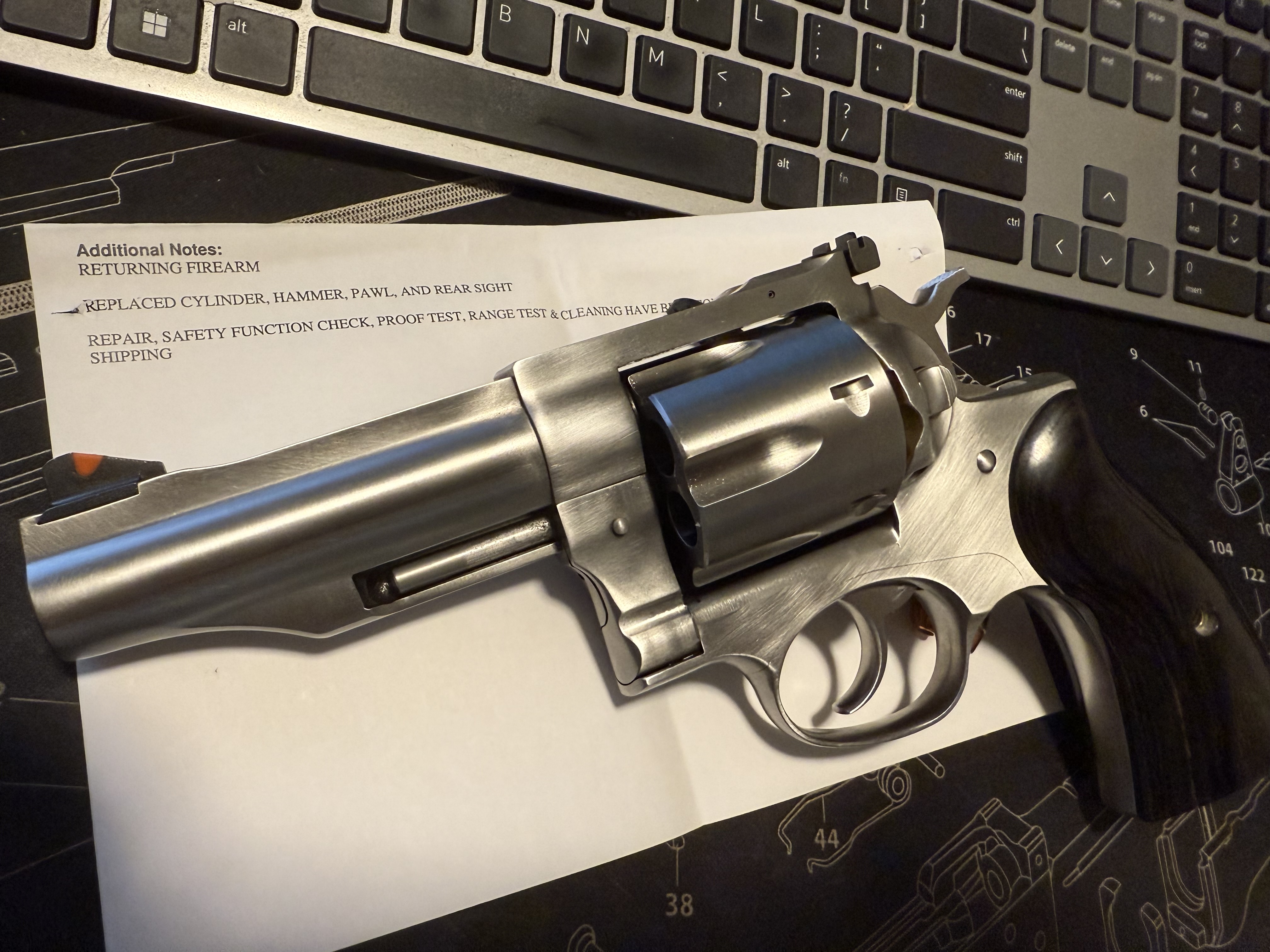

The Redhawk made its way home yesterday. Ruger replaced the Hammer, cylinder, pawl and for some reason- the rear sight.
I have to say that this thing has a SWEET (for a ruger) trigger now. Very smooth DA with just a slight bump before the break where you can stage the trigger. I’ll try and get to the tangs next week and test it

What exactly was wrong with your gun that they had to replace the cylinder? How do you even destroy a cylinder beyond repair? I think I would want to know what happened. Did they repair it under warranty?

jwv2023 wrote: ↑Fri Aug 29, 2025 7:47 pm What exactly was wrong with your gun that they had to replace the cylinder? How do you even destroy a cylinder beyond repair? I think I would want to know what happened. Did they repair it under warranty?
I was wondering also.
Hammer, pawl and cylinder...sounds like a timing issue?
I’m guessing the locking slots were out of spec.
The Redhawk was ‘locking up’ randomly. The trigger would freeze and you could not make anything move until you wiggled the cylinder
