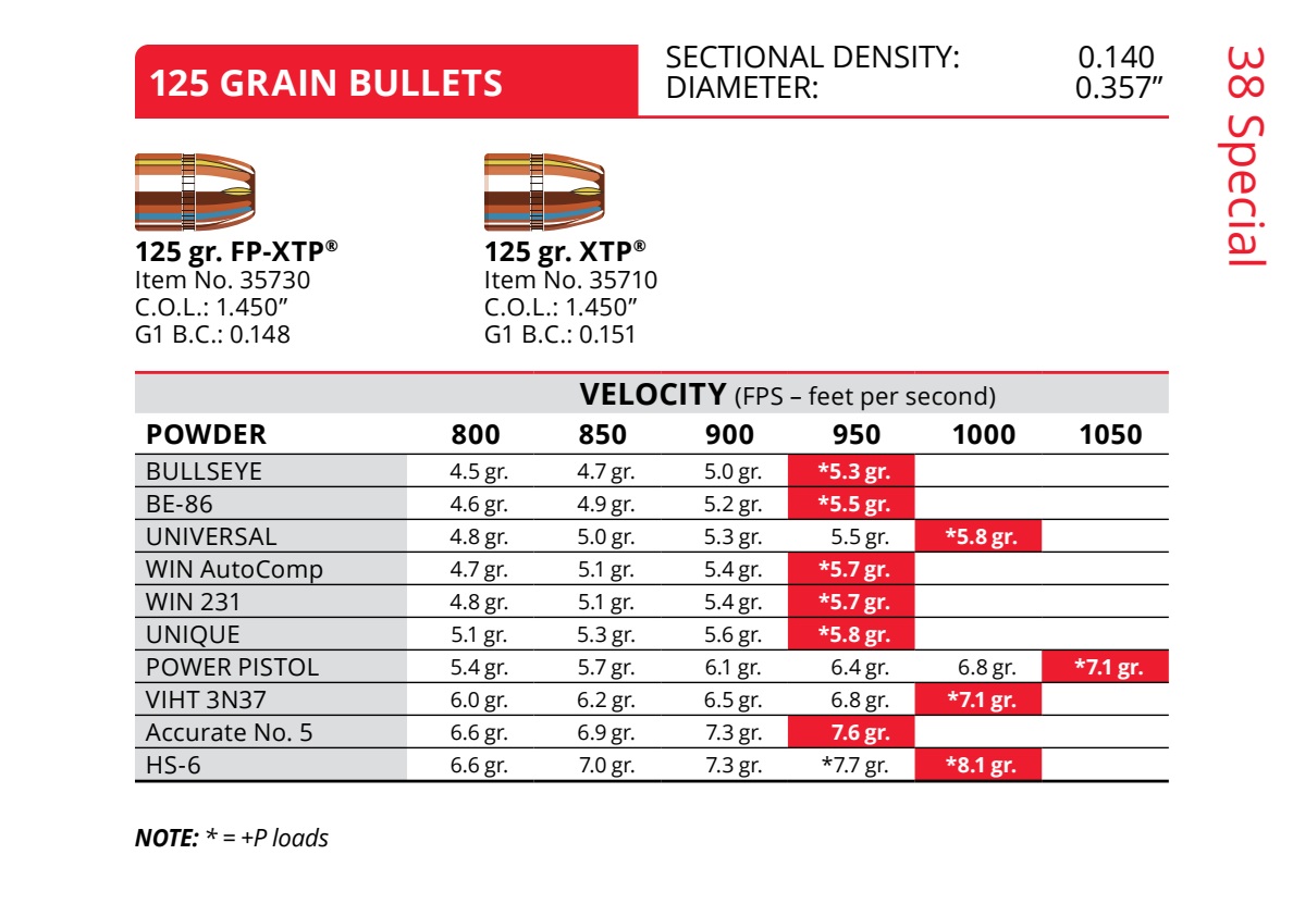

You should be able to get by using 125gr data for standard pressure 38spcl

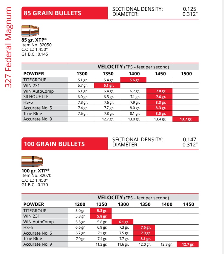

CPJ 2.0 wrote: ↑Mon Aug 25, 2025 12:19 amIMG_4600.jpeg
That is for a MEI cast lead bullet. Having a heck of a time coming up with something for a jacketed bullet

Re: Reloading manual question
I haven't torn the plastic wrap off my Lyman 51st edition yet, but the 50th has three jacketed and three cast options for the .327, and four jacketed and seven cast for the .38. No 130gr jacketed data for the .38, but it does have 125 - not hard to adjust from that.
Here's the 327 data Hornady lists
