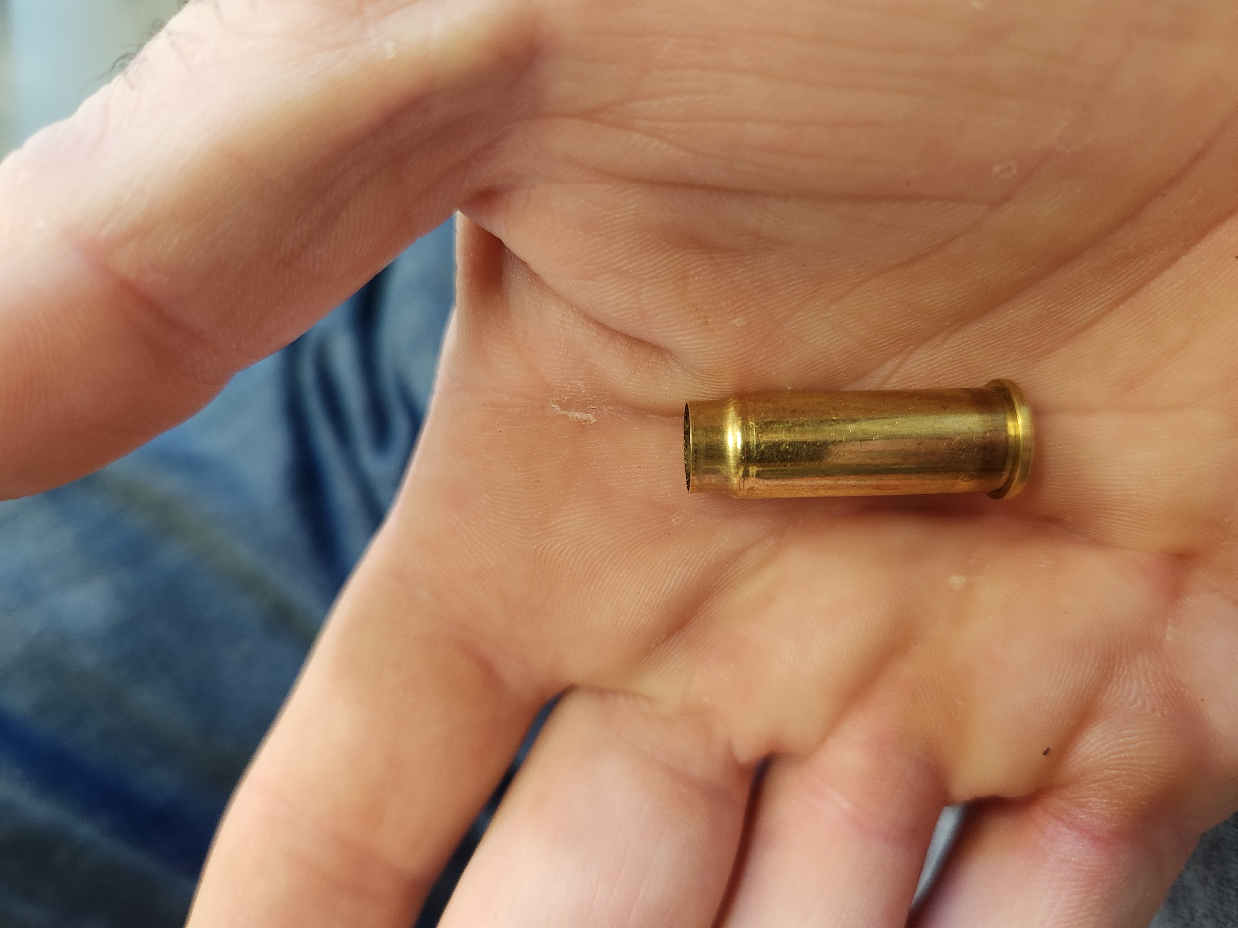

I'm sure you all know by now that I like weird and obscure things. I also like to mess around and throw random crap together and experiment. I've been aware of the 32 NAA for a while. It's just a 380 necked down to 32 caliber that's supposed to have a velocity of about 1200fps with a 70grain? bullet from a pretty short barrel. You can't find dies anymore so I thought I'd try and make one. I have a few pistols in 380 that I don't carry so I figure one would be a good test bed and think I'll use my Bersa Thunder Plus. I also have a plethora of 380 brass. I actually have quite a bit of brass in general from years of test fire ammo that I've kept.
I also considered that I could make 380 brass from my 350 Legend brass and really amp it up since it'll deal with higher pressures 🤔. It took me quite a few tries making dies to finally get one that doesn't collapse the neck only to figure out how damn easy it was for a functional die after overthinking it 🙄. But I turned out with a pretty good end product. Hopefully I'll be able to post up some velocities after I make a barrel or insert for the Bersa.

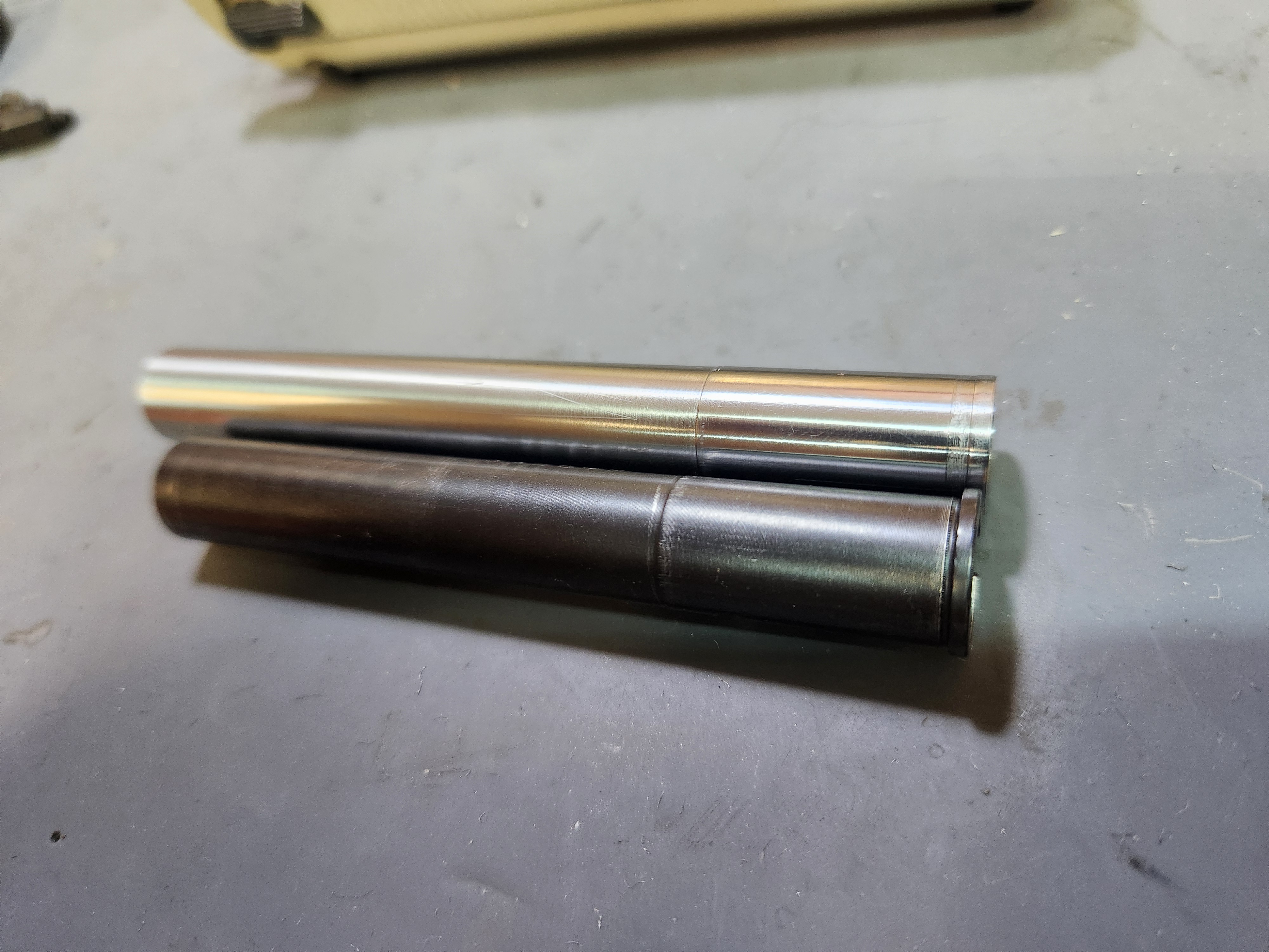

Posted: Mon Sep 22, 2025 9:07 pm
Well I got the barrel finished, except for chambering it. Guess I'll rent a reamer tonight. I made it a bit longer so I can thread it, because, why not? It's for my Bersa Thunder Plus. It doesn't have as much shoulder diameter as the original because of the blank I was able to find but a shoulder is a shoulder and shouldn't mess with the function. I can't remember the name of the place but I got an 18" blank that was chambered for 327 Federal and it's way nicer than it should be for 30 something dollars.
