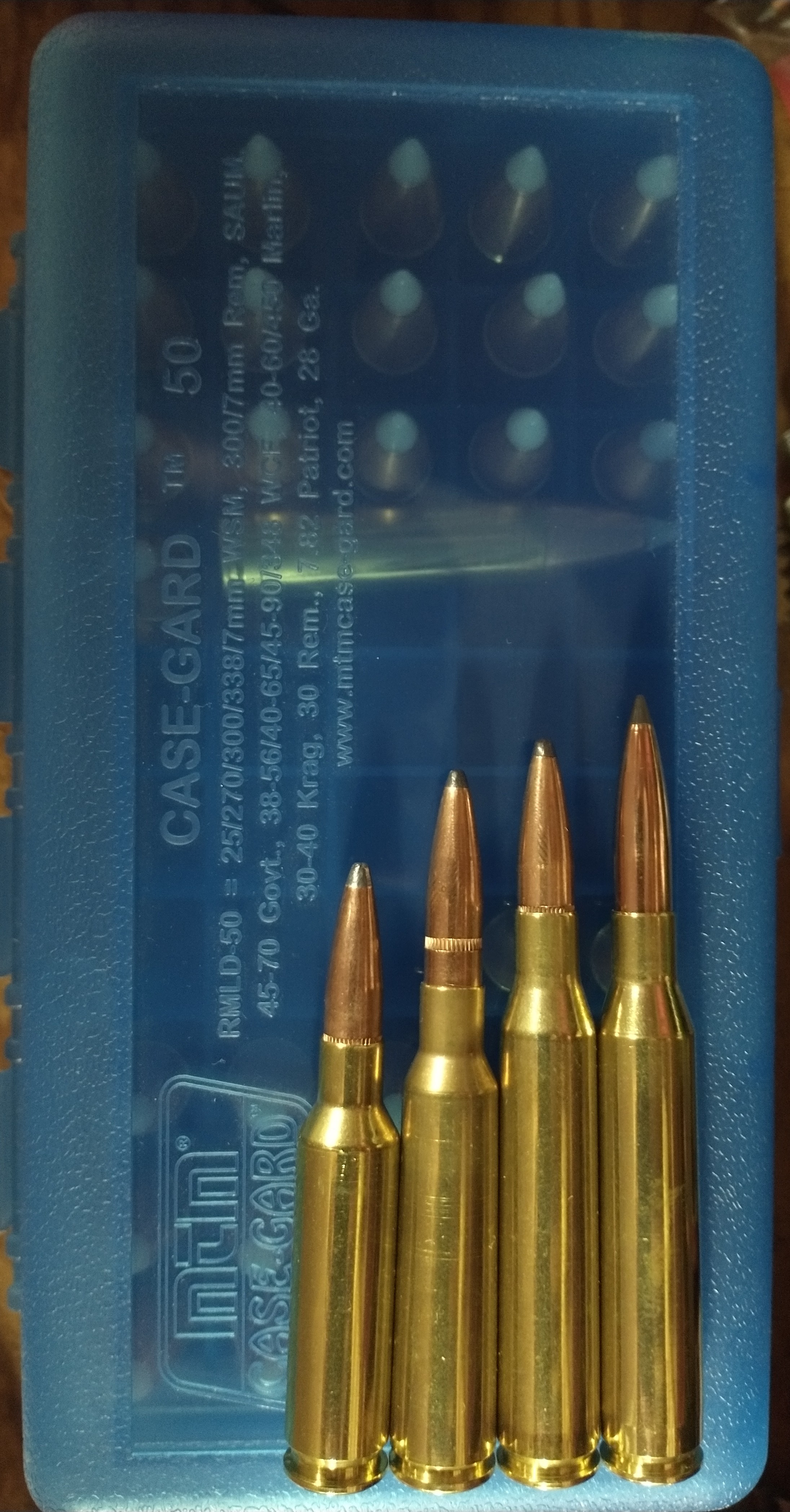

6.5CM 129gr IL 2.690"
6.5x55 129gr IL 3.115"
6.5-06 139gr IL 3.255"
6.5-06 150gr ABLR 3.455"

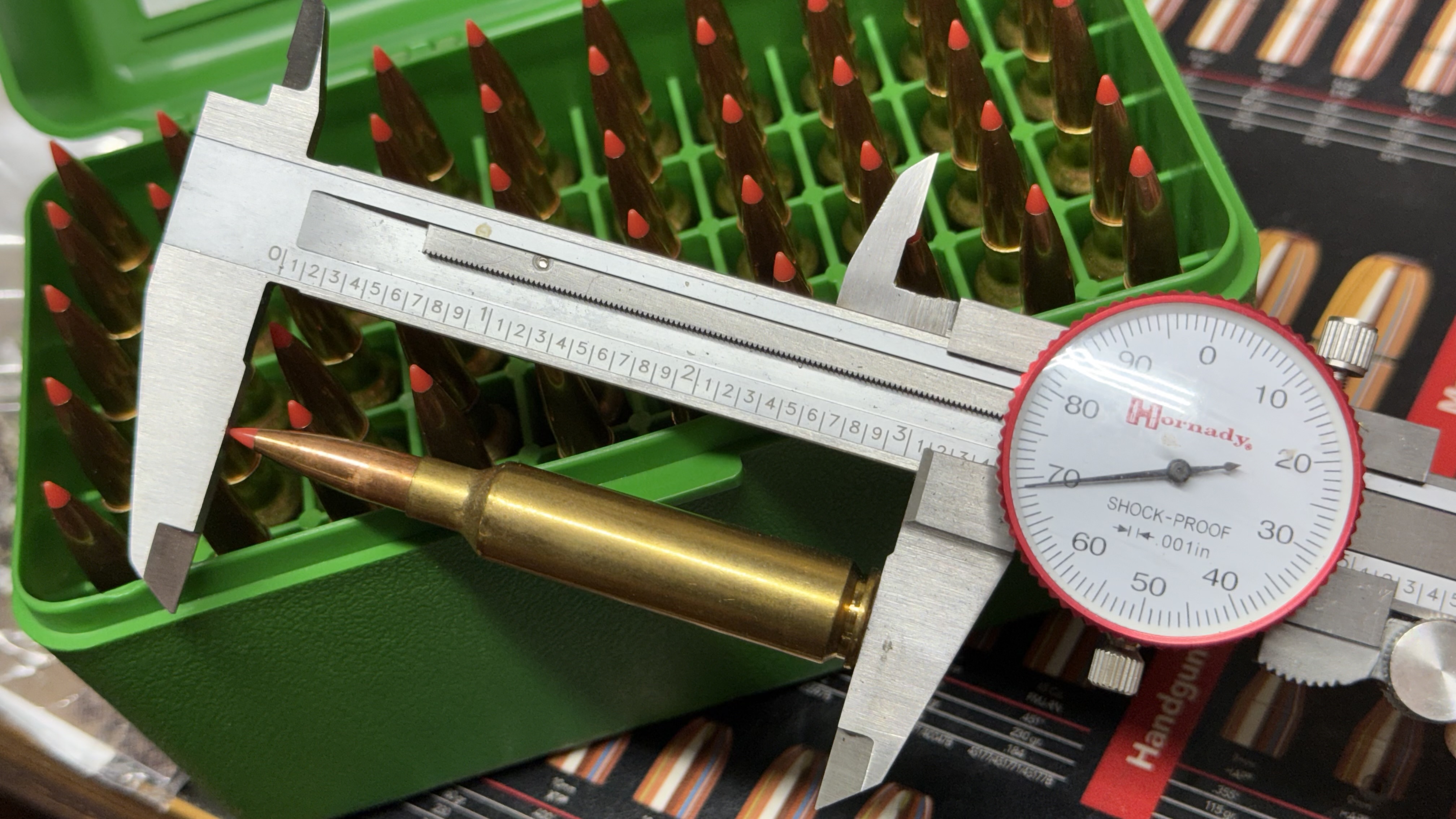

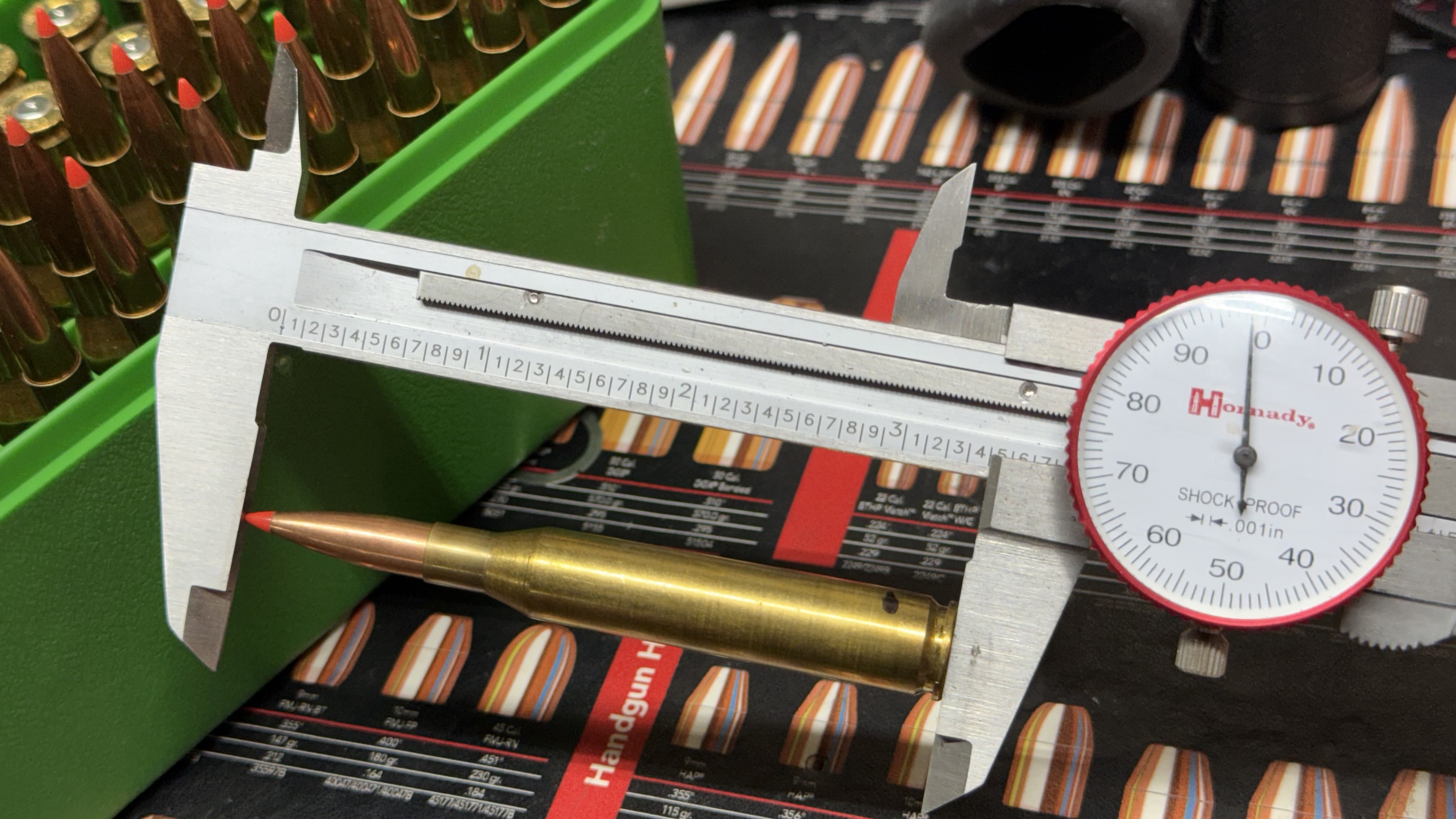

6.5-06 and 6.5-284 Win
Both with 140gr A-Max seated long.

Posted: Thu Sep 18, 2025 3:14 am
Zee wrote: ↑Thu Sep 18, 2025 1:16 am IMG_7712.jpegIMG_7713.jpeg
Interesting, so they would both fit. The -06 is a little less than .10 inch too long seated that far out but I don’t think that would affect case capacity too much if I pushed the bullet in a little bit.
Do you like one over the other?
Thanks for the measurements.
