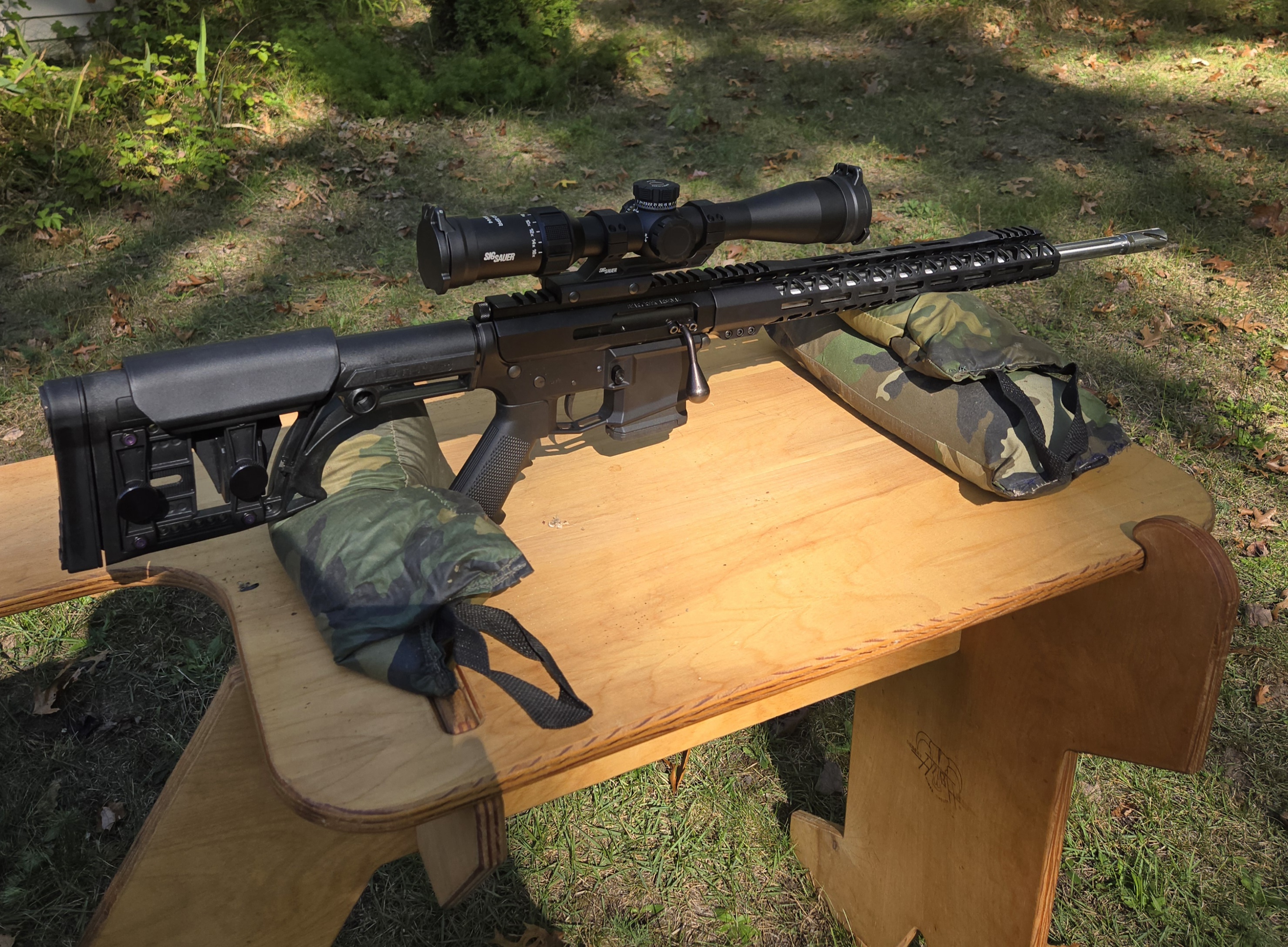

Here's what I came up with for that bolt action AR upper
.223 Wylde
20" 1/8 Twist, Fluted medium taper...10 lbs...SIG SPR 4-16x44 mm with 30mm tube...Rise Armament 3.5 lb trigger...Luth PR stock

I have debated a bolt action upper for a while. Bolt handle being so far forward would be odd though.

mitdr774 wrote: ↑Mon Sep 29, 2025 7:22 pm I have debated a bolt action upper for a while. Bolt handle being so far forward would be odd though.
I was thinking about the same thing but when I got it Shouldered the bolt handle was right where it was supposed to be...

I just ordered some 62grain OTMs and some 77 grain OTMs....I'm really hoping it likes the heavier stuff

1:8, should run 75 Hornadys, 77 (Sierra/Nosler) 80.5 Bergers, 80 Sierras, 80.5 Bergers.... might not run 90s, but in my experience the 62s will shoot well at least at short range

Based on what I can find online, 1:8 may or may not be good with something like the 90gr SMK. The Hornady 70gr CX calls for a minimum of 1:7 though. Then again the CX line tends to be some fairly long for caliber/weight bullets.

Having a brain fart but there were hornadys that were coming apart before they made 300 yards out of service rifles. The vast majority are wylde which are in the 1:8-7-7.5 range. They would vaporize on the way there. Cannot for the life of me remember which ones they were or if Hornady got it fixed. Might want to search on them before you buy bulk.
