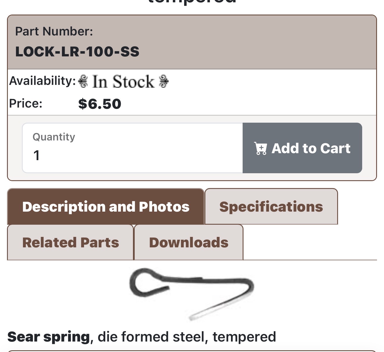

Re: Any experience making a spring?
https://www.trackofthewolf.com/parts/de ... -lr-100-ss
“Brand of Manufacturer
L&R Lock Company
Choose Right or Left Hand Lock
Right Hand Gun
L&R Replacement for Factory Lock Assembly with Parts
CVA & Traditions Kentucky -”
That’s for a reproduction of the CVA lock so it may or may not be the exact same, but it’s worth a few bucks to try it.
Any hardenable steel can be can be made a spring with the proper temper.

Posts: 1048
No, Track of the Wolf sent me the 'U" spring. They don't have the 'V'" . I have tried every source including one in Australia, no luck. Wolff Springs doesn't have them. The shotgun springs don't have the side retainer tab. I went to a local BP shop yesterday, this was the first lock he couldn't fix.

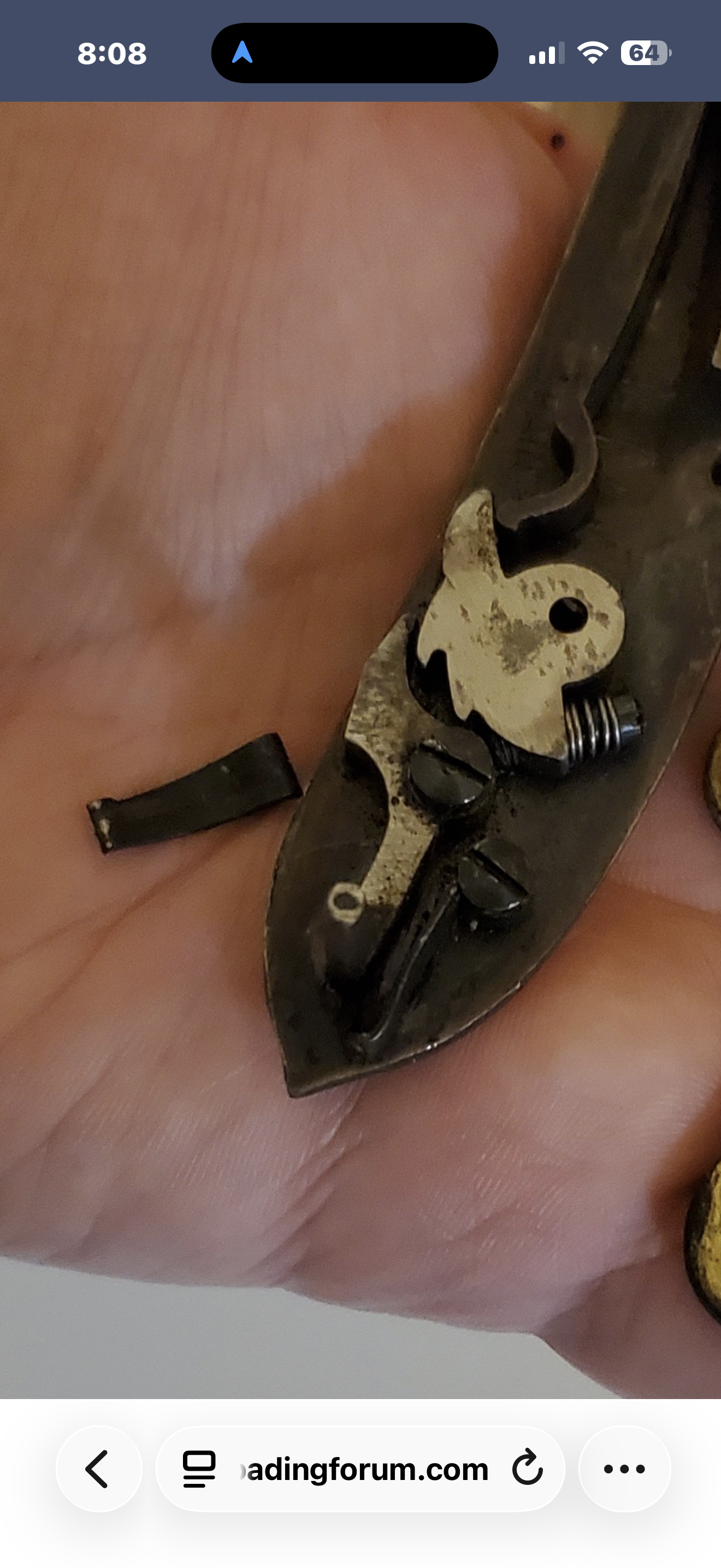

Have a pic of the spring?
Posts: 1048
Thank you! I thought I could get another spring and mistakenly threw the old one away. There are plenty of pictures and I'm sure since the metal will be soft I can use a file and dremel to form what I need. I just don't know what steel to start with. The entire spring will be less than 2.5 inches long and less than 1/4 wide.

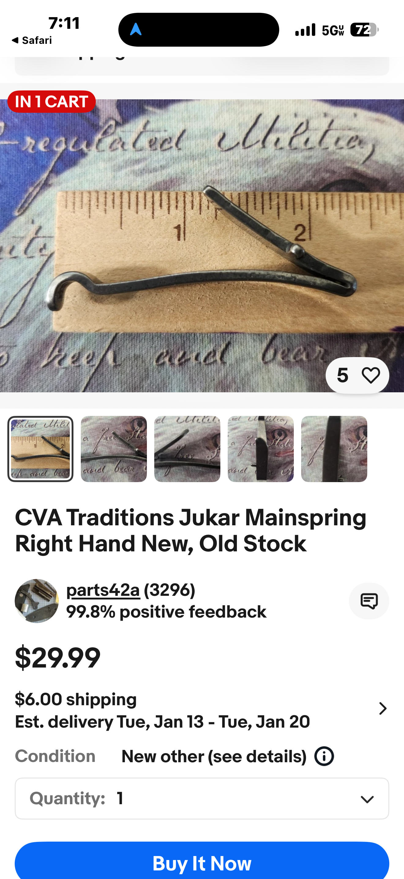

Posts: 1849
That spring you pictured is for the sear return spring, not the main spring. Traditional flint/percussion locks have 2 springs the main a long V spring with a tab at the end and usually a pin out the side near the bend. The other is the one you posted, it just puts pressure on he sear to keep it engaged.
Posts: 4221
Is this or?
Posts: 1849
Yep! That’s what you want! If that craps out gone these guys a call.

Posts: 1849
Does the lock internal look like it matches up? The hook should go around the tumbler, the other end will rest against a stop of some kind

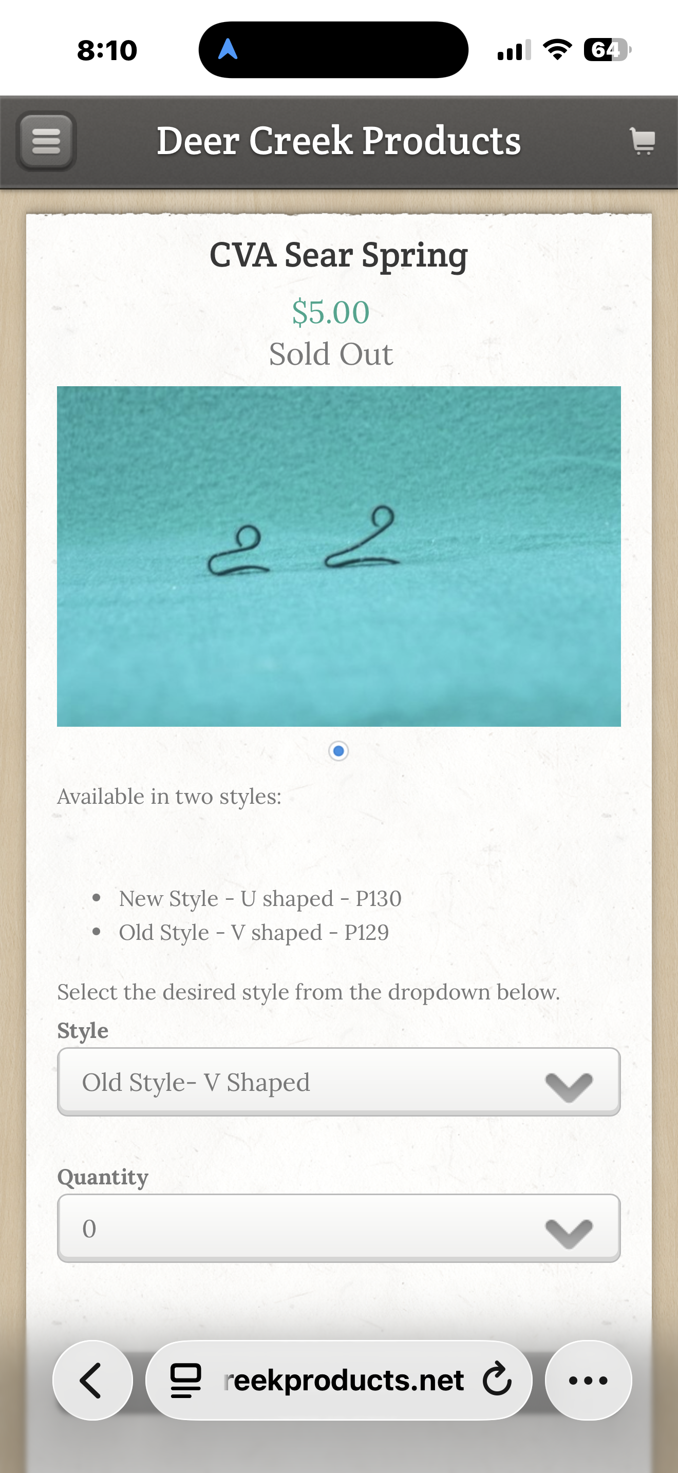

Posts: 1048
CJP, what you show is the main spring, I need the sear spring. I spoke with Sussie at Log Cabin, a sweet ol girl. She is the person that told me not to mess with the "U shaped spring, it's too short. I'll try to post pics of the "U" spring and "V" spring
Posts: 1048
Freezer wrote: ↑Fri Jan 09, 2026 1:52 am CJP, what you show is the main spring, I need the sear spring. I spoke with Sussie at Log Cabin, a sweet ol girl. She is the person that told me not to mess with the "U shaped spring, it's too short. I'll try to post pics of the "U" spring and "V" spring
[/quote
https://www.deercreekproducts.net/store ... pring.html

Posts: 4221
Ok. I’m guessing here’s the ones your after, and the V is not available.

Posts: 1048
CPJ 2.0 wrote: ↑Fri Jan 09, 2026 12:33 am https://www.trackofthewolf.com/parts/de ... -lr-100-ss
L&R Lock Company
Right Hand Gun
I bought this spring, it cost me $15. This is the spring that I thought would work and threw the broken spring away, This is a spring for their replacement lock, not the original CVA. New lock $270.
Posts: 1849
It’s going to work. It may take a bit of work but you’ll be up and running in no time.
