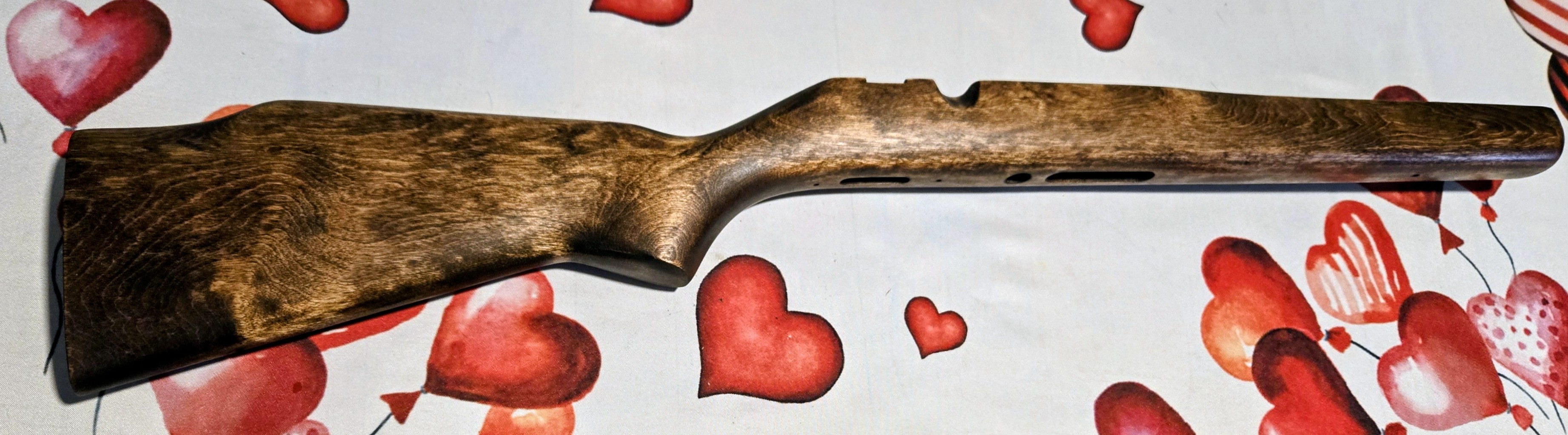

I've tried a few times but they always turn out blotchy. I usually give up and paint them black. I tried stripper, scand paper and liquor thinner. The reason is as is I have a Marlin 25, my friend Tom's, with interesting grain and it just isn't turning out the way I'd like. I stripped it sanded it, soaked it in hot water, sanded it, used stain control and it's still blotchy. Same result as some NEF's and other "Hard Wood" stocks. What kind of wood are they using. Is there any way to soften the density differences in the wood or effects of previous finishes?

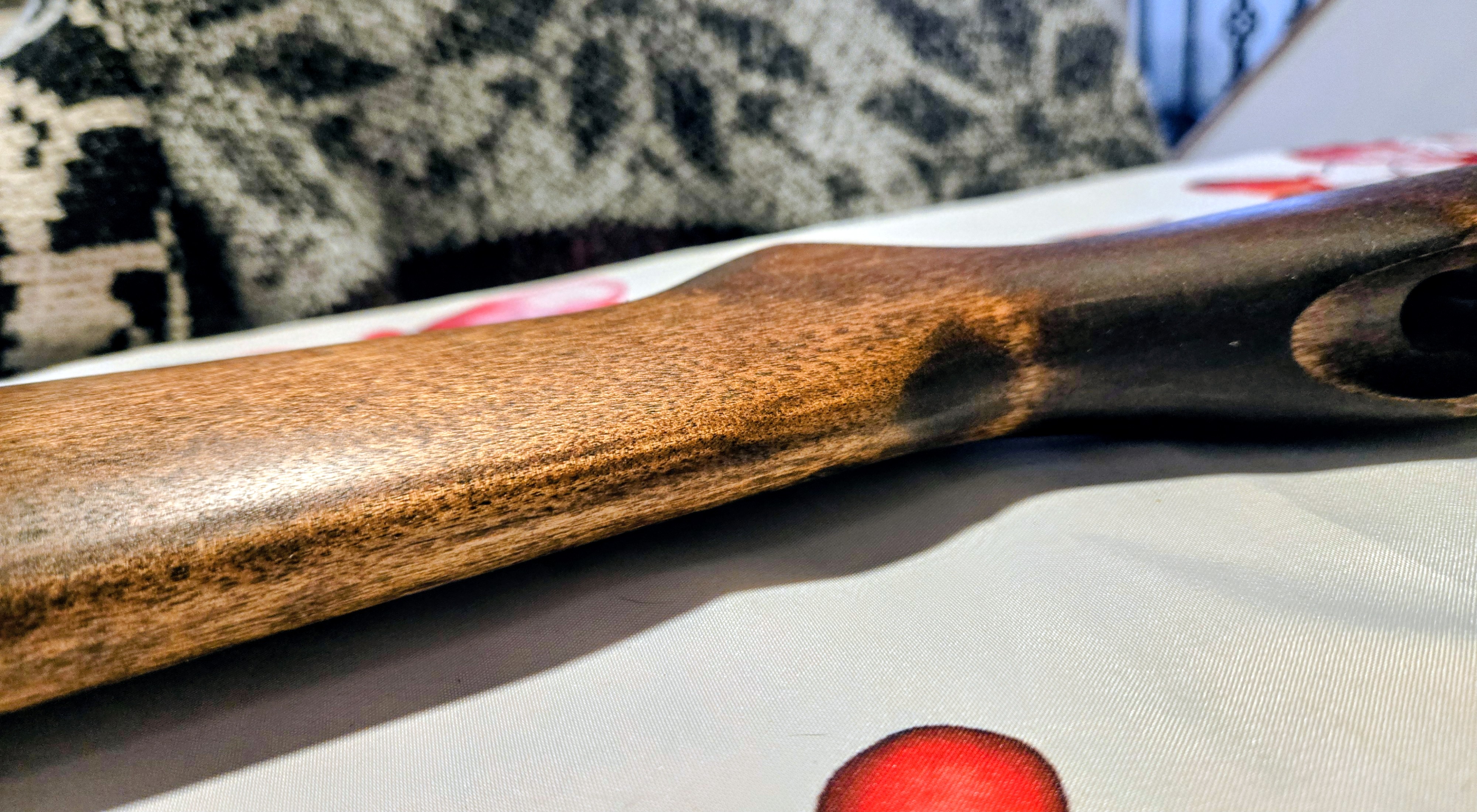

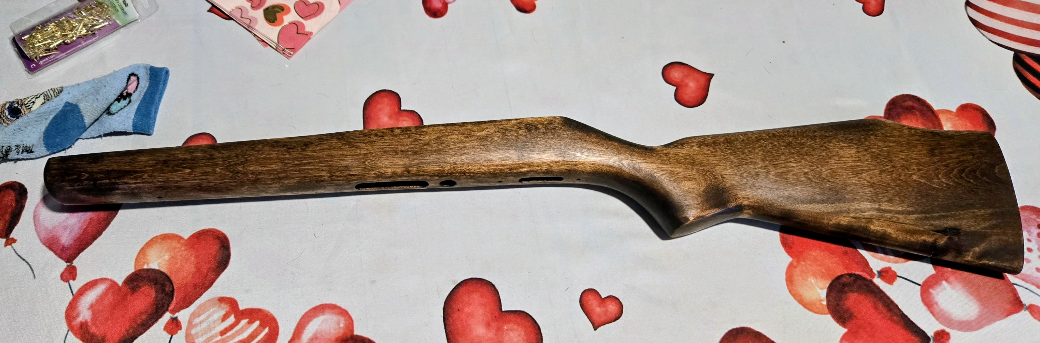

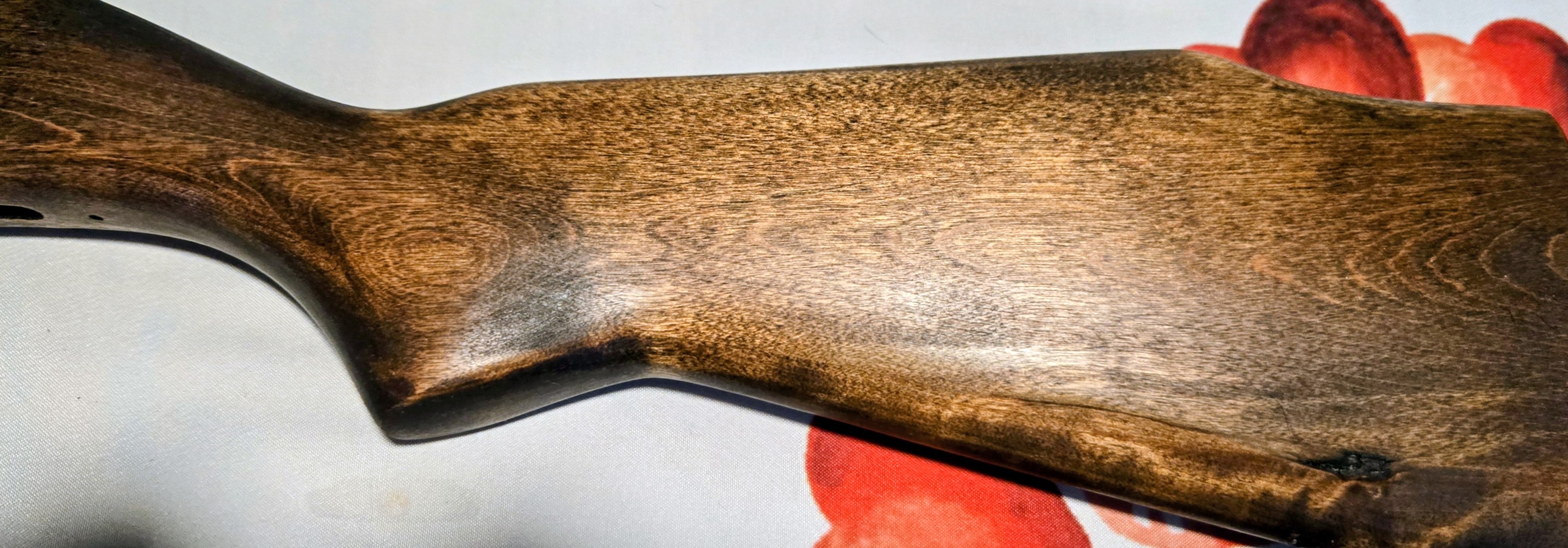

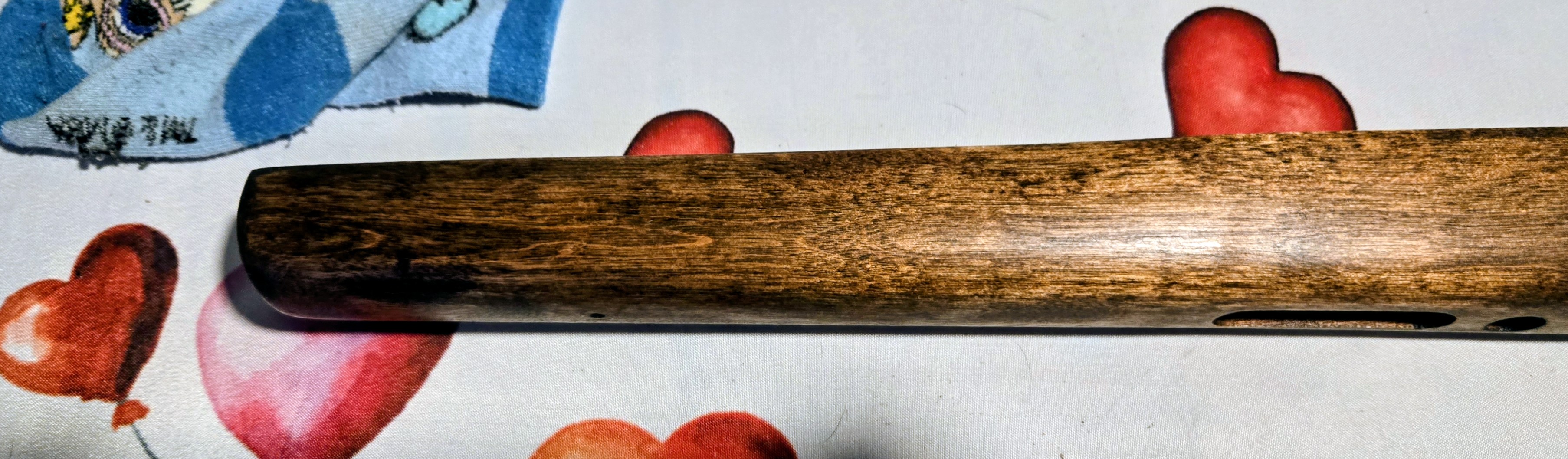

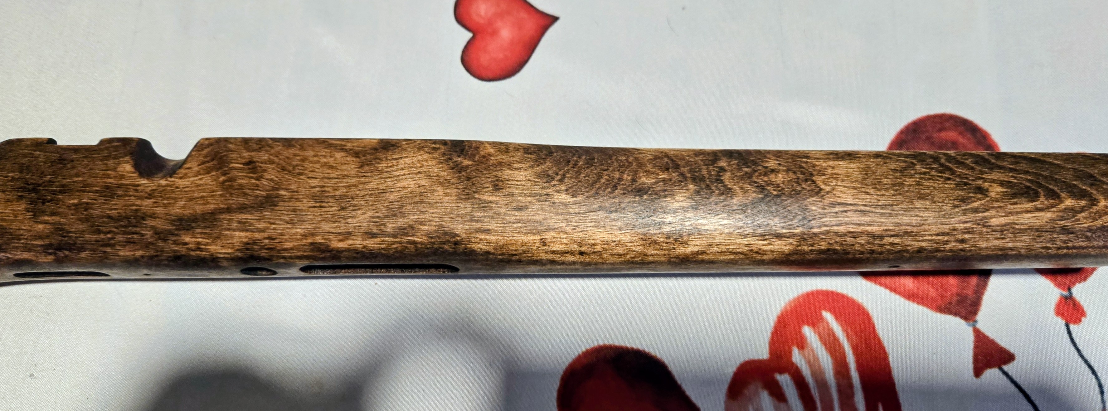

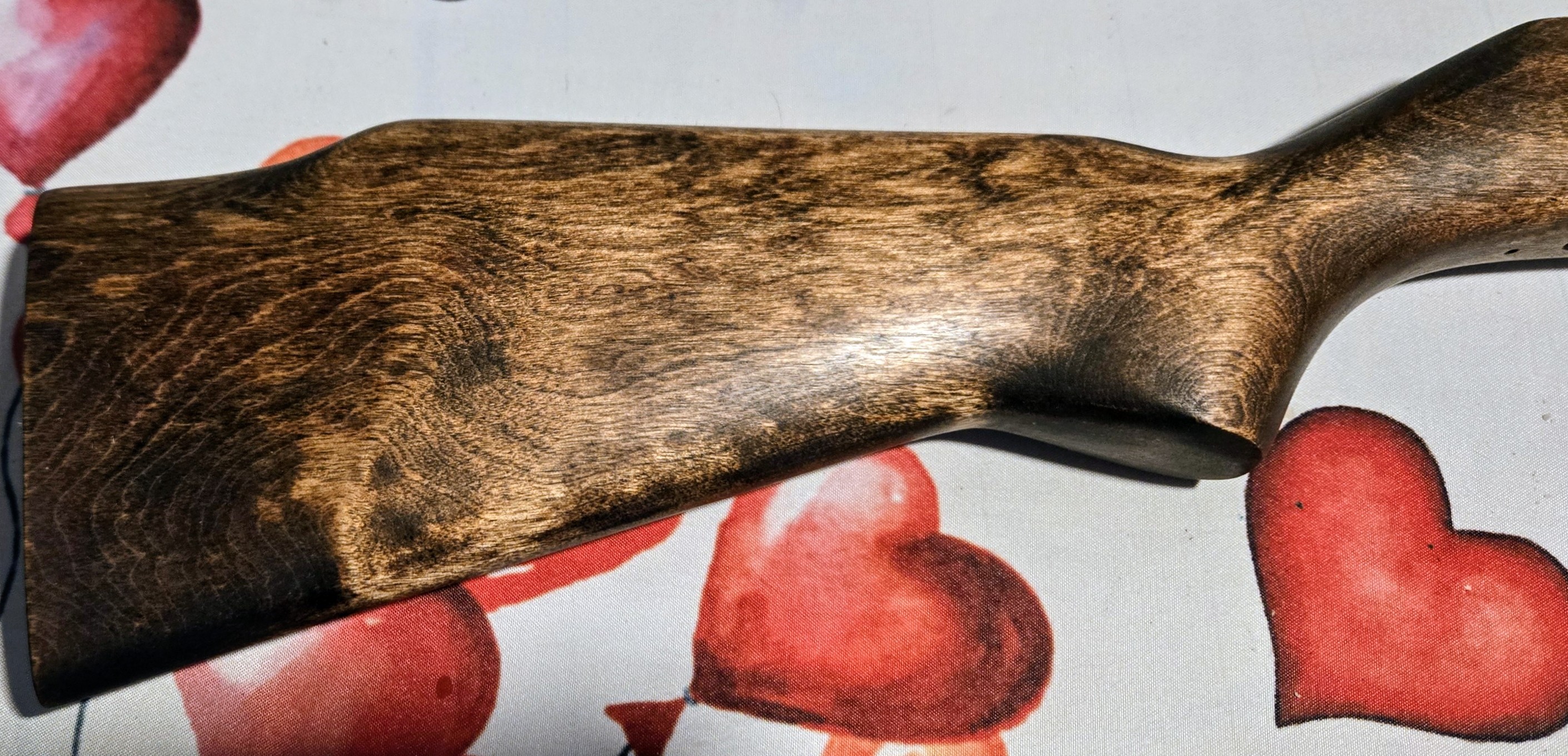

Ok, Tom really likes the finish. It's his gun not mine! I would have painted it black. I'll put 10 -20 coats of oil on it and call it good. If he's happy who am I to say different. After extensive prep and conditioner I applied Minwax "Gunstock" stain, it turned the wood red! I immediately applied "Dark Walnut" and it looked better. After a day I applied another coat of Dark Walnut and waited another day before adding the first coat of boiled linseed oil. It does have a nice red hew but...not my style or typical work. Not my gun! I appreciate the feedback I'm a tinkerer not an expert.
