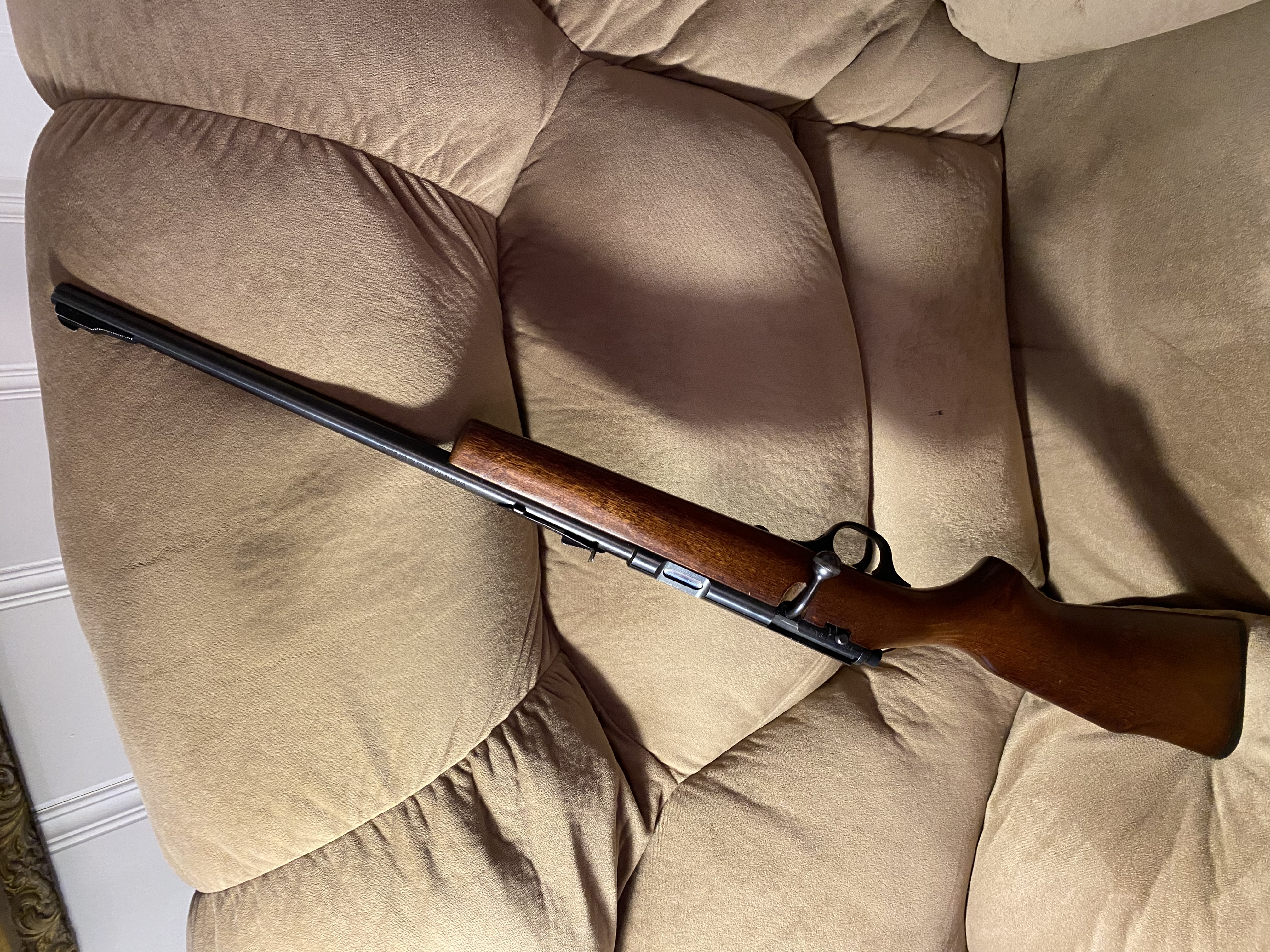

Didn’t intend on buying a gun yesterday but I did.
Saw a youth model .22 rifle on the rack at my LGS. It’s Marlin Model 15Y single shot youth model. It’s in good condition considering it’s at least 23yo. It’s heavier than a Cricket but not overly so. I didn’t know this model existed until yesterday. It’s for one of the grandkids.

Function tested the Marlin today. It won’t eject the empty cases. Gotta research how to remove the bolt and give it a good cleaning. Trigger is VERY heavy.

Posted: Wed Feb 25, 2026 11:30 pm
Pay special attention to the chamber. If they are cruddy it can cause extraction issues.

Posted: Thu Feb 26, 2026 2:08 am
Nice looking rifle

I suspect it needs a good cleaning and oiling. I think it was made in 1988. Production years were 1988-2003. Since it’s a youth model it’s probably been in someone’s safe for quite a few years.
I’ll search the YouTubes for a video and piddle with it this weekend if I get a chance. Grandkids range from 3 1/2 to 3 mos. They won’t be shooting for awhile yet.

GrapeApe wrote: ↑Thu Feb 26, 2026 2:08 am Nice looking rifle
I was surprised at the condition. Hasn’t been used much at all

If I remember correctly bring bolt back, press trigger and pull the bolt out while holding the trigger Agree, check the chamber for crud. I would actually take the whole thing apart and go over the whole thing with a brush and Hoppes. .22s are simple machines but they get pretty gunked up over time for sure.
