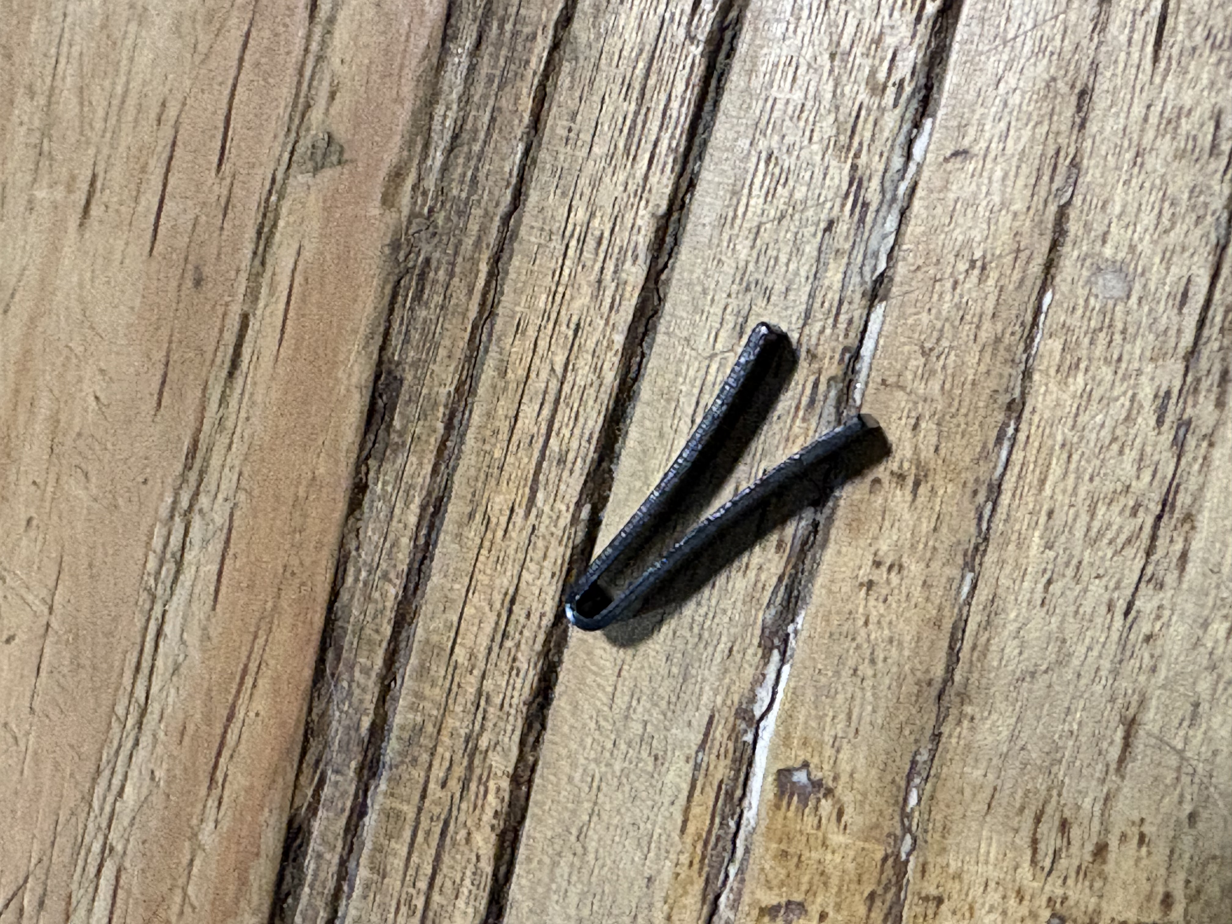

The part that started it all

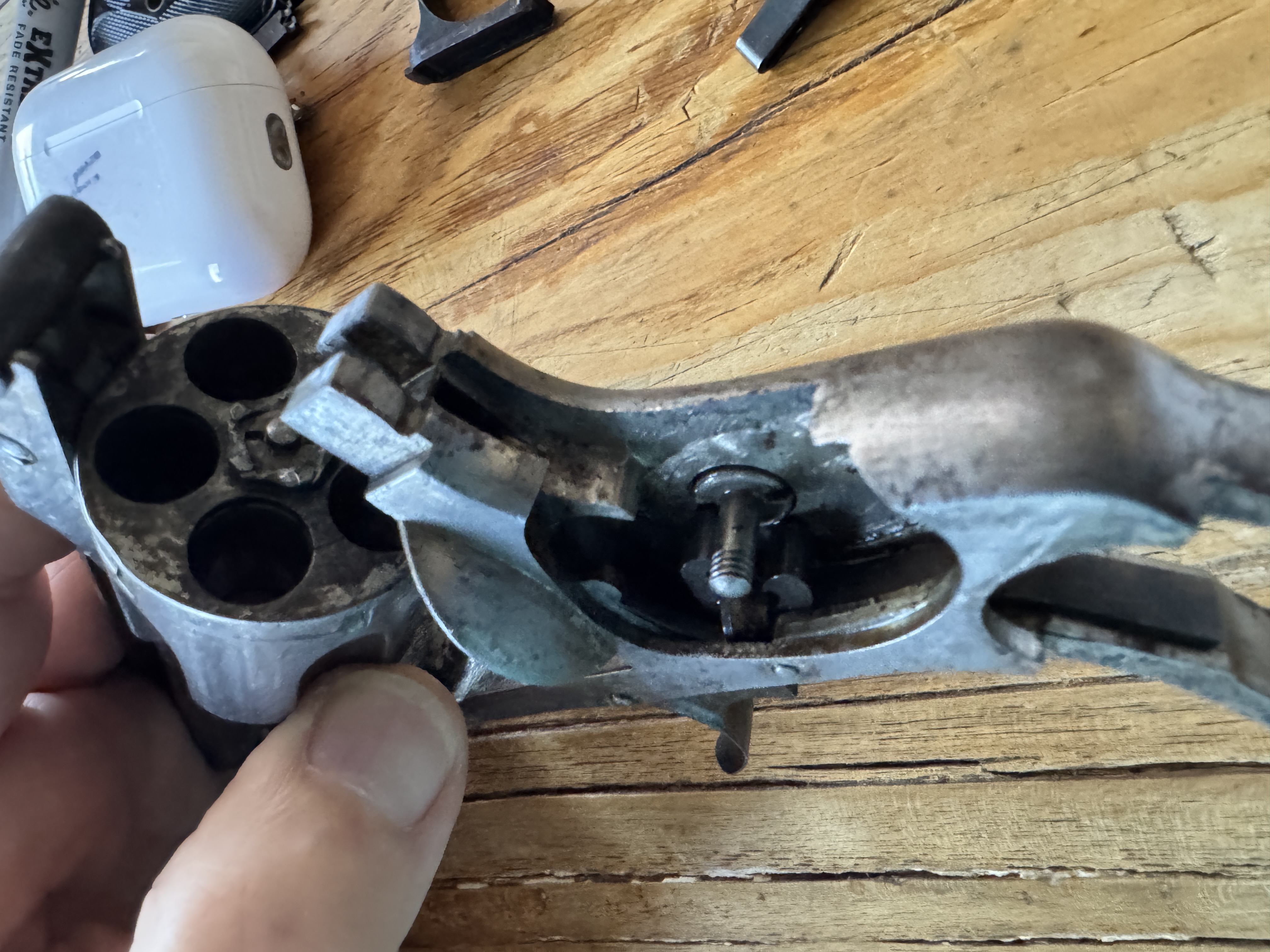

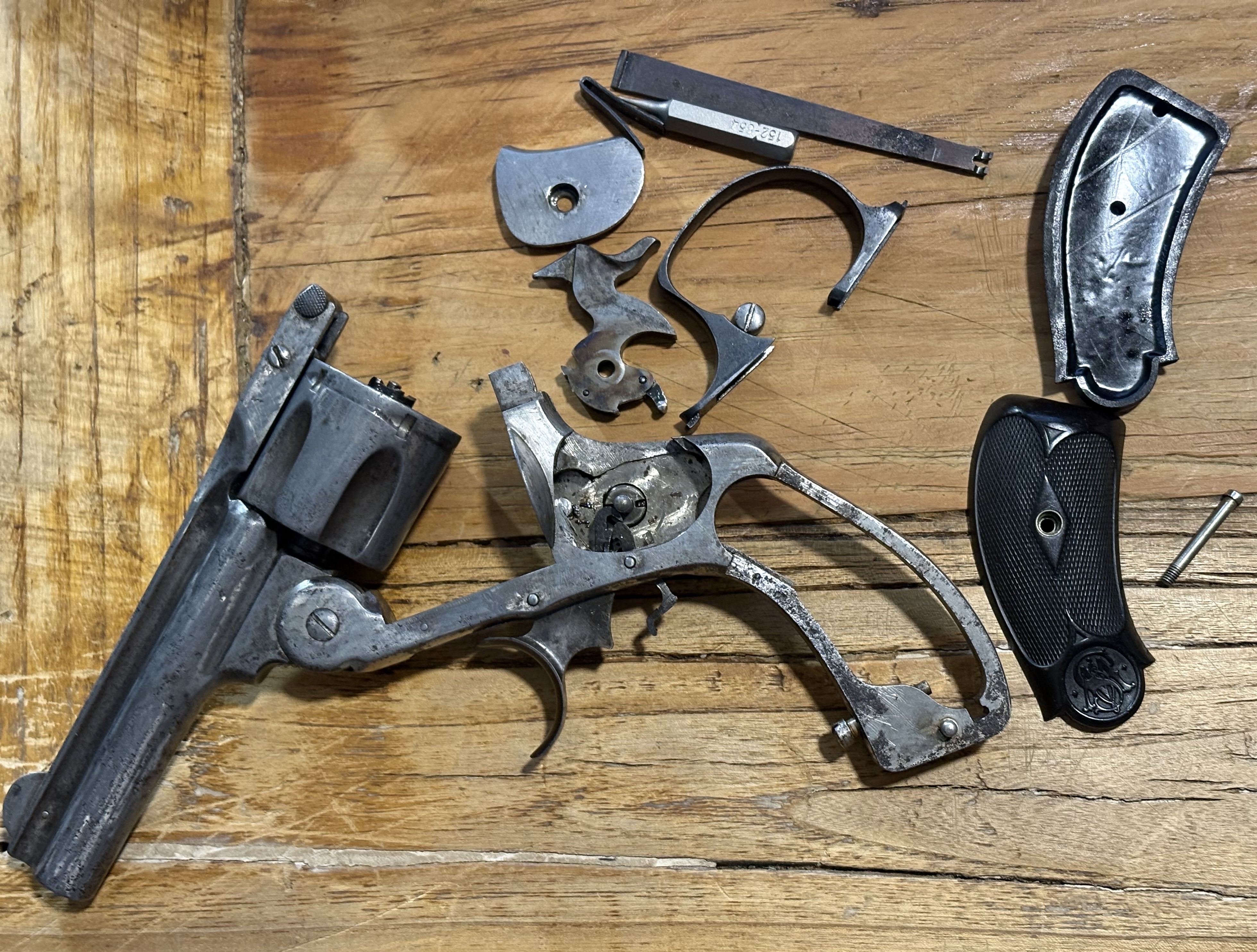

Current state of affairs

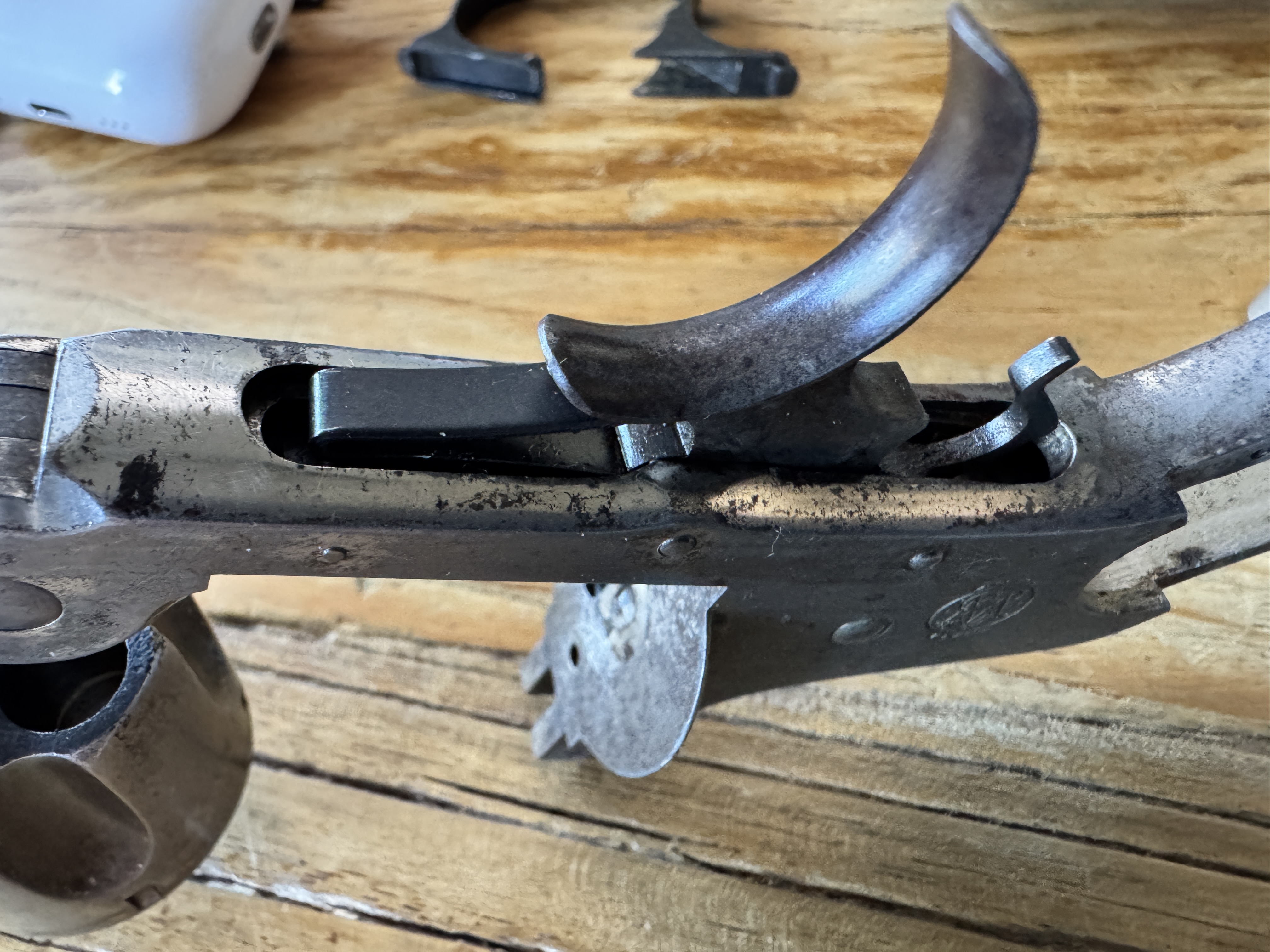

I wish I could agree with that statement. Hammer springs are easy. This spring lives in a tiny machined recess inside the lower frame where the trigger guard has to be compressed over it (no screws, it's a freaking work of art how it was machined, and you somehow have to keep it in a very precise place for it to work properly while snapping down the said trigger guard. That's why I'm convinced that even though all the kitchen gunsmiths on the inter web show how to do it from the bottom without taking the trigger off I believe it goes into place before the trigger gets pinned into place.
Oh, there is ZERO room for ANY tools where it goes while assembling the gun.

Yep, actually I' m pretty sure I will just tear it down to a pile of parts, clean, polish and re-finish first. Then I think logic will help me with order of reassembly. I'll go slow and think every step through.

Absolutely agree and I have several pairs in different sizes. BUT, for this job there is no room even for a pair of tweezers where this spring goes. The action of squeezing/snapping the trigger guard into place compresses and retains the spring, unfortunately usually moving it out of position while you attempt it. I have another example of this gun that operates properly but I'll be damned if I take it apart until I figure how to do this right.

That is the current plan. It's actually sitting on my desk in my office while I take pictures and SLOWLY take it down to a pile of parts. one of the pins in this gun defies finding a punch small enough for it.

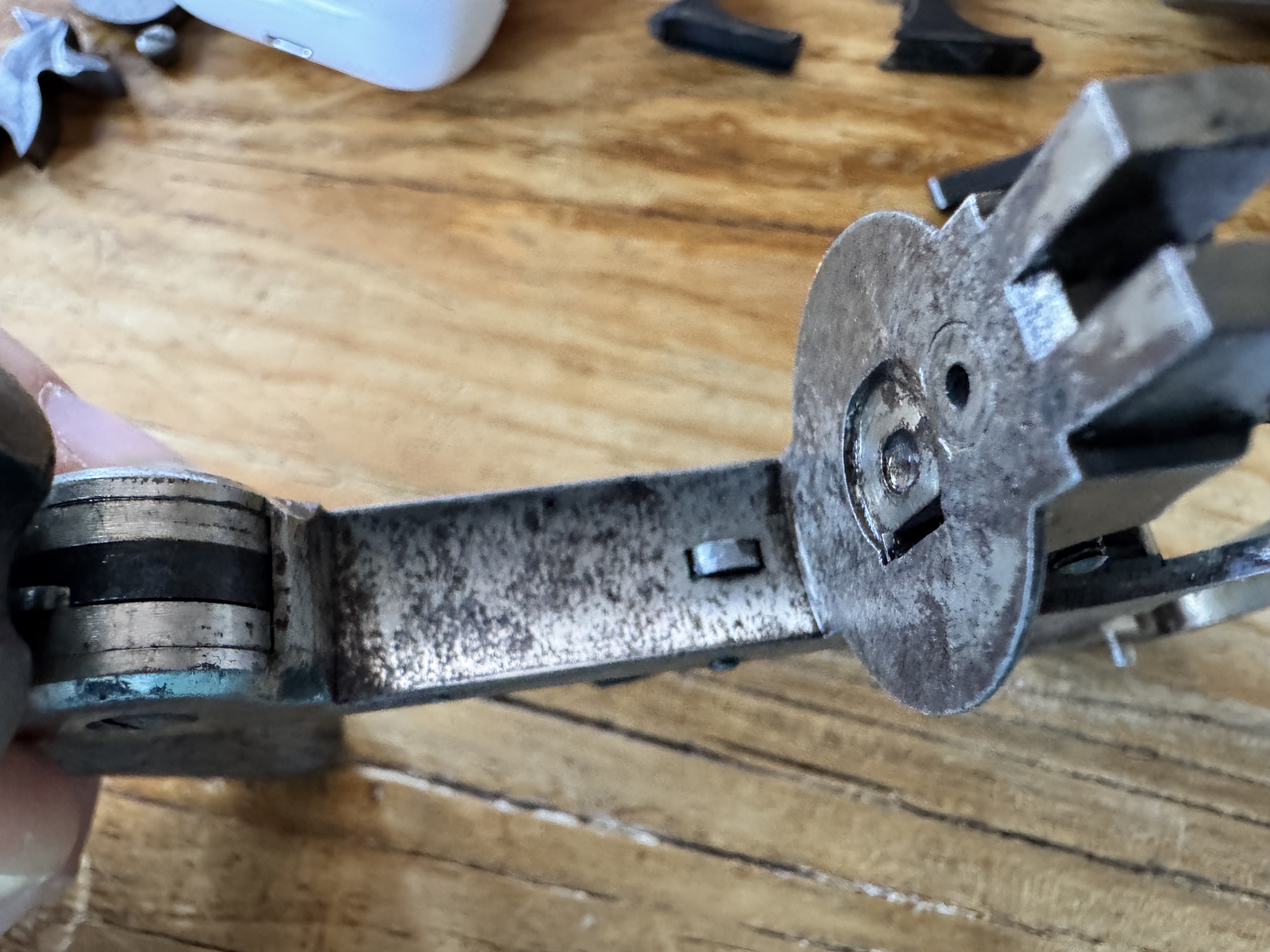

The spring goes in here.
There is NO access form the top.
ALL frame parts that have to do with the trigger have to be placed and pinned from the back.
