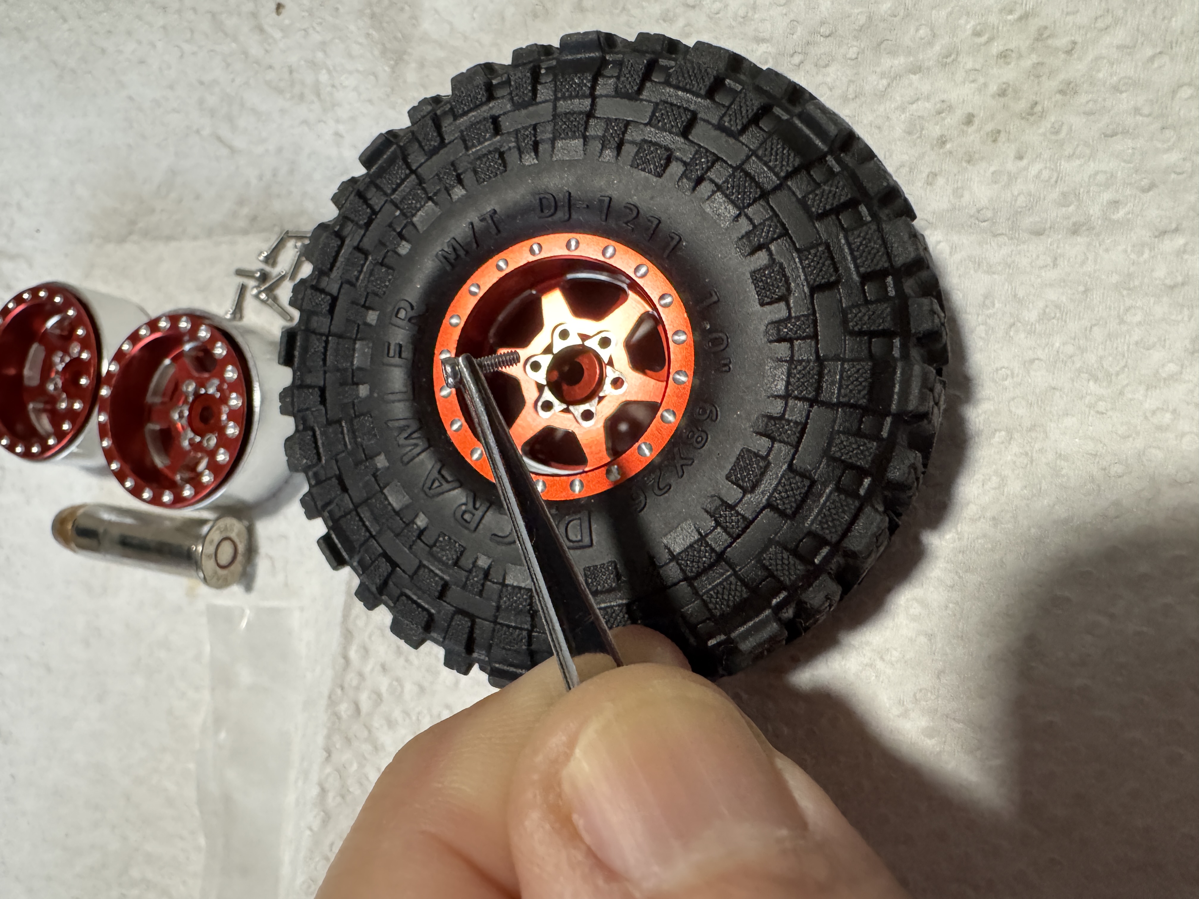

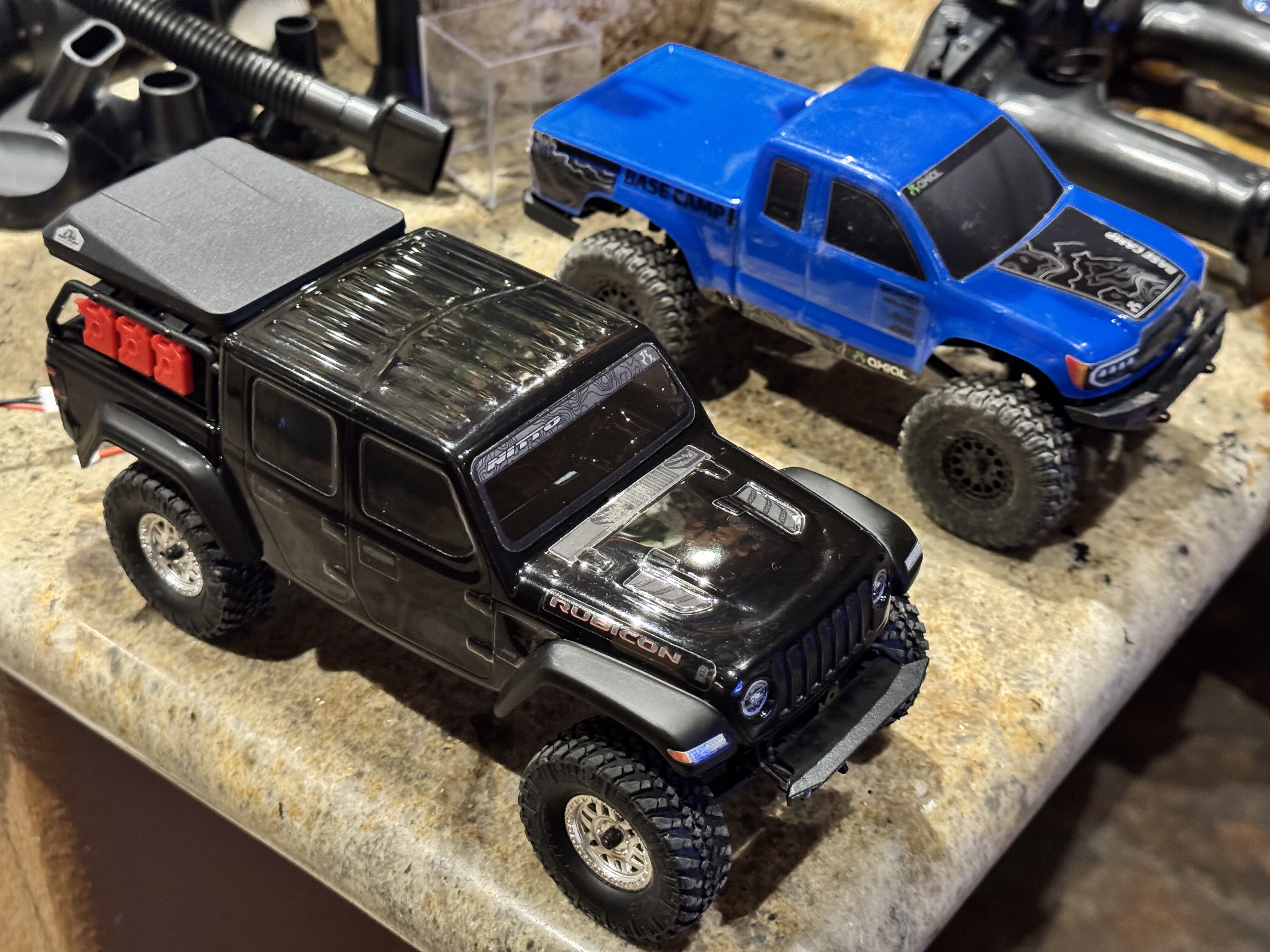

Decided I needed ONE more hobby so I started dabbling in RC stuff. Got a nice drone to follow my Gladiator around in the desert and go to places I can't so every afternoon I'm spending a little time getting the flight and camera controls solid. of course it's Chinese made and it just ROCKS!!! 4k camera and incredible flight characteristics and controls.
AND then I decided I needed a little Jeep Gladiator that I could rock-crawl around my backyard with when I can't take the time to really go off-road... There is a section of my new backyard that I didn't know what we'd be doing with. My wife said she does not want to encourage my madness but after seeing the wheels and the freaking real oil dampened shock absorbers she said we might just build a miniature Moab and she'll get her own rack crawler so we can both play!!! :D
The truck will be here tomorrow but I already got upgraded tires and wheels som other parts and DAMN!!!!!
Anyway the freaking Chinese have figured out a way to PRECISION machine these damn parts in bulk and still only charge under $20 for these wheels!!! The tires are AWESOME, soft and stupid sticky. I threw in a .38 spl cartridge in the pictures (all I had handy on my desk) for size in perspective. But these wheels are TINY and beautifully machined and flawlessly anodized!!! I have to put the screws in place with freaking tweezers but they lock like bank vaults, and the damn things are actual bead locking wheels!!! Hell I don't have those in my real Jeep!
Yep, these bastards deserve to take over the world :shock:

That’s actually a very simple part to make. If…you have the right machine. Bar fed Y axis lathe. Load in the bars of material, it moves it into the chuck and goes to town. 100% automated, save for loading the bars and hitting go. They are quite literally a money printing machine.

Here’s a really close example of your wheels. That’s a twin spindle machine. The sub spindle picks the part from the main so that they can machine the back side. Other than the 12 year old girl manually loading the stock.

CPJ 2.0 wrote: ↑Fri Mar 06, 2026 4:06 am That’s actually a very simple part to make. If…you have the right machine. Bar fed Y axis lathe. Load in the bars of material, it moves it into the chuck and goes to town. 100% automated, save for loading the bars and hitting go. They are quite literally a money printing machine.
Which part? The wheels or the screws which BTW use a tiny 1/4” T bit that looks like a freaking needle. And tapping the holes on the wheels without stripping those thin little threads can’t be easy. I’m sure as you say with the right machines. But damn…

First upgrade shocks and tires. I need new eyes!!!
Current garage: Jeep Gladiator and a Toyota Taco
Pre-upgrade SCX24s, nice base RC trucks that are fun out of the box and have loads of aftermarket parts so you can build them into whatever you like 👍
