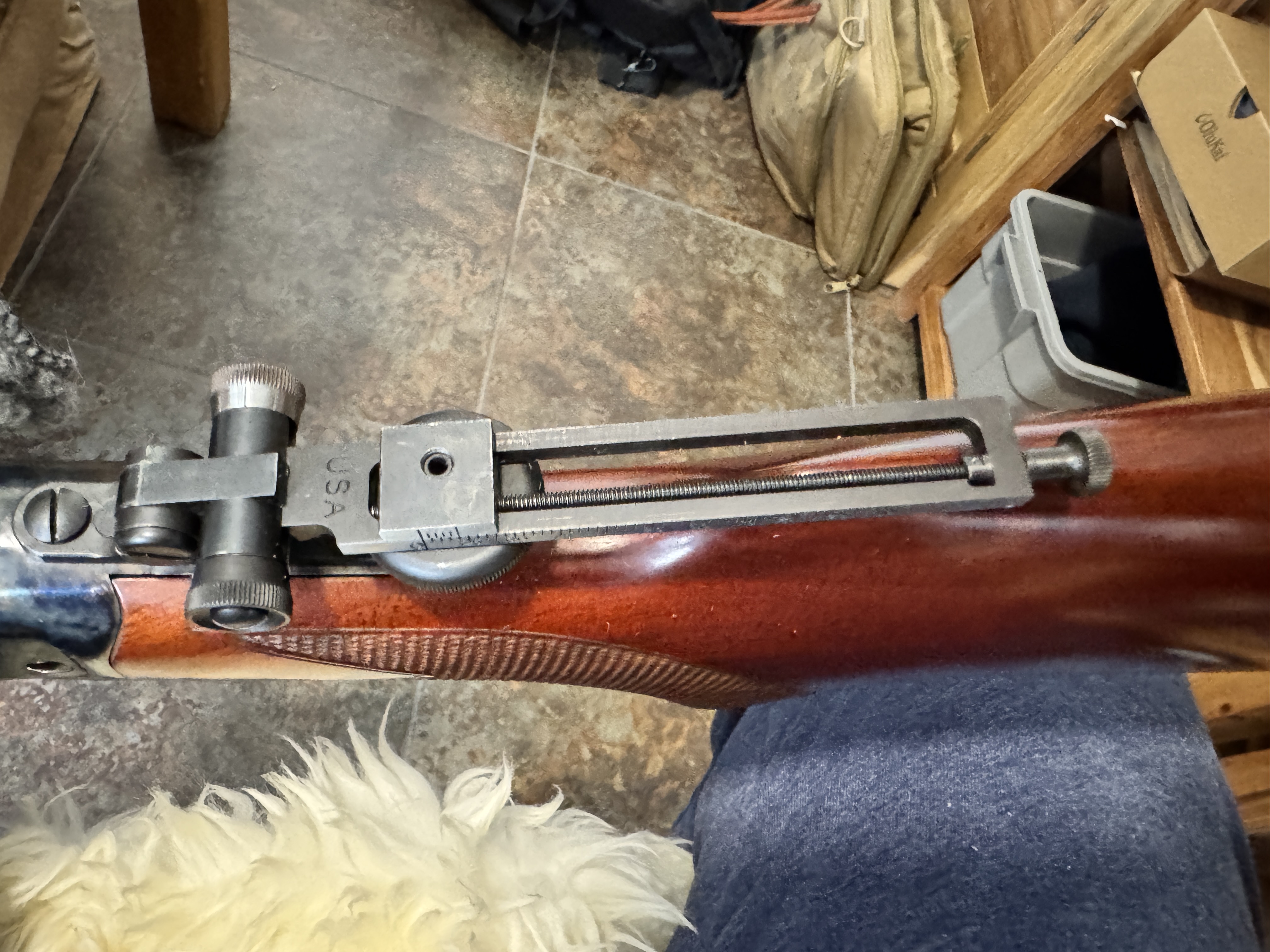

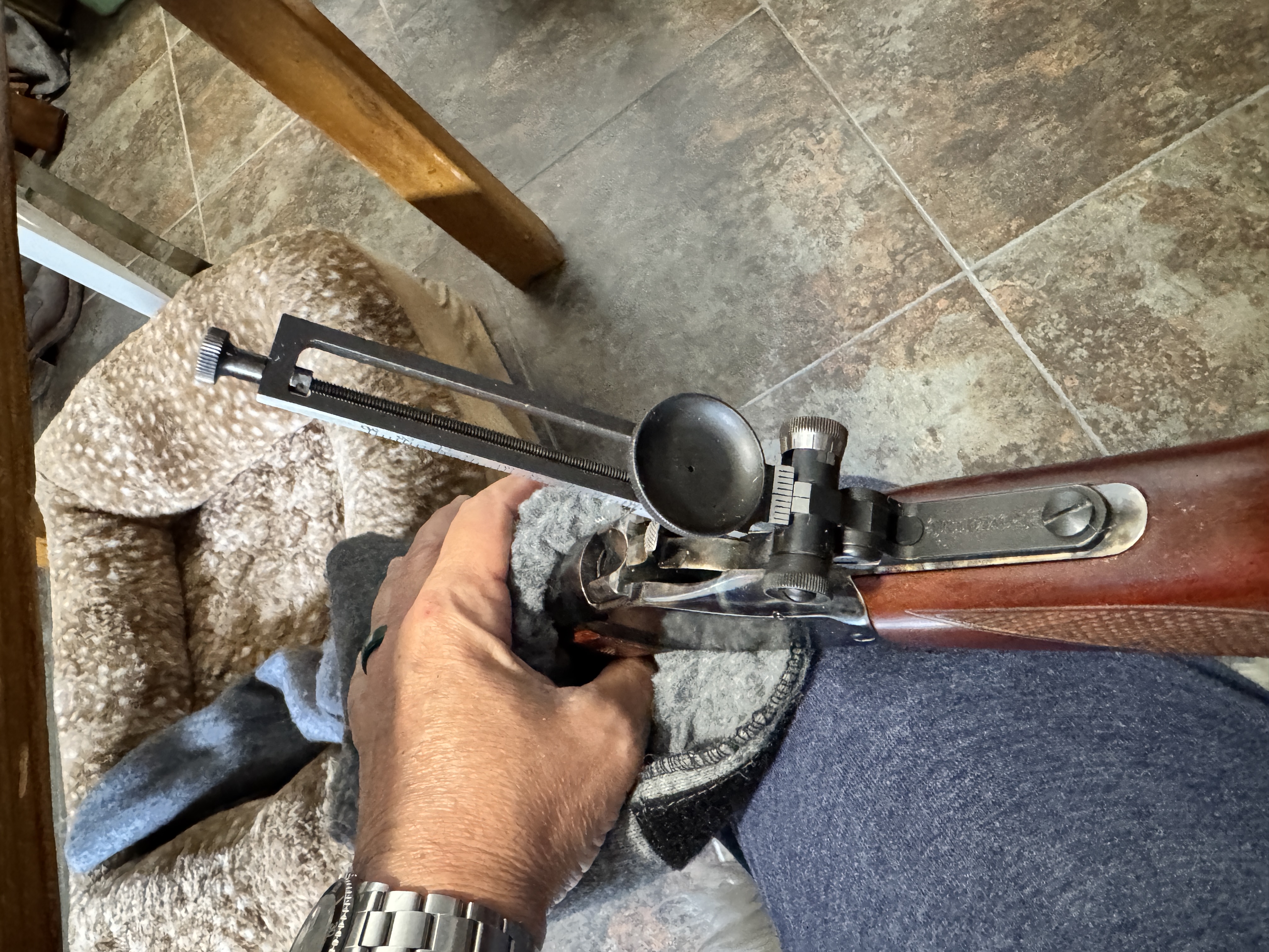

Anyone have this sight or similar? One what for launching Volkswagens at long distances?
If so, I have some questions on some measurements. Have an upcoming project

I have 2 similar, one frome Lee Shaver and the other a Montana vintage arms. Both on C.Sharps 1875 models from the Montana make.
Re: Hey Sharps guys got a question.
Posted: Mon Mar 30, 2026 12:37 am
I have dad a Montana Vintage Arms sight on a sharps. I run mainly Lyman’s and Marbles now. MVA sights are worth every penny for repeatability and durability.

Elk Creek wrote: ↑Mon Mar 30, 2026 12:37 am I have dad a Montana Vintage Arms sight on a sharps. I run mainly Lyman’s and Marbles now. MVA sights are worth every penny for repeatability and durability.
Cool.
But I’m making one. 😬

If you're taking the trouble to make one, copy a model with windage adjustment. Just a thought.

Sure. Take something simple and make it hard!😬 (I didn’t even know they made one with windage adjustment)

Yes, he can drift the sight. 😬
Make elevation only is cake. The windage adds a ton of pain.

Posted: Mon Mar 30, 2026 7:19 pm
So when the sight folds up or down it’s just held in place by friction?

CPJ 2.0 wrote: ↑Mon Mar 30, 2026 7:19 pm So when the sight folds up or down it’s just held in place by friction?
Detents that guarantee a 90 degree to barrel, so the sight snaps into place when in the correct position. They are usually either adjustable on a generic model mount or set on a model specific mount.

The issue with that is you'd have to assume that the barrel/front sight, dove tail and the tang on the receiver are correctly indexed to be perfectly horizontally aligned with the rear sight through the whole line of travel (I hope I explained that correctly). Any deviation between the barrel and the receiver or the tang, or the sight base, or the attachment screws or how square the sight frame is, etc... will get you perfectly aligned at exactly ONE yardage setting.
Not trying to dissuade either of you. Just making you aware that all your work (and this I assume is NOT a simple job), might be for naught. You are probably better off actually making a ladder type barrel rear sight. At least it will be easier to align the front and rear and you can still get them a fair bit out there. Of course that assumes the dovetails were also cut perfectly aligned on the barrel.
BTW this is based on hands on experience. I installed the type of sight you show the OP on one of my guns. It swiftly proved to me that it was way prettier than it was functional and it got replaced after one range session.

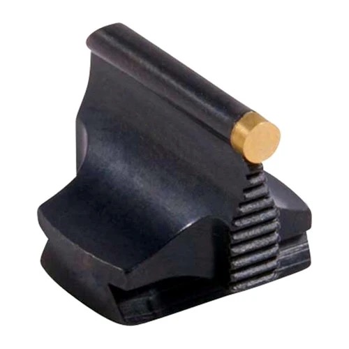

What type of ladder sight?

Something like this…
https://skinnersights.com/products/skinner-ladder-sight

Posted: Tue Mar 31, 2026 1:30 pm
Still a fair amount of work and can’t fine tune elevation precisely like the other type, but it’s much sturdier (not a bad thing considering the intended user) and it won’t disappoint after it’s on.
Posted: Tue Mar 31, 2026 1:39 pm
The small screw in top of the ladder is just there to keep you from sliding the bar off outright until you want to. The screw on the side holds a spring and a small ball bearing to provide smooth friction and detente type stops on the ladder.
Bonus, because it’s closer to the front sight you can get away with a shorter sight and still gain a lot of elevation adjustment, and it’s MUCH faster to deploy and adjust.
AND the screw on the actual part that slides into the dovetail can be loosened to adjust for windage which beats the hell out of a brass punch and hammer at the range.

That setup works... for some (maybe even many) folks and for some applications. Personally with any insert I've tried in a globe sight, any dark background target that does not offer a distinct white/black sharp delineation will make the whole globe and front sight blend and turn into a big black blob...I've tried many globe fronts sights over decades and if hunting is on the menu in any shape it's a hard pass for me so I have just about given up on them in favor of a classic post with a white or brass bead on top. I can see those well on most backgrounds, especially on game (favorite of Africa dangerous game hunters for a reason) and all I do is lay the dot on the target and press the trigger. And those work with anything you put on the back.
https://skinnersights.com/collections/f ... ront-sight
