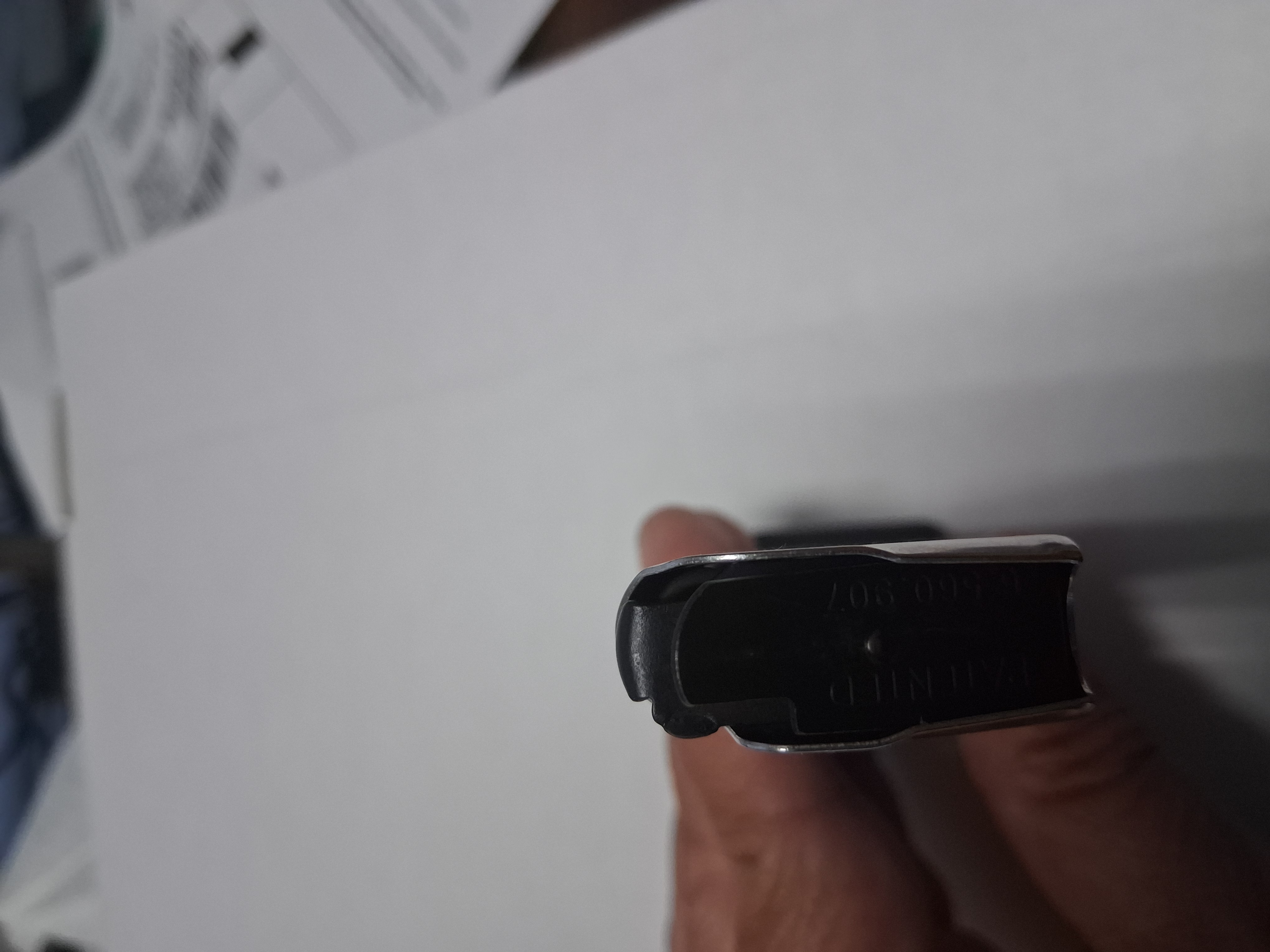

I used Midway's birthday pricing and free shipping to get some stuff for les expensive prices than I could get elsewhere. Among them, I got 3 new magazines for my 1911s. 8 rounders from a manufacturer who's got a decent reputation with features II prefer so I could try before I got more. As is my habit, I pulled the mags apart and cleaned them internally before I even loaded them. Some folks ask why I do this instead of going to the range, loading them, and trying them there. Well...

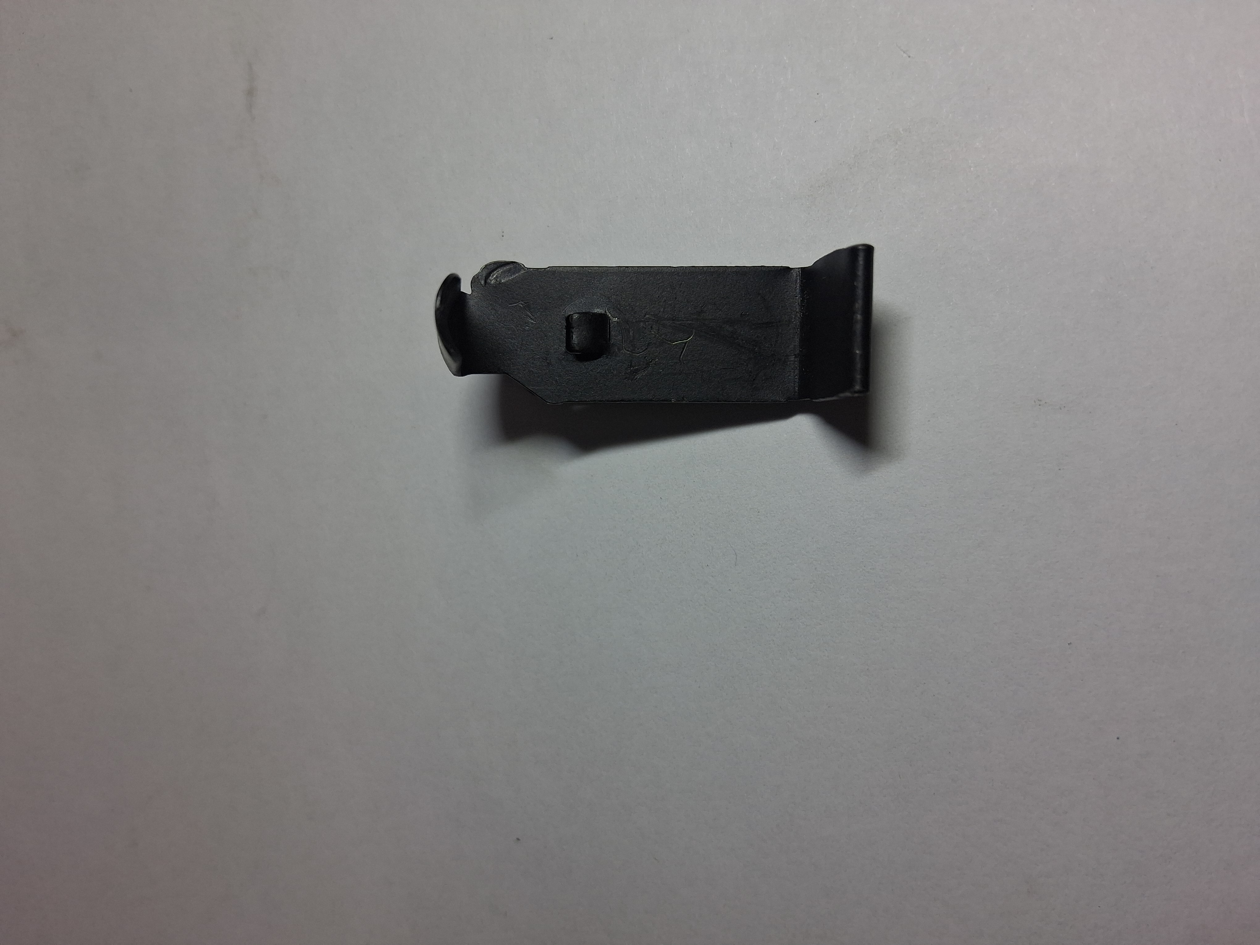

One mag, after being cleaned, was hard to load and would not feed. So I took it apart and started examining stuff. The follower wouldn't easily move in the mag tube with no spring. I examined it better and found...
The tab that's supposed to hit the slide stop is deformed. Factory mistake. It didn't show up at first look because...
With the mag assembled, it's not hitting the tube. Only way to tell is to put 2 or more actual or dummy rounds in the tube.
