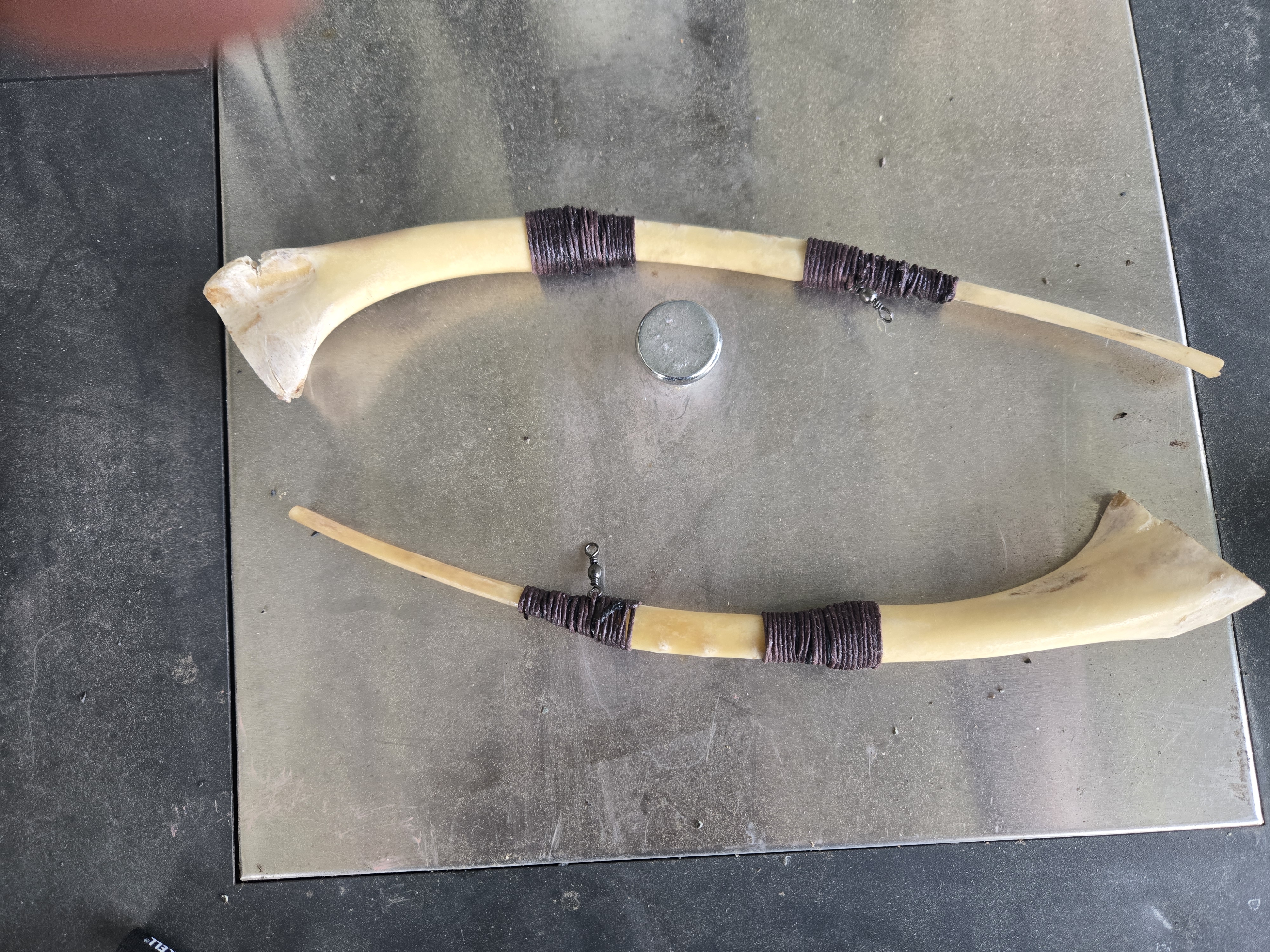

These are my latest project. They're not complicated, or time consuming but a fun project and they work well. I like doing as much as I can with the animals I harvest. We'll test them this weekend.

Friends of my family have seen my calls and want one. They have provided five sets of wing bones and a couple spares. By mixing and matching the bones I can find a nice fit. I found that by using my grinder, jig jaw and epoxy, I can get a good fit and taper the joints for a better string wrap. I don't feel I need the wrap but it makes a great place to add a couple double closed swivels for lanyard attachment points. I use a small piece of wire to clear and tune the blow holes because the bone dust sticks to the epoxy. Each call has a slightly different tone with three capable of loud calls. The other two perr like kittens. This project is a lot of fun and opens a door to the past, one I gladly walk through. I hope that one day a later generation will see one of the calls I made and say, "What the heck, that's old school, I can do that!" and use a turkey wing calls instead of a cell phone, or whatever they have in the future. Like the old bolt action shotguns I refurbished in the past these will revive the old ways. My friend used Truetone calls to bring in my "First turkey" I'd bet these would do the same or better.
One thing I learned this year is, those old Tom's are hard to call. The Jakes and hens will respond to the mouth calls and hand held calls but there's nothing like the life sound your mouth and lungs can add to a bone call.
