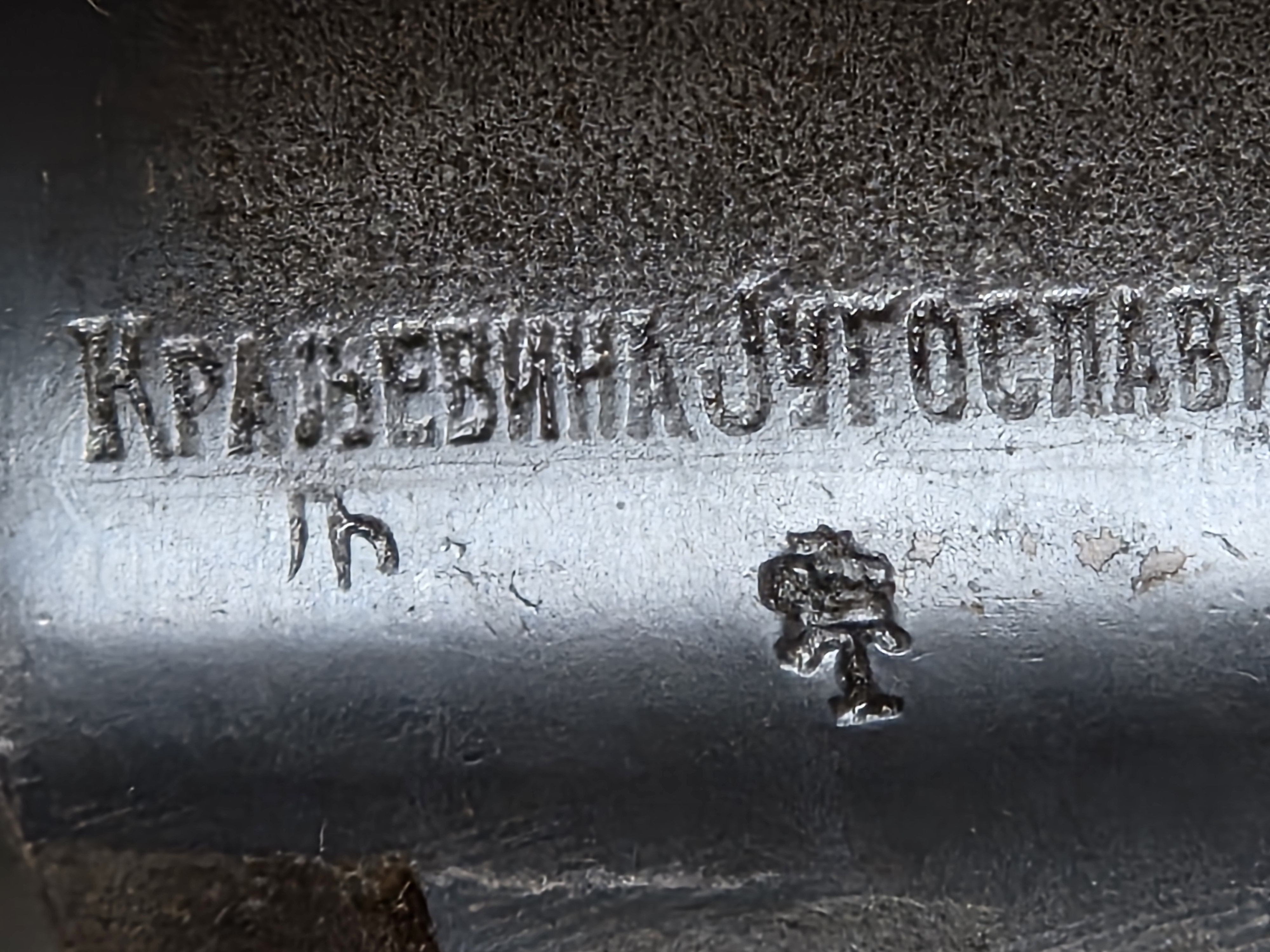

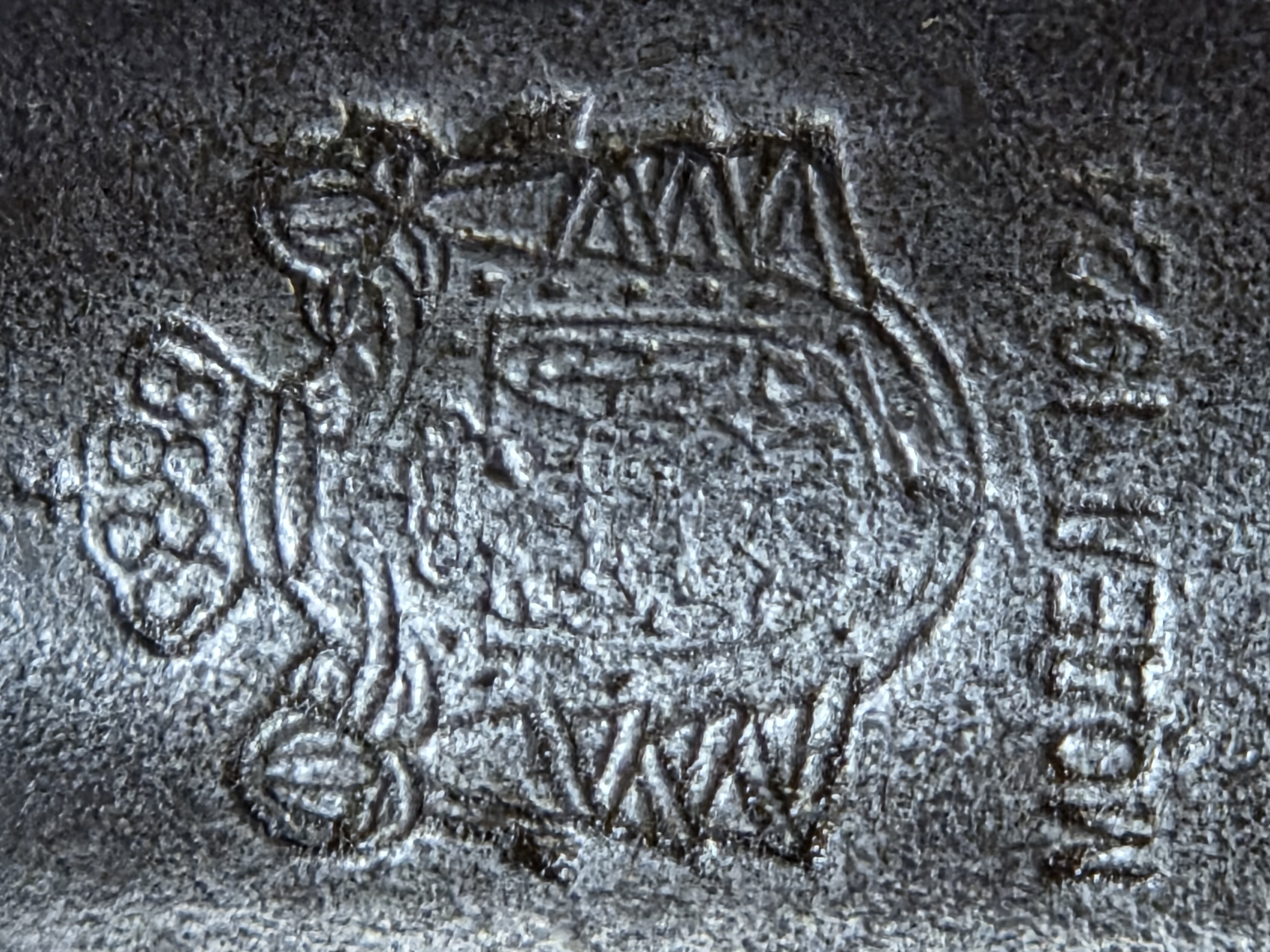

Mauser 1924 action
Posted: Wed Jul 08, 2026 4:01 pm
Not knowing jack about mausers
Looks like an unscrubbed Yugoslavia one
Worth picking up for a someday thing for 100 ?
Probably would never get used by me.....but ?

Yeah, what are we looking at?
Re: Mauser 1924 action
Posted: Thu Jul 09, 2026 3:41 am
It Has the bolt basically a full unbarreled receiver.
Would need stock and barrel to put a gun together
I'm Probably going to avoid it. Unless it was too stupid a deal not to have around
In case some whim develops

There’s a quirk to the Yugos, but I can remember what it is. But if you’ll just send me your bolt I’ll complete the action I have that’s missing the bolt. 😬
Posted: Thu Jul 09, 2026 3:03 pm
One of the quirks is that it’s unique to other Mausers. Can’t just grab a 98 bolt, it’s got to be a yugo.

Posted: Thu Jul 09, 2026 4:14 pm
It’s the way the bolt/barrel is interfaced, is the difference. Regular Mausers have a flat barrel face, yugo have a recessed face and extractor cut. Making it a much more involved gunsmithing project. Not hard, but more than just spinning a barrel on.
