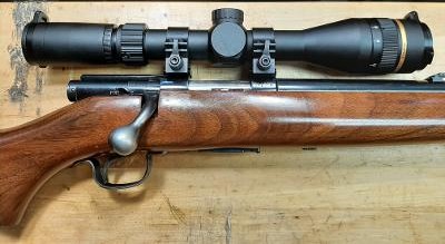

Mine, in .22 Hornet (of course) has a hard trigger on it. Clean, but about 6 pounds. I've been told it can't be lowered as the trigger is basic...you get what you get. I wonder from you gun guys if the trigger could be replaced entirely. Not with original parts, but with something crafted to fit. Something adjustable.

The trigger system looks like a simplified pre-64 model 70. It is adjustable via a small screw that sets the return spring tension. Lightening the pressure on the spring and some judicious stoning of the sear should improve the trigger tremendously and looks simple enough to do.

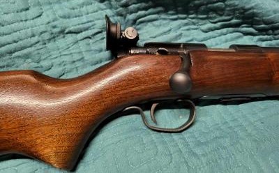

Yep Winchester 43. . .
Winchester 69A
Methinks they might be related.

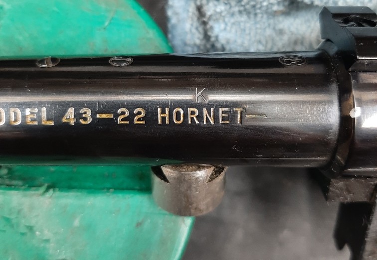

I may need to dig out my 43 and go play again. Got as far as figuring out the load, and got distracted by other things. Kind of a pain in the ass, truthfully. I thought I'd bought a Hornet, but someone had done a K-Hornet conversion and never thought to indicate. I fixed that:
Winchester 69A
