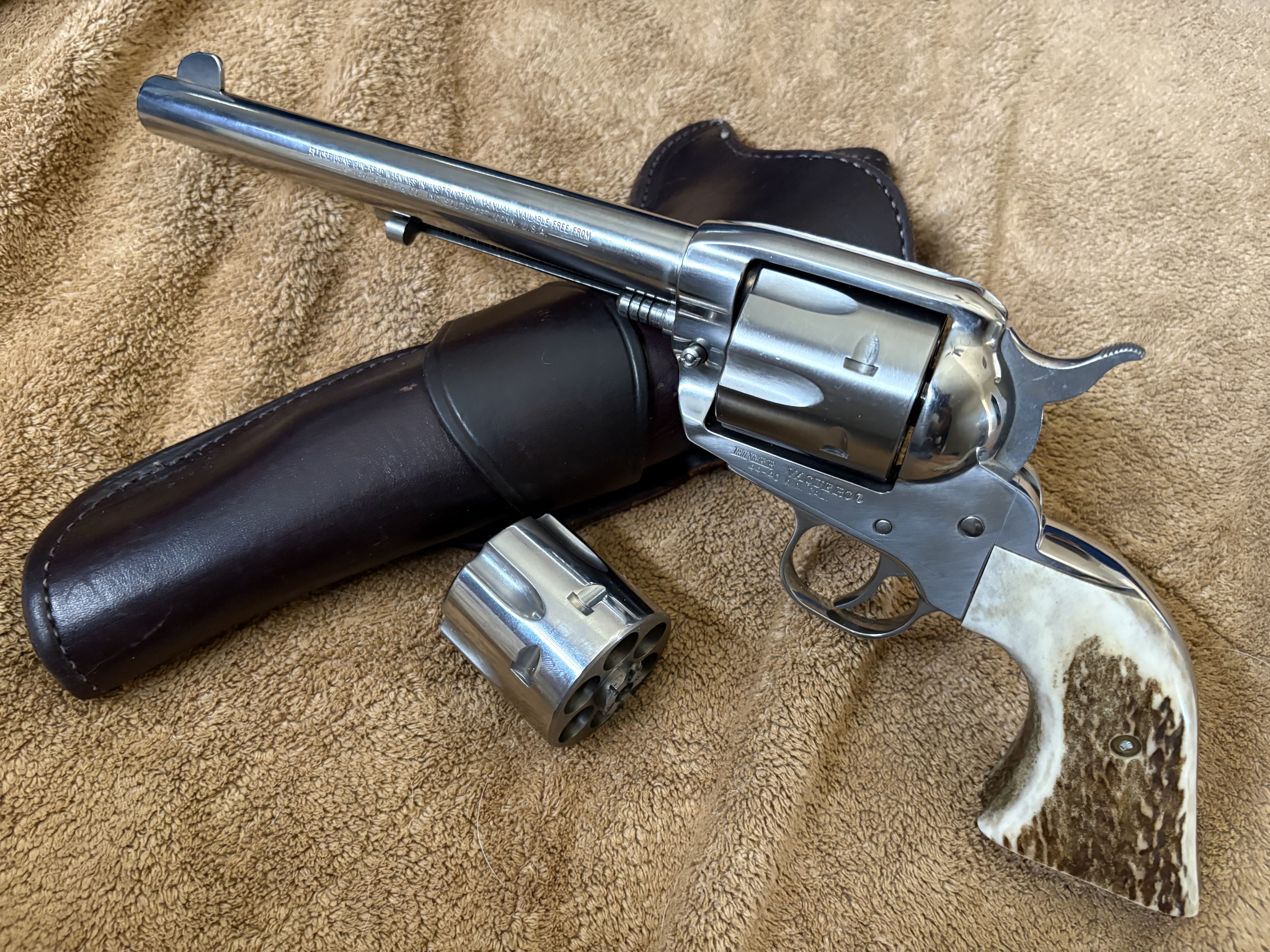

I have an SS Old Vaquero 7.5” in .44-40 and I love that gun, but I always thought it’d be fun to have a convertible with a SS .44 Mag cylinder so I have options! Factory 44-40 is expensive and I haven’t started reloading it yet, but I have buckets of .44 spl and mag reloads!
We’ll, kick in eBay and I found BH SS .44 Mag cylinder which looks to be in basically like new shape. Doesn’t even have turn marks. For the money (under $100) I figured what’s the worst that could happen.
Well it arrived yesterday and I threw it in the gun today and except for the level of polish being a bit more matte on the BH cylinder the fit is factory perfect!!! Timing is right on the money and there is zero back and forth or any other movement. Locks up like a bank vault when I cock the hammer.
So here’s my new to me 44-40/44 Mag convertible!

Chiro1989 wrote: ↑Sat Aug 29, 2026 1:41 am Ruger says this is OK to do?
They never made one, that said is the shoe fits Cinderella….
The biggest concern would be barrel grove diameter and cylinder timing. When all those stars align it’s all good!

Elk Creek wrote: ↑Sat Aug 29, 2026 2:05 am
For compatibility of parts purposes, Ruger barrel grove diameter in the 44-40 old Vaqueros was the same .429 they used for the .44 Mag Vaqueros and BH 👍👍
Now I could have just loaded my 44-40 to 44 mag pressures with modern brass for this revolver that’s basically a tank, but I also have several 1873 clone Ubertis and a Uberti Model 66 Yellow boy rifle in 44-40 and none of them would appreciate a steady diet of hot stuff.

Japhy wrote: ↑Sat Aug 29, 2026 4:34 am Interchangeable cylinders in the 44s was an unknown feature to me.
If the vaquero was designed iff of the blackhawk wonder if 44-40 cylinders will interchange with 44 RM in the super blackhawk or redhawk?
Yes on the Super Blackhawk but I don’t think so on the Redhawk it being a DA. But I will admit I have never looked into it.
Ruger only has a handful of CNC blueprints and they trim and shape the castings to their needs for specific models. A Blackhawk, Super Blackhawk, Old Vaquero (literally a BH frame with a rounded top and a channel for a rear sight) have a whole lot of common parts.
Other parts like grip frames and hammers are often interchangeable even between larger frames like the SBH and the smaller New Vaqueros.

New tidbit: Ruger had a new model superblackhawk convertable that came with the 44-40 cylinder and the 44 mag cylinder
Catalog number s4440
Dont know when it was available but it is a “new model superblackhawk which is the version with the transfer bar among other differences.
Ruger has a long history of convertible revolvers.
