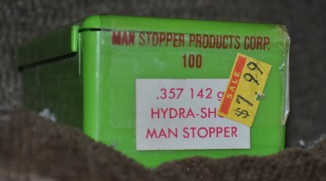

Re: Wadcutter reloading question
Depending on how heavy they plated those HBWCs, you might not get ANY expansion loading them backwards.
I base that on how little their 200gr 45 Hybrid HP expands into CBG at ~1000fps
https://www.berrysmfg.com/product/45-20 ... low-point/
As thick as the skirt appears to be on them, I'll be shocked if they do much.
And yes, I've got experience with both HBWCs backwards and the original hydrashoks, which were originally a basic HBWC with a post
