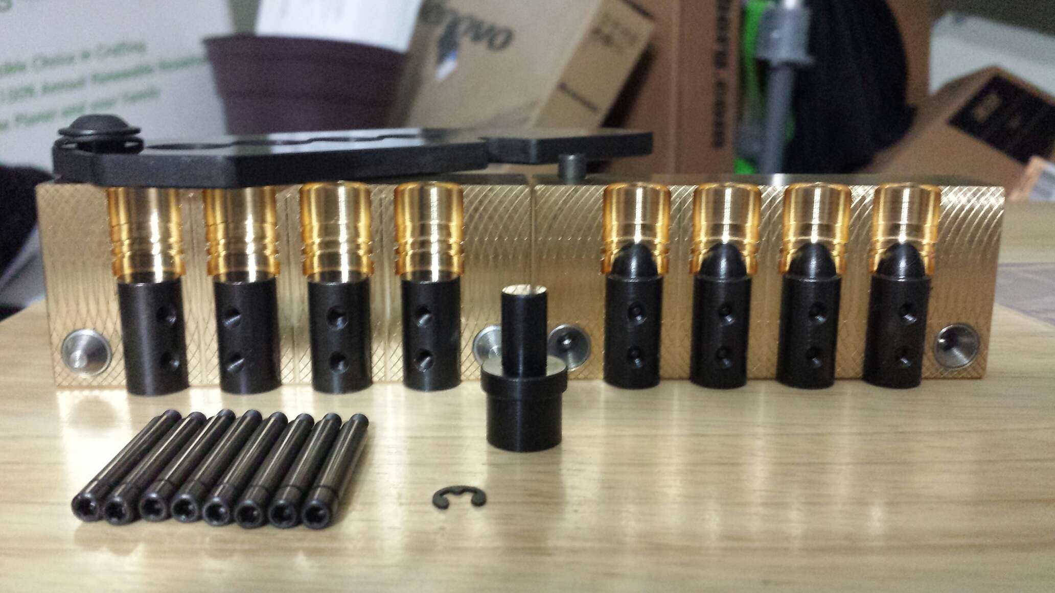

If you've ever been curious about the tech for casting a hollowpoint, this is how NOE Molds does it. Their system has a bracket that bolts to the bottom of the mold into which you insert your hollowpoint nose pin. The bracket is angled so that when the halves of the mold are opened, the pin can tilt outward and the bullet is allowed to drop off - - if all goes well. Sometimes they can stick to the pins a little, or a lot. There's a little more voodoo and chipmunk juggling involved when it comes to casting hollowpoints.

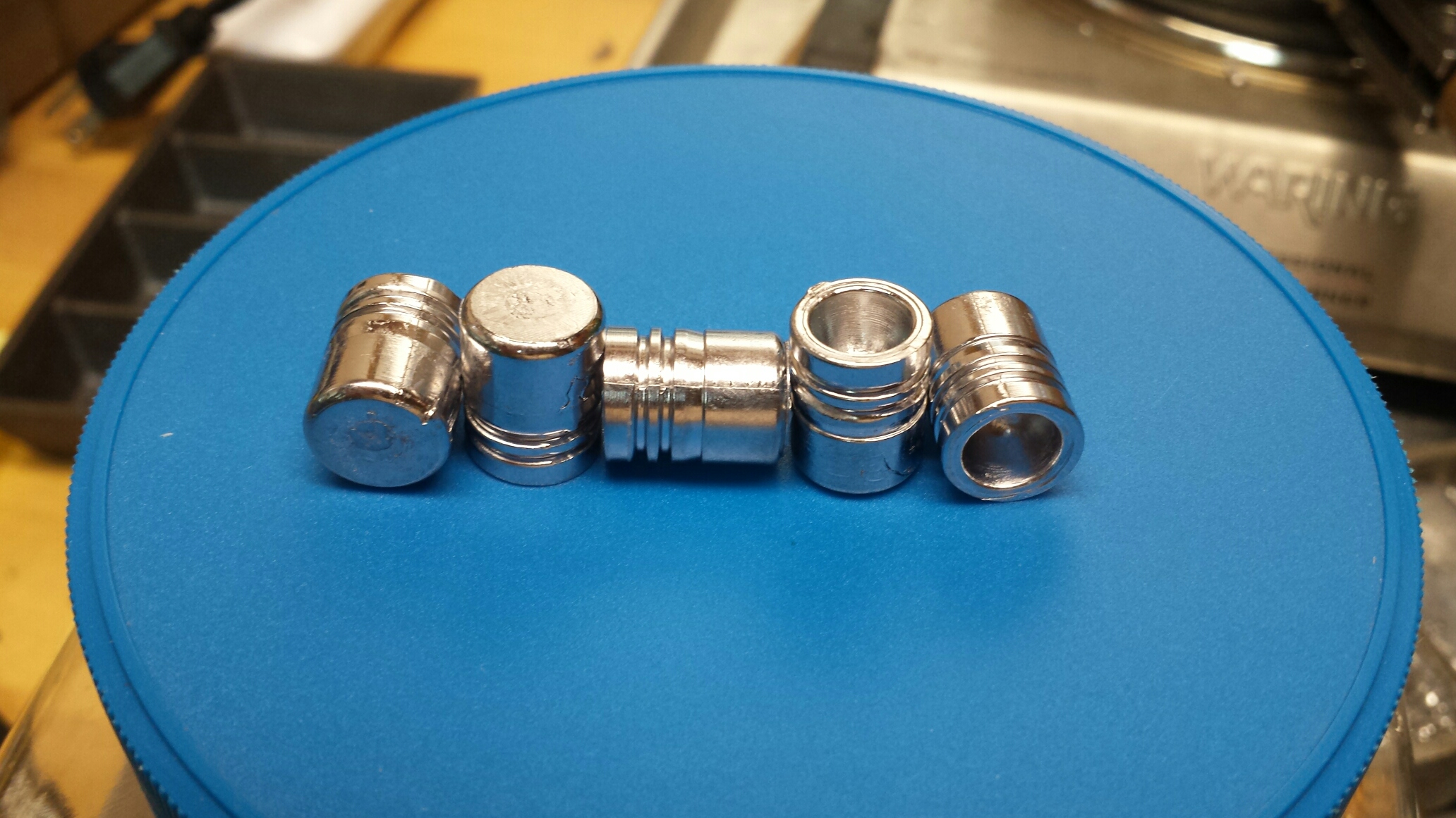

Some of the end product:
These were cast out of the cores melted out of jacketed bullets scrounged from various range berms with a little tin added to help the mold fill out properly. There's some trace antimony on board, but functionally, it's 25-1 lead/tin with a Brinnell hardness of 9.5.
That particular mold was a initially minor disappointment because, when seated to the crimp groove in .357 brass, the front driving band was too long to chamber in the Rugers. It worked OK in the Smiths, and could probably have been made to work in the Rugers with a trip through a sizing die, but that would have defeated the purpose of buying a tumble-lube mold. Thus, it's pretty much a .38 Special brass only proposition if I want a round I can shoot in anything. Since Dad's looking for comfort cartridges, this isn't a problem here.
Goal is to see what the velocity range is for expansion with this thing. Hopefully, this occurs without needing to get into +P pressure levels, but I ain't holding my breath. The Science will tell...

Not as of yet. This batch went well, probably owing to gaining a lot more knowledge since the last efforts, but hollowpoints - at least with this system have been a trying PITA compared to solids.
A wax or silicone "initiator" is an interesting concept, but whatever tissue it runs into should fill the cavity on impact and serve the same function, so really not sure to what degree it would help. But, given that we're probably looking at British Webley speeds to keep the recoil manageable, it may be worth investigating.
Going closer to pure lead would help from that angle, but would make the casting more difficult. Even with roughly 4% tin, we had to run the pot at 825F to get those nice, crisp bands.
Game plan is to milk jug test starting with a .38 Heavy Duty/ baby .357 charge of 6 grains Unique, which should get a bit over 1000 fps in a 4" gun and work backwards from there until it stops expanding when fired from a 2" snubby. Unofrtunately, deer season begins to loom, and the milk jug stash is a bit depleted. Might be a spell before I get back to this, but will post what I find.

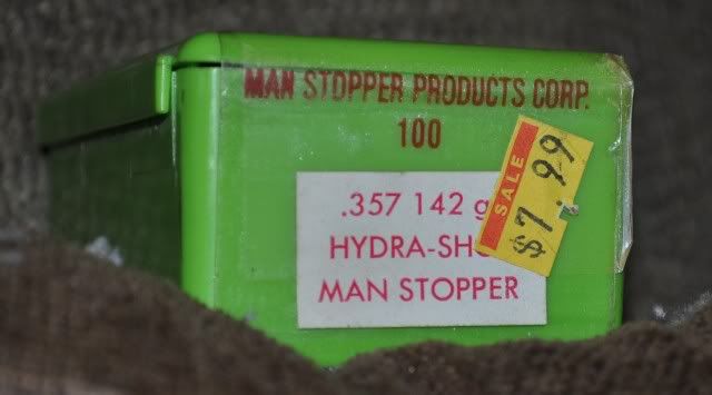

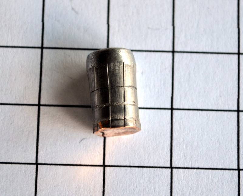

Slug, I know the original "Man Stopper Product Company" Hydrashoks I have (HBWC with a post) expand down to ~700fps into wet newsprint.

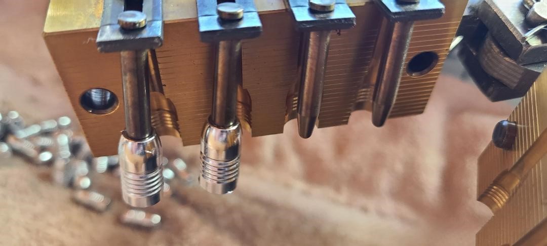

Good looking bullets. When I'm casting hollowpoints, I wipe the pins and molds with a q tip wet with Kroil and I never have a problem with anything sticking. In fact, I lube all of my molds with Kroil.

Interesting. . .how many dud casts do you get with wrinkly bullets before the solvent vapors burn out of the mold? I'll wipe the bottom of the sprue plate from time to time with Veral Smith's moly/beeswax, hit the sprue plate hinge pin, and alignment pins from time to time with the same stuff, but that's about the extent of it. Can usually count on a few wasted pours until the wax burns out.fisheadgib wrote: ↑Tue Aug 15, 2023 2:31 am Good looking bullets. When I'm casting hollowpoints, I wipe the pins and molds with a q tip wet with Kroil and I never have a problem with anything sticking. In fact, I lube all of my molds with Kroil.

Actually as long as I only put a light film on the mold, I don't get any wrinkles and it doesn't burn. I had read about using Kroil on a forum and was skeptical at first but after trying it, I started using it regularly. I just put a drop on a q tip and wipe a film on the mold, I don't wet the mold.

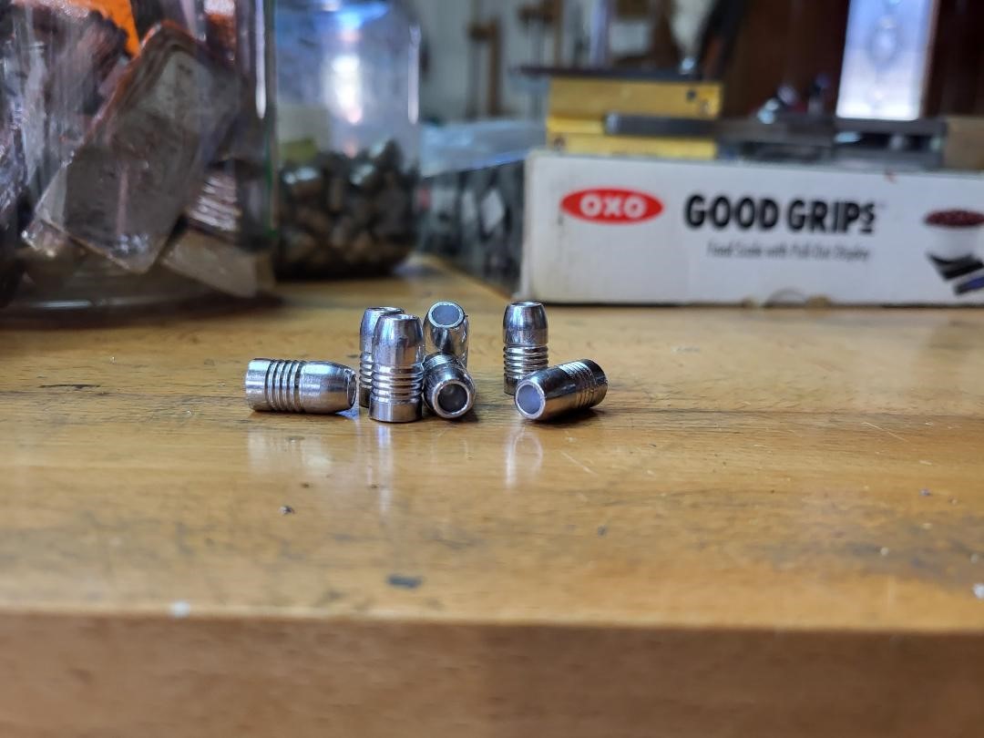

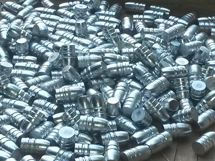

Glad I got my 0.358" 164gr GC mold a few years ago. It's the easiest casting mold I've ever used
The top 2 are one shot into wet newsprint. It measure 0.375" now. It was cast from wheel weights
