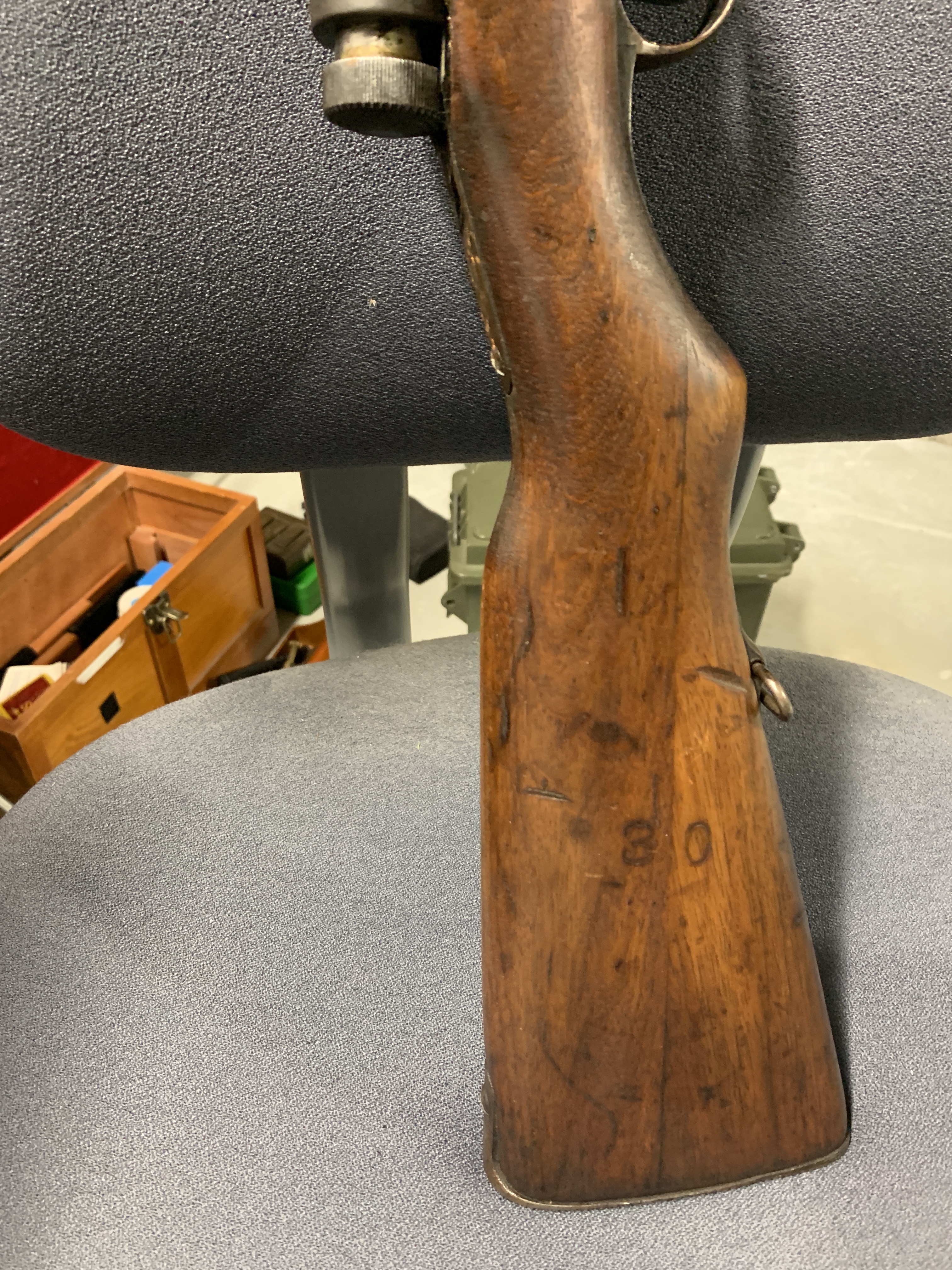

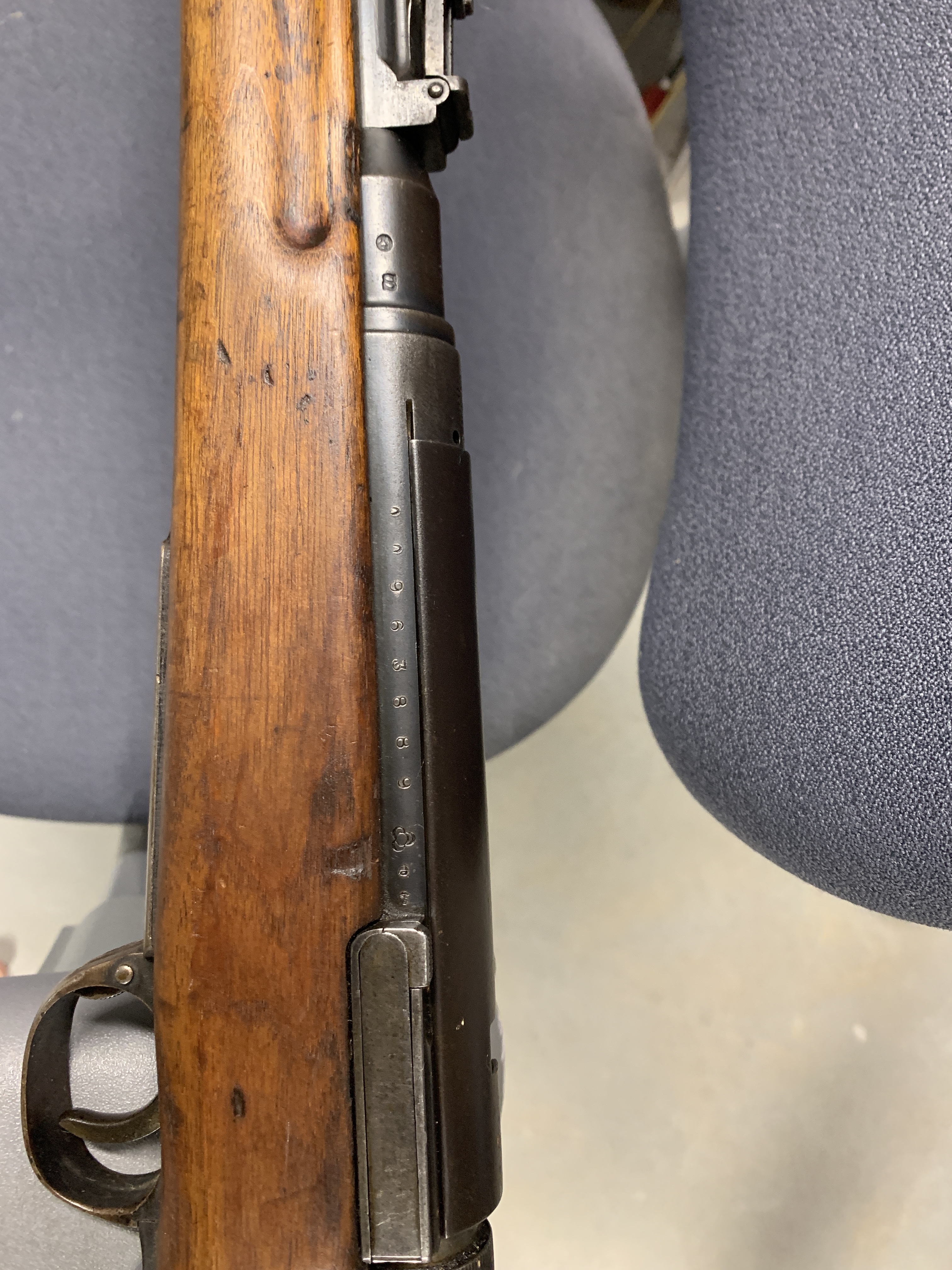

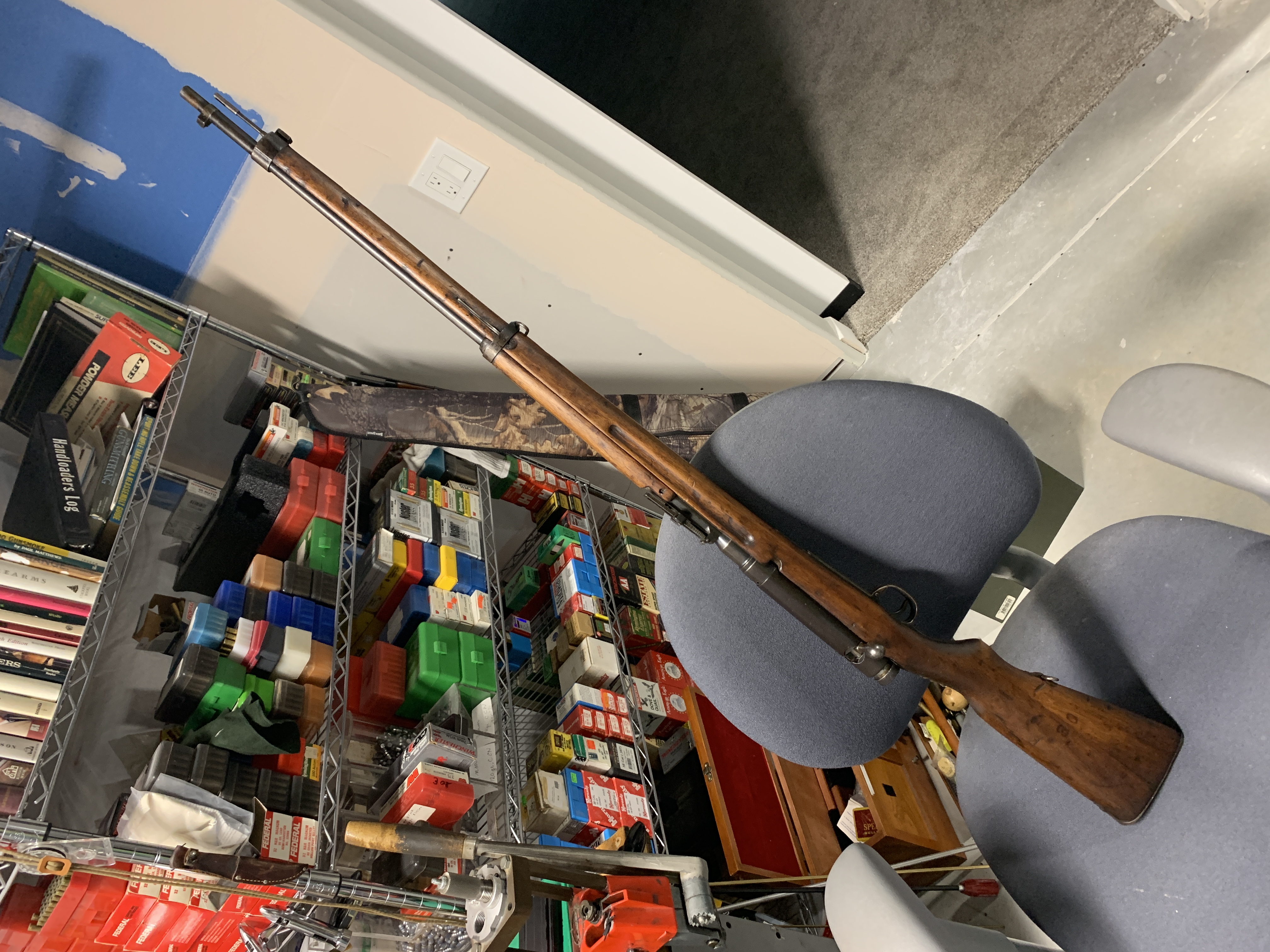

Need some expertise on this rifle. Believe it is 6.5 has an intact mum and dust cover along with bayonet and scabbard. No duffle cut or import marks.
What can you tell me about it?

I don't know anything about the rifle, but the bayonet looks more like a sword.

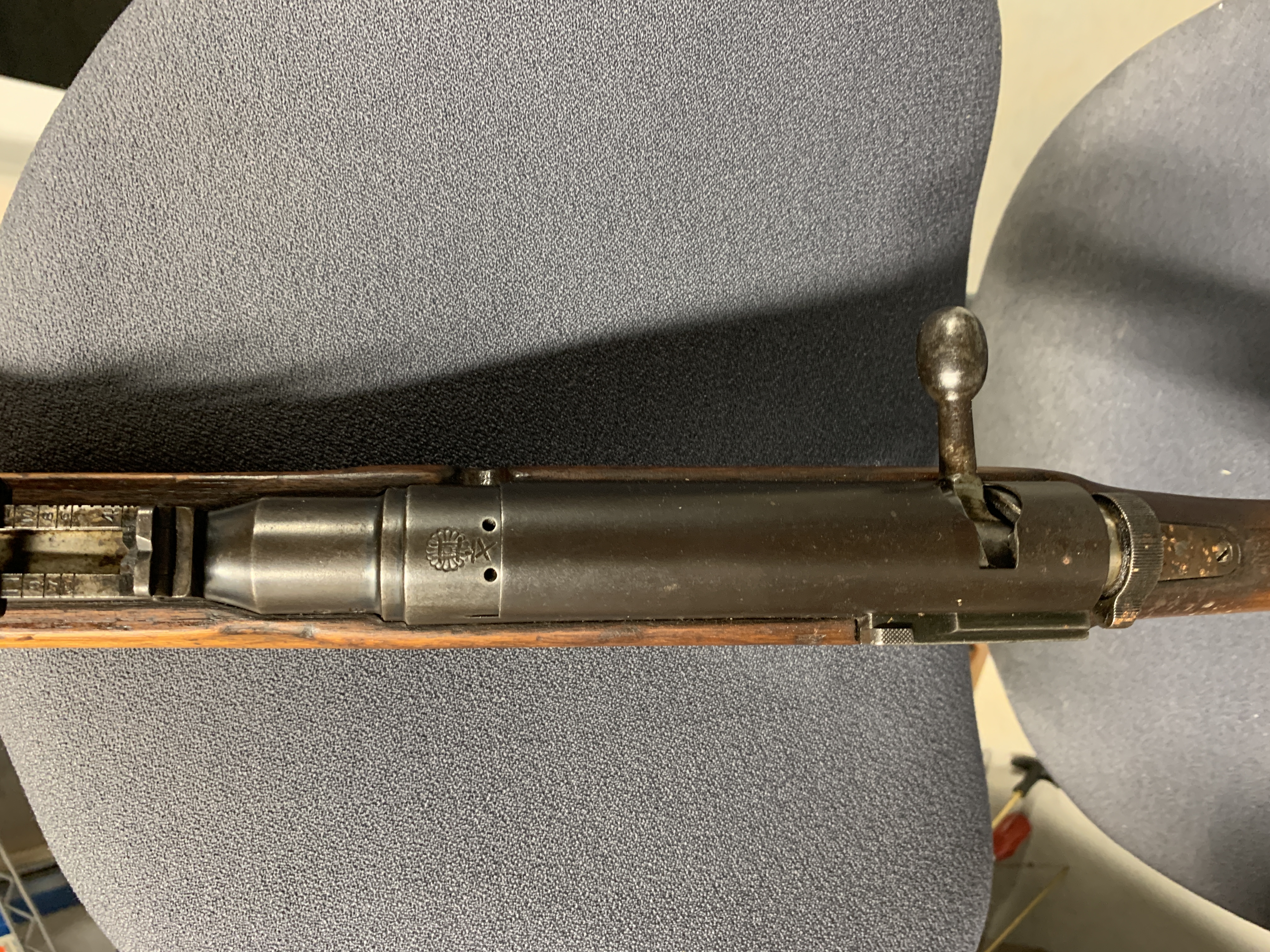

The Japanese had two basic bolt action rifles, both were Arisaka's. The 6.5x50 Jap is an Arisaka type 38 and the 7.7x58 type 99. Yours was probably a GI bring-back because the chrysanthemum is intact. All Japanese weapons had a mum on them to show it was the property of the emperor. As a show of good will to the emperor, all captured Japanese weapons had the mum removed or defaced.

What am I missing? you say drilled for a scope. The only holes I see are on top of the receiver and it is my understanding those are gas ports.

So based on info here, it would seem this rifle was removed from service to ether be sold or sent to a school for a training weapon. This based on the fact the Mum is over stamped but I can't identify the characters.
That's the way they mounted their scopes, kinda sideways to the way we would drill for one. I couldn't tell if the rear was drilled because of the dust cover. If they are not threaded then probably gas ports.

Just checked, no other holes under the dust cover and the two on the receiver go in at about a 45 degree angle so safe to say gas ports I think.
Re: 6.5 Japanese
The 7.7 only has one gas hole. I may have confused it with an 09 Argentine scope mount. Scope was a side mount on the 6.5.
