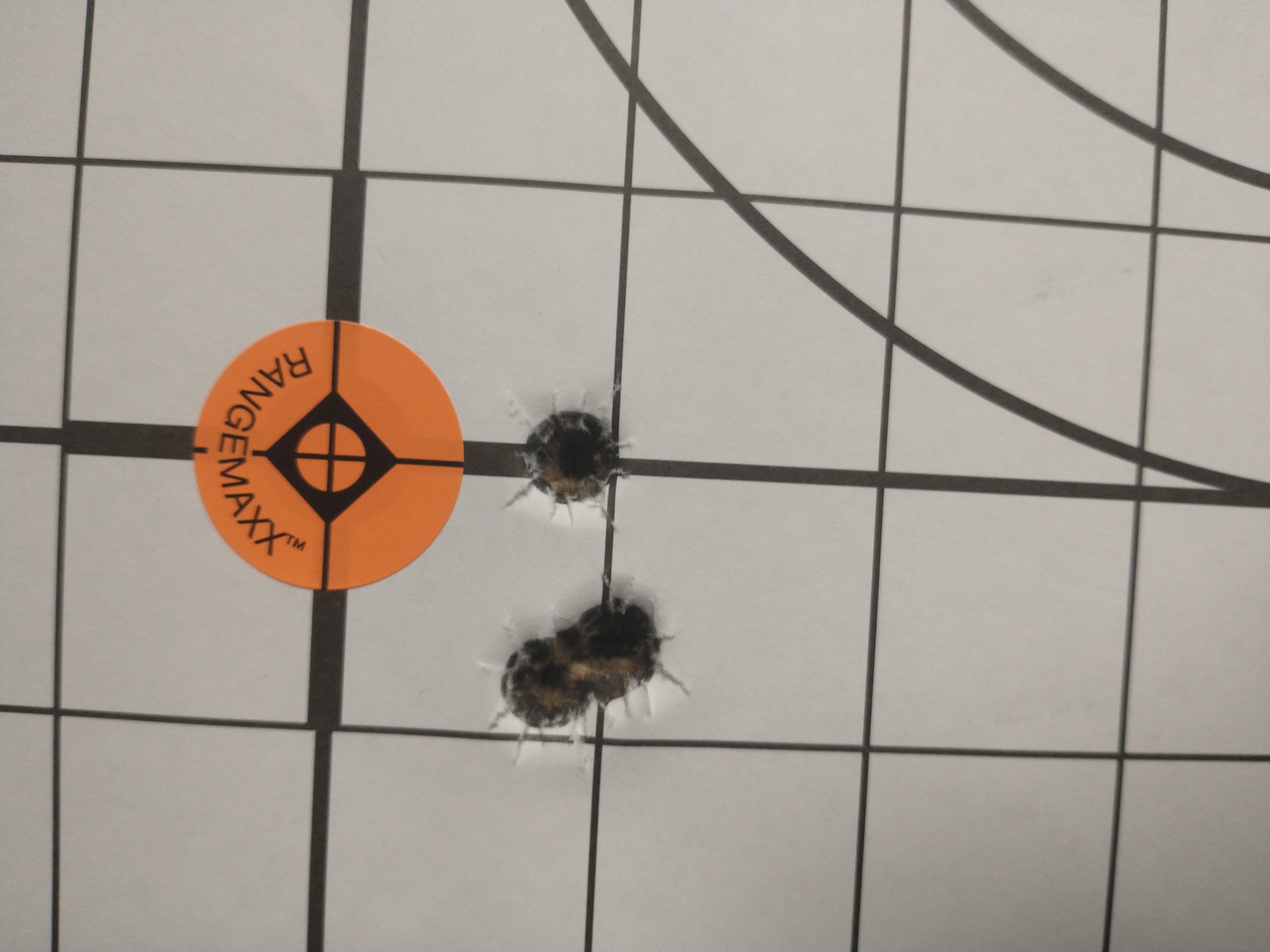

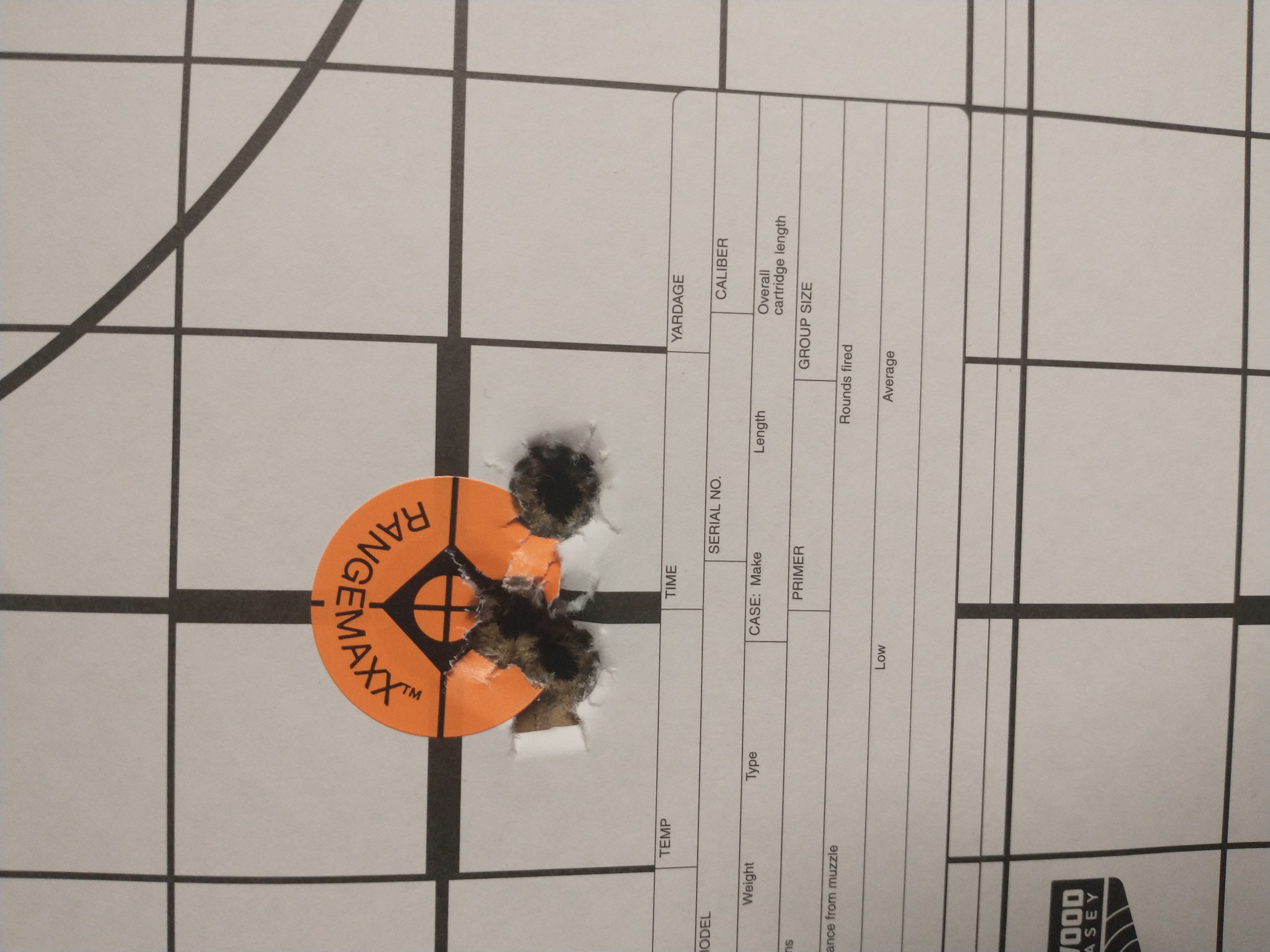

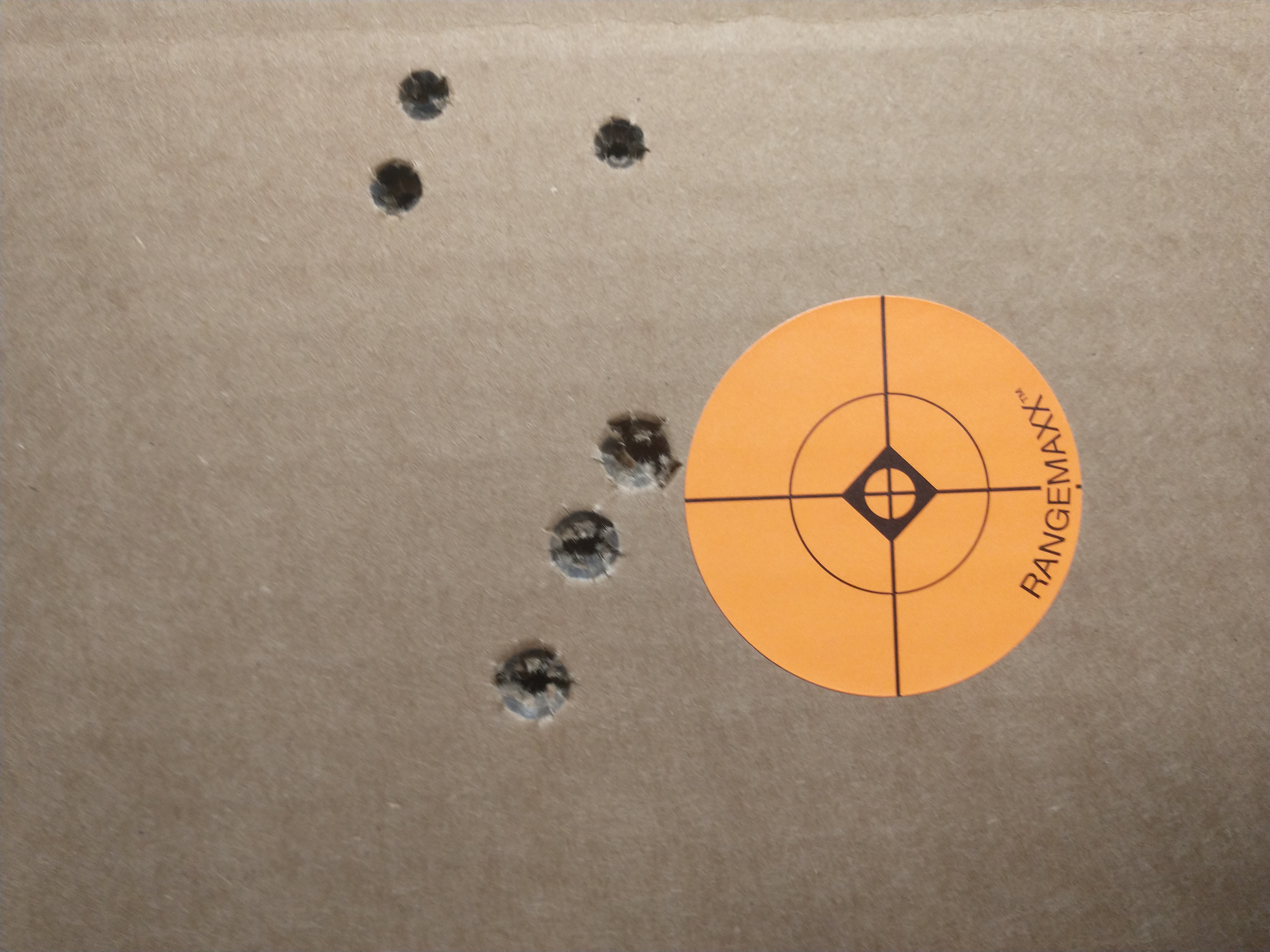

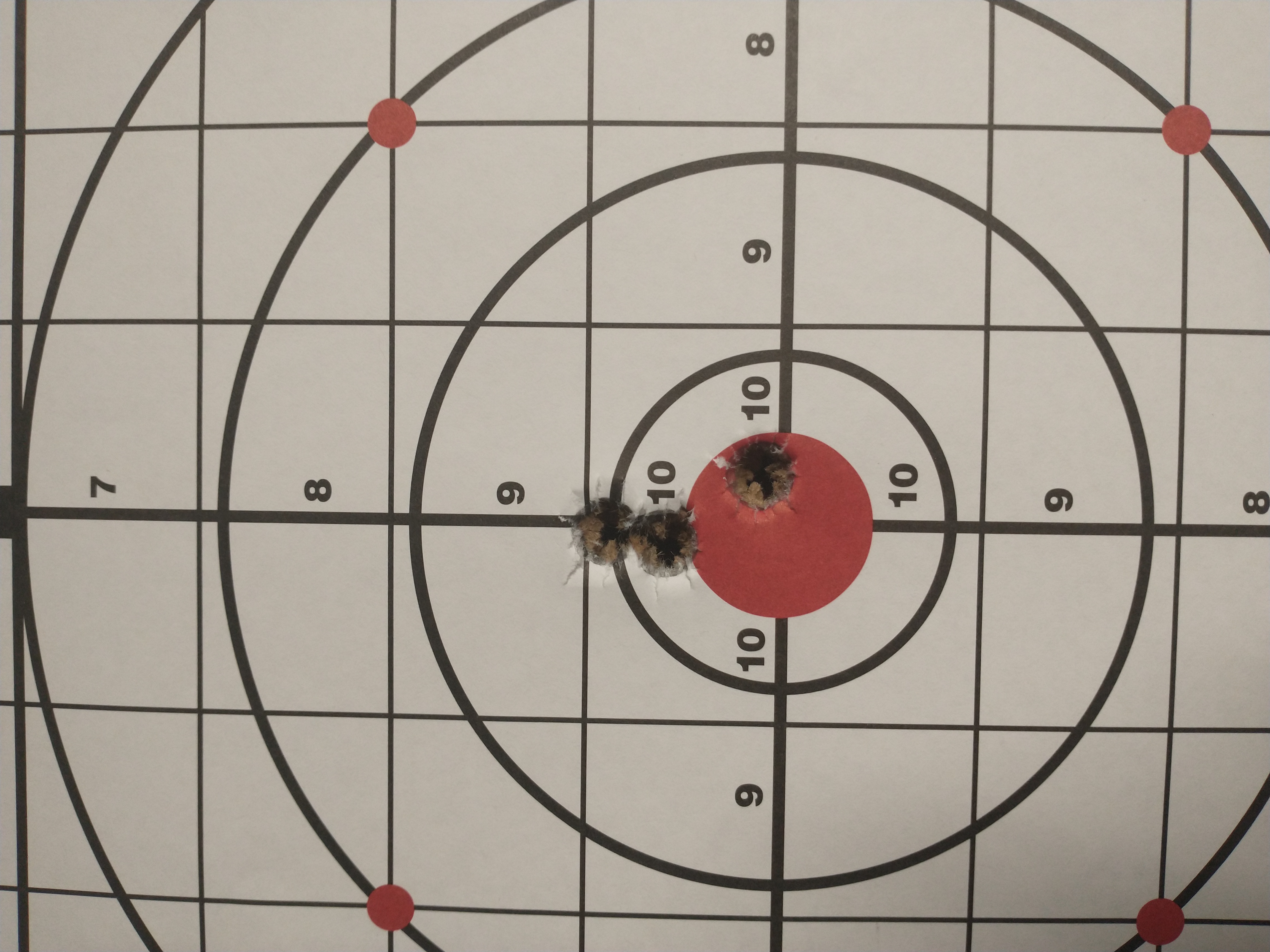

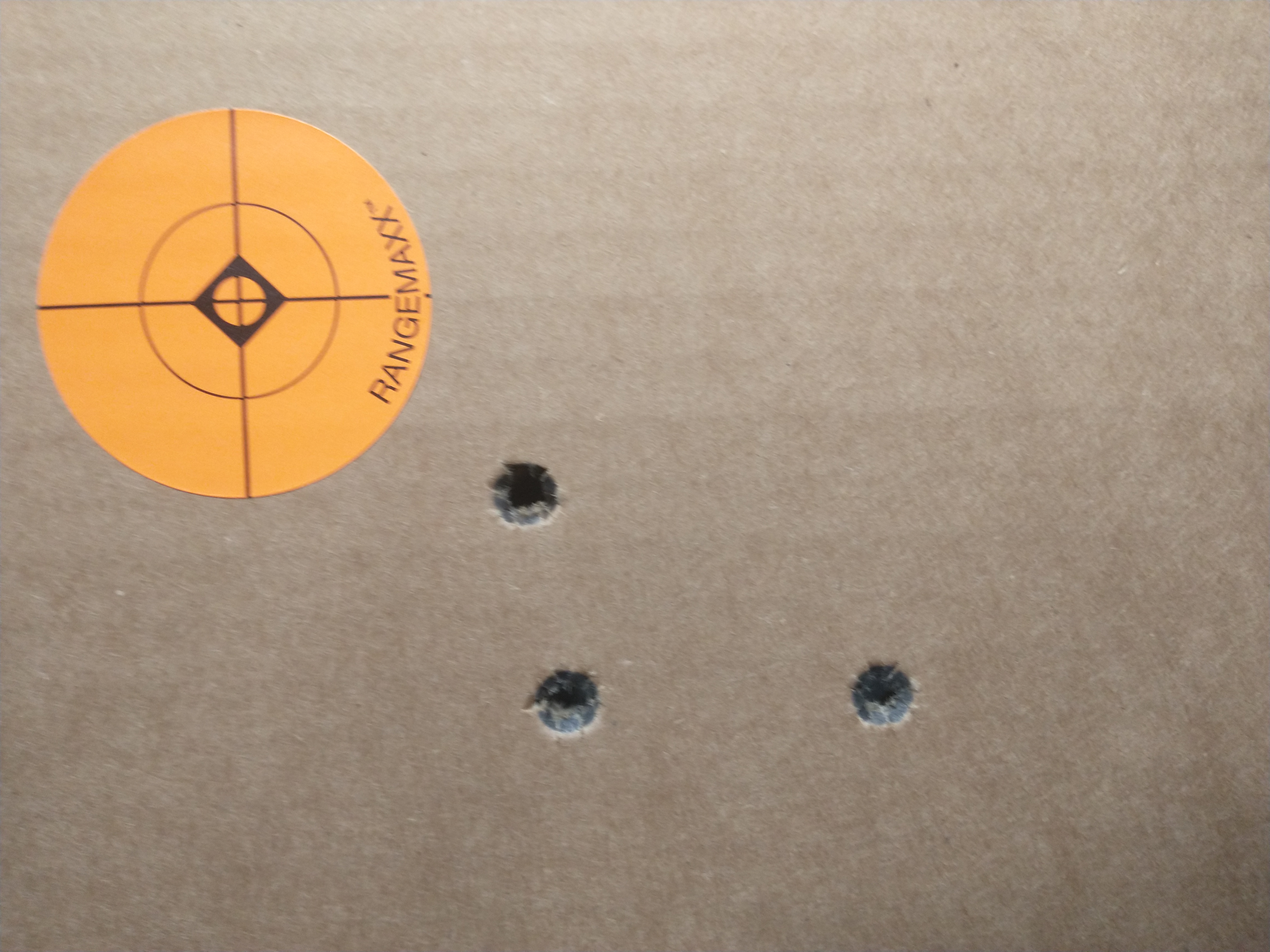

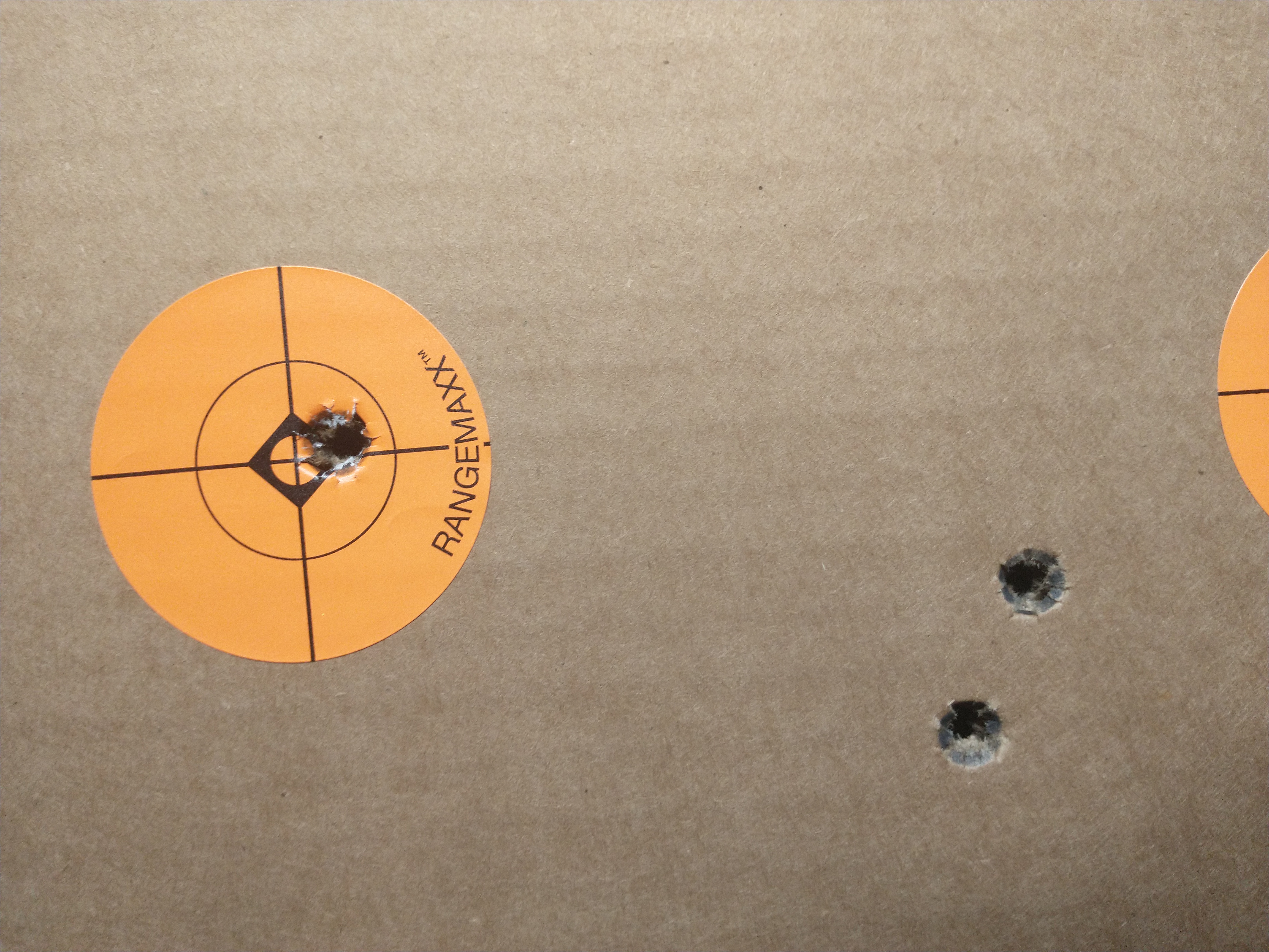

It hurt to do, but I picked up a couple boxes of Winchester 150gr XP to test out. I had an old box of the 150 XP, a couple boxes of the Win 180 PP, and a couple boxes of the Hornady 170 IL. This is a solid 50 yard gun with factory ammunition. It can be pushed further, but at 100 yards the groups start looking a bit crap. Where I nap in the woods anything past about 50 yards would be a big gamble that I am unlikely to take. Its just too much junk in the way that you cant really see in a scope. For this year, this will have to suffice for my back up. Maybe next year I will actually work up a good load for it.
Velocity results
150 XP 2240 fps
180 PP 2100 fps
170 IL 2320 fps
50 yard followed 100 yard targets.
150 XP
180 PP
170 IL
