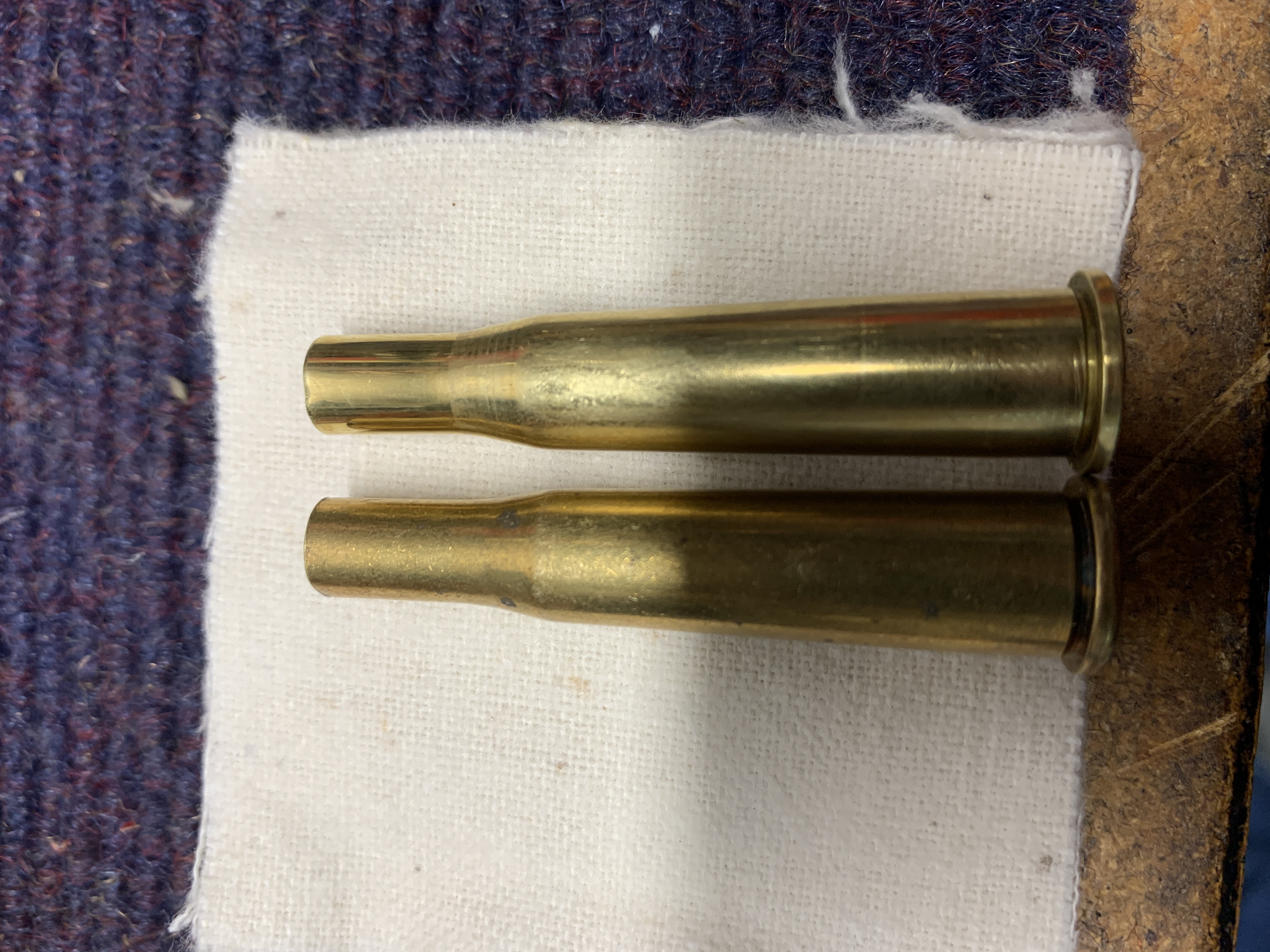

Side by side view. Factory on left, re sized 30-30 on right. Pretty clear the shoulder is not setting back far enough. Lee die, wondering if I should try another brand.
Thought?
Posts: 3903
Re: case forming
I’d call Lee, as that’s not even remotely close.

Re: case forming
So I did a little experiment.! Thought I'd try resizing a .30-30 case to 25-35, just for science!! I have a lot of .30-30 case since I often resize them for other rounds, like .32-40 and .375 Win. without problems, except they come out a little short but still work! I have RCBS dies for the .25-35, lubed a .30-30 case and ran it in the sizing die. I had to grunt a little bit to size it, but it came out perfect, just a little long, by .050 compared to a factory case. Although it doesn't look like it in the picture, the shoulders are the same, and it chambered nicely in my .25-35. There are some stretch marks, but no wrinkles!
