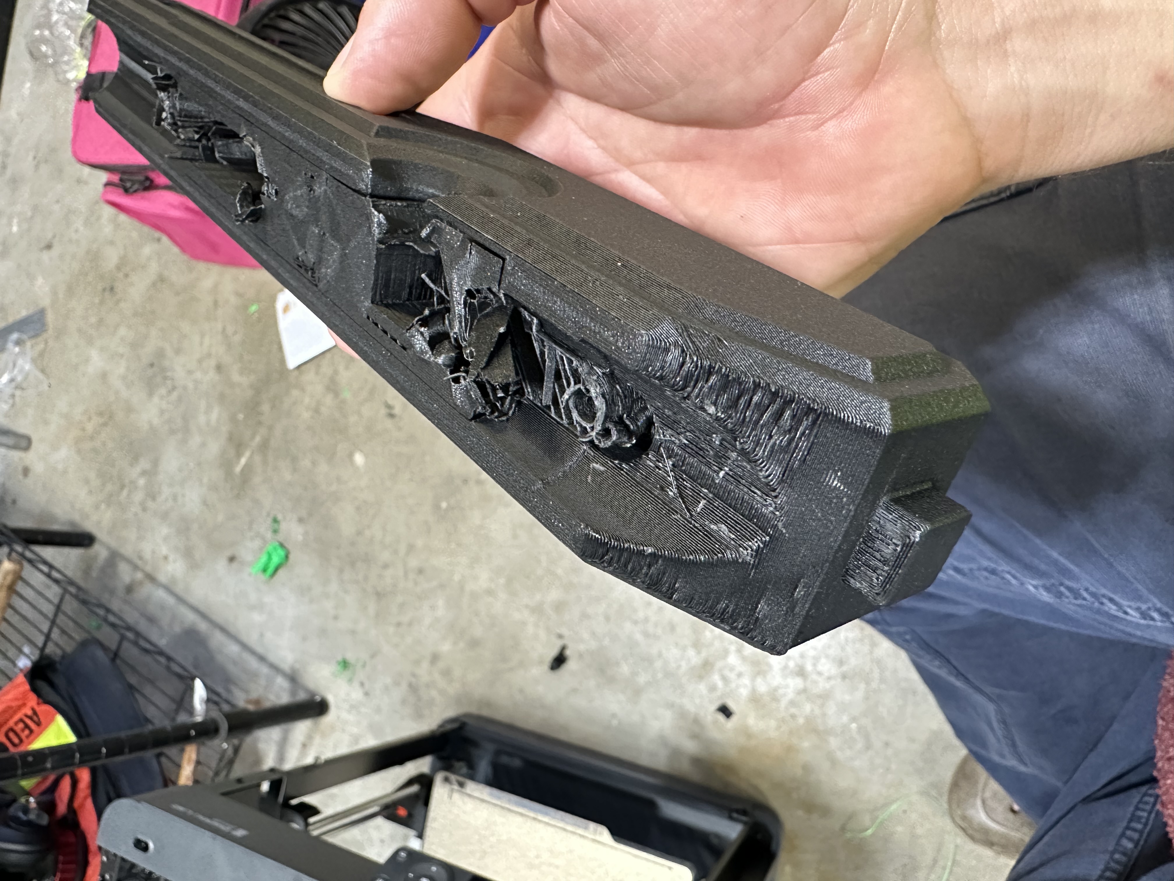

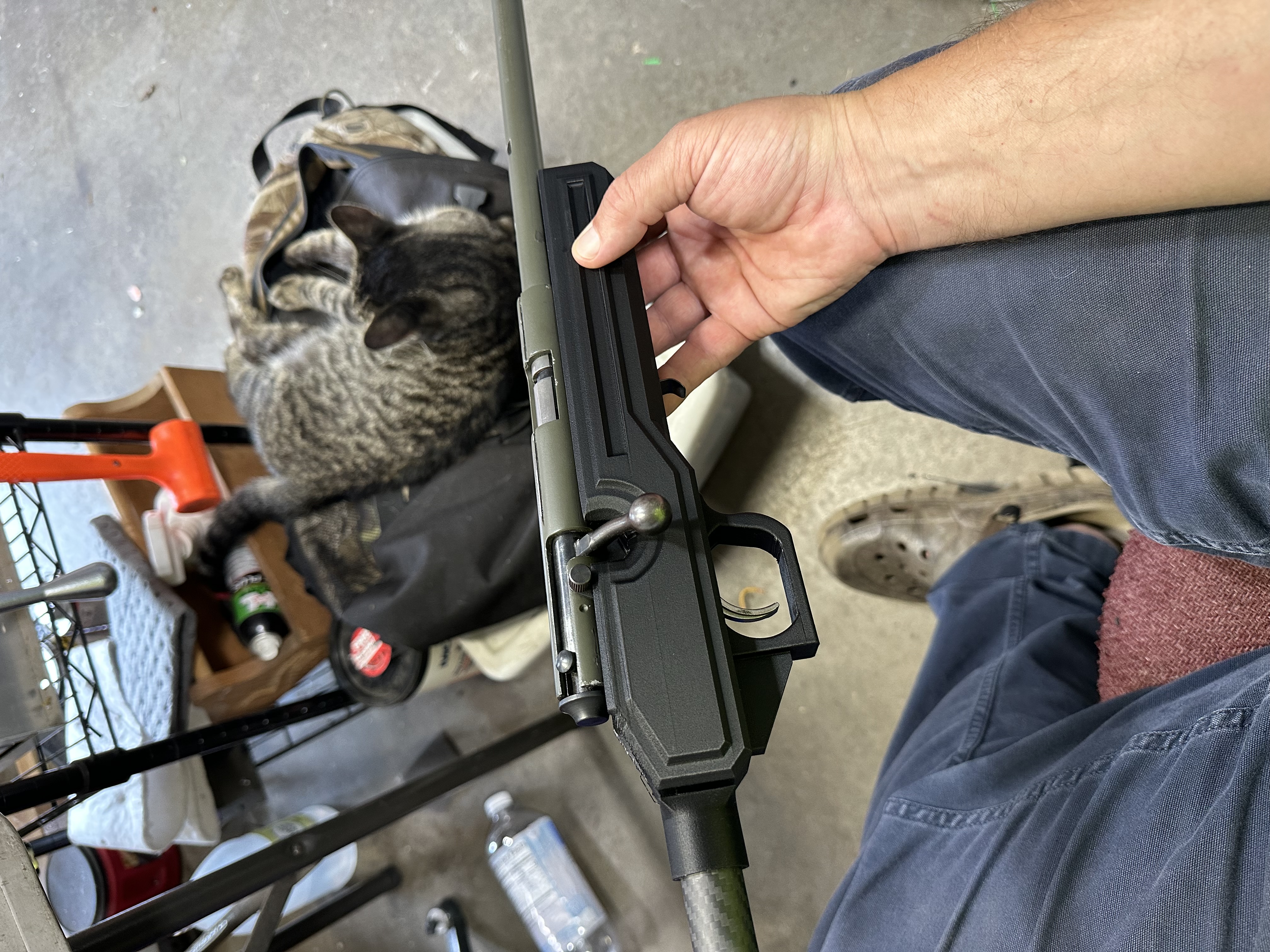

Whipped up a chassis for my old crusty Savage Mark 2. The original design was made for an accutrigger model.
Mine isn’t that.
So, I made the changes and made some prints to test the changes. Ended up with this. Not done, but very close.
Posts: 4238

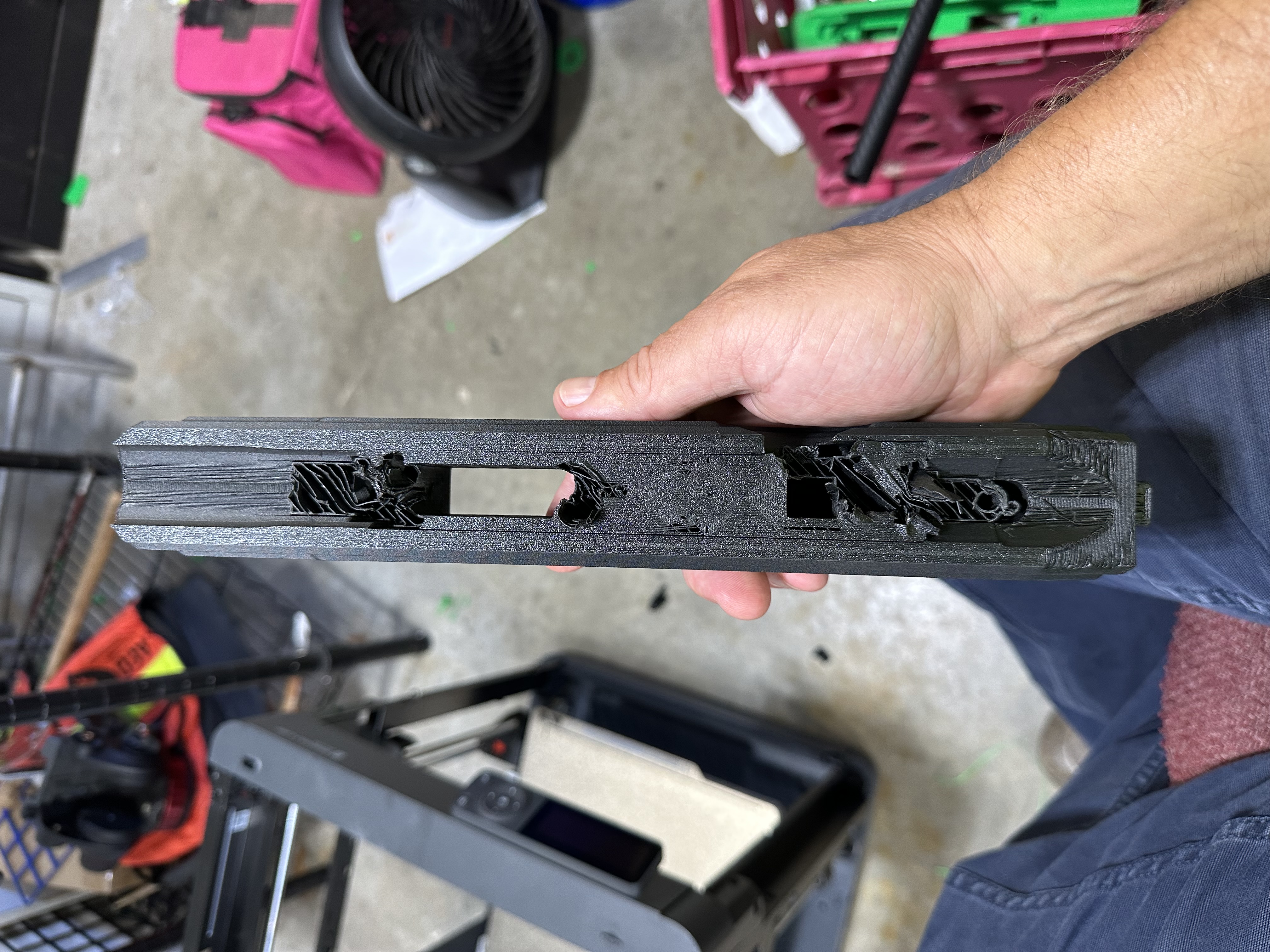

Re: 3D printed chassis.

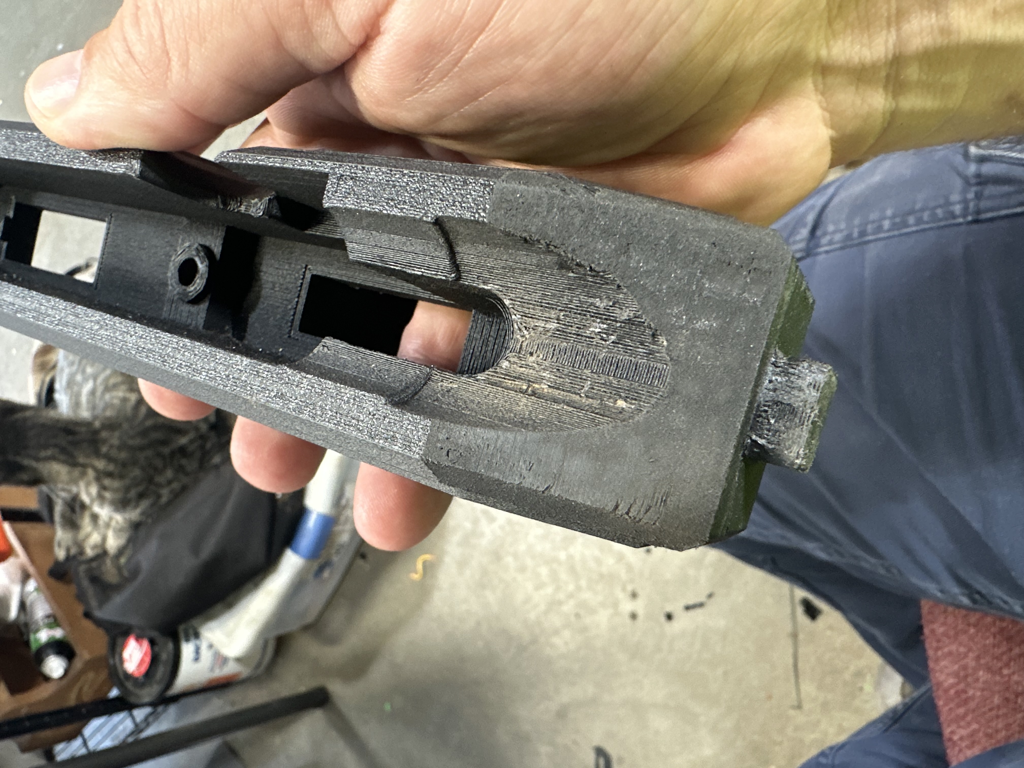

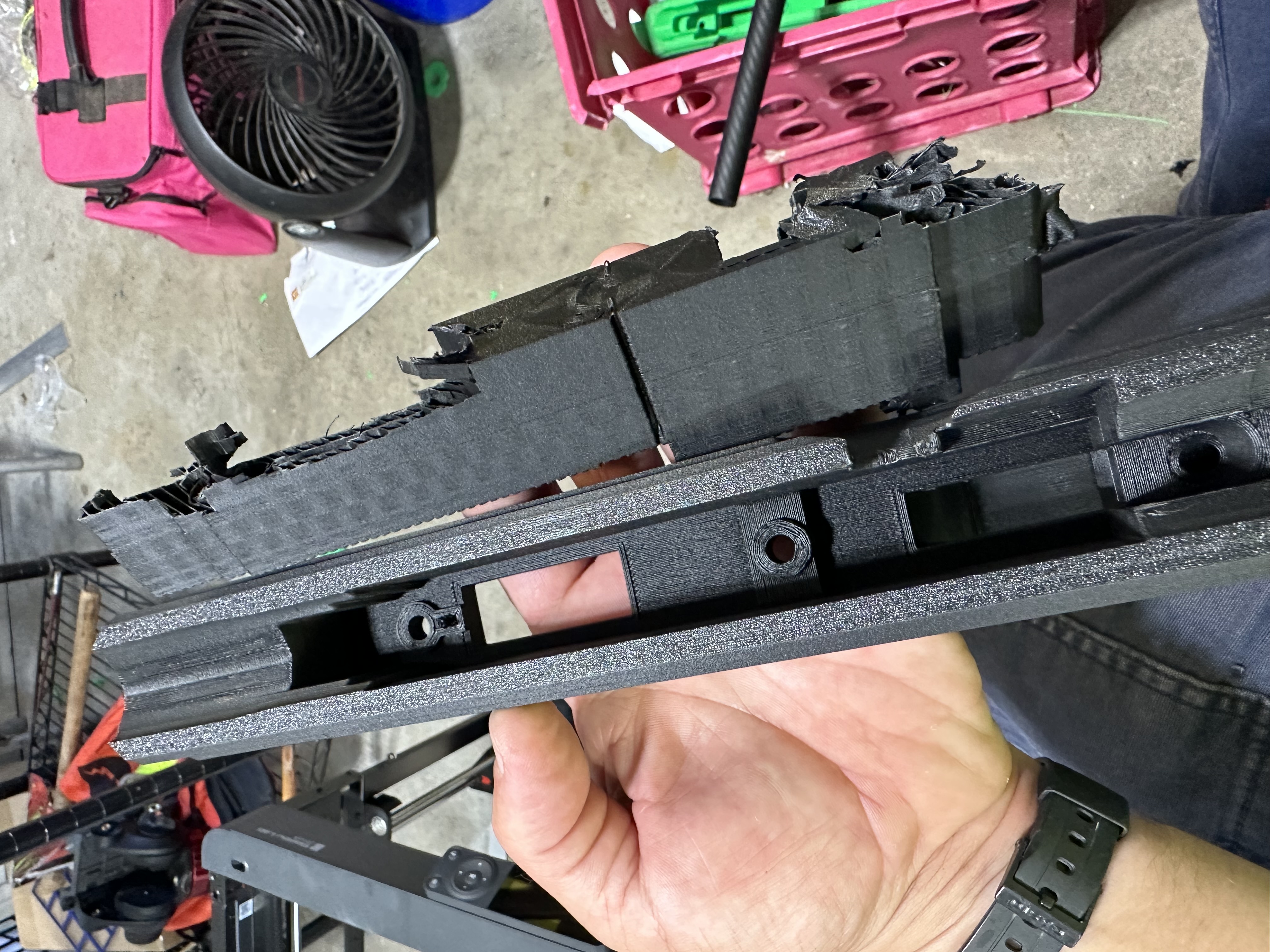

This was printed upside down, so the printer adds support material to the bed so that that it can support the print as it arches over.
This could have came out in one piece had I done it correctly.
Posts: 4238
Rear looks like ass. Something with the support isn’t bueno.
So I sanded it. It will work for a test bed.
Posts: 4238
Printing in pieces is an excellent way to get around using support, and makes for better prints when the part is in an ideal position. Just add features to key them together.

Looks good. What was the print time? Also, I had support issues like that and it turned out that my base layer was too high so they didn't adhere everywhere they should have.

Making 2 pieces and attaching them later would seem to make sense.
Posts: 4238
Justsomedude wrote: ↑Mon Sep 25, 2023 11:28 pm Looks good. What was the print time? Also, I had support issues like that and it turned out that my base layer was too high so they didn't adhere everywhere they should have.
5 ish hours.
That’s like 20 in Ender time. 😬
Not sure what’s the deal with the support, everything *should* be fine.
I sanded it smooth-ish. It’ll work forever, or till I re print it.
PFD45 wrote: ↑Mon Sep 25, 2023 11:39 pm Very interesting pictures and progress report.
Say you print a coffee cup. You want it vertical. Like the cup sets. The print head just spirals around pooping out plastic in a circle and gets higher with each turn.
But lay it horizontal, and there has to be support material what for it to print upon. And it WONT be round. may work for some things, but not this. Hence the two pieces.

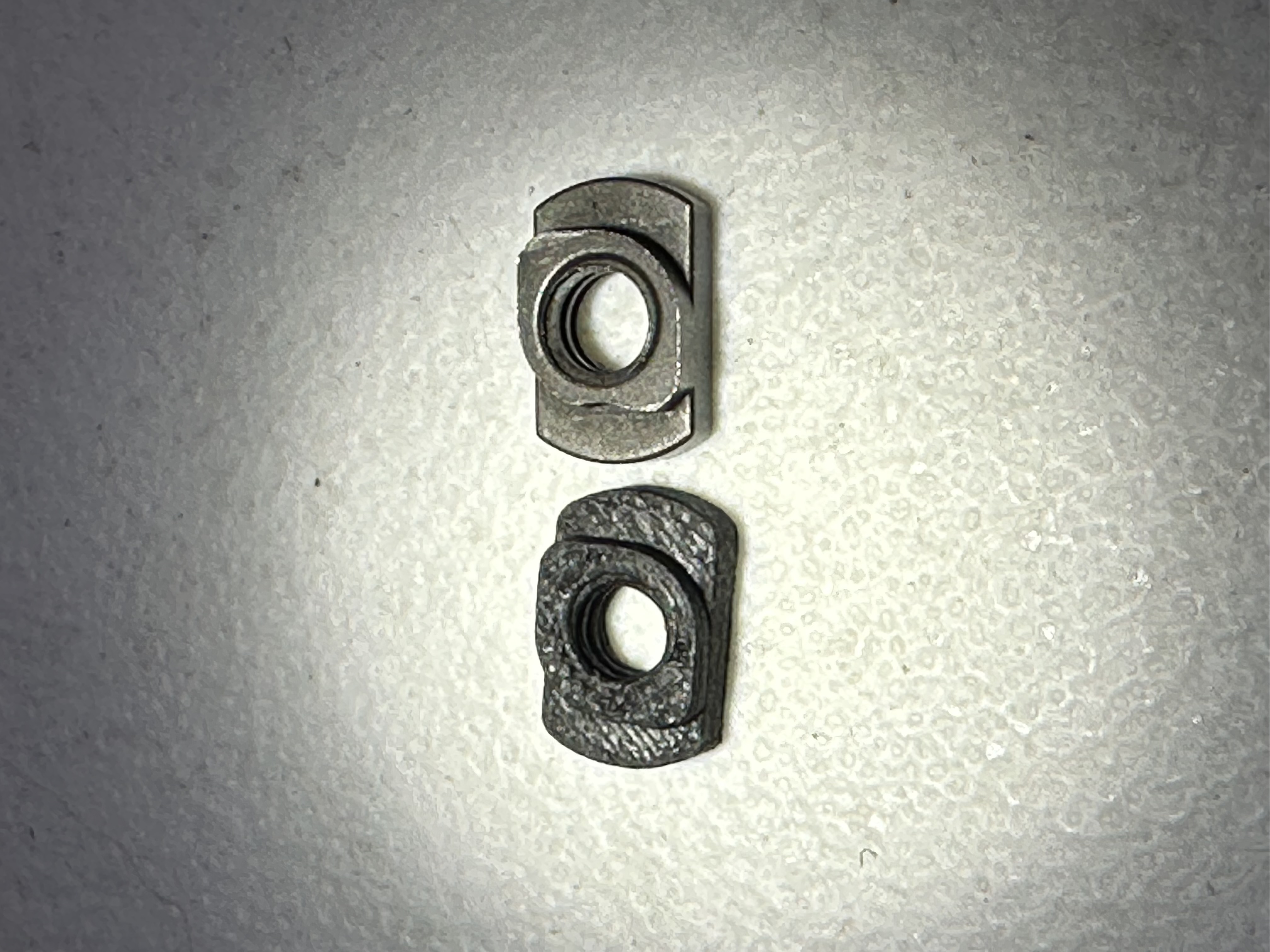

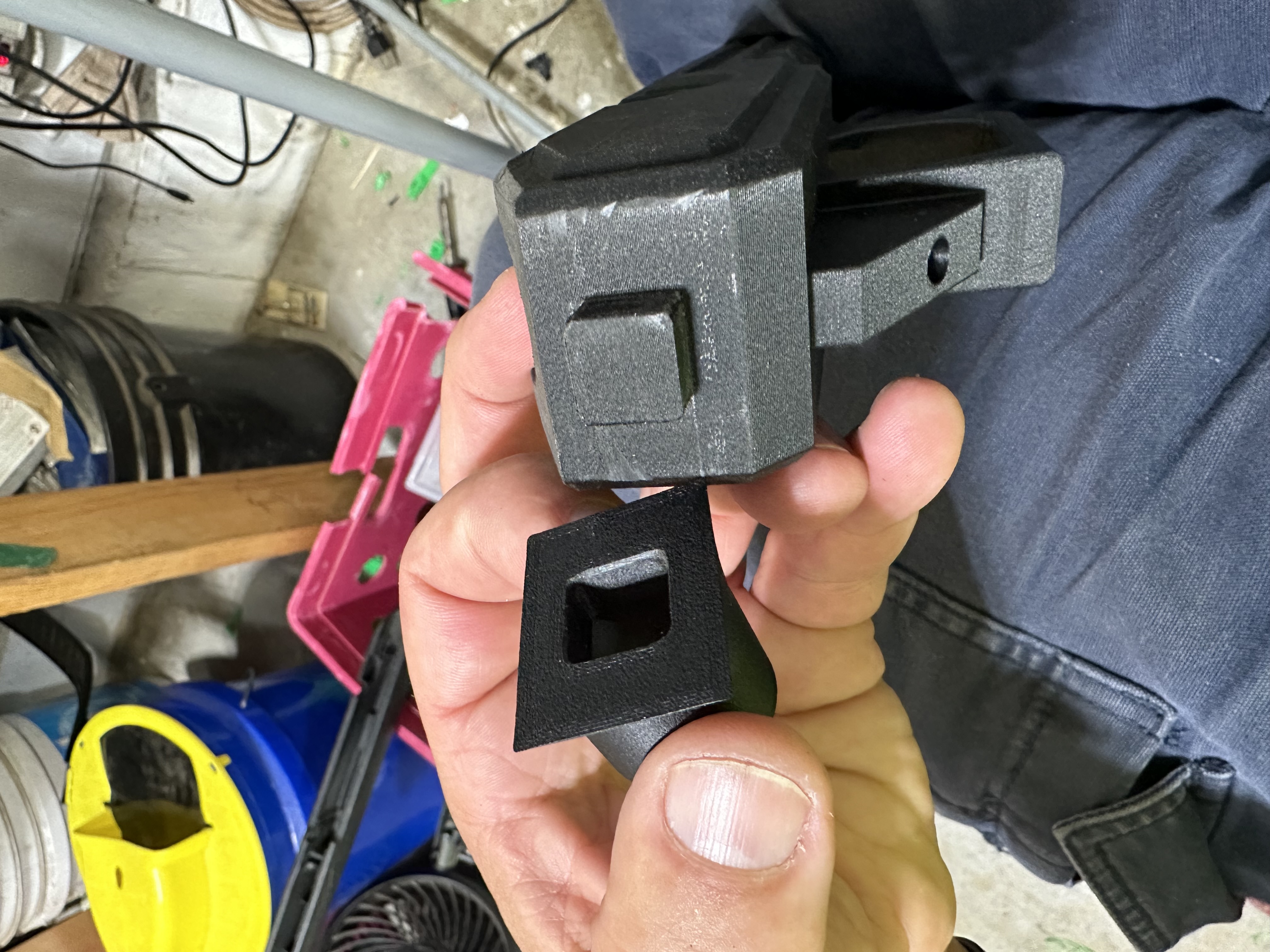

I made some M Lok hardware also. Not exact, but it works. Don’t have a 10-24 tap on hand to chase the threads, so I’ll just dial the fit in with software.
That's a really good thread print. I've yet to print any threads but read that layer height is the difference between good and bad ones. Your printer does a helluva job but I don't know that I could justify changing out what I have for now. You ought to look into printing the stronger materials, mostly just because I wanna know how it handles them 😁

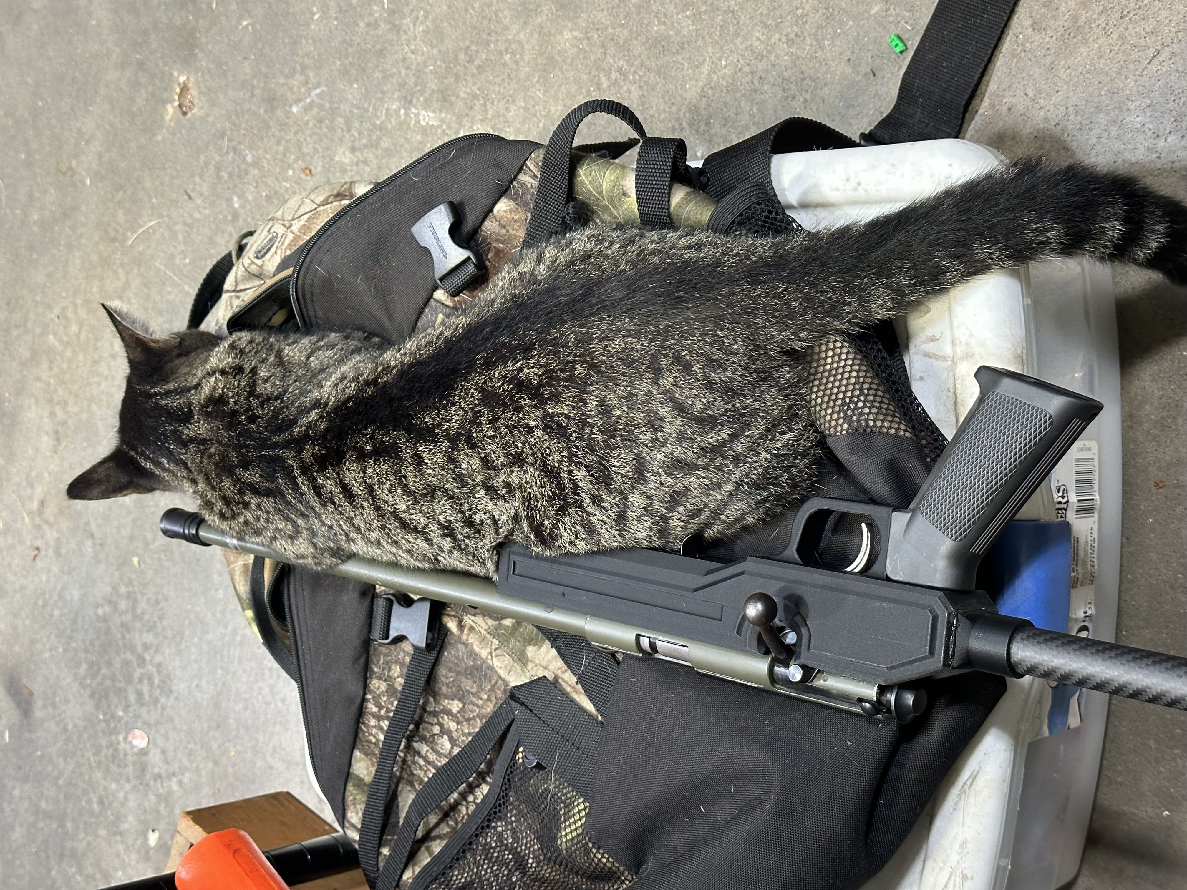

What's your helper there up to?
Justsomedude wrote: ↑Tue Sep 26, 2023 12:49 am That's a really good thread print. I've yet to print any threads but read that layer height is the difference between good and bad ones. Your printer does a helluva job but I don't know that I could justify changing out what I have for now. You ought to look into printing the stronger materials, mostly just because I wanna know how it handles them 😁
This is carbon fiber PLA.
Handles it with ease.
Layer height helps, but I just walked the thread diameters out by .008 software. The software makes it exactly what you draw. The printer is of course gonna squirt what it squirts, but not exact. Making them a bit big allows for that.
I’ve done 1/2-28 threads that threaded on. They were tight, but they went. That’s without any tweaking.
Gila wrote: ↑Tue Sep 26, 2023 1:04 am
CPJ 2.0 wrote: ↑Mon Sep 25, 2023 11:16 pm Whipped up a chassis for my old crusty Savage Mark 2. The original design was made for an accutrigger model.
Mine isn’t that.
She was supervising.
Now she’s on security detail.

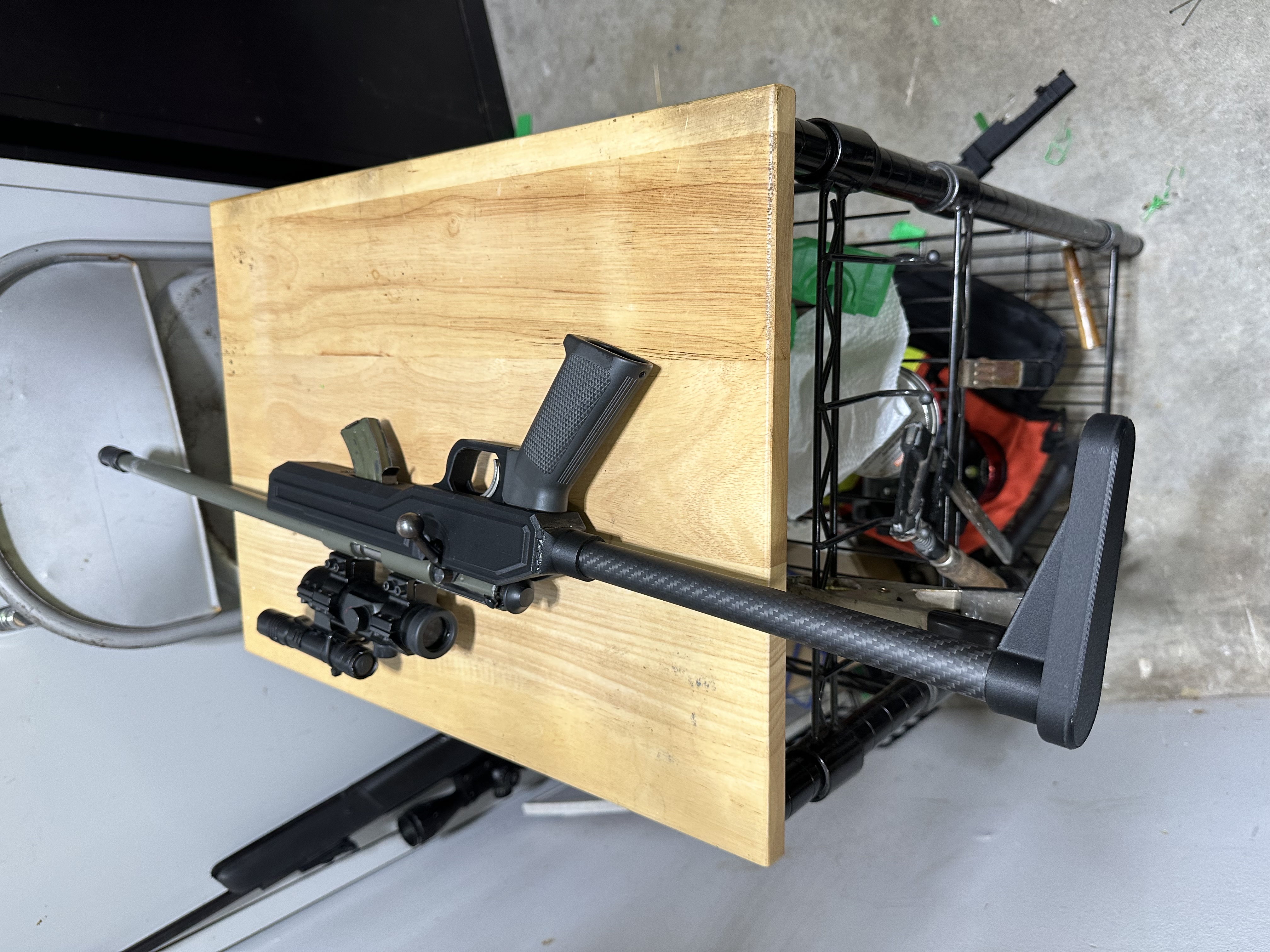

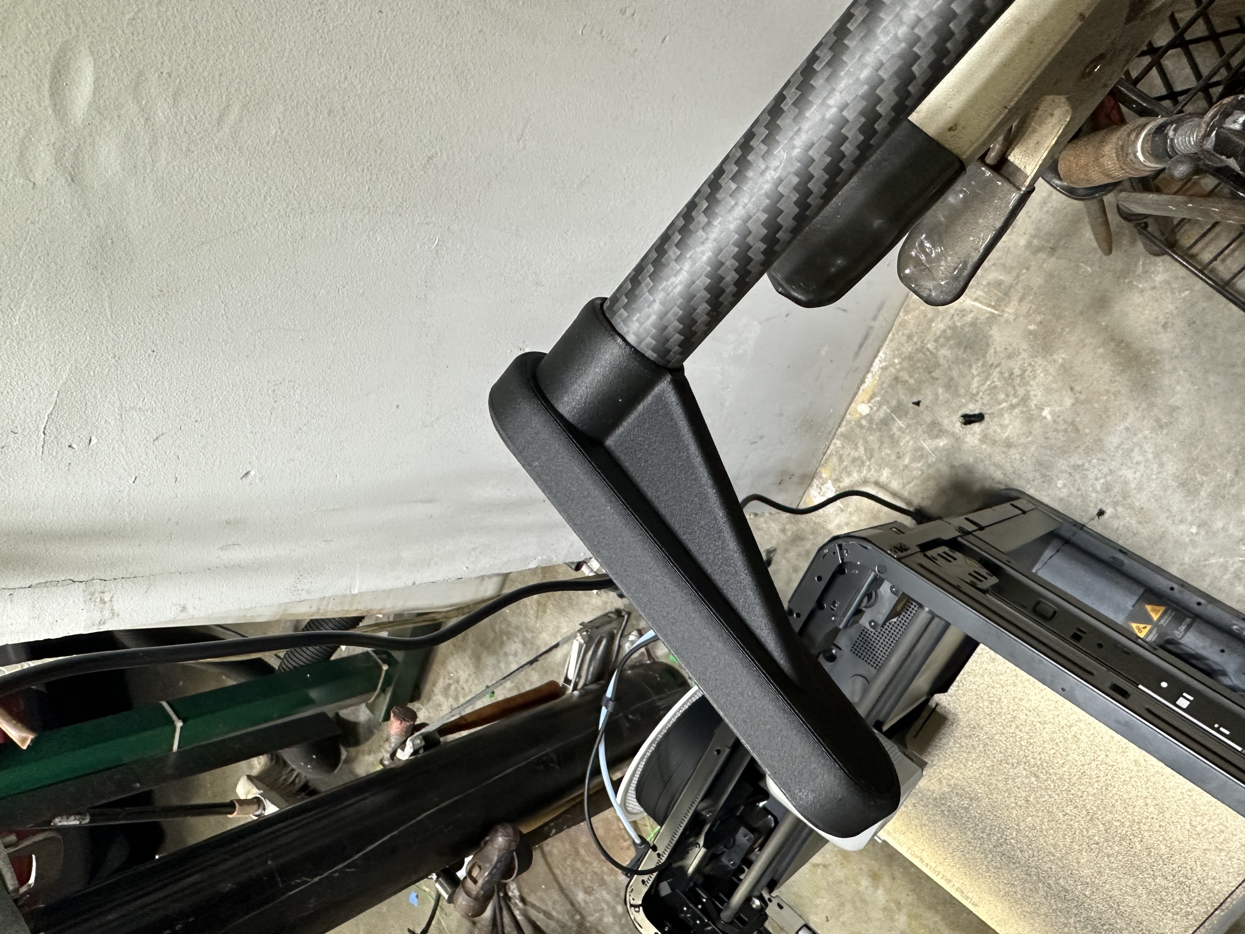

Japhy wrote: ↑Tue Sep 26, 2023 2:11 am CPJ that is nice work! From design to the end product
Thanks, but I can’t take full credit. At least for 98% of it, the actual functional part. 😬 The original model had a 1913 rail on the back what for clamping a folding stock. I had carbon fiber tube, so I made that design change.
Butt plate is cooking as we type.

Posts: 4238
I need to repaint the metal, but that’s a project for another year. This guns purpose is for small furry things what go bump in the night.

That is pretty Kool. Will the product hold up to larger calibers?
Posts: 4238
Diver43 wrote: ↑Tue Sep 26, 2023 4:22 am That is pretty Kool. Will the product hold up to larger calibers?
.223, certainly.
Anything larger? Meeeeehhhhh not so sure.
Ive pondered it.

That rifle would look much better with a wood stock and proper scope...
Posts: 4238
Posts: 1803
That will work. Is the stock permanently anchored or take downish?
