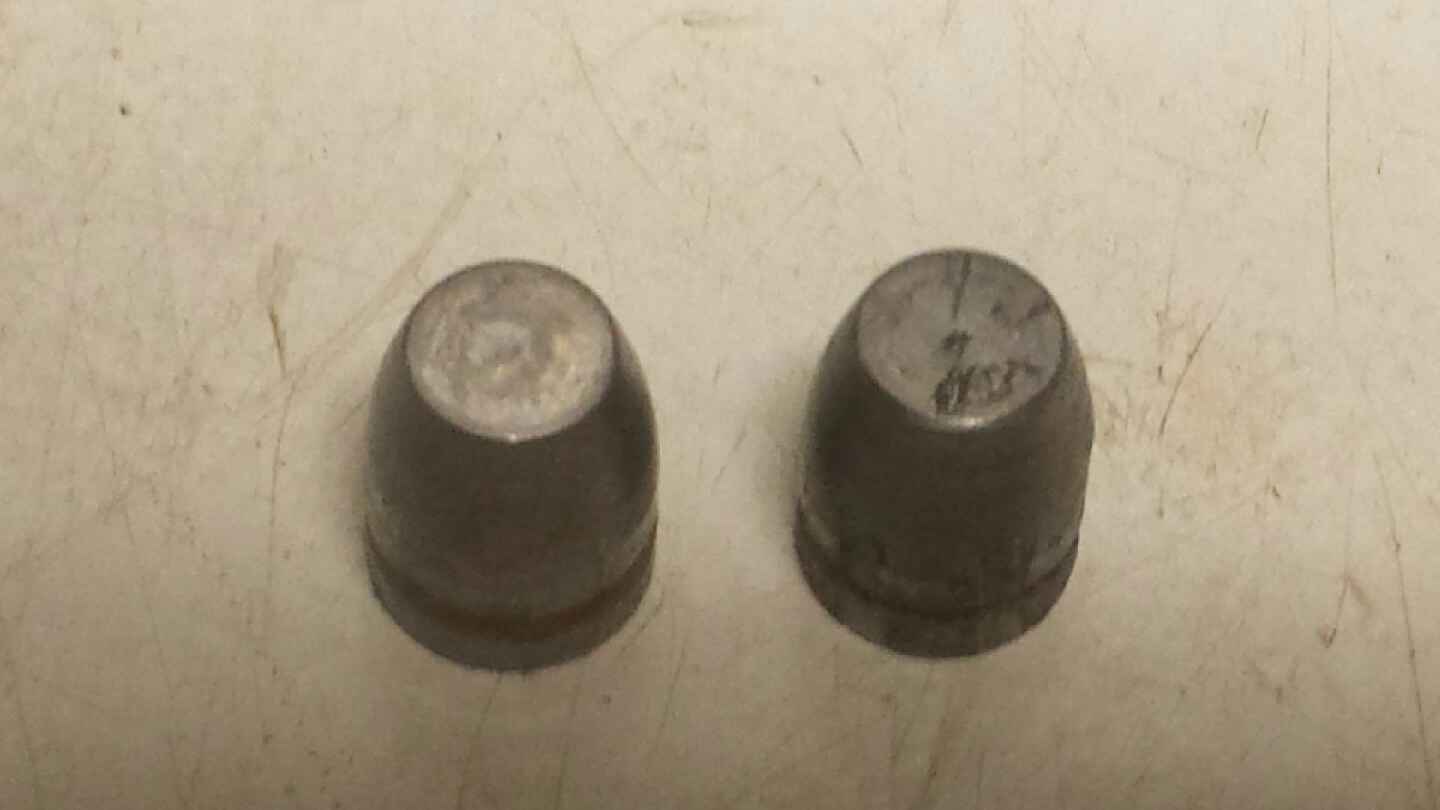

Buford, the big question is are you loading to shoot for known-distance, flat trajectory for UNKNOWN distance, or for meat?
With the harder alloys you'll want for cast bullets in these 45 Colt +P /+P+ loads, you won't be seeing much for expansion, and I don't think you'll find a broadside shot in North America that will stop a medium/large meplat 275 grainer fired at over 1100 fps. For sake of reference:
LBT 452230 LFN Jug Test.jpeg (36.49 KiB) Viewed 3017 times
That's 230 grains of 830 fps 1911 fodder after passing through eight gallon milk jugs and stopping in the ninth. You do NOT need to rattle windows three blocks away with your launch for sufficient game penetration.
If you're trying to knock over steel plates at specific distances in the silhouette game, you need a certain level mass and momentum, but not necessarily all the velocity you can eke out, since there it becomes a matter of knowing the holdover at each distance.
Flattening the trajectory for unknown hunting distances can be accomplished by going lighter and faster with the bullet.
It's always worth remembering that the secondary function of both the .45 Colt and .45 ACP was to put down a HORSE. It doesn't take a lot to convince me of the need for A LITTLE more than those rounds have to offer, but the loads that risk separating local geologic fault lines - ummmm. . .not so much.
