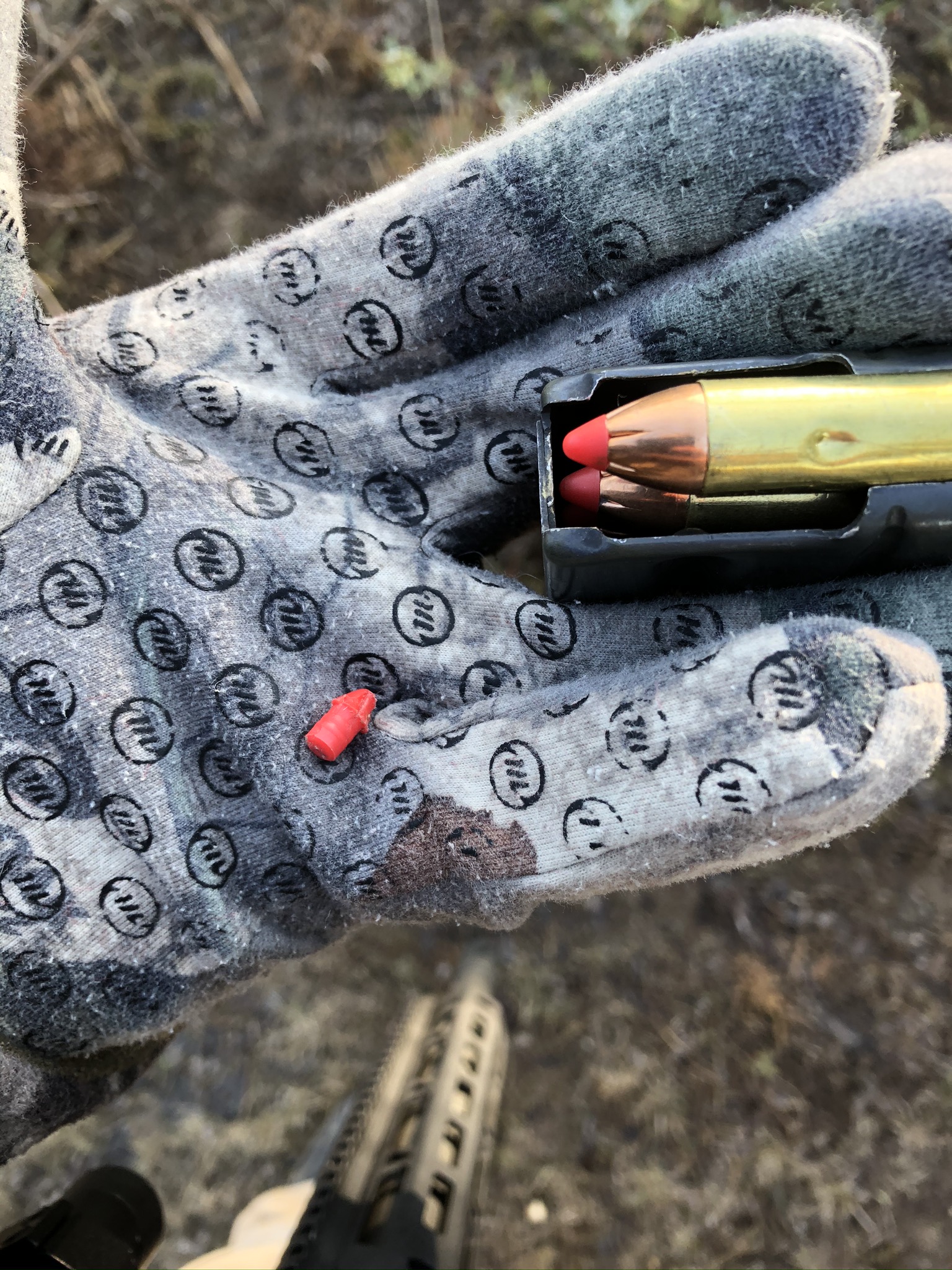

I use the FTX bullets in my 450Bushmaster upper. Never recovered a bullet, but they have all been 100% perfect performances with massive destruction and tracked straight through the animal. I think I have shot 3 deer with it. Two bang-flops and one that I had to track about 50 yards.
On the 1 deer I had to track, I did find.. just the tip… about 20 yards back from where the bullet exited the deer’s chest. Let me see if I can find the pic

Found it:

On my dads doe the plastic tip didnt even make it into the chest cavity. We suspect the front of the bullet just flew apart just after it make it through the hide. That is about what the one he found looked like.
