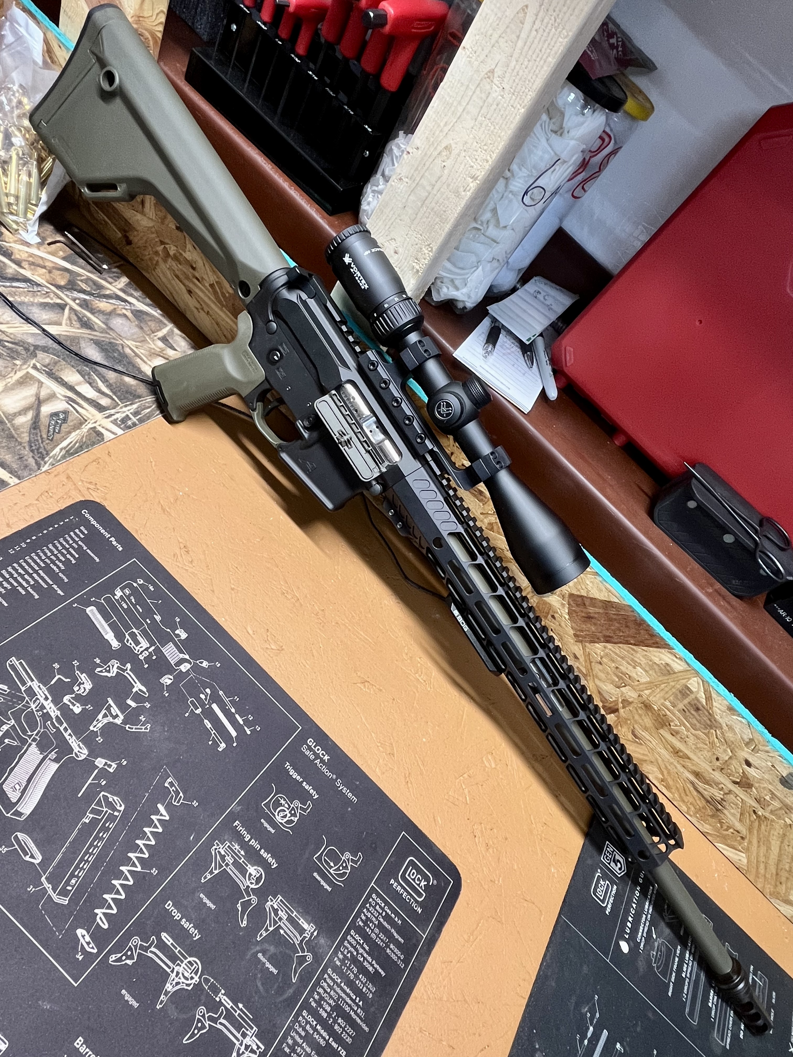

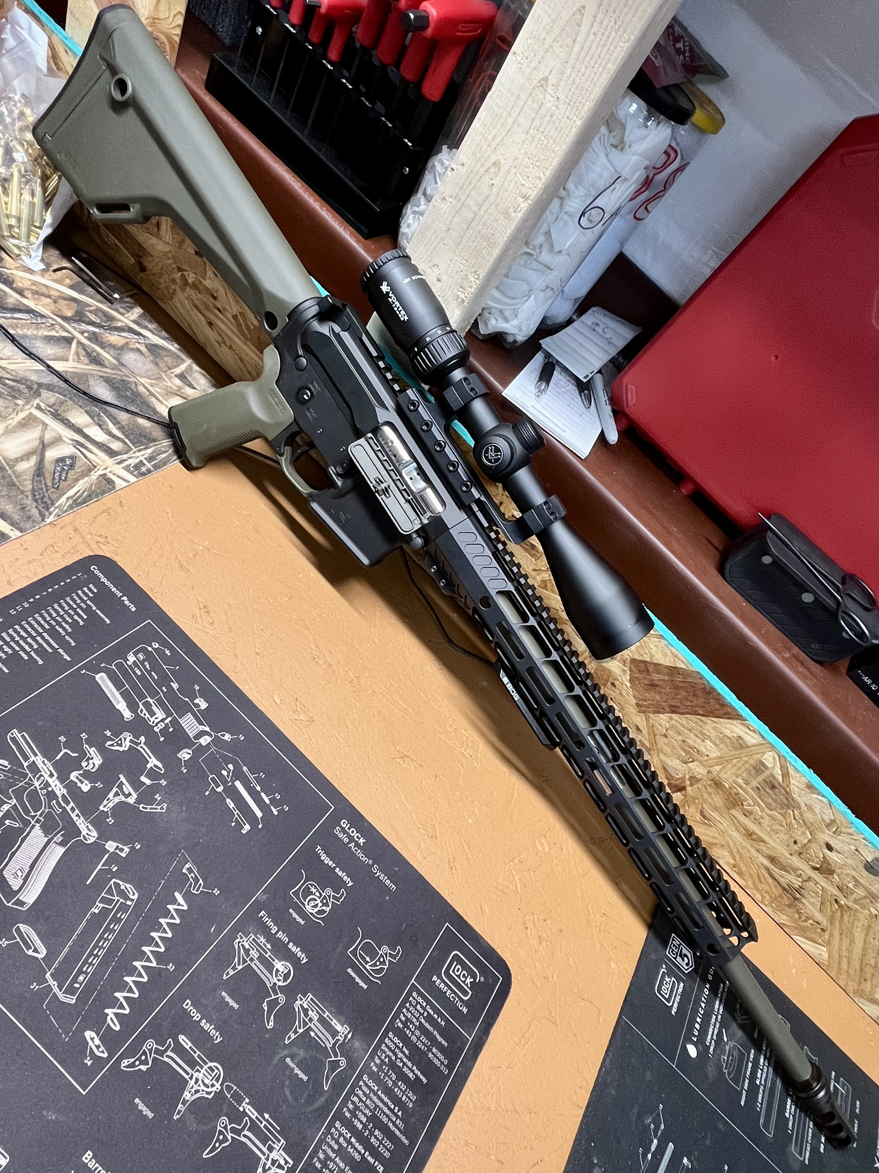

Back in August I started on a quest for a fast cartridge, AR platform, for predator and varmint hunting. Mainly for coyotes. It’s been an itch I’ve been wanting to scratch.
After getting some advice and learning a little about the options, I decided to go with the 20 Practical. The main deciding factor there was, it’s based on the 223 Remington case. So brass is plentiful. And, unlike the similar 20 Tactical (aside from having a stupid name), the 20 Practical doesn’t change the shoulder dimensions. Just the neck. Speed is right up there with the 204 Ruger. There is info out there showing this cartridge being capable of getting over 4000 FPS with longer barrels. And it uses standard AR mags.
So I settled on McGowan to make my barrel. I ordered it in August. Got it today. 20” modified HBAR profile, 10 twist. It’s a beautiful looking barrel.
Lower is Aero Precision, with a Magpul grip and stock and LaRue MBT 2S trigger. Upper is an AR Stoner billet receiver with matching 15” hand guard. Faxon ultra low profile gas block, a BOG ARCA rail and a Silencerco ASR brake finish it off.
Optic is a Leupold mount and Vortex Diamondback HP 4-16x42 scope. Pretty basic build, really.

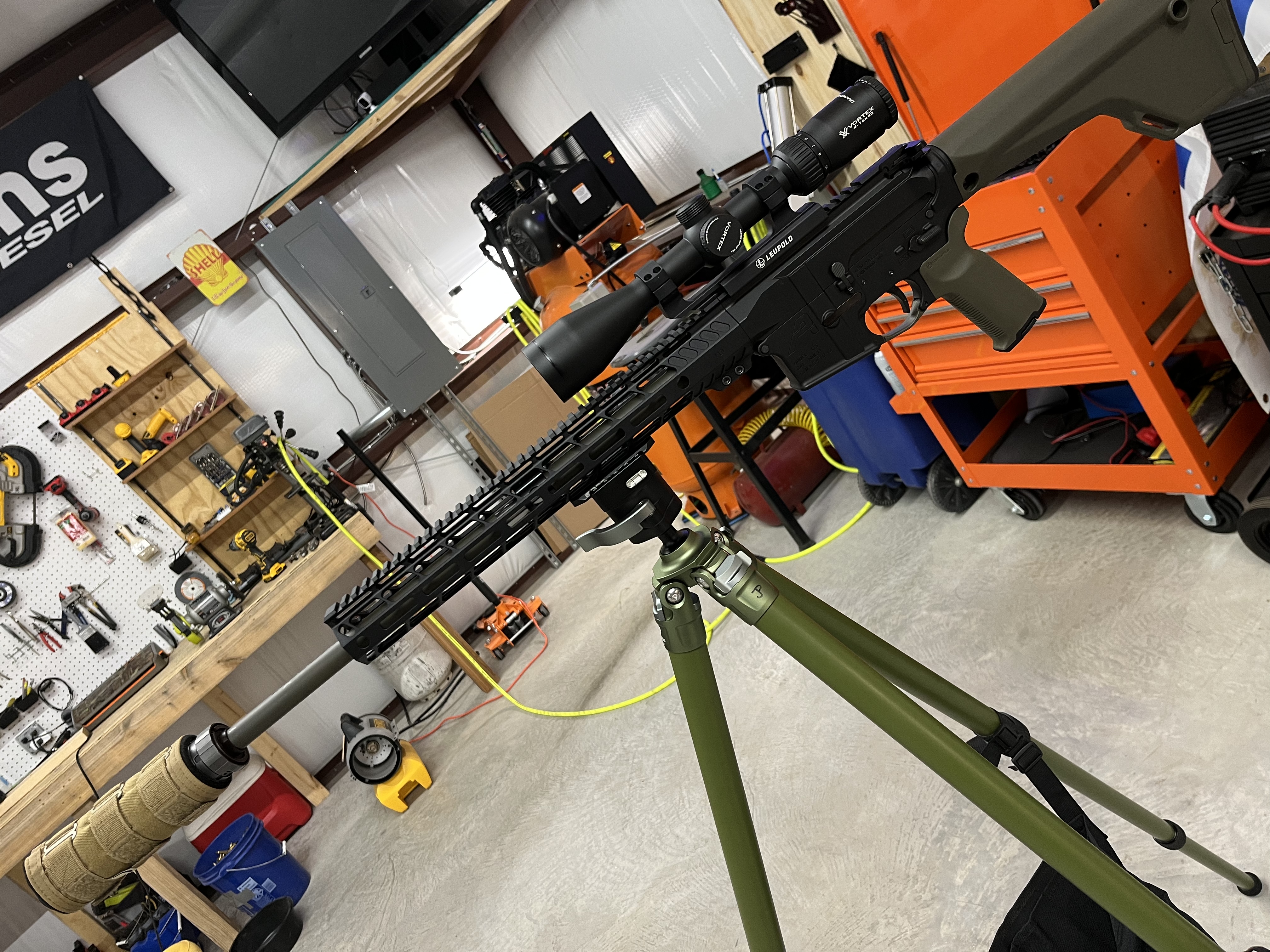

Posted: Fri Dec 15, 2023 2:51 pm
It has been a fun journey, watching this build. I knew nothing about this cartridge until now.
My French Model is growing up.
ARCA
Carbon Fiber Tripod
Two Wildcat Cartridges
I’m still plugging away on the thermal. 😎
Once you get this one loaded. I’d be interested to see what the 6x45 could do with 58gr V-Max in comparison! That’s something I never tried.
Re: The 20 Practical
Posted: Fri Dec 15, 2023 3:08 pm
Zee wrote: ↑Fri Dec 15, 2023 2:51 pm It has been a fun journey, watching this build. I knew nothing about this cartridge until now.
ARCA
Carbon Fiber Tripod
Ummm, I enabled a new barrels action and chassis, thank you very much.

I’m a big boy now!
I’ll have to see if I have any 58gr Vmaxs. I seem to recall loading them in 243 Win years ago, but not certain. If not, I’ll see if they have a box next time I go to Cabelas. That would be interesting.
