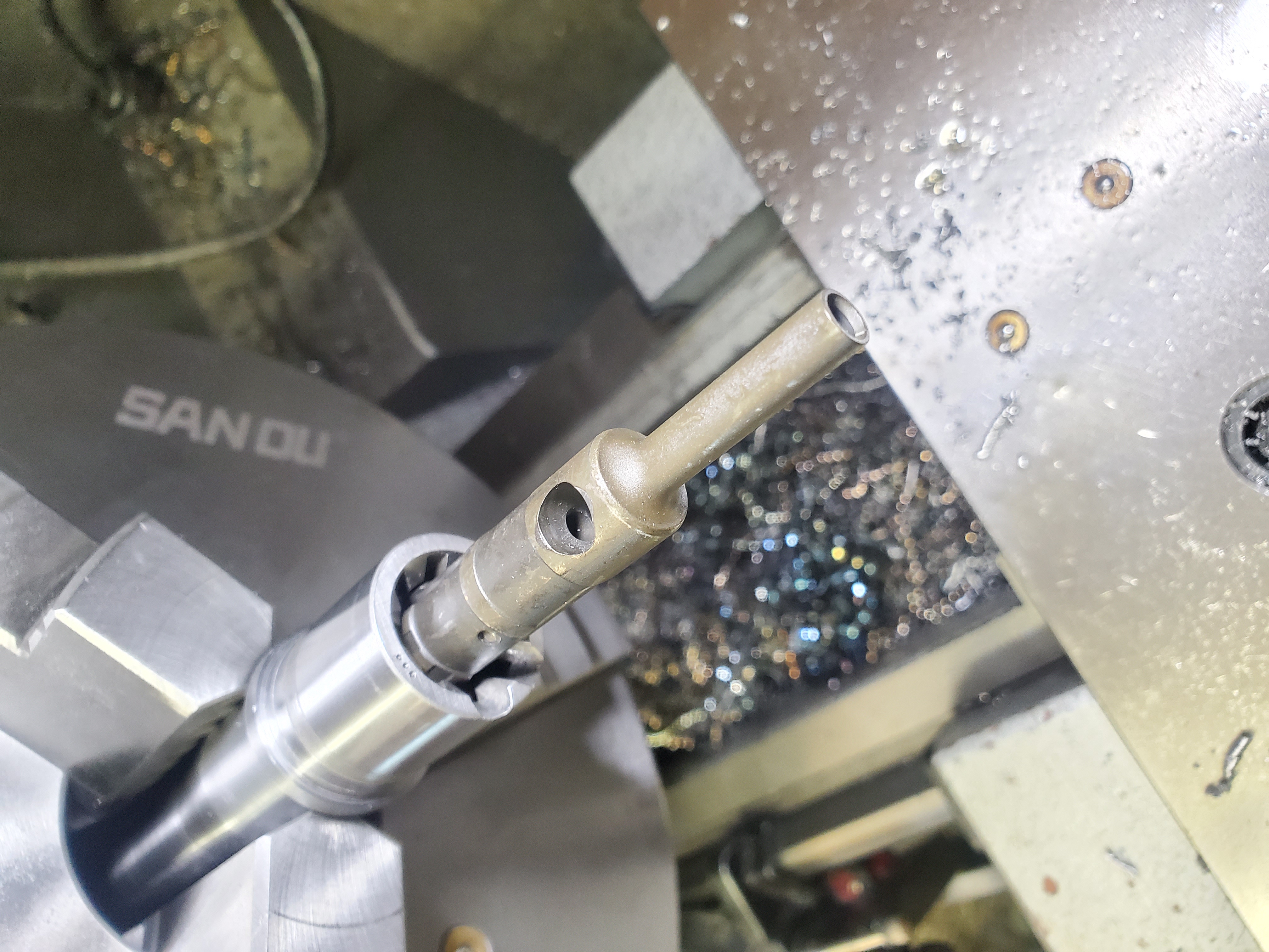

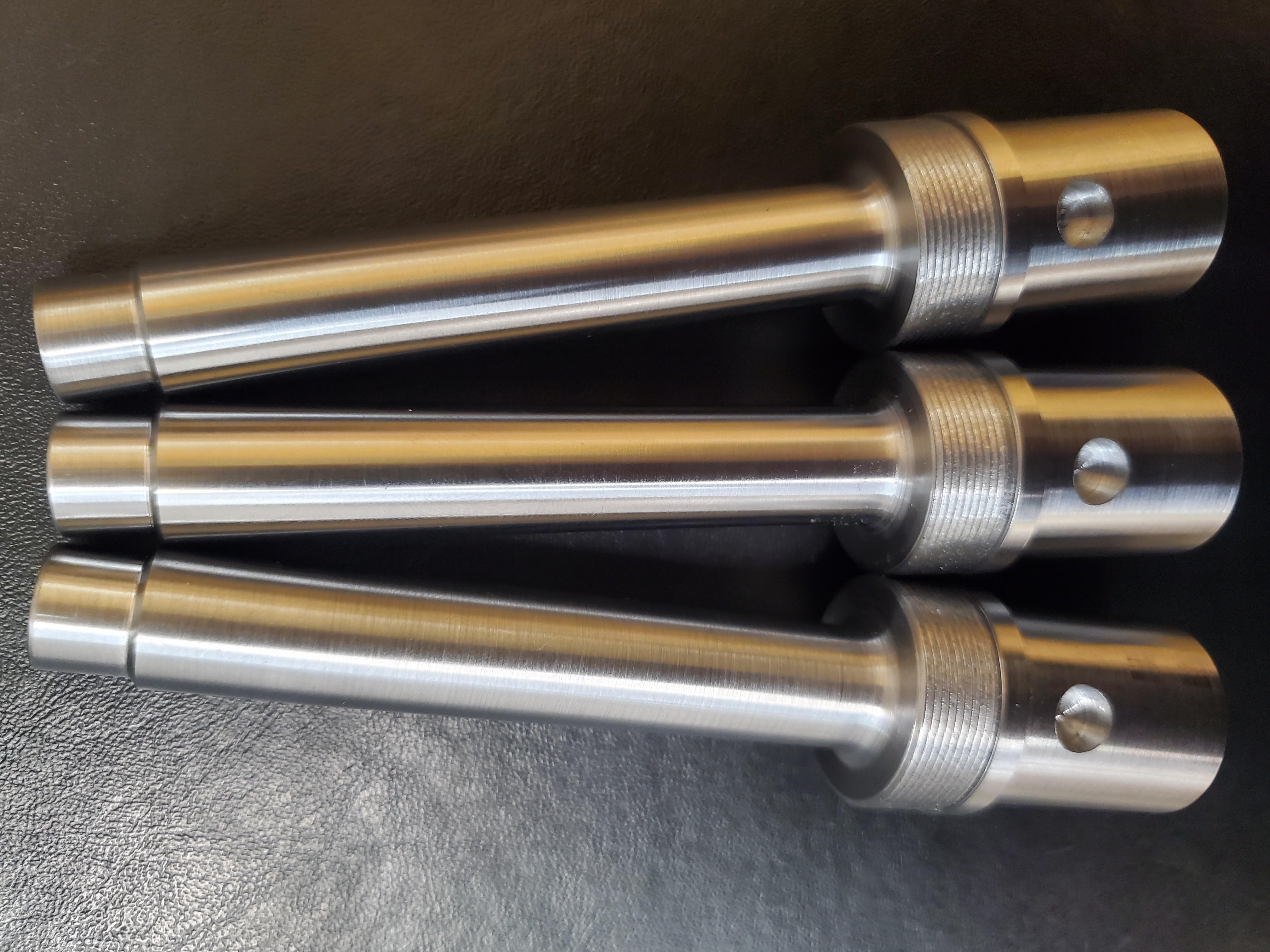

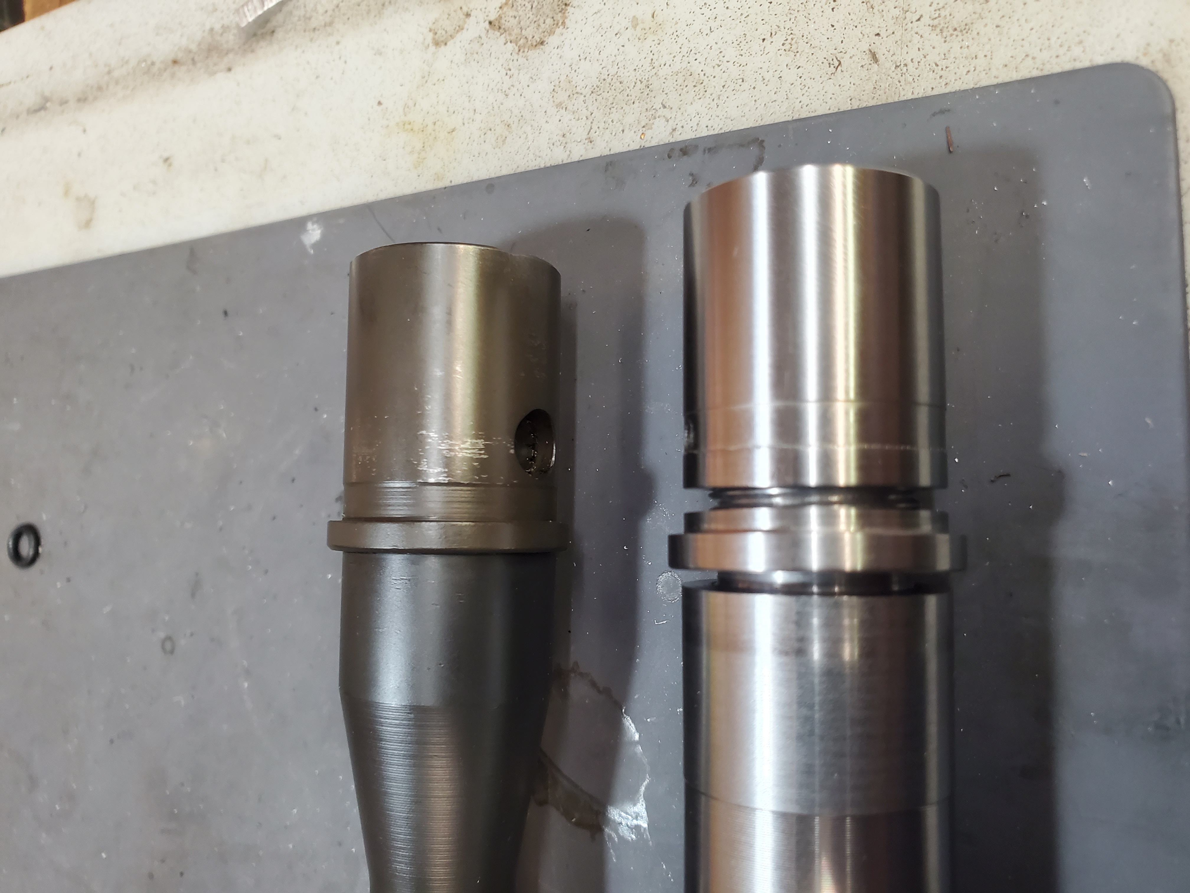

Amongst the billion other ideas and projects that float around in my life, I was made aware by a customer that the Daewoo K2 rifle he owns only has 1:14 twist barrels and that there's a cult following of people that would pay dearly for 1:7 or 1:8 twist barrels. So he let me borrow his upper, barrel and bolt. The barrel extension is almost the same as one for an ar15 but it's longer with the same locking lugs. So I ordered some GM blanks and some barrel extensions and took measurements from his barrel. I have about 30 people waiting on these things. I had to turn off the ar shoulder and make extended shim/shoulders but they mic out perfectly.
The gun is a love child of the ar and ak platforms. Weird things.

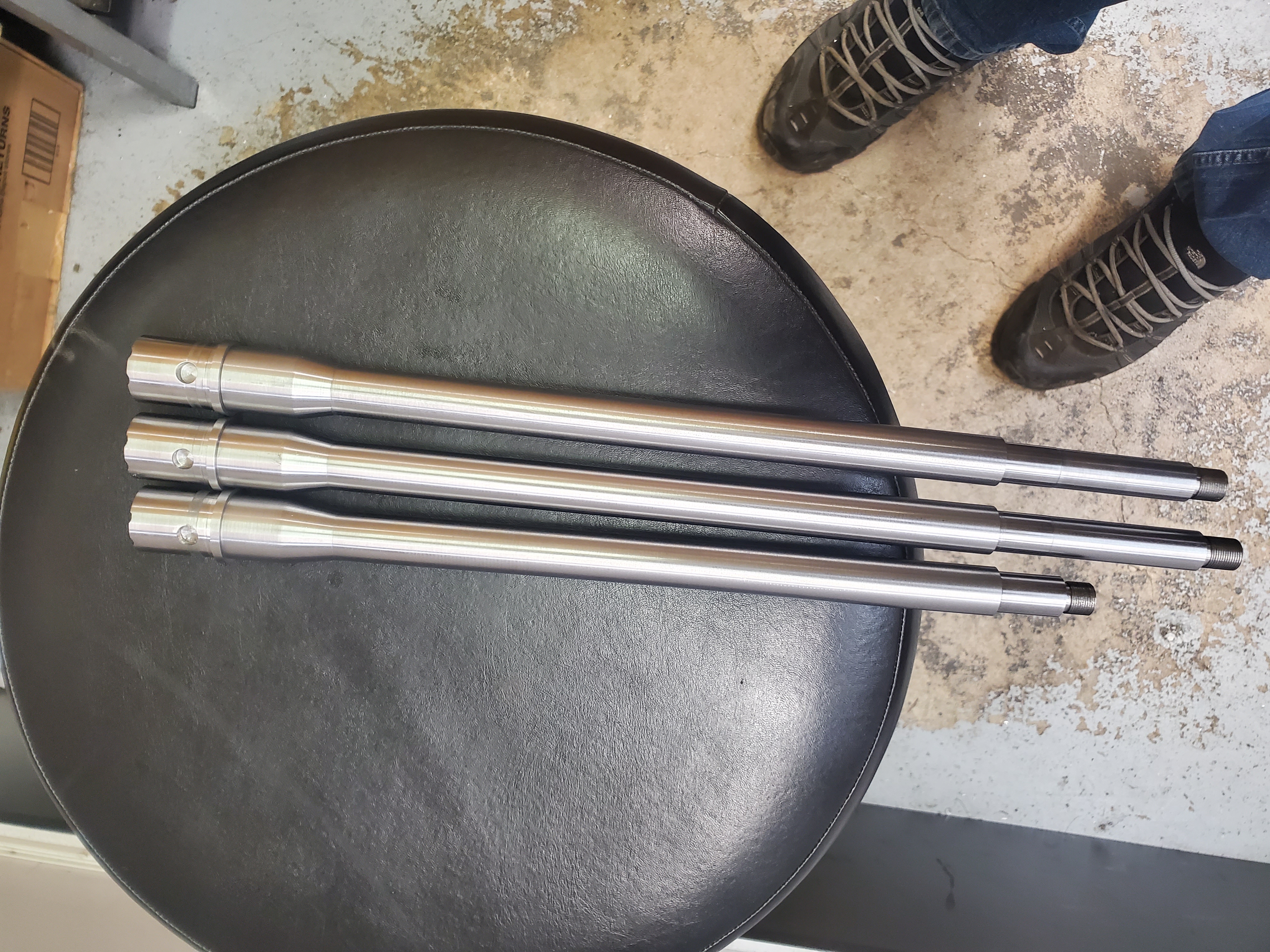

Little update.
I got the first three barrels done. These are going to the guy that let me borrow his barrel, bolt and upper to take specs from. Ordered 5 more blanks. I have about 21 of these pre ordered from people.
