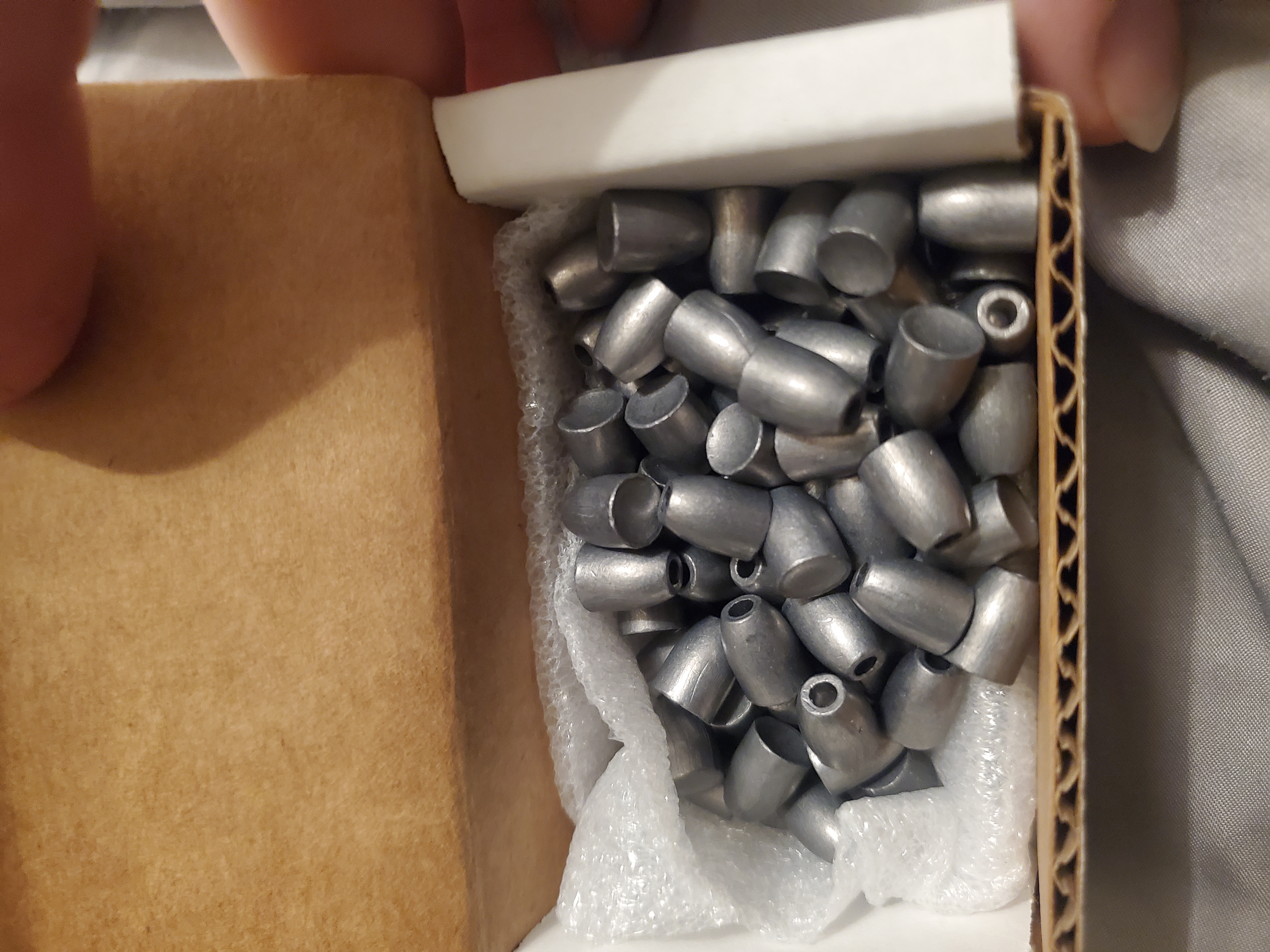

Here's some 65 grain 308 airgun slugs for reference. I'm hoping for 1800fps and the mags hold 8 rounds. A fill should be able to give at least 8 regulated shots.

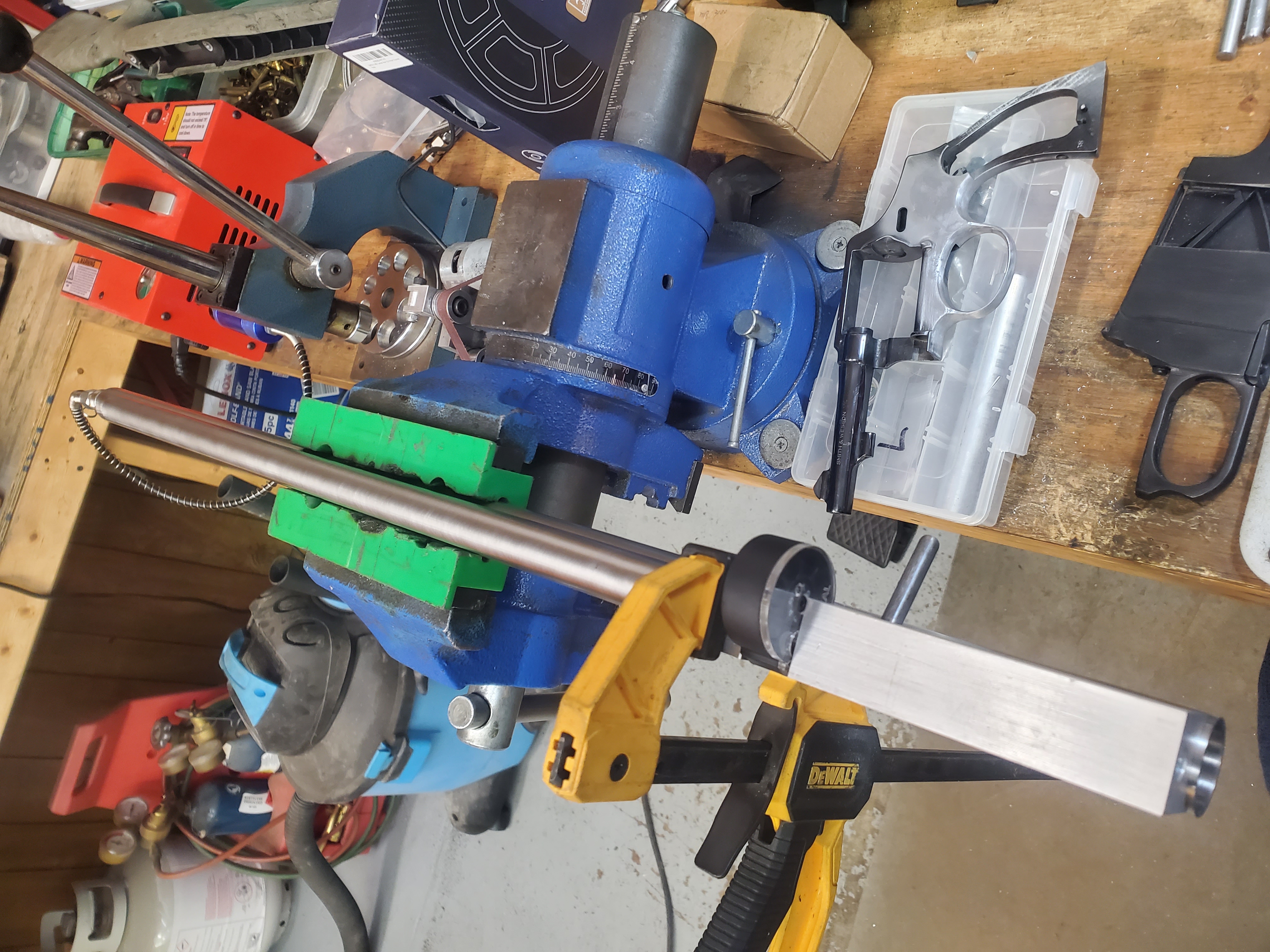

Posted: Sat Dec 30, 2023 11:14 pm
Got a bit further. Just a mock up.

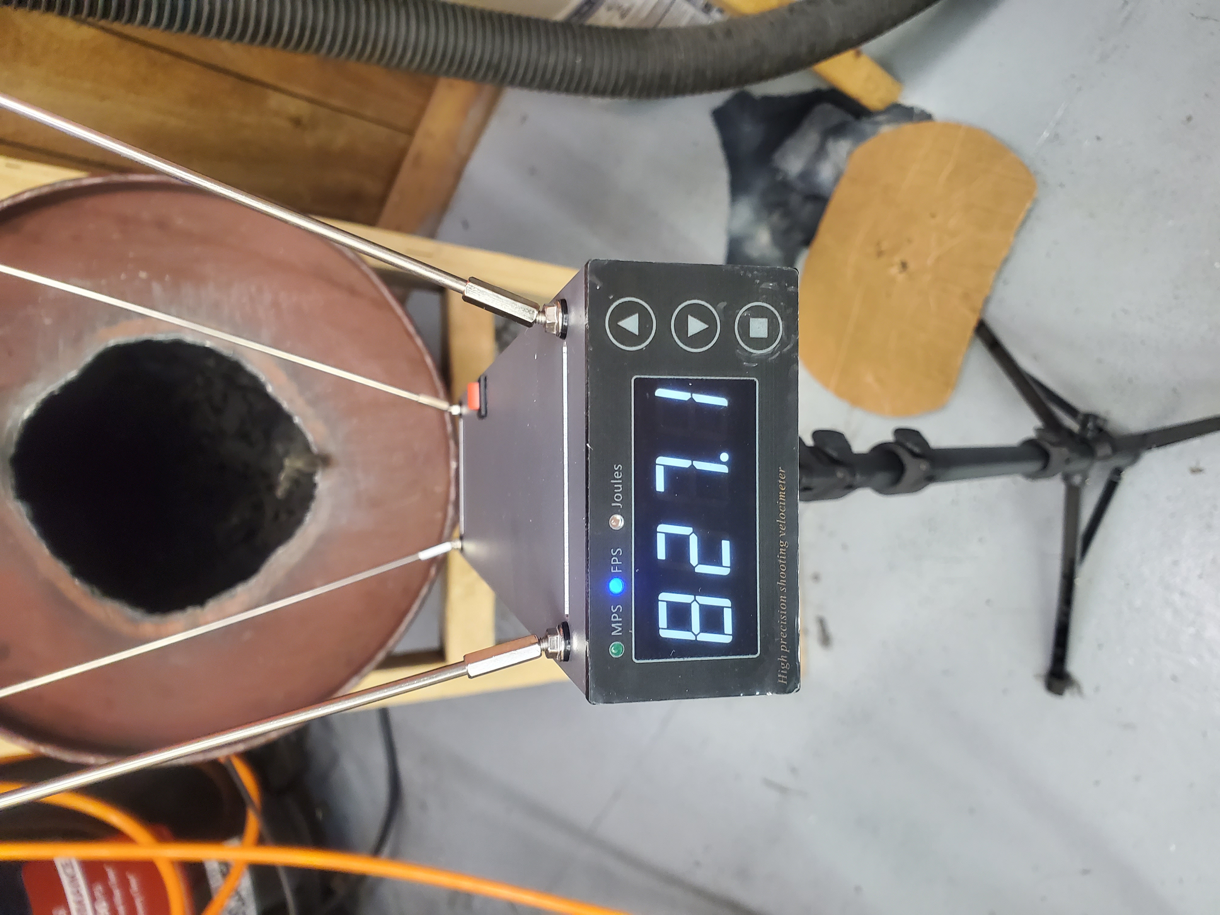

Posted: Sat Jan 06, 2024 11:31 pm
Well, I've yet to pin the valve in place which is what keeps it from blowing out the back and into my body, preferably not my skull but the hardened steel transfer port is pretty strong and it sits between the pressure tube, upper reciever and valve so I figured I could take it up to 1500psi for testing. It works and works good! I got 739fps at that fill and it's rated for up to 4500psi so it'll scoot when I'm done. Don't mind my clamp for "testing purposes."

Posted: Mon Jan 08, 2024 3:05 am
I also did some testing today. For one, it held pressure overnight with no leaks and I tried it at 1700psi. It will also be tunable.
