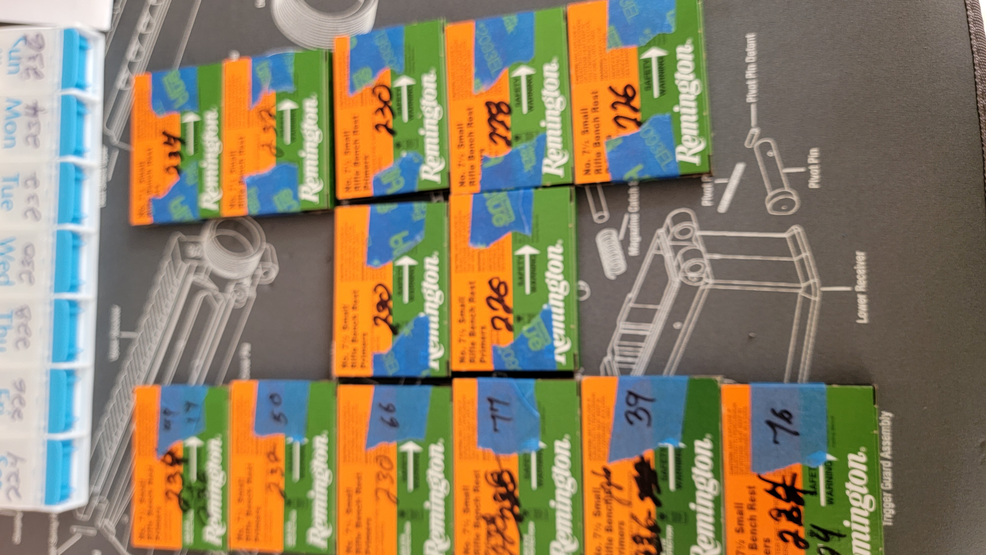

Here is a picture of the sorted primers at the end of the current batch. The next batch of 5000 primers will be sorted when I start getting low here. I do not mix batches.
You can see the pill caddy at the top, or the edge of it, with some numbers written on the lids.
The seven boxes in the middle and right are all full boxes of the numbered weights. The lefthand column is made up of the remnants of the batch. You can see the box on top having two weights in it, .234 and .236, The .236s are fairly rare; 19 out of 2500 or so. I have used a few .236s for foulers, now that I have started allocating cases for that practice instead of dipping into my pure match ammo. (A story for another day.)
