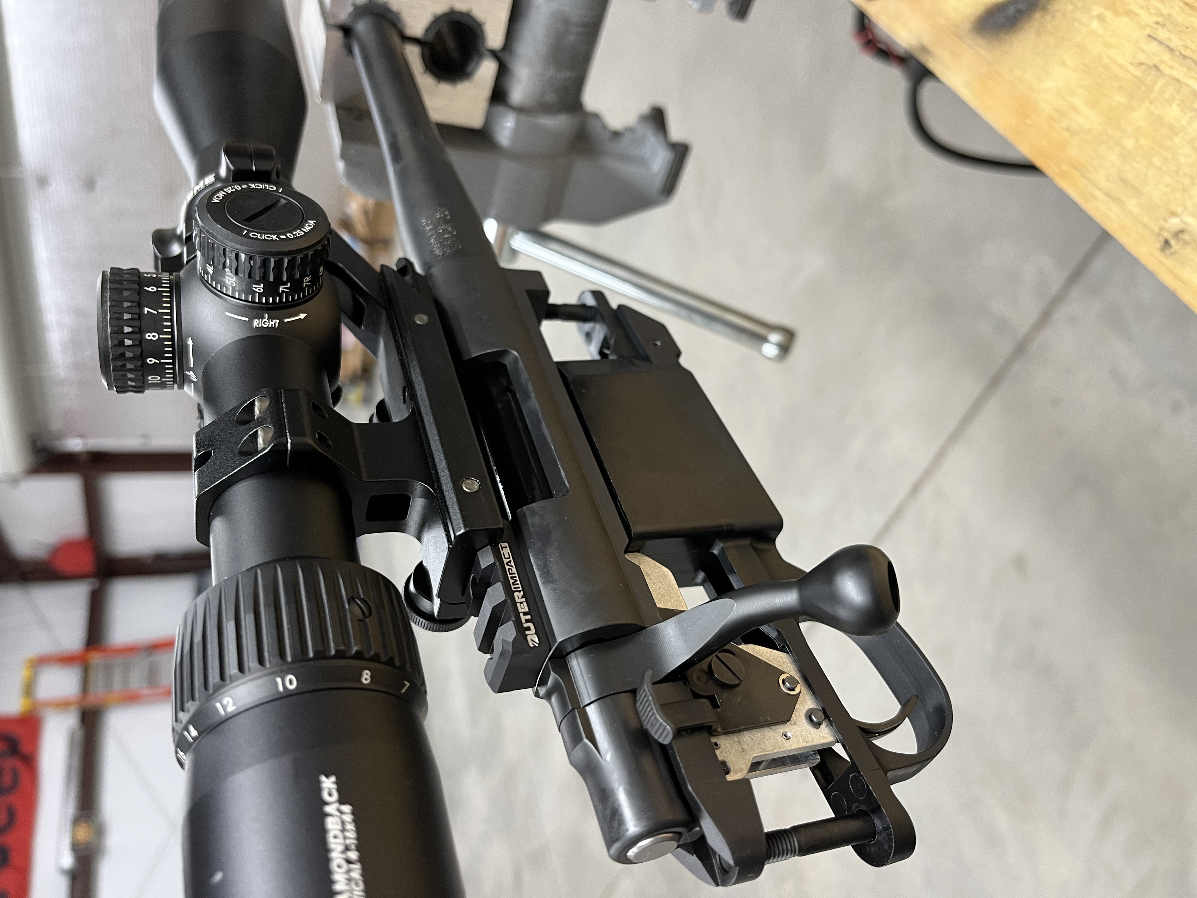

This. I have a project in the works, using a Howa 1500 mini action and MDT chassis. More to come when it’s up and running. 👍
The new Howa actions are made in Japan.

Posted: Sun Jan 07, 2024 5:08 am
by Jay
That scope mount won’t be staying.
For $400, kinda hard to not order one of those barreled actions.. 😉

Trigger on that Howa?!?

Zee wrote: ↑Sun Jan 07, 2024 6:51 am Trigger on that Howa?!?
The factory trigger is a two stage. The first stage is light and short. My trigger gauge goes down to 8 oz and the first stage won’t even register. It breaks clean at 3 lbs but has a tiny bit of overtravel. It’s actually a really good trigger, for a factory trigger. But if you’re a trigger snob, it’s a bit heavy. A 3 lb, clean breaking trigger probably suits most people just fine.
Timney sells a trigger for these actions. 1.5 to 4 lb adjustable. Midway sells them for $170. Mine will be getting one at some point. But I’ll make due with this one until that time comes.
