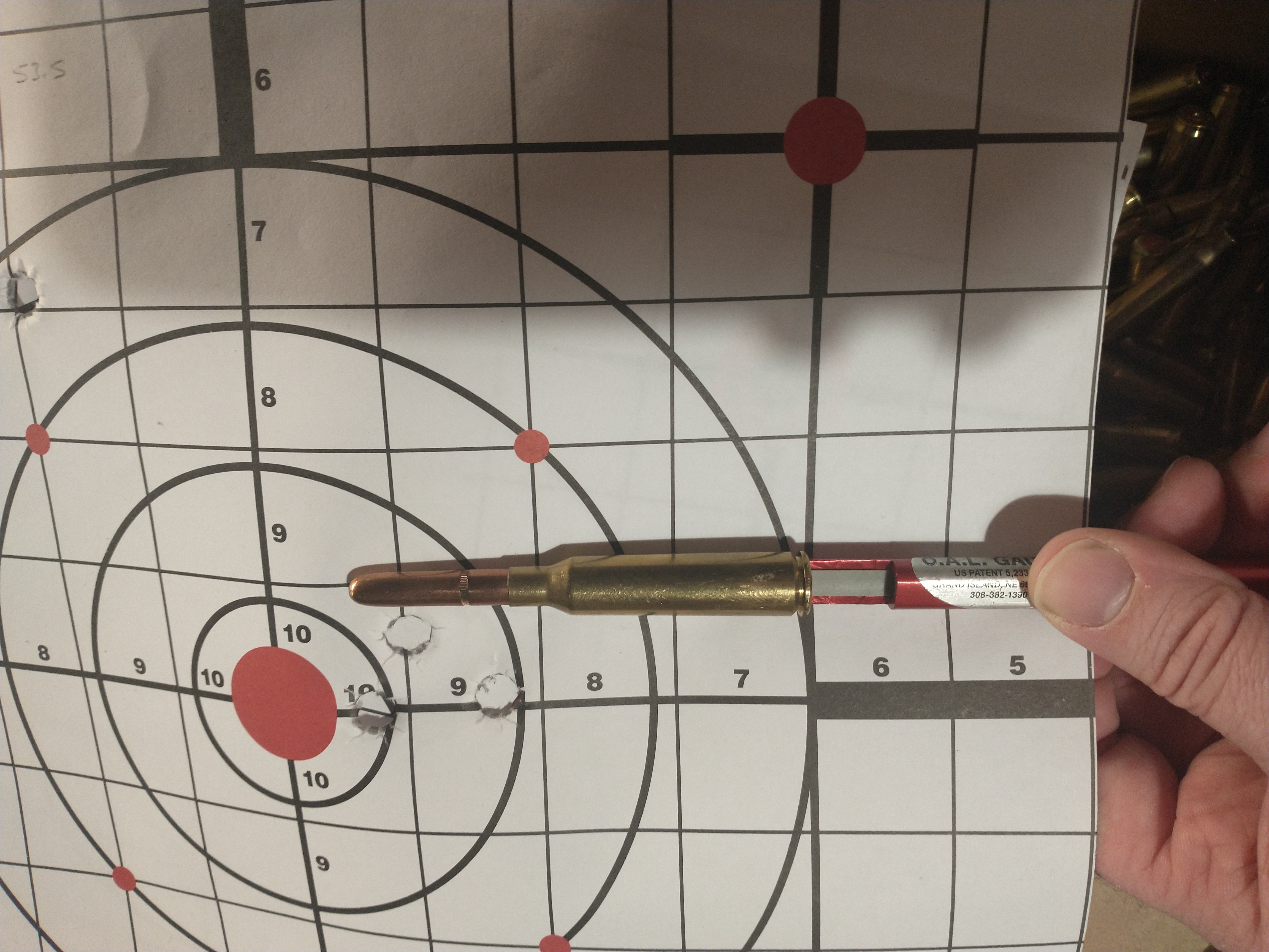

I picked up some cast .265" GC bullets a few years back, but cant recall where from. I was going to try them in the Grendel.

I would have to check compared to my M96 or my 6.5x55 using a M38 NOS barrel, but the 6.5x55 Swede has a very generous throat/leade intended for the long 156gr rn bullets it was designed for.
Just checked on a M98 based 6.5x55 that would have had the chamber cut with a standard 6.5x55 reamer. The Hornady 160gr RN has a max OAL in my rifle of 3.303". This leaves 0.095" of the bullet in the neck and would not be a wise seating depth.
I stand corrected on the cast bullets I have. They are 146gr .264" with a gas check. The lube grooves would extend way past the case mouth unless you seat the bullet so deep that the GC and some.of the lube grooves are below the case neck.
Disregard the holes in the target. The target is from playing around with a R700 .35 Whelen

Mitdr - thanks for the sense of scale. That's a good photo to illustrate my point.
Yeah. . .not an uncommon approach to lube grooves. A lot of guys will fill those many-groove bullets in their lube-sizer, and then gently roll them in one of the harder-shell tumble-lubes to seal the softer stuff in. Obviously not ammo you'd carry in your pocket on a sandy beach, but perfectly shootable within certain care-in-handling limits. Some guys will seat deeper if fit requires and work up their load with a weighed wad of Dacron stuffing or sized bit of tissue paper in front of the powder charge. There are ways.
