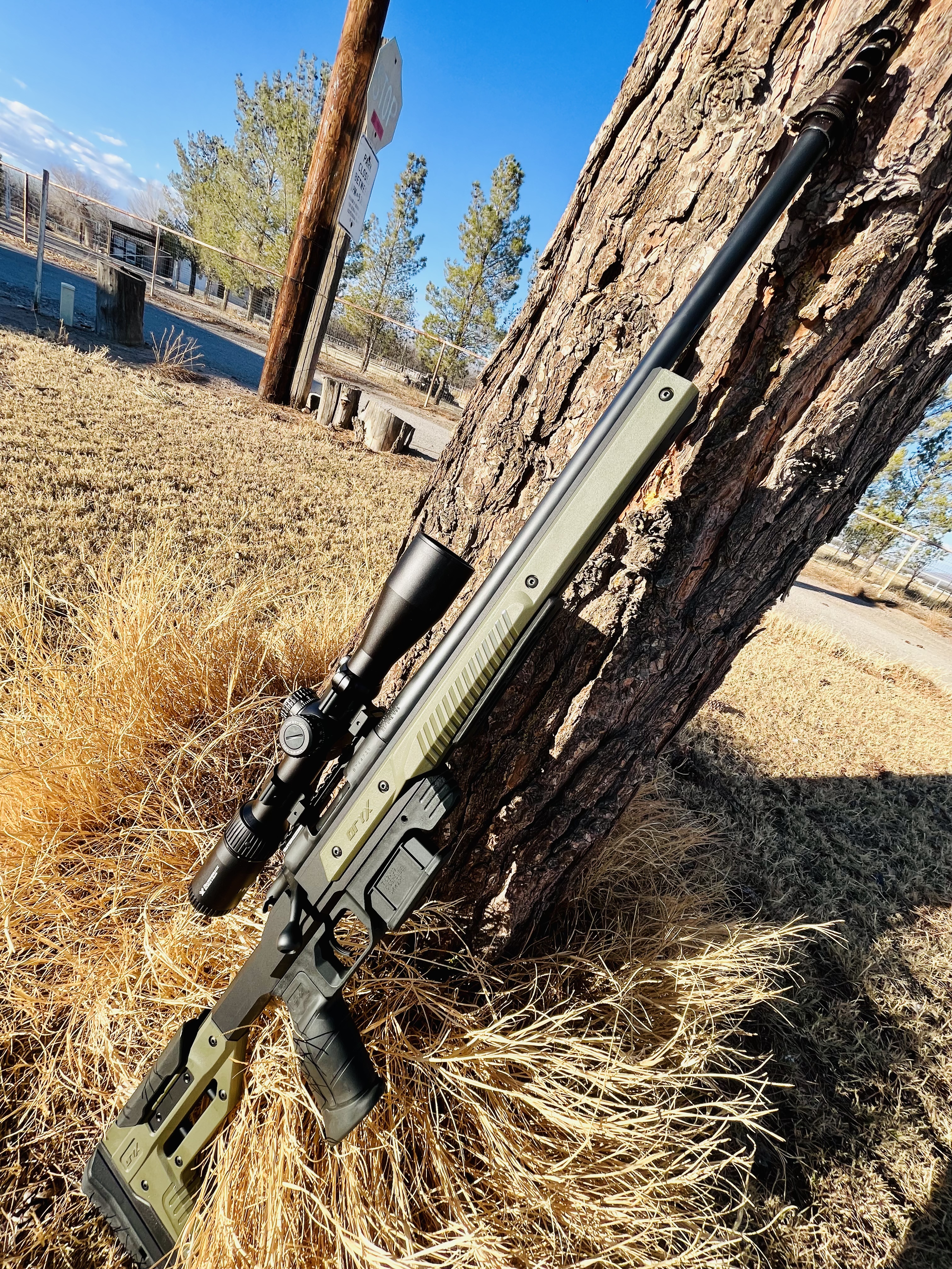

I’ve mentioned it in a few threads. It’s finally complete. So, here’s the story.
I’ve had the thought of building a 6mm ARC since the cartridge came out a few years ago. But was looking at building it in an AR platform. Never really found an off the shelf barrel I liked, and components and factory ammo have been scarce. So I always pushed it back.
Fast forward through a few years.. I helped a buddy of mine build an AR in 6ARC. I like the way it shoots. Then, some jackass came along and did some enabling… I became aware that Brownells was selling Howa barreled actions. They had the mini action in 6ARC, although it was backorder. I was also pointed in the direction of MDT chassis. Before I knew it, I had ordered a Howa mini action in 6ARC and a MDT Oryx chassis. The barreled action got here about 2 weeks after I ordered it. The chassis just got here today.
Re: 6mm ARC mini action chassis rifle
Posted: Thu Feb 01, 2024 1:57 am
by Jay
Details;
Howa mini action, 20” heavy contour
3.5 pound 2 stage factory trigger. Will probably put a Timney trigger in at some point
Silencerco ASR muzzle brake
Vortex Diamondback Tactical, 4-16x44, FFP, MOA reticle
New brass can still be hard to get. It comes up every now and then. I was able to snag 100 pieces last week. Also have 80 rounds of factory Hornady 108gr ELD-M ammo. That’ll get me started. I bought a set of RCBS Matchmaster dies for it. Bushing sizing die and competition seater. Started brass prep this week. I’ll get some test loads together and take it out with those and some factory ammo and start seeing what it can do.

Wow, never really been a fan of the chassis stock but that is one fine looking rifle!

sakodude wrote: Thu Feb 01, 2024 2:08 am Wow, never really been a fan of the chassis stock but that is one fine looking rifle!
Thanks. I’m happy with how it came out.

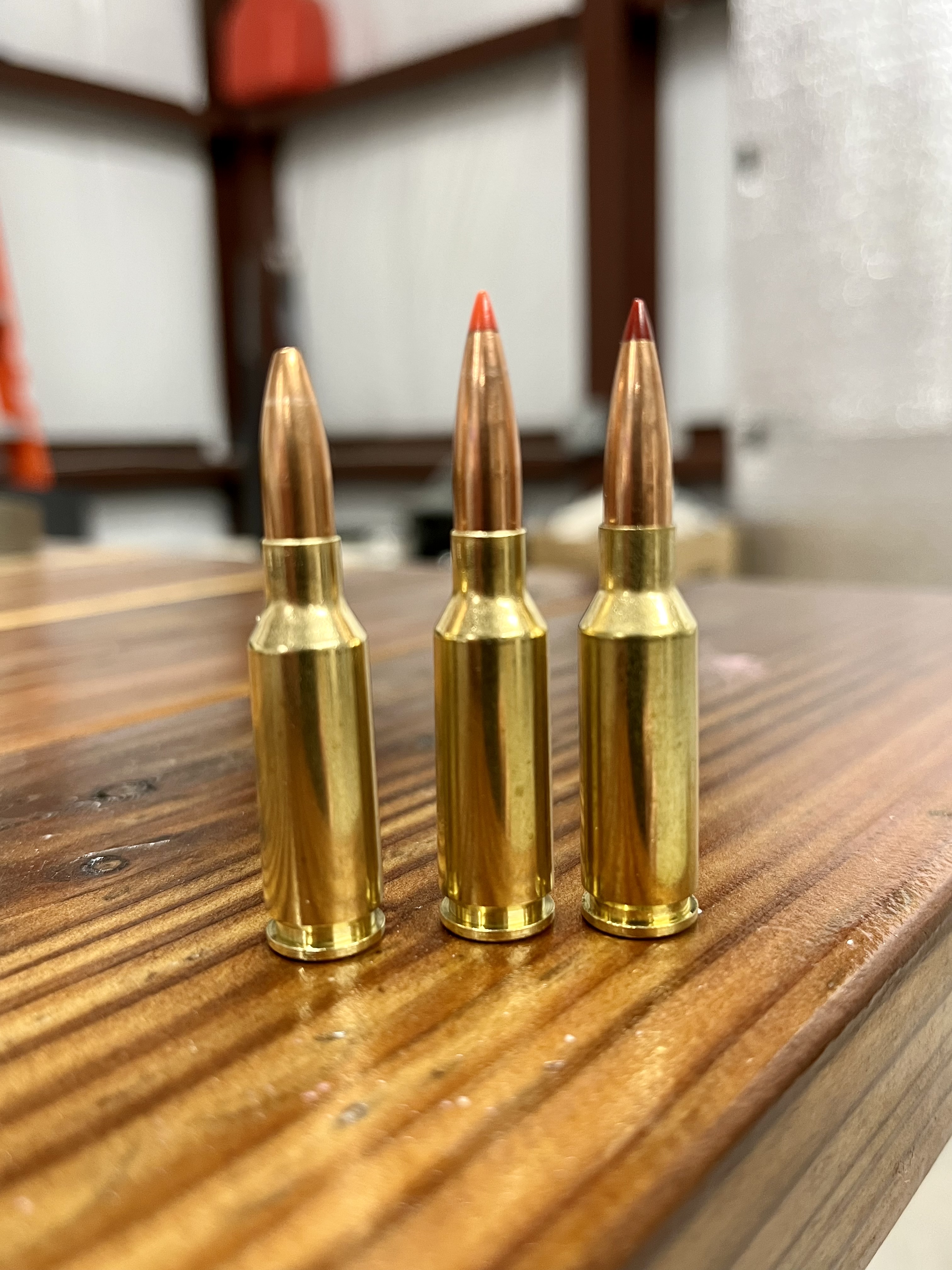

Test loads assembled this evening. Left to right, 75 grain Sierra Varminter hp hand load. 105 grain Hornady Amax hand load. Factory Hornady 108 grain ELD-M.

Really looking forward to your results. The Hornady load data doesnt have it as far behind a .243 as I would have expected, if you stick to what the book says. I wish they would list bolt gun loads for the 6.5 Grendel like they do for the 6 ARC.

Using that Hornady bolt gun load data, I’m starting off just under their max load. 30.0gr LVRevolution with the 105 and 30.0gr H335 with the 75gr. Once I check those for velocity and accuracy, I’ll go from there. I’m also seating a little longer. I might be able to squeeze a little more out of it. But having no experience with the gun, cartridge and powder, I’m going to be a LITTLE cautious to start.
Hornady indicates bolt gun loads up to 62,000 psi max and gas gun loads up to 52,000 psi max. Since my hunting buddy has the AR in the same chambering, I’ve let him know we need to not have a brain fart and put my ammo in his gun.
It seems I’ll have a little spectrum of 6mm rifles to work with. 20” 6x45 gas gun, this 20” 6ARC and a 22” bolt gun in 243. The advantage of this one over my 243 is that it can be suppressed. The 243 isn’t and can’t be threaded with its current barrel. And the can very well could bump the 6ARC velocity up a bit as well.
