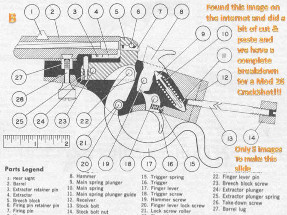

CPJ 2.0 wrote: ↑Sun Feb 04, 2024 4:20 pm Guess what action isnt available as a machinist type kit? Guess which one is damn near impossible to find drawings of?
You might be able to find the drawings for a Steven's Crackshot action. It's a falling block that's simple and would be perfect for that type of build.

Justsomedude wrote: ↑Sun Feb 04, 2024 6:27 pm
Oh there’s several that would be easier. And one day I may go that route.
