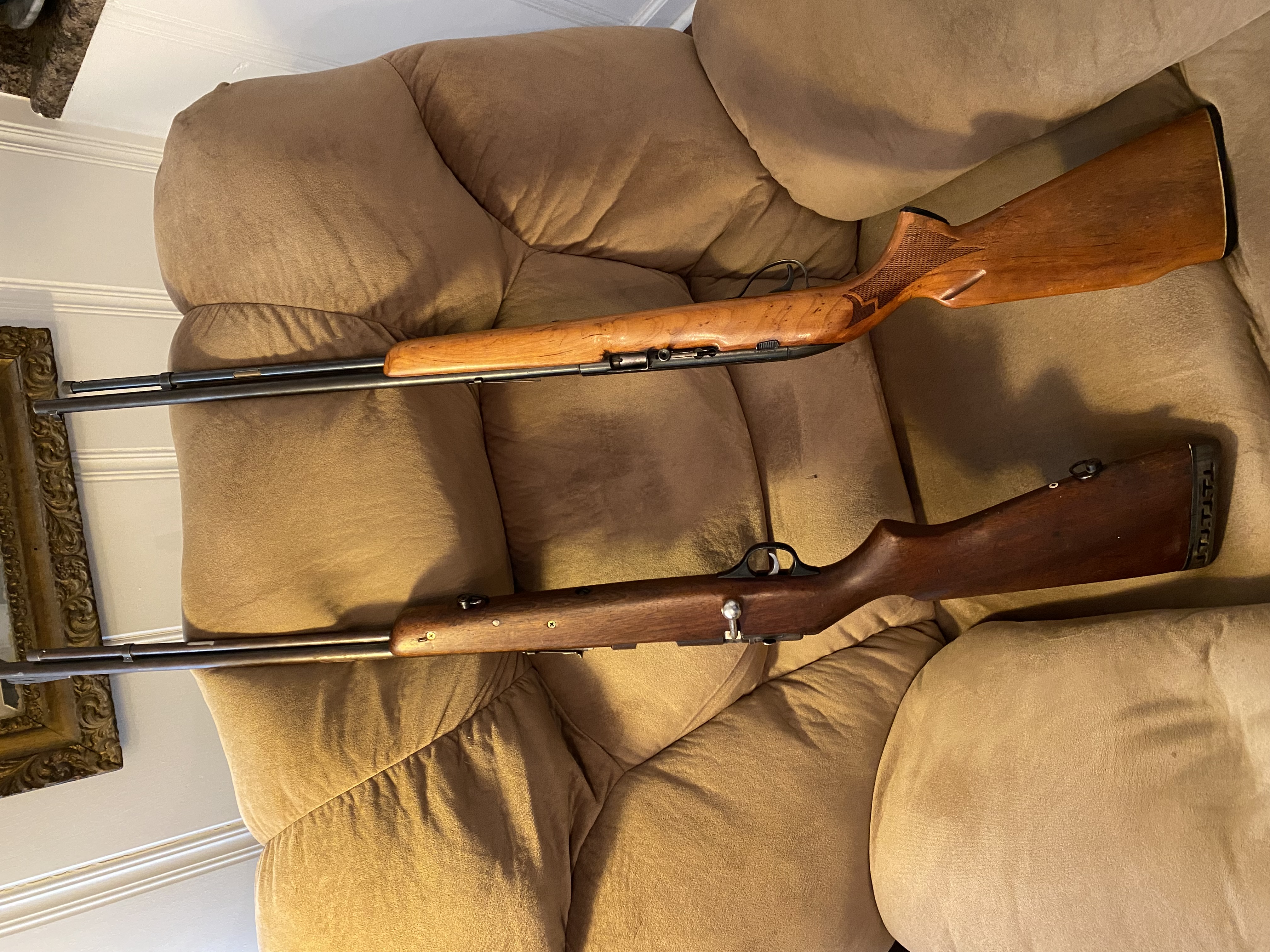

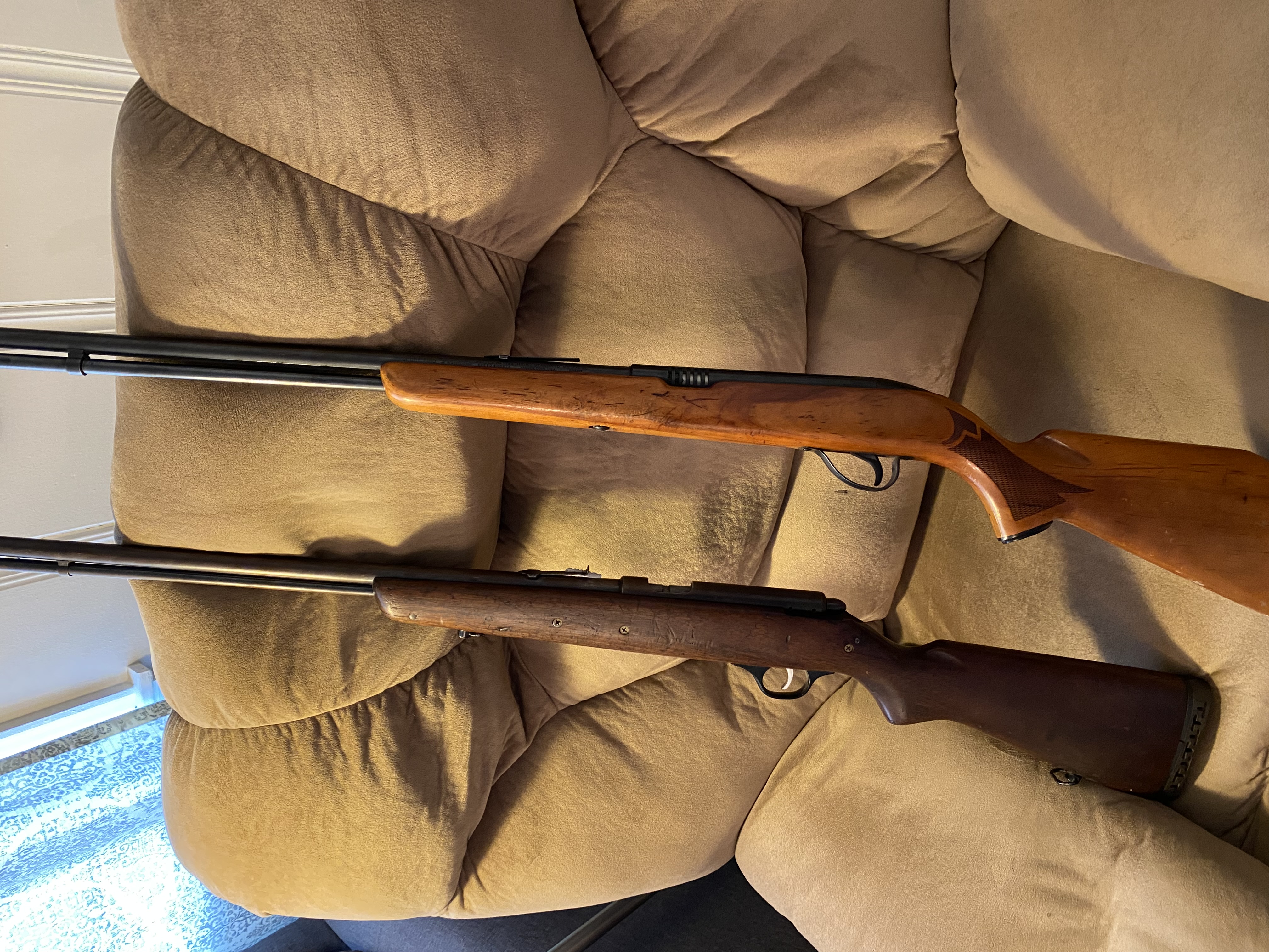

.22 rifles to the herd. Idk what they’re worth but I figured for $250 otd for both I couldn’t go too wrong. “They’re for my grandkids”. Nudge, nudge, wink, wink.
The dark one is a Marlin Mod 81 DL. Peep sight is long gone. Forearm is split which someone “repaired” with 5 Phillips head deck screws :o Old enough that it doesn’t have a SN. I’ve found a stock on eBay but it says it’s for an “S” shaped bolt and mine is not so shaped. The metal one this one is kinda rough. Will try 0000 and Kroil and see what happens before getting any Oxpho.
The lighter one is a High Standard Sport King Special
Model A1041. It’s a semi automatic. It needs the complete rear sight assembly which I have found on Gun Parts.
Both are tube fed. Will function test later.

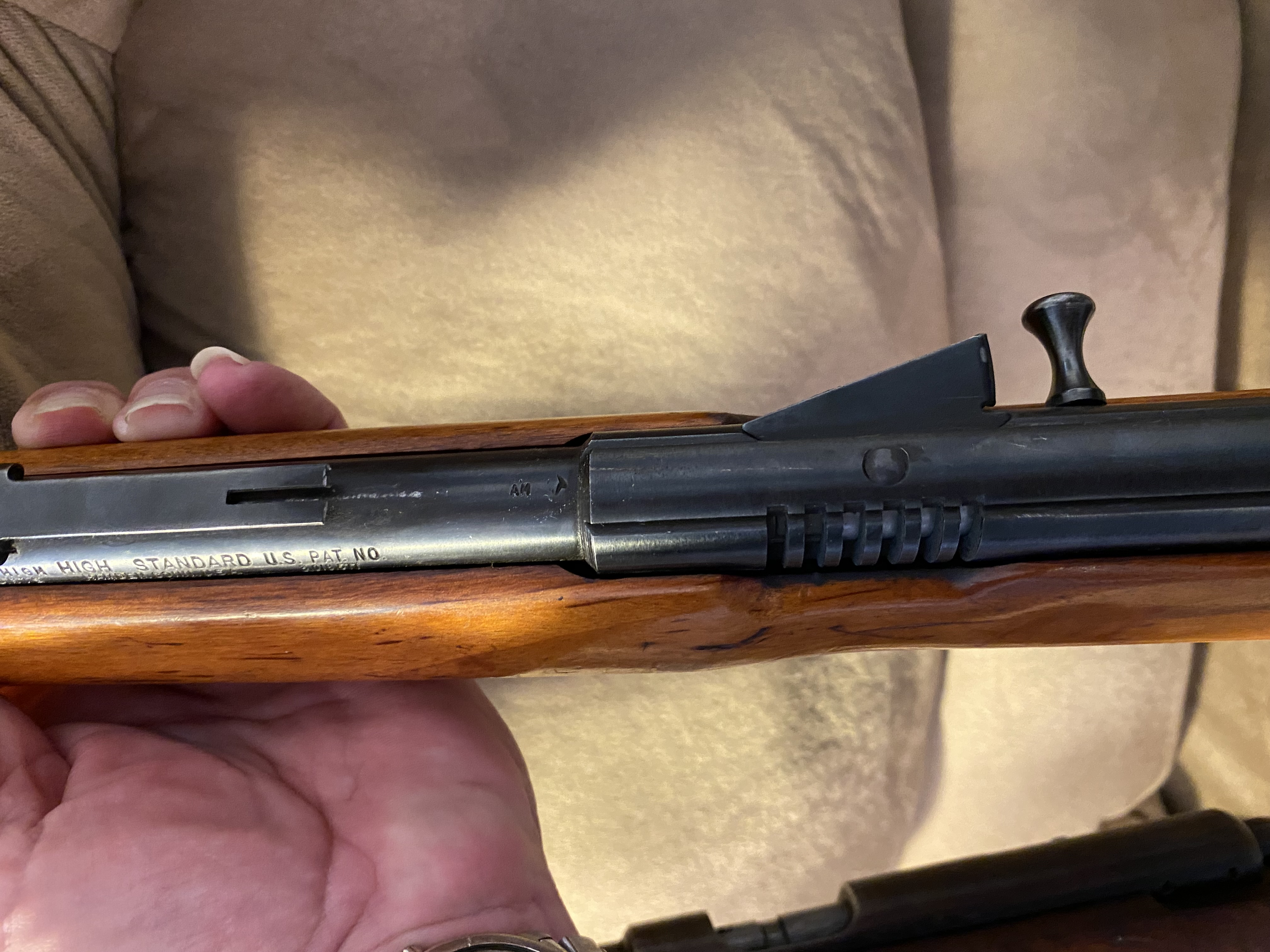

BTW, I think is was JunkCollector who purchased a rifle a few months ago with cutouts like this HS. Someone used the term “gill gun”. Was this a common feature at one time?

Good scores!!! If you can’t find the stock you can remove the screws and drill/replace with thin wood dowels. Just epoxy the crack and dowels in place and refinish. Save yourself one step with oxpho paste on 0000 steel wool. It’ll melt the rust and old grease, dried oil etc. off and refinish in one step. Keep re-applying and rubbing until you reach the right color you want. Fast and good results.

Glad you mentioned that about using dowels. I was wondering if that would work.
The stock I found is $39. I’ve thought about maybe getting it and use this original stock as a stock refinishing experiment. Since it’s broke and has the screw holes in it.

Function tested both. The HS shot 10 rds with no problems.
The first shot with the Marlin jammed. I cleared that then the remaining 9 shots were trouble free

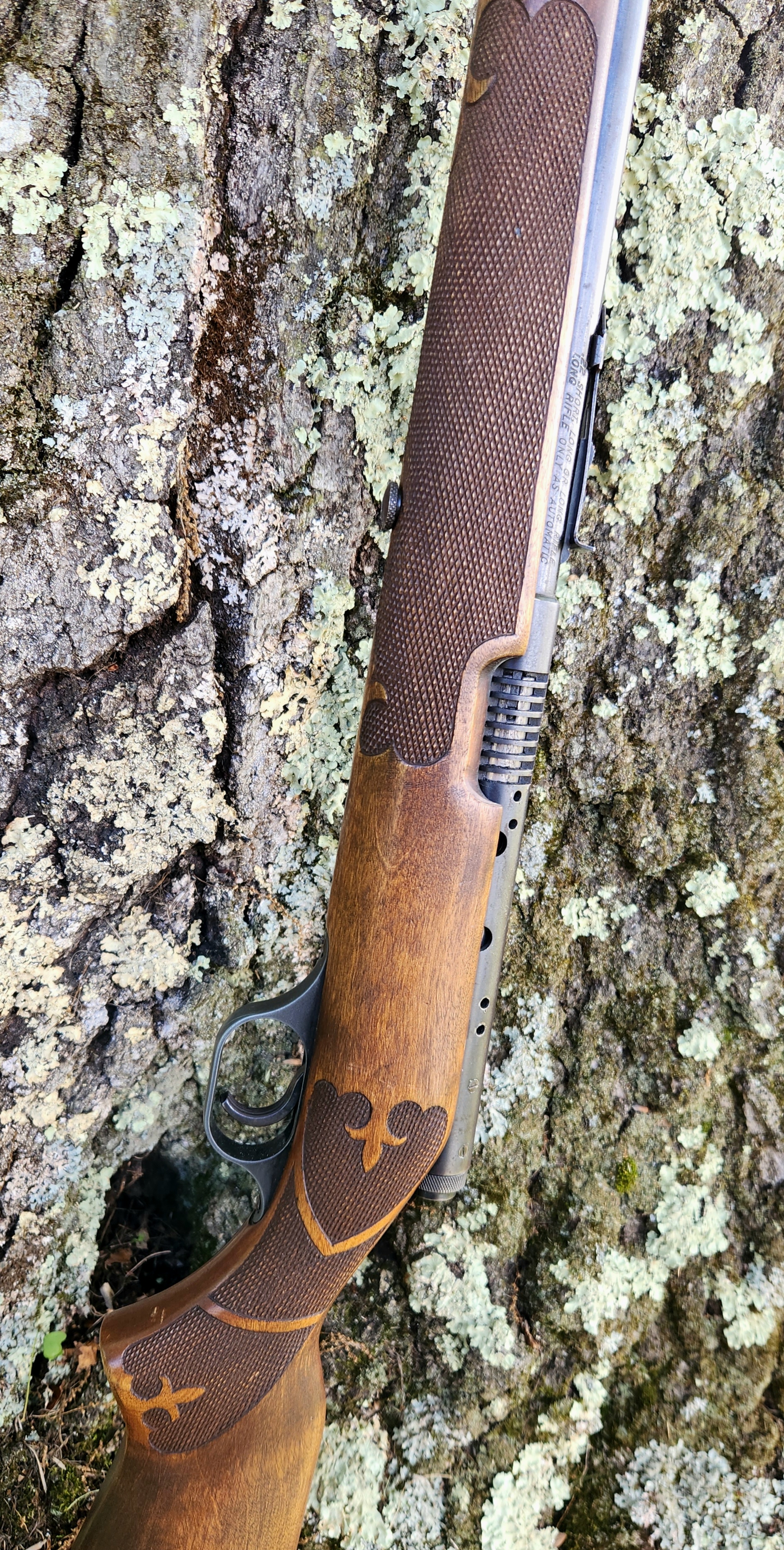

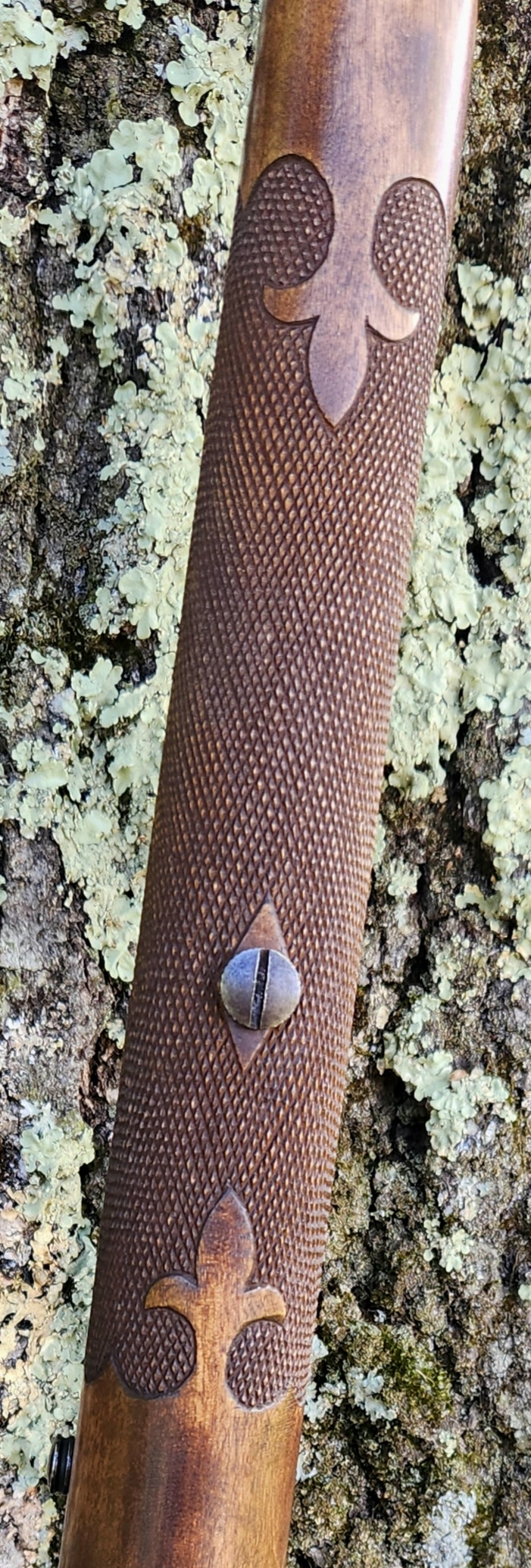

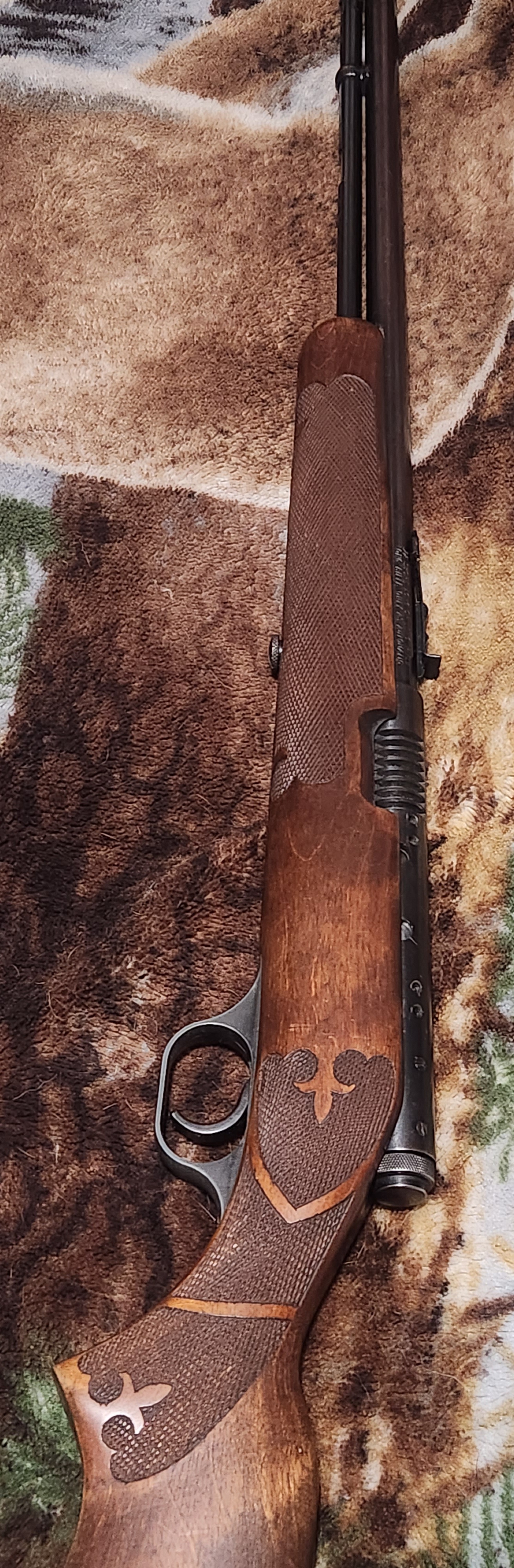

It was me.
Yup....Gill gun....click clacker.
Real fun to shoot
Fire it and don't release the trigger and the bolt stays back until you do.
A LGS here I convinces to part with the stock on mine.
Who ever did it had talent

Is yours a High Standard too? I’ll have to try that on mine to see what happens!

Those are cool guns! Nice grab!

I like that High Standards, great find. I've got a marlin model 81 as well and it's a great shooter so hopefully yours will be as well.

I'm guessing if they used that many screws, the split goes all the way into the barrel channel.
I'd be inclined to pull the screws, wedge the split open, squeeze in a lot of Acraglas dyed black, clamp it and let the squeeze out sit until dry. Scrape it off after. It won't ever be new again, and blackening the Acraglas will blend in with the grain/pores better than brown will match the rest.
That's the functional repair. You could drill the screw holes for dowel diameter to the depth of the middle of the barrel channel, and then use a smaller bit to drill a connecting squeeze-out hole in the middle of the channel for the extra Acraglas (again black) to flow out of. Try to seat your dowel with the grain direction matching the stock and leave it long until the goo sets. Odds are the dowels are gonna be light colored birch, so probably your best bet will be to use some aggressively dark stain after you've sanded them flush.

Thanks. The 81 is not a svelte gun. It’s a lot more burly than I would have thought a .22 would be.
I figure the crack is pretty extensive. 4-5 screws plus 2-3 nails at the forearm tip.

As for the gills in the other one. . .my only guess is that it was done to let fouling escape. We've all seen the semi-auto .22 with the layer of carbon building up on the left receiver wall opposite the ejection port. You could treat it like an AR and keep the bolt heavily lubed - the crud would then flow back out the gills. No other reason for it I can think of
