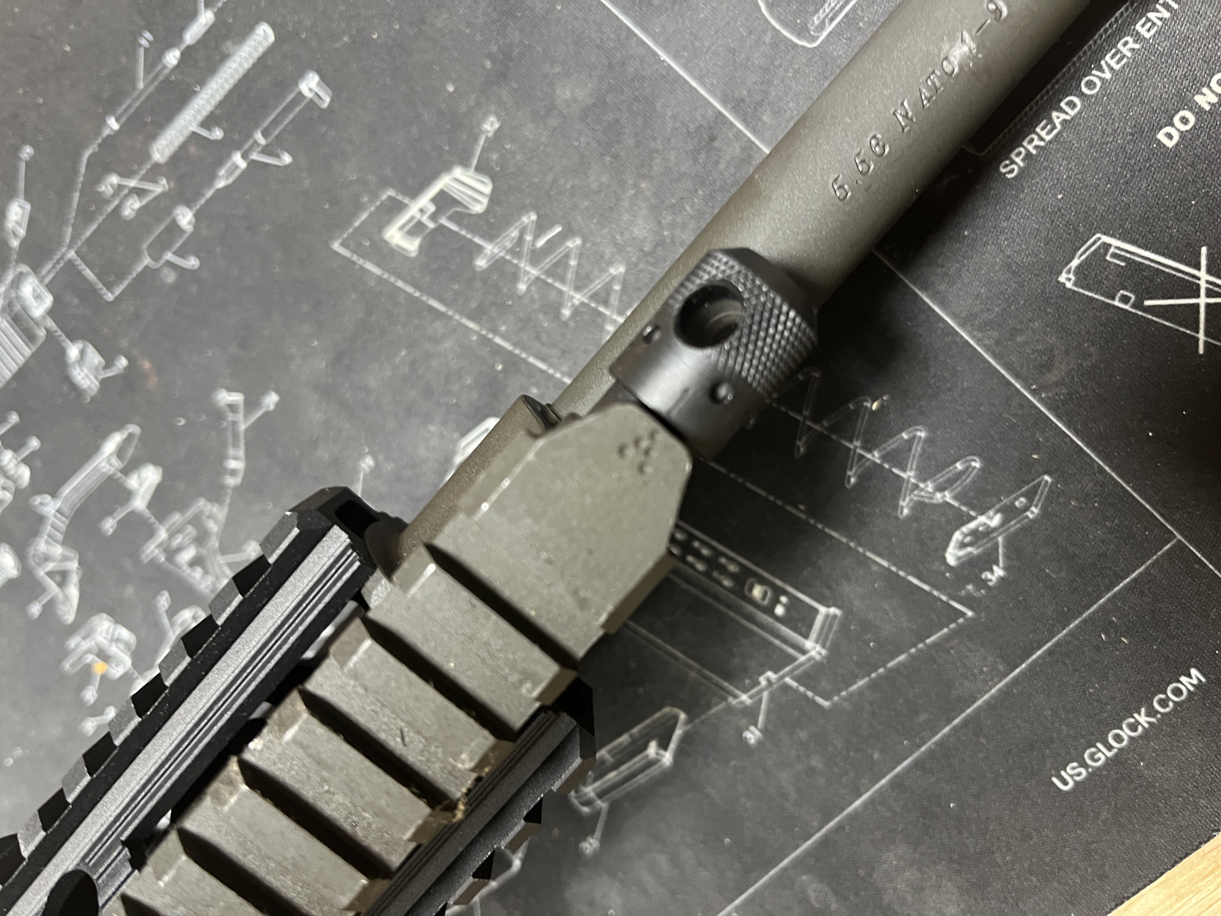

You're going to need an allen wrench to change MOST of them. I like the Superlative arrangement better than the one I have where you have to remove (and NOT lose) the set screw to then adjust the actual gas block screw, then put the set screw back on top of the adjustment screw.
That one, a well known brand, is still in the package. I saw the adjustment directions and thought HELL NAAA

I have an Aero, and a couple Seekins.
Aero is much better. It has detents. It comes with a really long allen wrench, you can adjust it without removing the handguard. If you remember to bring the wrench.

Once I got mine set, I haven't done anything else to them
