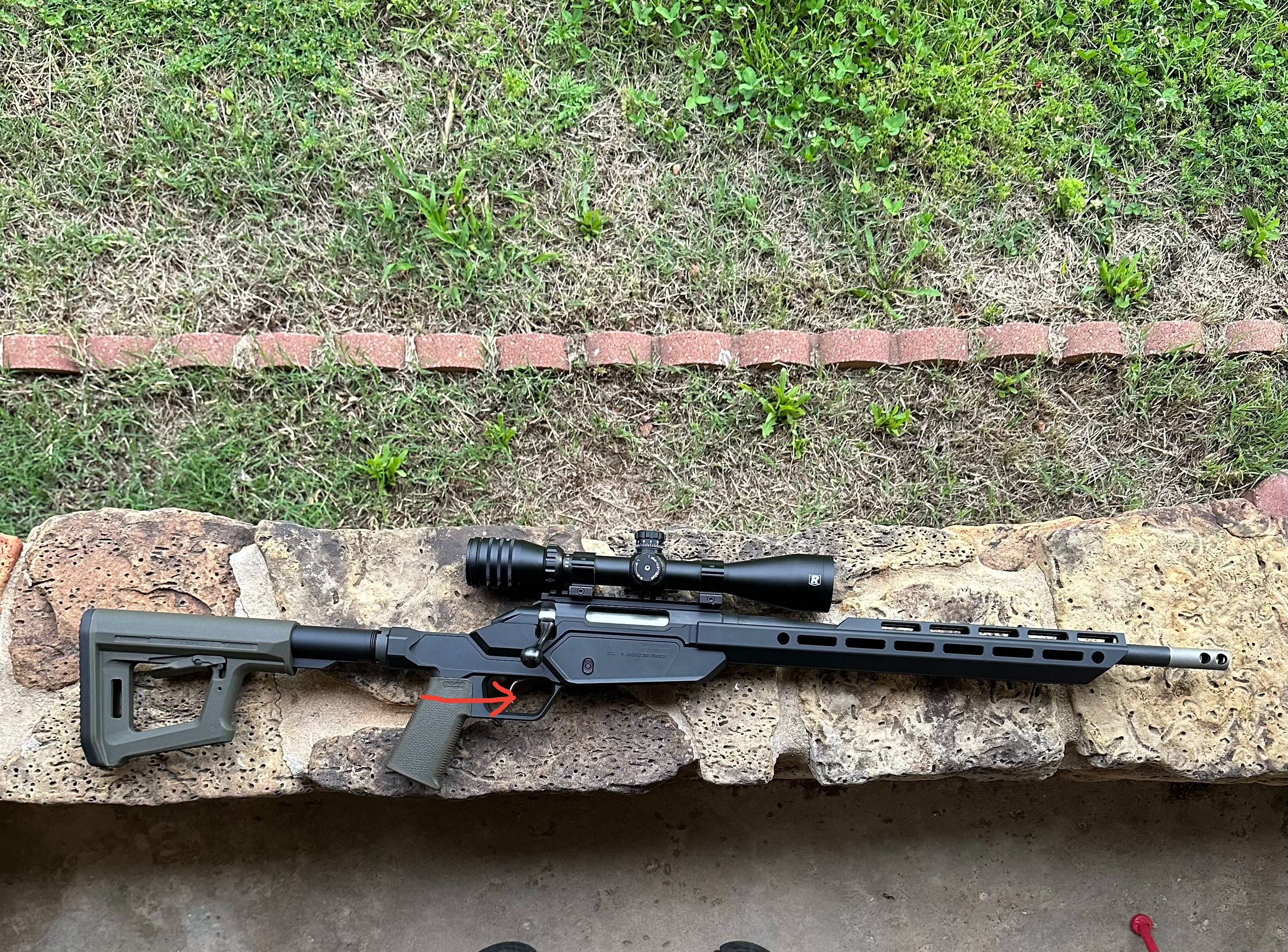

I got swindled, coerced, forced actually into buying a new chassis for my Ruger American Ranch. Some cork stuffer out west made me do it.
Anyway, it’s a Sharps Bros Heatseeker (dumb name) chassis. New Magpul PR stock and magpull grip. I’ll add an ARCA rail what for tripod mounting.
It’s currently a .223. But with a can to be arriving….sometime, I need a bolt gun in .300 blackout. Because, that’s why.
New barrels have gotten stupid expensive. Since I have tools and some skills, and know a guy with a bigger tool and more skills, I got a Green Mountain blank. It’s a rifled tube. Period. Needs contoured threaded and chambered. But, it was dirt ass cheap. And I enjoy that kind of stuff. And I can make it whatever length I want, up to 25”.
Got the chassis today, and just ordered the barrel.

I haven’t even got around to posting anything on mine yet. Figure I’ll wait until I have an initial range report. Since I built two new chassis rifles, I’ll just knock them out at once.
The Ruger American Ranch is a damn handy little rifle. One of my favorites. But not tripod capable. And other stuff.
The kinda full back story.. I was on MDT’s website, minding my own business, buying a stupid expensive magazine for my Howa mini action 6ARC. I was curious about a chassis for the RAR. They don’t make one for the ranch. So, jackassery ensued and I was shown the Sharps Bros chassis. I was a victim! I was forced to be the Guinea pig… Then, used the force to reverse enable..
There are other chassis out there for the RAR. But they pretty much all convert it to AICS mags. The Sharps chassis retains the AR mags. That, and having a bridge on top of the forend were the deciding factors for me.

Zee wrote: Thu May 09, 2024 3:15 am Due to the French Model’s deceptive ways, I’ll eventually be ordering the. Same chassis for my Ranch Rifle. But, I’ll likely go for a fixed A2 butt.
We should probably do some looking before committing to an A2 stock for the Sharps chassis. I looked at possibly taking the one of my 450 Bushmaster to swap over. Problem is, the A2 stock has the little oval shaped nub that goes into the oval shaped hole in the back of an AR receiver. The chassis doesn’t have that. I’m sure it could be ground off. But you’d end up with 1/2” or so of the stock hanging down below the bottom of the chassis. And I’m not sure if the stock would try to rotate without that nub being stuck inside a hole…

Side note, I’m really digging the Magpul PR stock. It is a bit wiggly, but I know a guy. Making it not wiggle is easy. Making it not wiggle and still be adjustable isn’t as easy.
