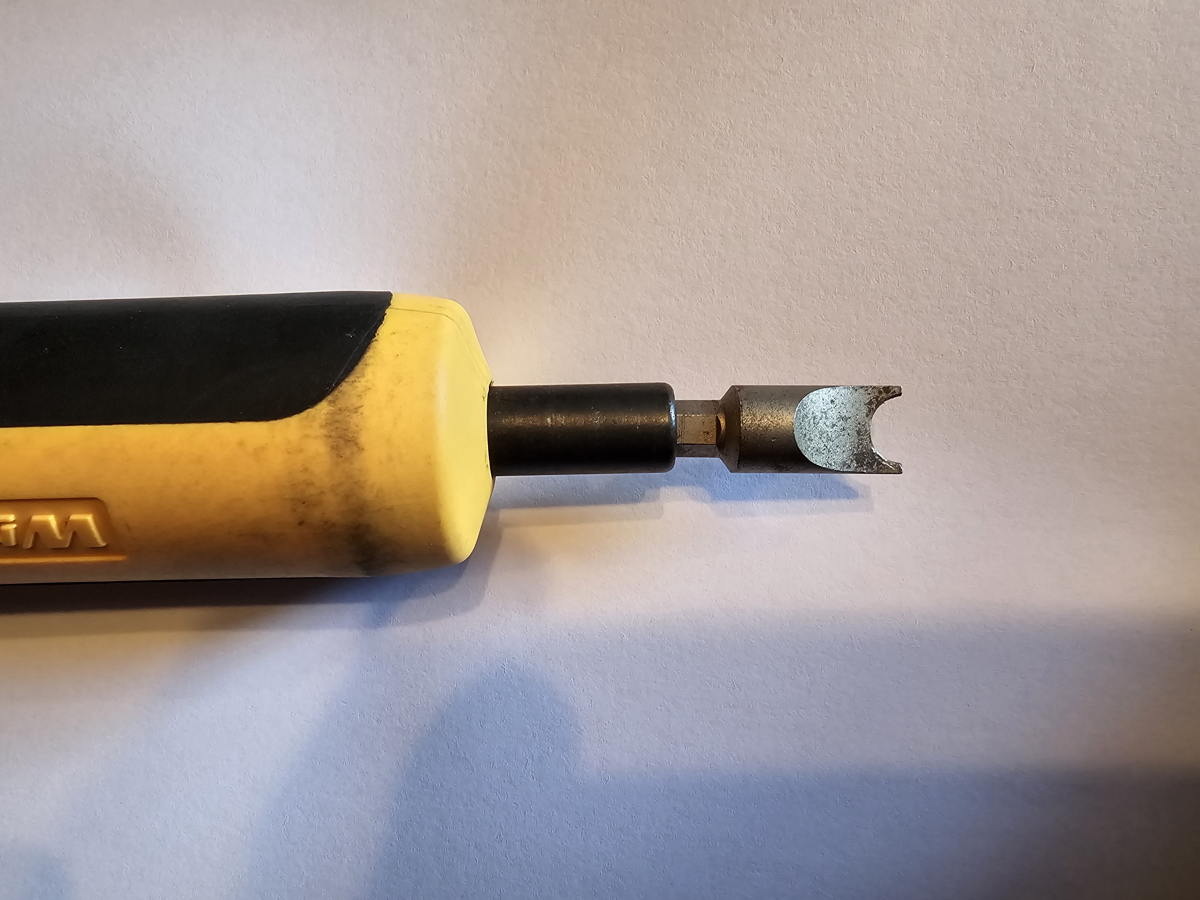

When I sighted the thermal and scope in at 100m, I removed and replaced them numerous times to check the repeatability of the zero. I found that the point of impact varied by up to 2 inches or more. I didnt think that was satisfactory and came up with a hillbilly solution.
Here it is.....
I used my Wheeler Fat torque wrench and one of the unused 'bits' from my Wheeler Screwdriver set. After experimentation I found that 15 Inch/pds was the setting that gave me the best repeatability.
To swap the thermal for the scope I do the following.
Use the wrench to loosen the scope QR mounts and wind them right out with my fingers. Place the thermal in place and push it forward against the pic rail with hand pressure while tightening up the QR mounts finger tight..... doing the front mount first. When both mounts are finger tight and still keeping the forward pressure on I use the torque wrench to tighten them until the wrench lets go......again doing the front mount first. I can do the changeover in less than 2 minutes.
Repeatability of zero for this method dropped the groups to within .5-8 of an inch with both the scope and the thermal.
The QR levers are a bit scratched as using the wrench is metal to metal but I am not worried about it...see next pic
