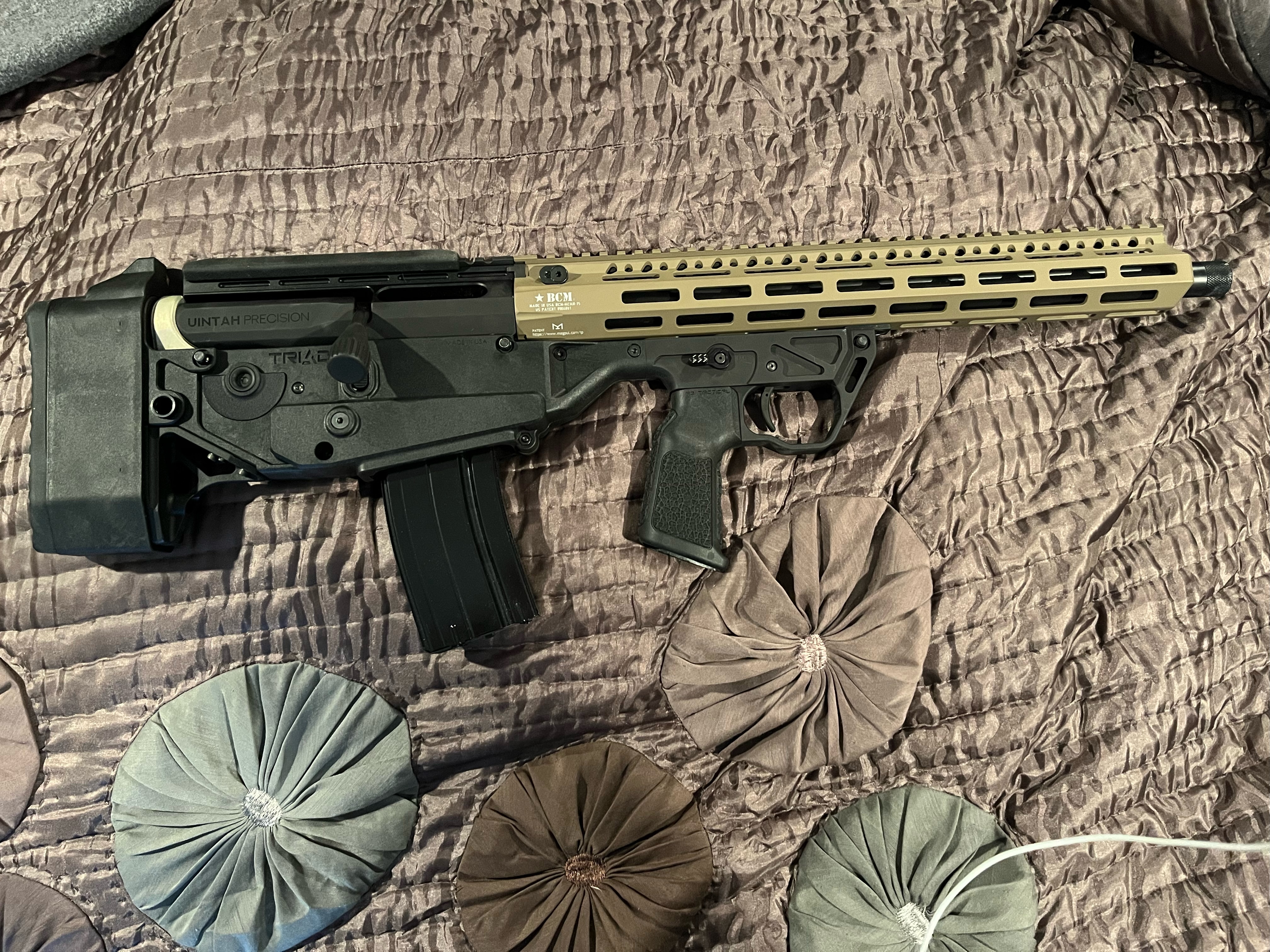

It is a mil spec ar-15 lower in a A3 Tactical Triad bullpup conversion kit with a Unitah Precision 16” barrel chambered in 6.5 Grendel. A BCM handguard. 26 and 3/8 inch overall length. 7 pounds 2 oz’s. It is using a modified pistol buffer tube, to allow the bolt to move completely, while still mechanically locking the extended stock spacer to the lower receiver.

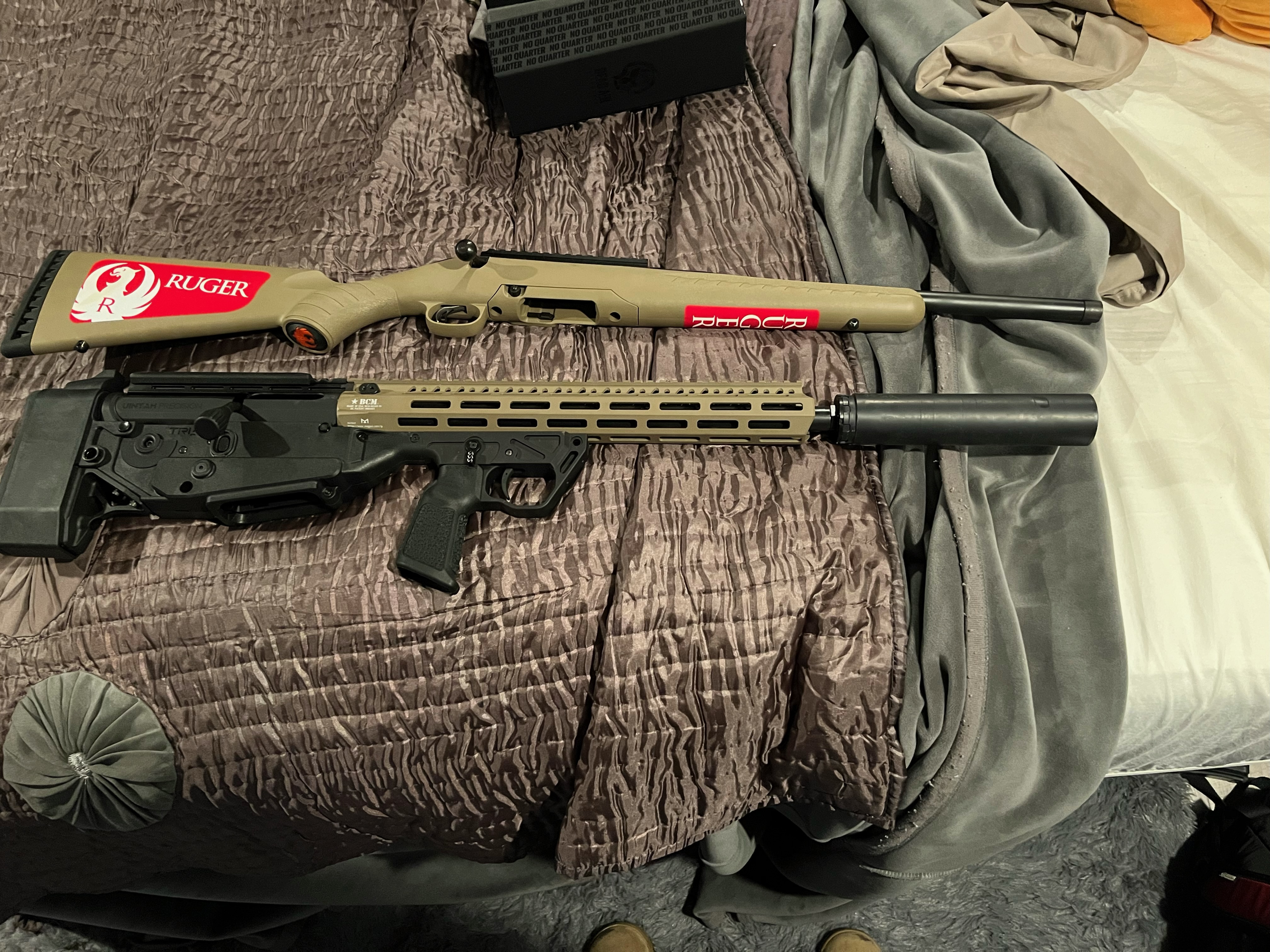

This is an interesting design that hasn't been explored much. My nephew is a fan of the bullpup design and wanted a bolt action bullpup that was shorter than a typical hunting rifle with a can on it. It was meant for 200-yard shots on deer and pig in the woods. It has a 16" bull barrel and though I would have preferred a light barrel, one was not available. Triad is interested in his design as there is only one design similar to this on the market, and it is $6000. This one cost him $2500. The barrel company guarantees sub moa.
Freezer wrote: Fri May 24, 2024 10:25 pm It is a mil spec ar-15 lower in a A3 Tactical Triad bullpup conversion kit with a Unitah Precision 16” barrel chambered in 6.5 Grendel. A BCM handguard. 26 and 3/8 inch overall length. 7 pounds 2 oz’s. It is using a modified pistol buffer tube, to allow the bolt to move completely, while still mechanically locking the extended stock spacer to the lower receiver.

That is exactly what it is designed for, thick woods and blinds. He is exceptionally concerned about his hearing and the can will handle that concern. Even with the can, it is shorter than a compact rifle. It's not my cup of tea, but I want to shoot it! I would like one with a 20 or 22" thin barrel and a little more speed. The bull barrel brings it to 7.3 lbs without a scope, with a scope and a can, it will be well over 8 lbs. A thinner barrel, no can, and 2x7 scope would make it less than seven lbs. A tactical chest hung sling and I might get to like this gun.
