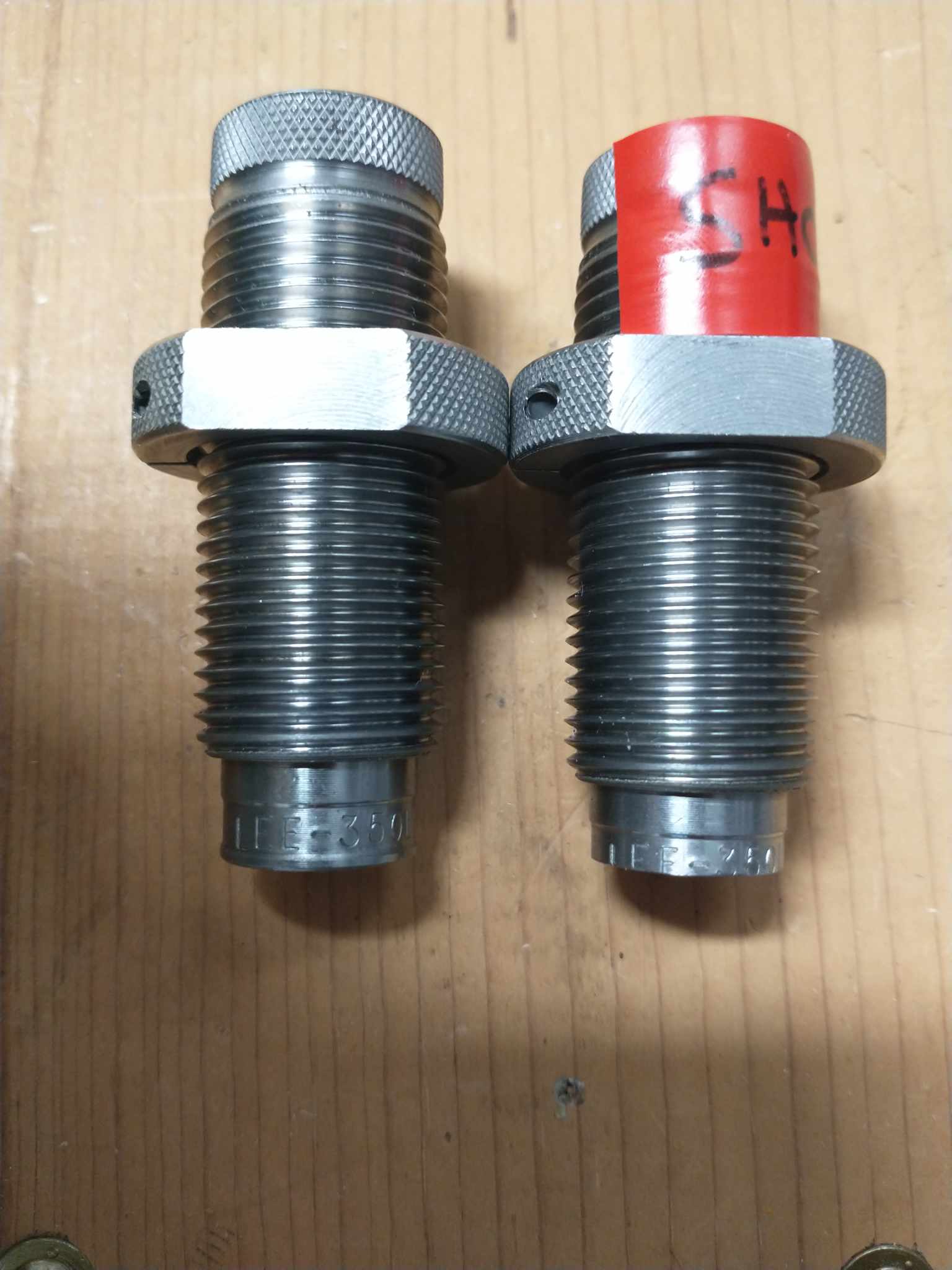

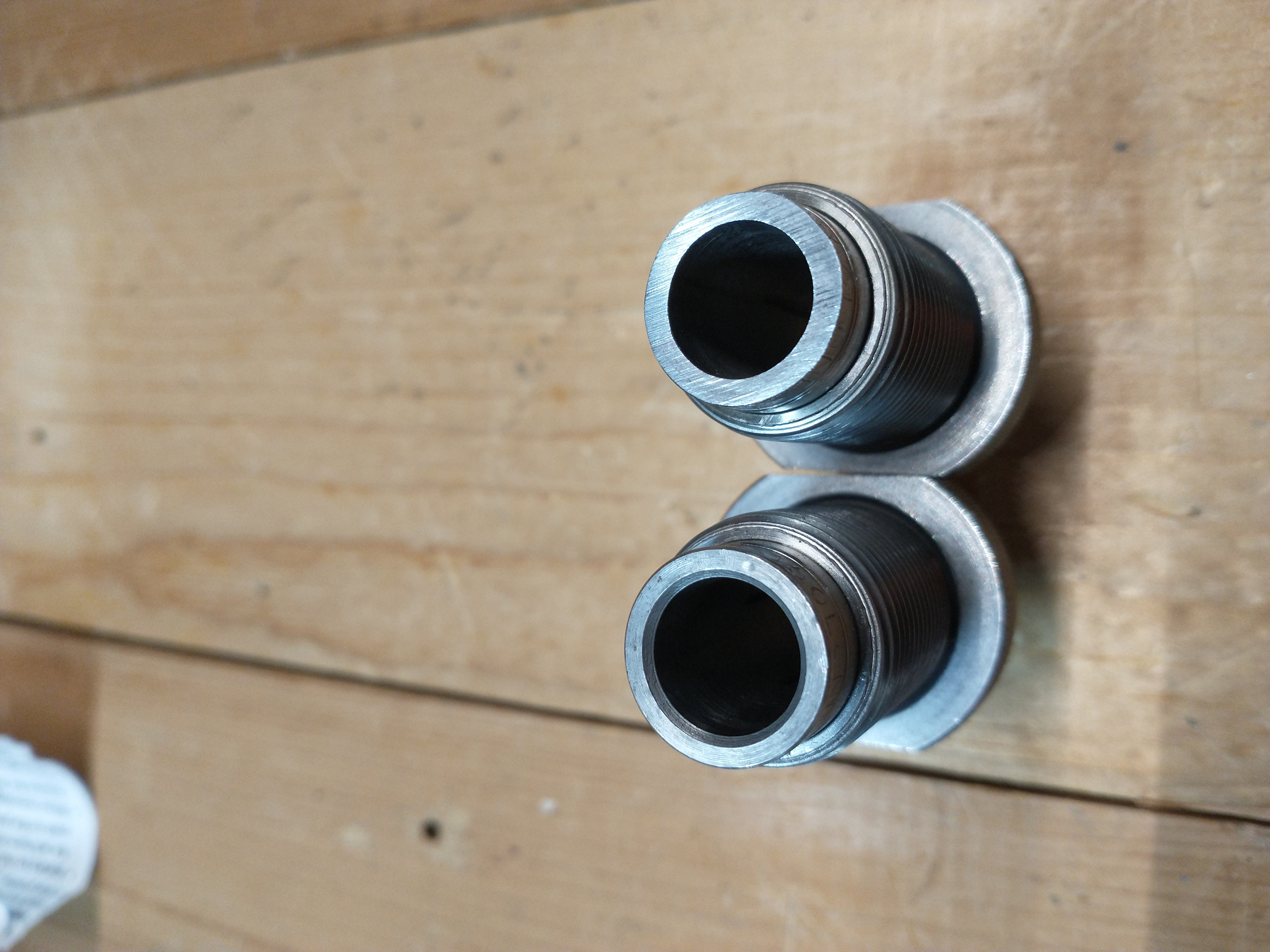

This is a quick comparison between a Hornady taper crimp, Lee FCD, and shortened Lee FCD. The shortened die is set to a very heavy crimp as an exaggeration of a heavy crimp. The pictures are not the best, but they should show enough. The dummy rounds do fit in my CVA break action. I have not tried them in my Ruger American, but I dont see why they wouldnt chamber just fine.
Factory and shortened Lee FCD dies.
L-R Hornady TC, Lee FCD, and heavy shortened Lee FCD

So from the responses it seems like the Lee Factory Crimp is not a bad idea, or at least it would not hurt anything, but the 45-70 die will require some modification to work correctly with the shorter 45-60 case. Now by the pictures I saw here it seems it does not need precision machining 🤣 to get there. They are cheap enough that I can experiment using tools I already have so there is that.

It was a quick and dirty modification for an experiment. Its amazing what a belt sander can do..... The picture makes it look rougher than it really is. Some day I will get a lathe.

mitdr774 wrote: ↑Mon Jan 22, 2024 9:01 pm It was a quick and dirty modification for an experiment. Its amazing what a belt sander can do..... The picture makes it look rougher than it really is. Some day I will get a lathe.
Looks don’t mean much in this endeavor 🤣

It's fairly even across the face of it, but fairly obvious that it wasn't done with a precision tool. It works, but it's not pretty. Lee obviously did a better job with their factory machining.

Did you shorten both the body and collet or just the collet?
Posts: 470
Re: Lee Factory Crap Die
On the .350l crimp I only shortened the collet. On the one I originally made for my little .458 I had to shorten the body and collet. That one is much cruder, but still worked just fine. I had Lee make me one when they made my die set. Now my die set for the .458 looks more professional. I Hornady seating die would be a nice addition down the road.
