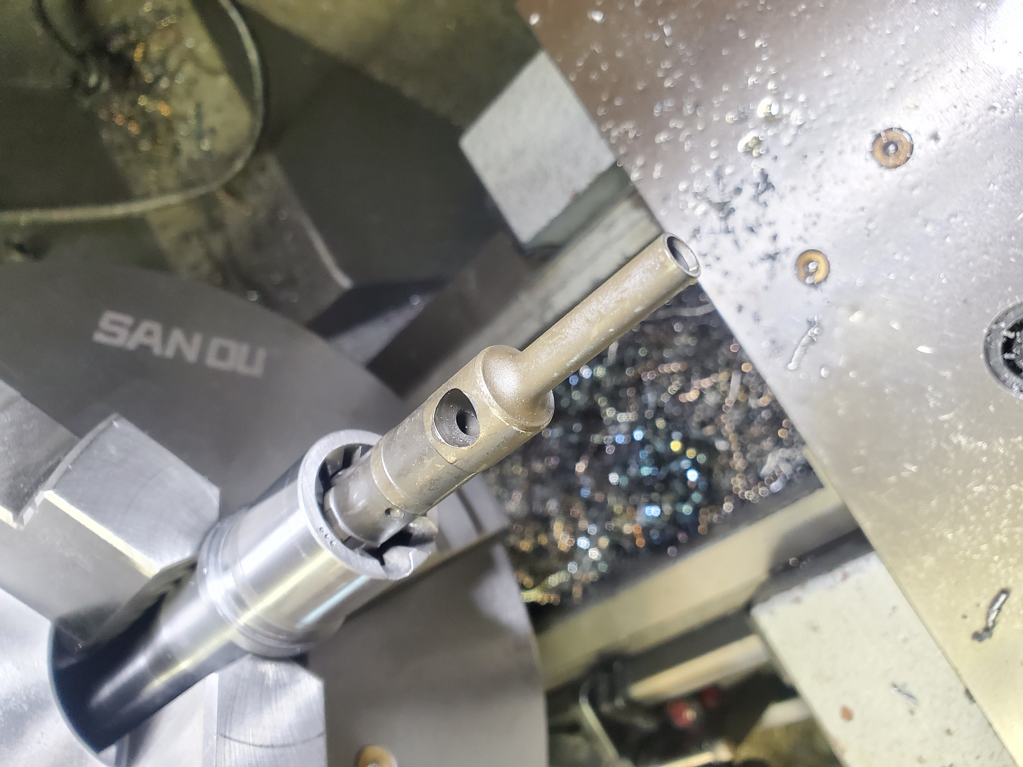

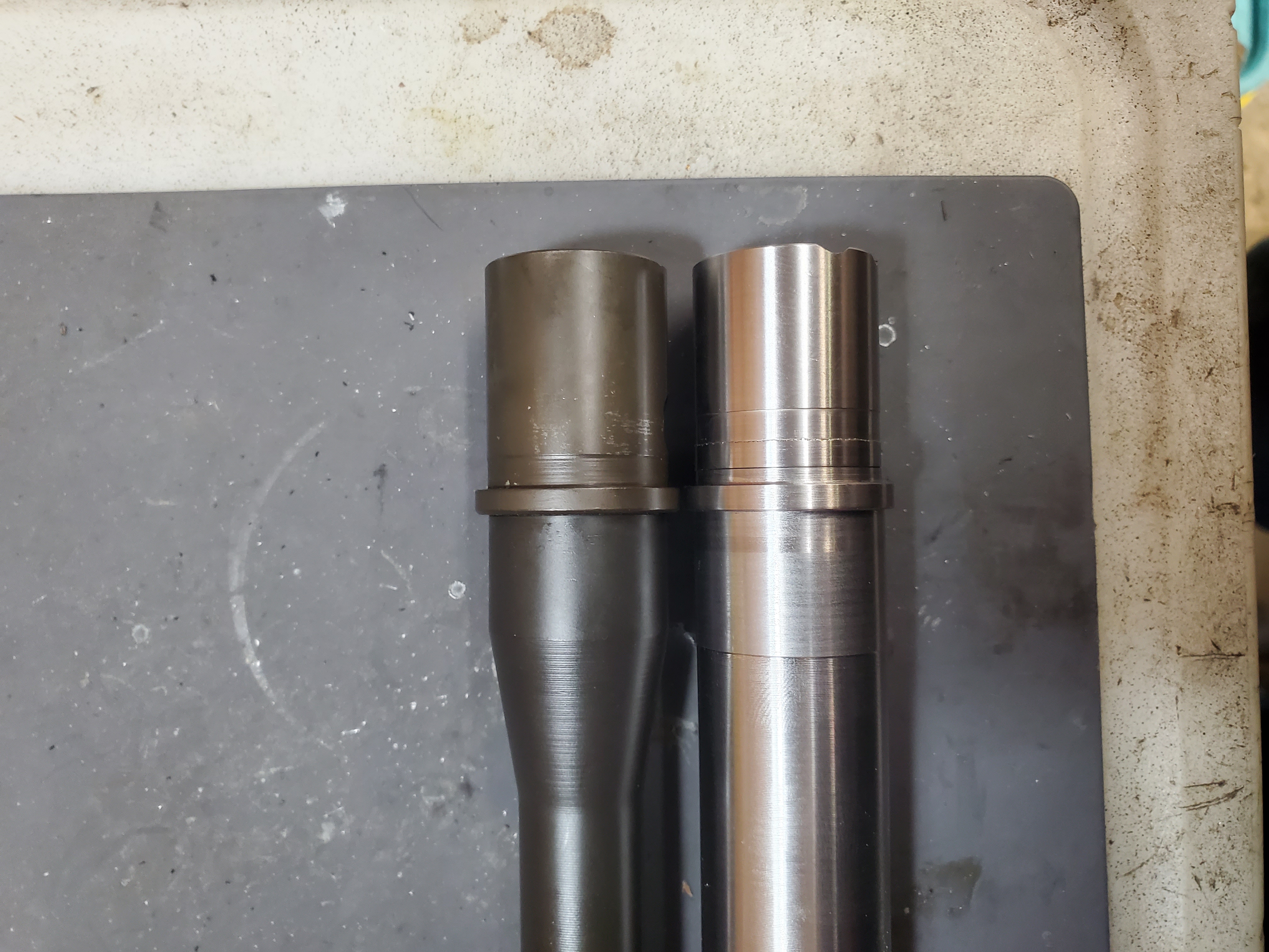

Amongst the billion other ideas and projects that float around in my life, I was made aware by a customer that the Daewoo K2 rifle he owns only has 1:14 twist barrels and that there's a cult following of people that would pay dearly for 1:7 or 1:8 twist barrels. So he let me borrow his upper, barrel and bolt. The barrel extension is almost the same as one for an ar15 but it's longer with the same locking lugs. So I ordered some GM blanks and some barrel extensions and took measurements from his barrel. I have about 30 people waiting on these things. I had to turn off the ar shoulder and make extended shim/shoulders but they mic out perfectly.

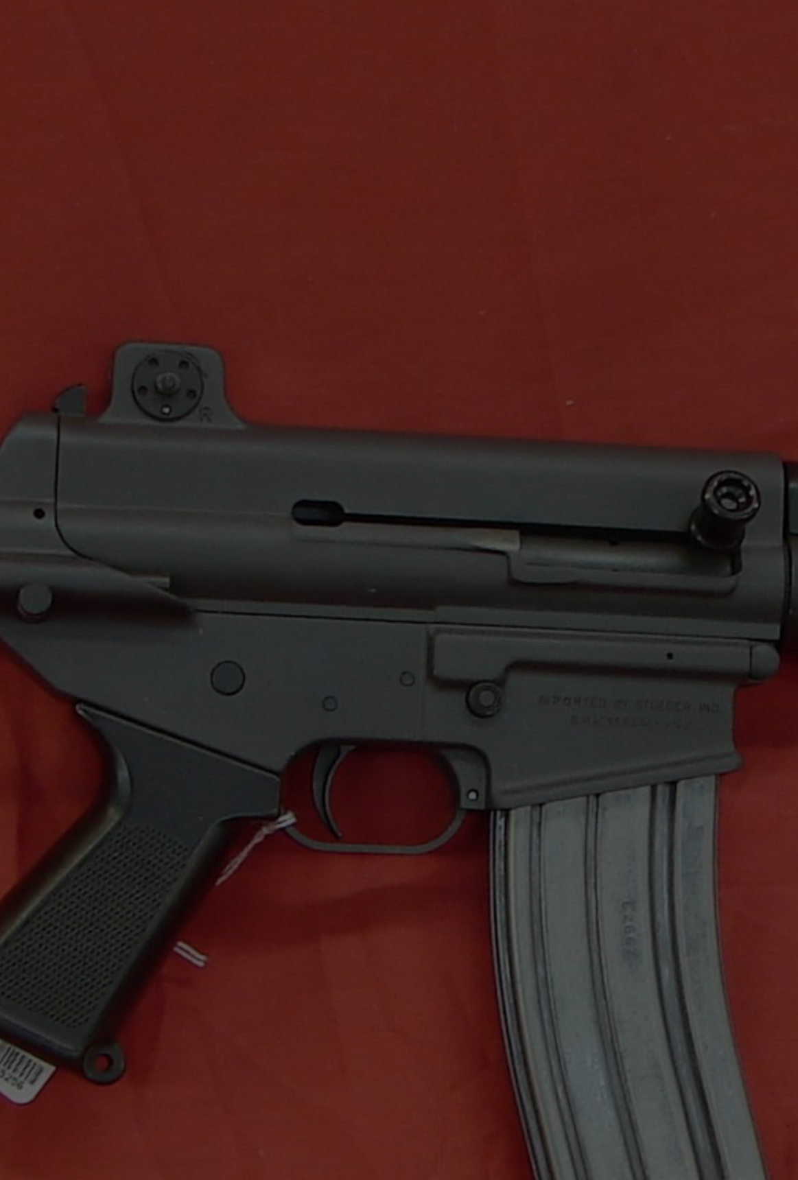

One of the biggest mistakes in my life was selling my Daewoo A1-K1. Those things have gotten stupid expensive over the years. Who knew…

I got the first three barrels done. These are going to the guy that let me borrow his barrel, bolt and upper to take specs from. Ordered 5 more blanks. I have about 21 of these pre ordered from people.

My K1-A1 only cost me $400. At the time it was a cheap alternative to an AR. I sold it years later for considerable more than that and it’s worth even more now. My biggest concern was that it was becoming a collectible with no supply line in case of parts failure. But it was a hoot to shoot and more accurate than any AR I bumped into back then. No optics capability (maybe another niche market for Justsomedude? 😁).
