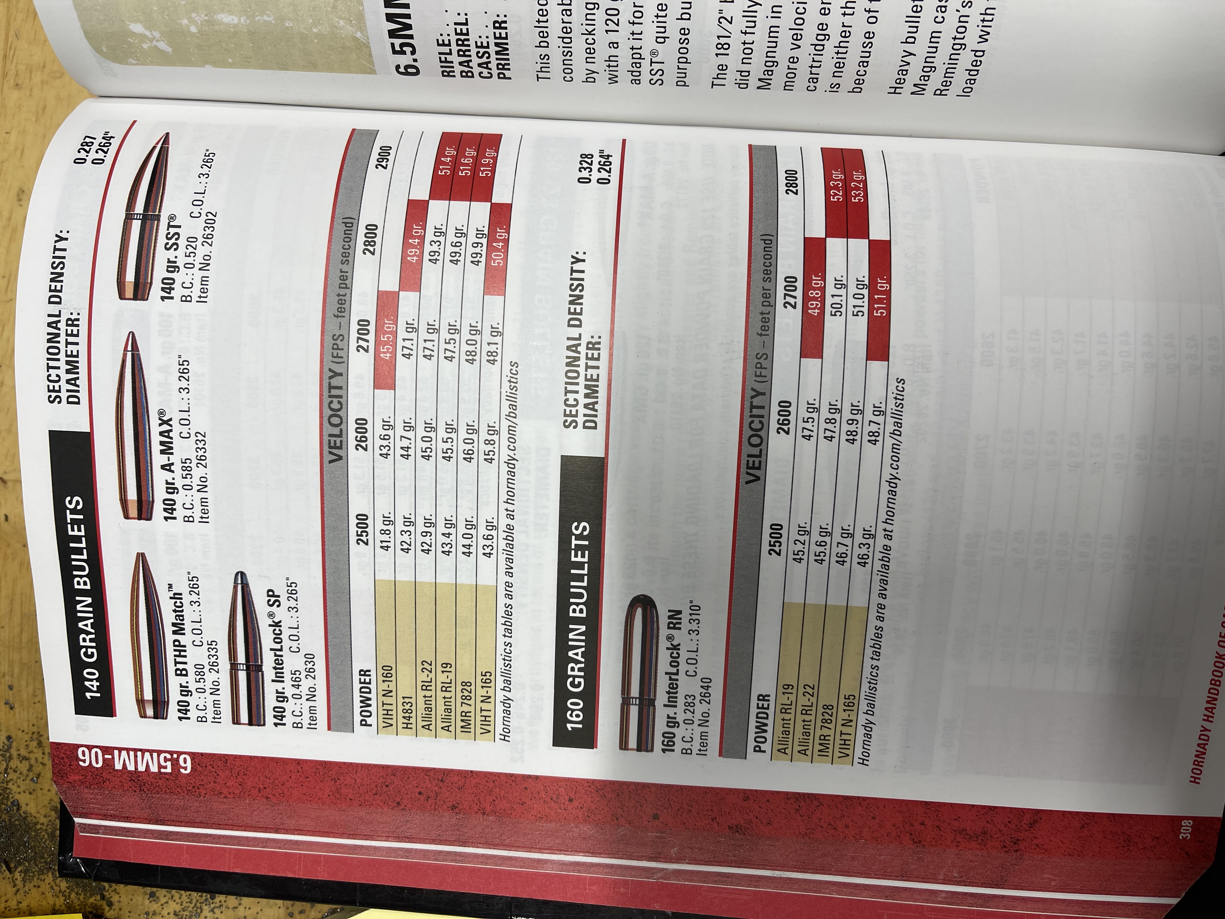

Posts: 1648
Re: 6.5-06 load data
Another look from Hornady.
Posts: 467
Based on multiple range trips with my R700 6.5-06 with a 26" barrel, the Nosler load data is optimistic on velocity. I am using Sig .270 brass converted to 6.5-06. I have used the 140-142 load data for both 142 and 150gr ABLR bullets. I find the 150gr is only slightly slower than the 142gr at the same charge weight. The best group size loads I have shot with the 150gr and IMR 4350 was 45.0-45.1gr. This should have resulted in a velocity of around 2790 fps. Actual velocity is more like 2650 fps. I found my max load with the 150gr ABLR and IMR 4350 to be around 3gr over max and it resulted in an average velocity over about 20 rounds of 2895 fps with a fairly low ES for hunting ammunition loaded on non fancy equipment. This same powder charge results in the 142gr ABLR running about 30 fps faster.
I am probably going to run the 142gr ABLR over a charge of RL-26 that averages 3050 fps for my upcoming pronghorn trip.
I have found that with my rifle and brass, just about every book load I have tried from Nosler or Hornady has been optimistic compared to recorded velocity. Some more so than others. I have been using QuickLoad and it has been more accurate with velocity predictions, but it has been off a bit on some of the pressure predictions.
