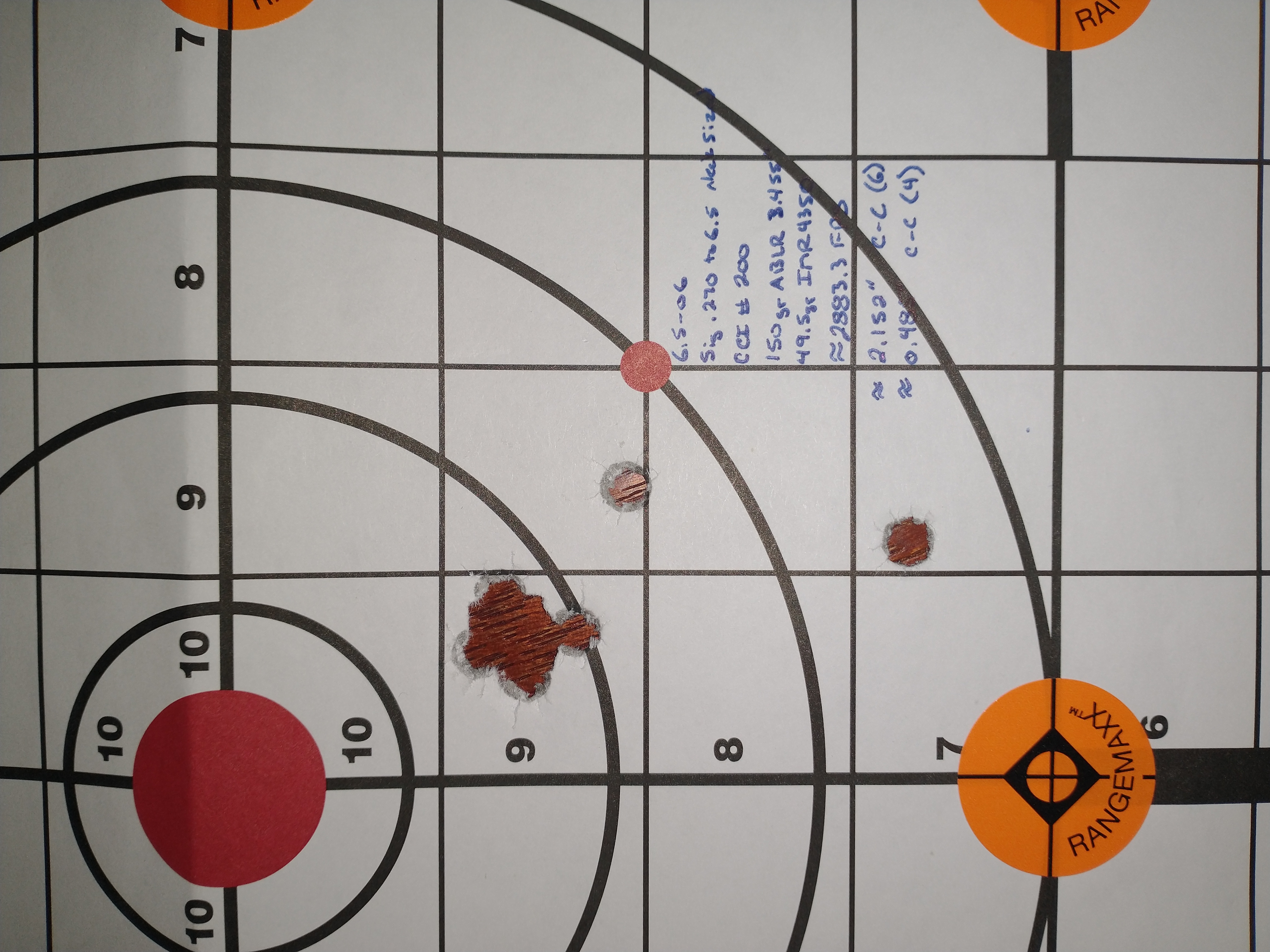

I have found this to be an issue across several cartridges and multiple bullet weights in each case. Maybe it's just my luck, but it seems as if driving the Nosler ABLR at what I would feel to be acceptable velocities for a given cartridge they tend to have random flyers. Slow things down a bunch and the flyers go away. That being said, pushing 6.5CM velocity in a 6.5-06 seems rather pointless to me. If I drop the velocity to about 2500 fps it produces fantastic groups all day long, but why use the -06 case when I can get the same velocity in a more efficient case size?

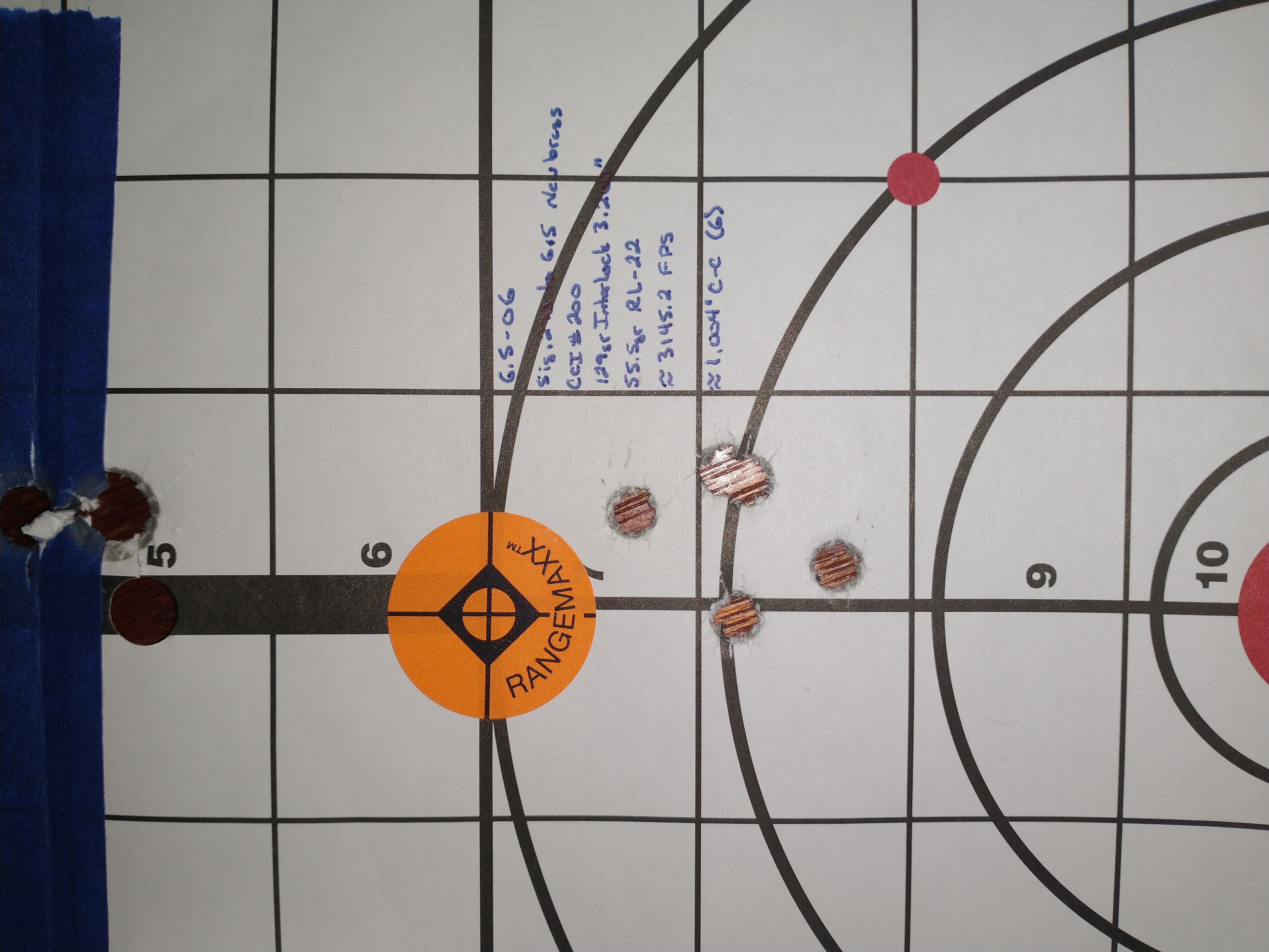

I had forgotten why I stopped shooting the ABLR in my 6.5-06 until yesterday when I took my wife's step brother to the range for load work up on his M70 6.5CM. I took my .430x1.8, .458x1.8, and 6.5-06. If I exclude the two flyers it's an amazing group for me. Below is two pictures showing a comparison of my "bitch" about the ABLR and why I ended up using the 129gr InterLock on my pronghorn hunt last year. Both groups were done as two sets of three. The 150gr group produced one flyer in each of the sets. It's not a consistent point in the set either. The 129gr IL load usually does a little better than that, so my shooting may have been off some, but not that far off.
Has anyone else experienced this?
I am slowly working on switching hunting loads over to lead free to at least prepare for the day it happens. I wonder how the 150gr ABLR would do in a 6.5 Grendel??? The 142gr produces some very nice groups at about 2000 fps from my CZ 6.5g from what I recall.

Looks like the potential is there, but probably for one critical little thing.
How consistent are the velocities on the loads? When I do a load workup, I'm looking for the spots where the velocity doesn't really change significantly across three or more charge increases of 0.2 to 0.3 grains, and then I concentrate my efforts around those flat spots. It's usually worked very well.
You might also have a seating depth preference issue. The Barnes TTSX's I've been hunting with LIKE a long jump to the lands. I am not familiar with these ABLR's, but you might check Nosler's recipe for COAL for guidance.

I would have to check my numbers again, but from what I recall velocities were been fairly consistent. Nothing jumped out velocity wise at the range.
The ABLR has proven to be somewhat of an oddball for jump. Some cartridge/ABLR bullet combinations like more jump than others. If i recall correctly I have as little jump as I can manage while still having smooth feeding. Nolser recommends something like sticking to max cartridge length spec. Nosler has no data for this bullet and cartridge combination.
The lead free bullets do seem to generally like a long jump.
I know that bonded bullets have a potential for some issues due to the bonding process. The only other bonded rifle bullet lines I have played with would be the 85gr InterBond in a .243, and the 120gr and 140gr Gold-Dot in multiple 6.5 cartridges. I have played with the ABLR in several 6.5mm and .30 cal cartridges and experience the same results with the ABLR every time. The ABLR is the only one that consistently has this issue where lower velocities produce fantastic groups and higher velocities start producing odd random flyers.
I like the promise of the ABLR, but I dont like the performance on paper at higher velocities.
