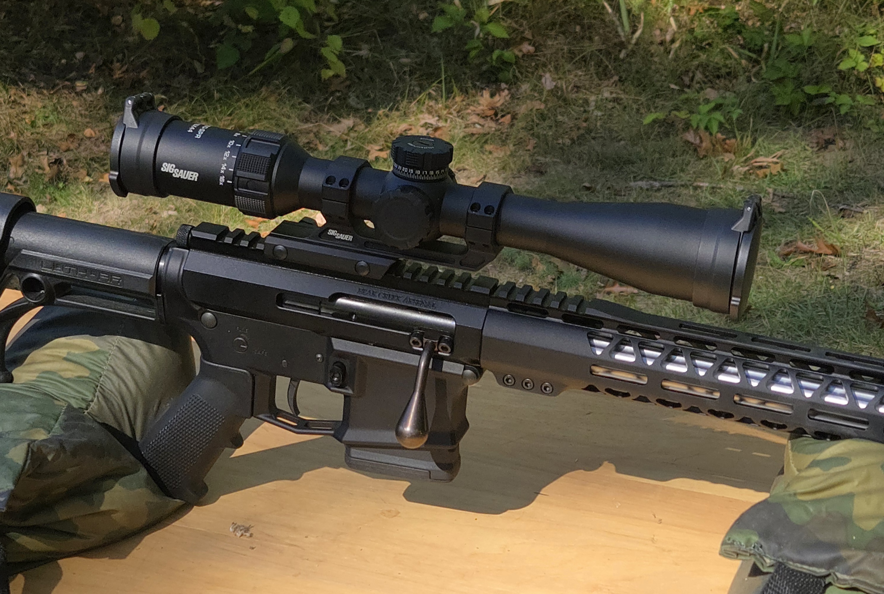

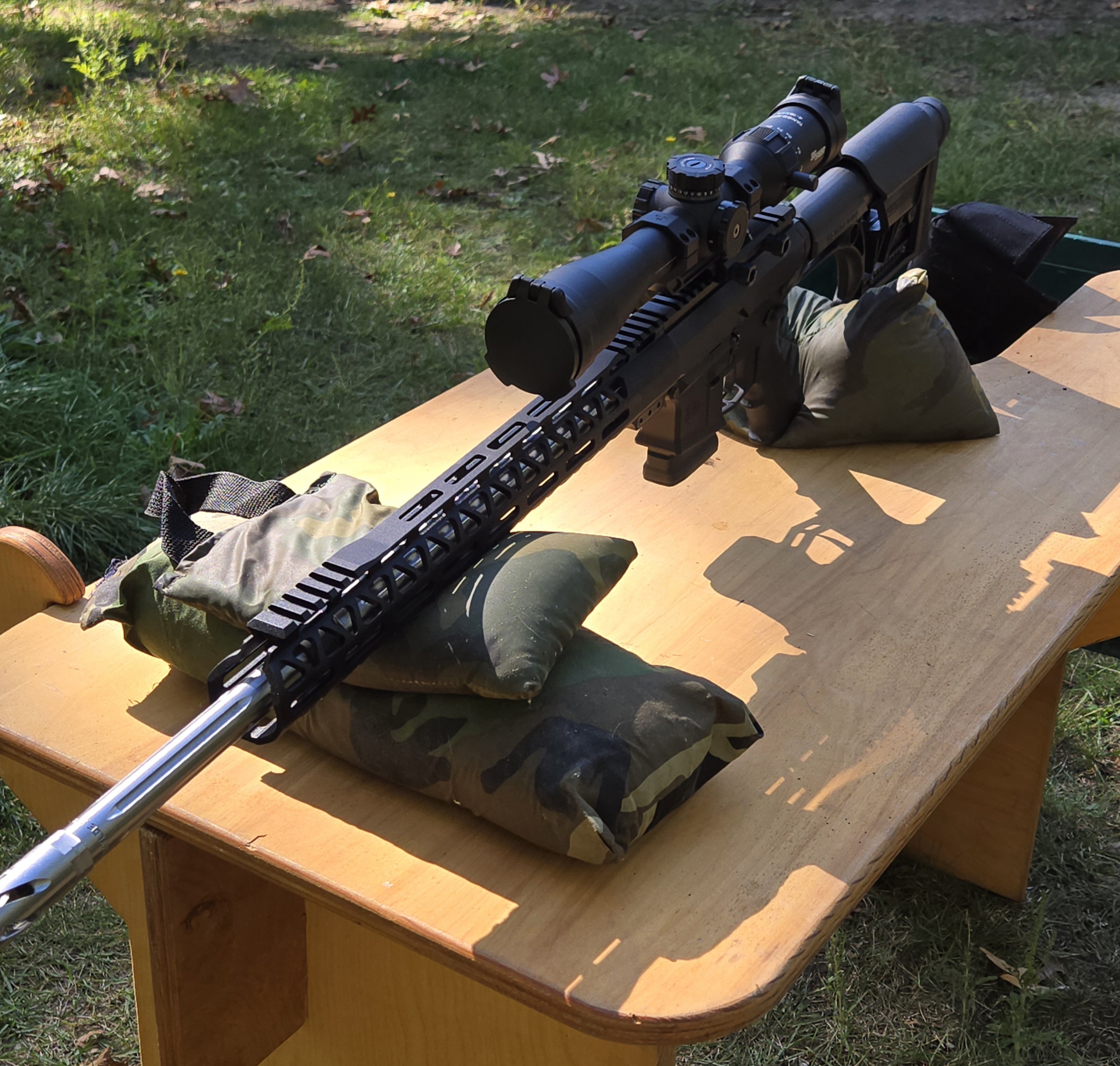

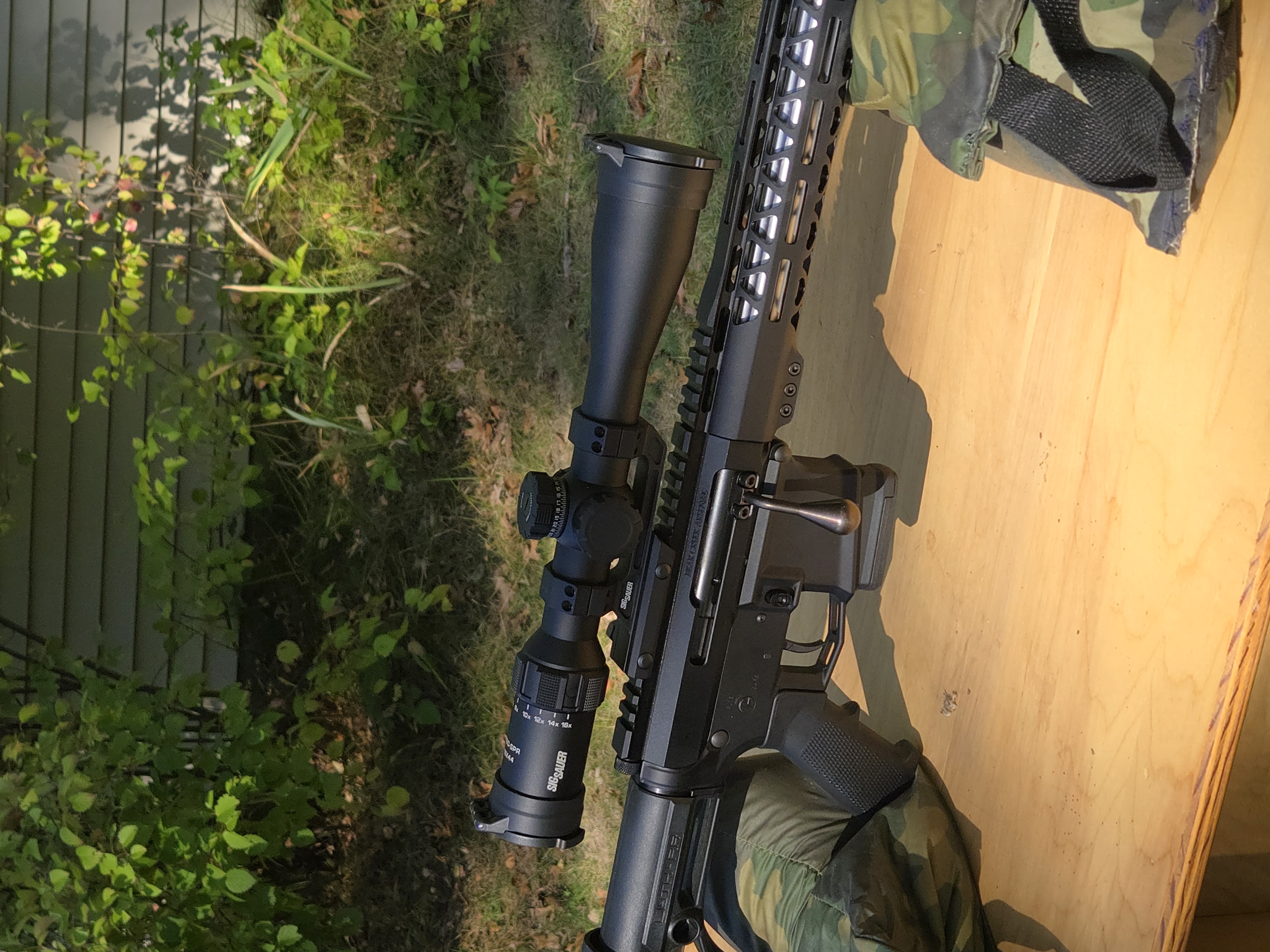

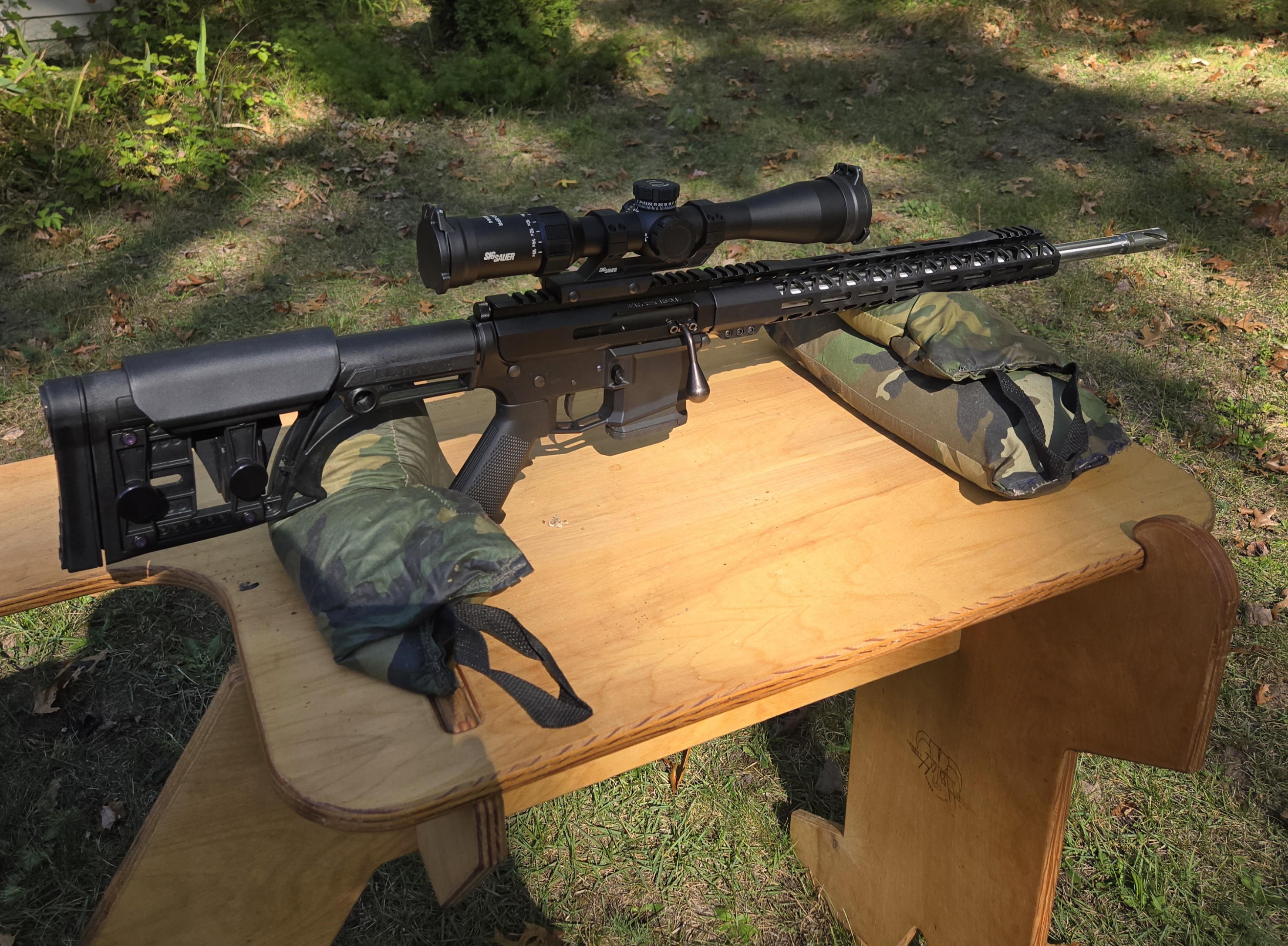

Here's what I came up with for that bolt action AR upper
.223 Wylde
20" 1/8 Twist, Fluted medium taper...10 lbs...SIG SPR 4-16x44 mm with 30mm tube...Rise Armament 3.5 lb trigger...Luth PR stock

I have debated a bolt action upper for a while. Bolt handle being so far forward would be odd though.

Sorry...got carried away and forgot the important stuff .223 Wylde

I was thinking about the same thing but when I got it Shouldered the bolt handle was right where it was supposed to be...

1:8, should run 75 Hornadys, 77 (Sierra/Nosler) 80.5 Bergers, 80 Sierras, 80.5 Bergers.... might not run 90s, but in my experience the 62s will shoot well at least at short range

Sweet looking rig!

Based on what I can find online, 1:8 may or may not be good with something like the 90gr SMK. The Hornady 70gr CX calls for a minimum of 1:7 though. Then again the CX line tends to be some fairly long for caliber/weight bullets.

It's like a Mosin-Nagant sniper rifle on which they fixed the stock's comb height. . .and left everything else alone. :mrgreen:
