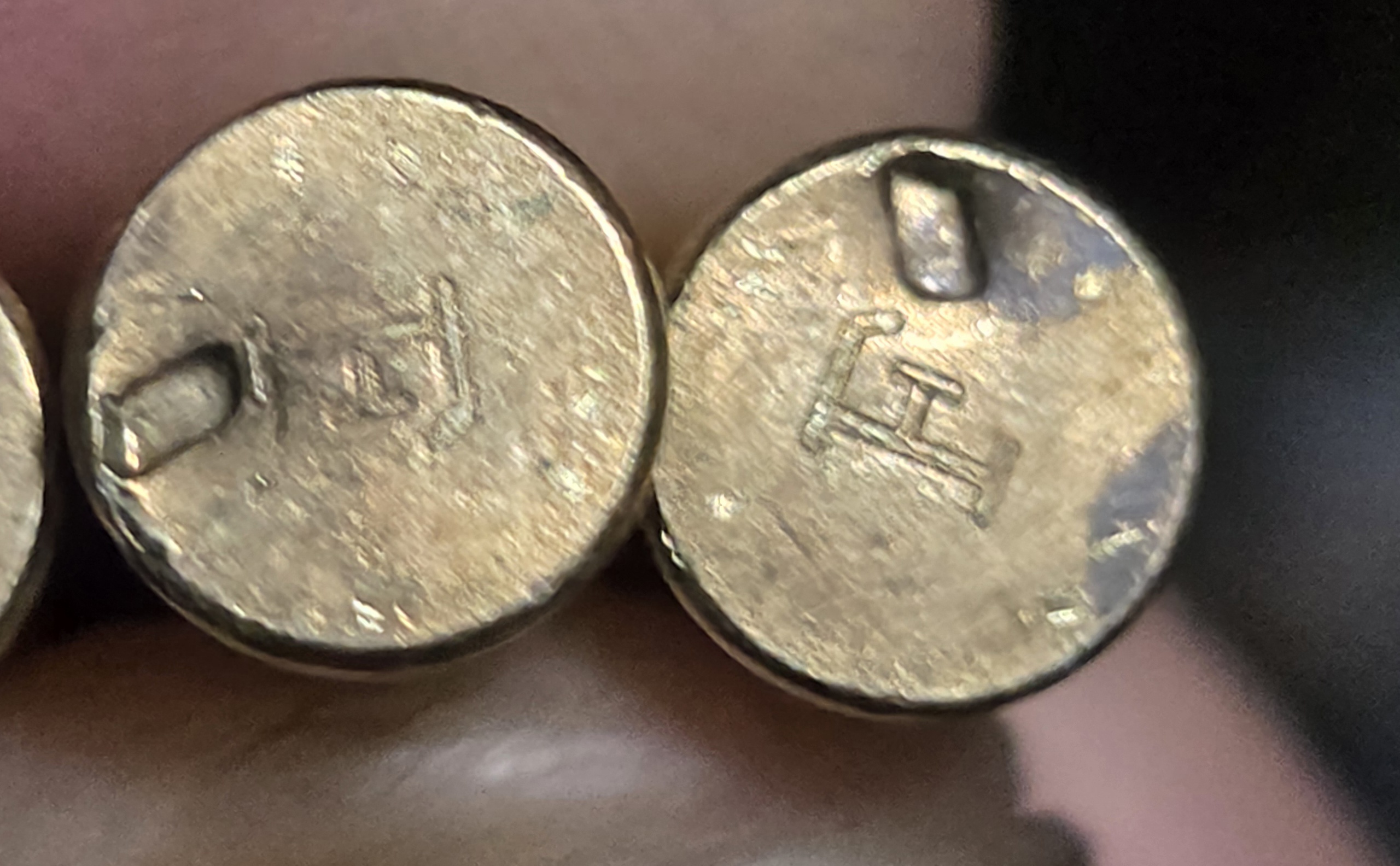

It's on the check list.
I also see where the strike hit and seems deflected..
Had I grabbed an empty after fixing the chamber it may look totally different......may also look the same.

Thoughts ?
Looks fine to me.
Definitely different than before.
Posts: 2341
Re: Help diagnosing the lever 22 problem
Still a strange, irregular, angle along the rim

GrapeApe wrote: ↑Mon Mar 16, 2026 2:49 pm Still a strange, irregular, angle along the rim
I won't argue that
But with strikes like that on a rimfire I don't see a need to replace it

JunkCollector wrote: ↑Mon Mar 16, 2026 3:54 pm
I won't argue that
I concur on it not needing replacement
I won't argue that
I agree 100%! As long as the pin is retracting into the bolt body and not binding on the hole on the breech and sticking out (which is needless to say dangerous) I wouldn't screw around with it. And in any case if there is any deformation one quick light tap with a hammer on a flat surface or a swift pass with a fine file should take care of it. They are not all that thick or tough
Should cover the edge of the rim
its not a square outside edge
I havent found a spent 22 case to photo
if its working its good enough
Dont file it that may end up producing light strikes
Posts: 987
I do think it varies but going from memory most hit just inside of the edge
