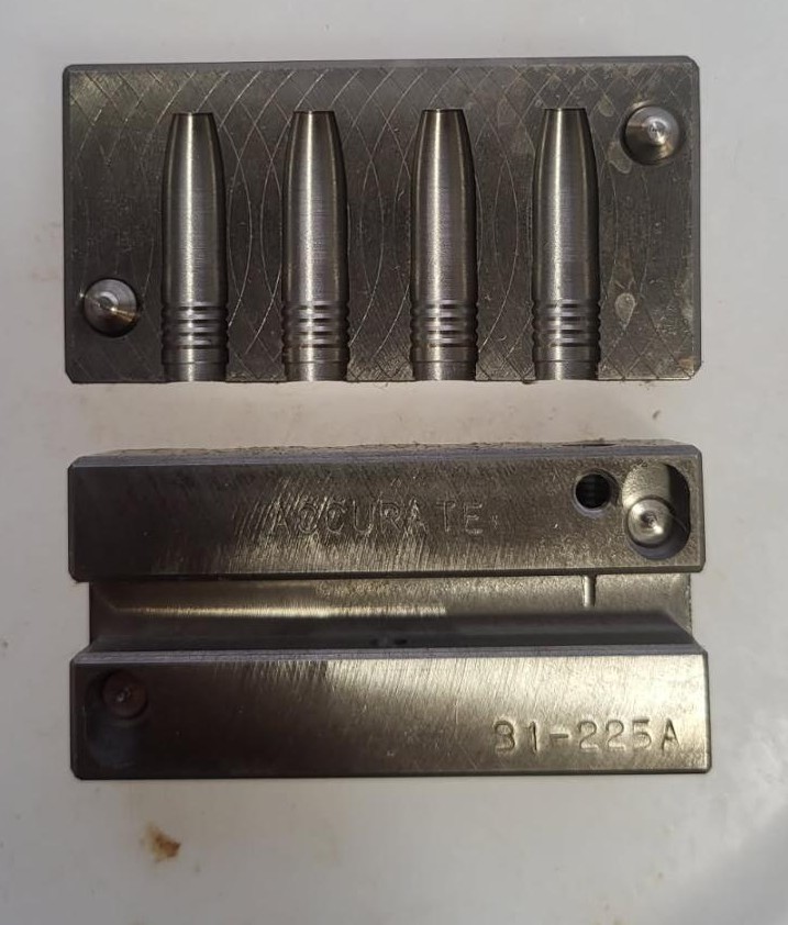

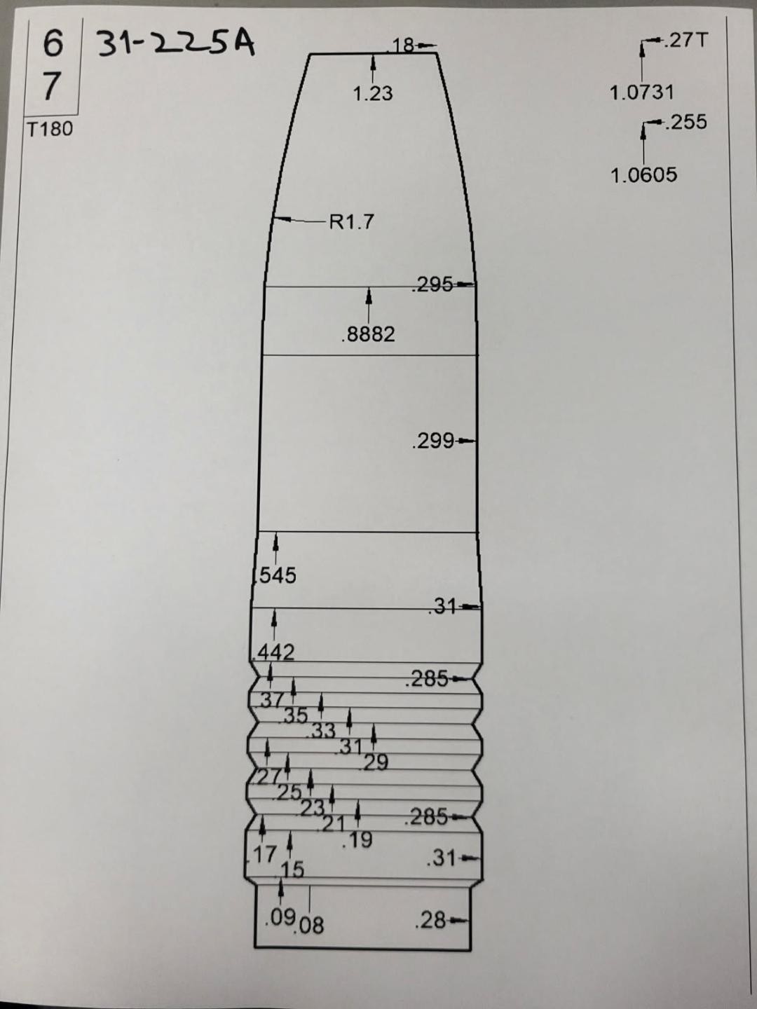

THE SECOND SOLUTION: So I got in touch with Accurate Molds and did some back and forth to custom-design THIS:
What we've got here gives me very nearly the .30-06's max overall cartridge length of 3.340" when seated with the gas check at the back of the case neck. The front-rear length of the gas check cup and the taper at the front of the .310" driving shank and .299" nose (A.K.A. "the bore-ride section") give me a little play, but it took some serious farting around with other bullets across multiple rifles to figure out where all those diameters and lengths wanted to be.
So, I was pretty darn giddy when this showed up:
I've come to like iron molds. Heavier than aluminum; not as heavy as brass; yeah you have to oil it to prevent rusting in storage, but the output is nice. . .so very nice!. . .Hmmm. . .possibly out of room for pics on one post. Let's try a second. . .

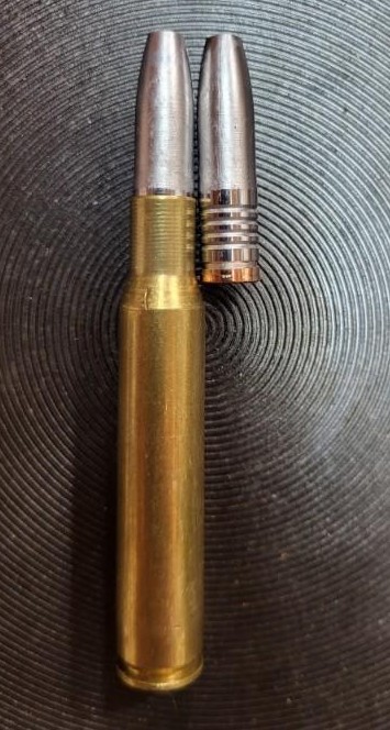

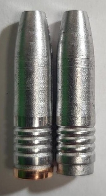

As I was saying. . .output:
Straight out of the mold and with a gas check crimped on and base sized to .310", ready to be tumble lubed. Sample round loaded to just shy of max .30-06 COAL.
Plan is to try IMR 3031 for the initial load workup as I have it on hand not doing much else, and it's got a widespread following as a cast bullet propellant across many different cartridges. If that's a dud, we'll try others. Outcome to follow.

Magazine. There was a fair bit of work done to ensure it. I've got a 200 grain mold with an almost identical nose that I made test rounds with. I seated them WAY out long; the driving band that far forward wouldn't allow the bolts to lock up, but it did allow me to test feeding of the nose profile with max allowable COAL / magazine fit.
My pre-'64 M70 had some issues feeding from the left side of the magazine (flat nose ran into the right side rear of the chamber entrance). . .until I swapped in the follower from my Hawkeye. Another Hawkeye follower is on order from Ruger. . .

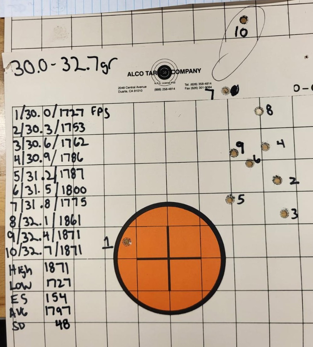

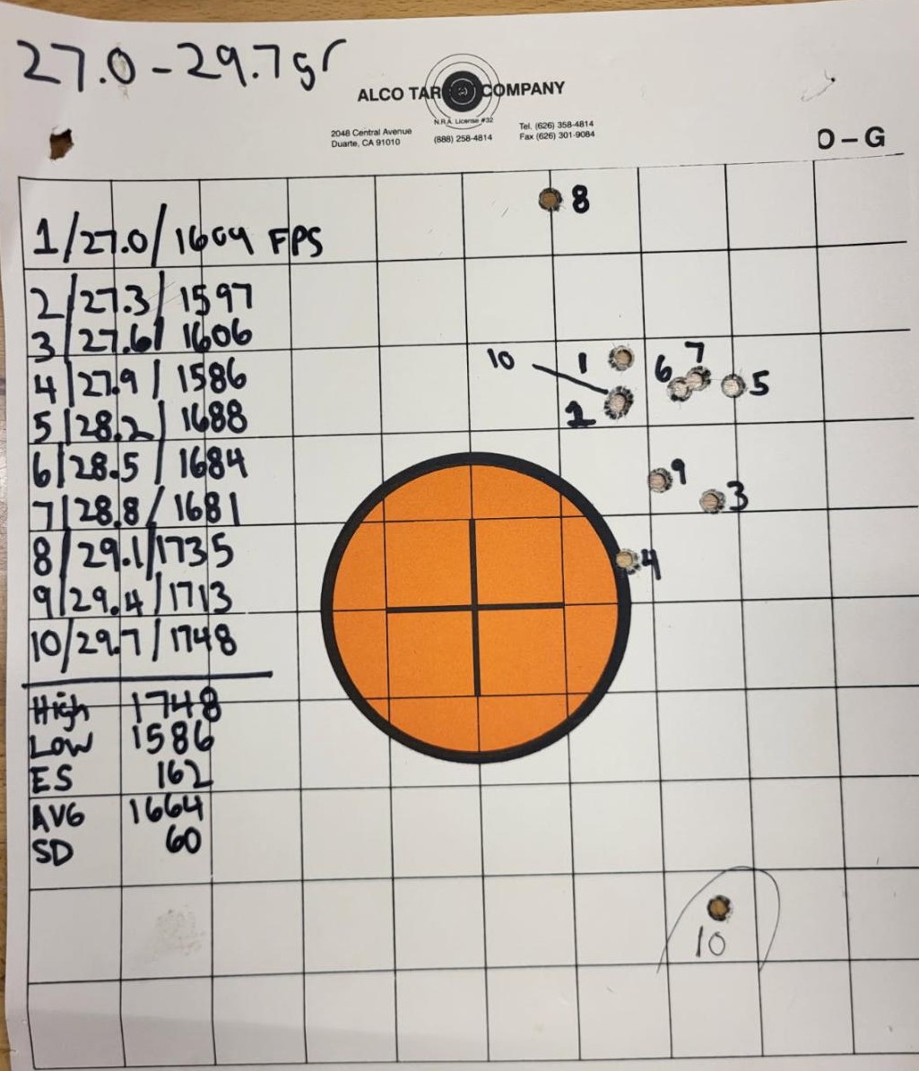

Nothing miraculous to report. At least not yet.
I fired the 50 round ladder test covering the min/max range for this powder and bullet weight. The good news is that 3031 seems to be a good powder for giving a pretty smooth velocity progression. The bad news is it never gave me the usual progression of sticking 2-6 rounds really close together, then settling onto a new point of impact as the charges increased.
These two were the low end:
The next two targets got muddied when the POI shifted markedly high on target #4 so they were impacting on #3. Potentially useful info on them, but pointless to post without a lot of explanation.
But I got five potentially useful flat spots in the velocity curve to test out to see if this powder/lube/rifle combo is going to work.

Mid 28 looks pretty good

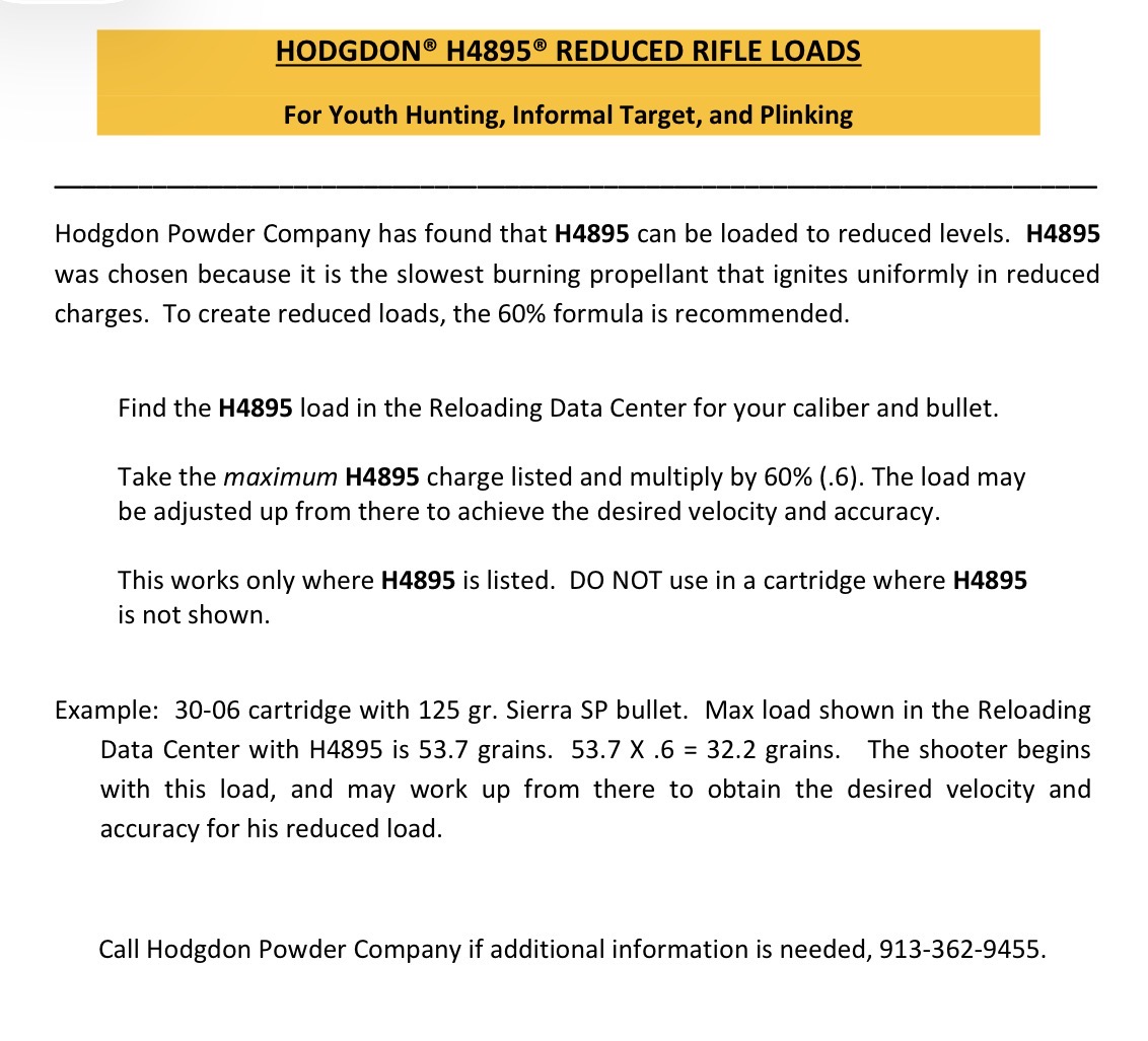

That looks like ton's of fun! Those would be fun in Tom’s and my 1885 30-30’s! I wonder if H4895 would be a good powder. You can use it for reduced loads all the way trough full house you load 60% of a FULL load to start and go up. You can find the notice on hodgdon’s site.

4895 is a possible. . .
