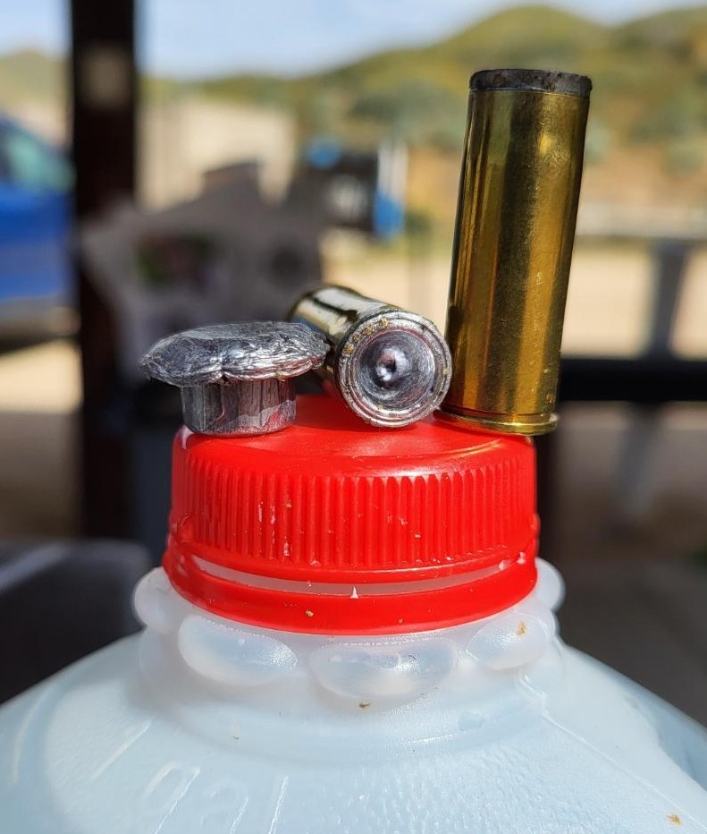

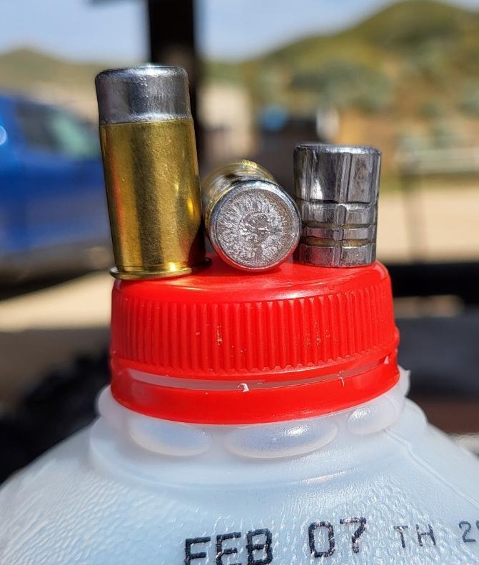

My three favorites from the project:
This was the NOE Molds authentically-copied 200 grain MKI bullet for the 1930's - WW2 era Webley MKIV .38S&W. Bullet is lying on top of a sheet of soda can aluminum that I placed between the gallon jugs to better register the tumbling effect. Jury is still out on to what degree they'll swap ends in calibrated gel, but our best data indicates that it's exceeding the top end of the FBI penetration threshold, which is fine for a military round. Lobbed out around 590 fps.
This is an MP Molds clone of the 220 grain .455 MKIV hollow-based wadcutter that had a really brief service life between the Hague Convention rejection of the MKIII (more on this in a moment) and the re-adoption of the conical/round nose MKII. 725 fps and 17-18" of gel-equivalent penetration.
The 218 grain MKIII "Manstopper" was a weird bullet with a hollowed-out wadcutter nose AND a hollow base. You can only make that by swaging the bullet with equipment I don't have, but I cast the MKIV bullet above out of a softer alloy and loaded it backwards to get the hollow point for this test. Basically same speed as the MKIV. Opened to about .75" and only gave 9" of gel equivalent penetration. Crappy by modern standards, but exactly what Phillip Webley was after in his 1899 patent. Wasn't around long before it got Hagued out of service. Probably would have been great on frontal shots against skinny aboriginals, but would unquestionably fail the Miami test. Shot it out of a .45C Redhawk where the hollow base wasn't needed for proper gun fit as it is in my Webley MKVI.
It's all been a real eye opener that you don't need "Thunder of the Gods" to get the job done.
