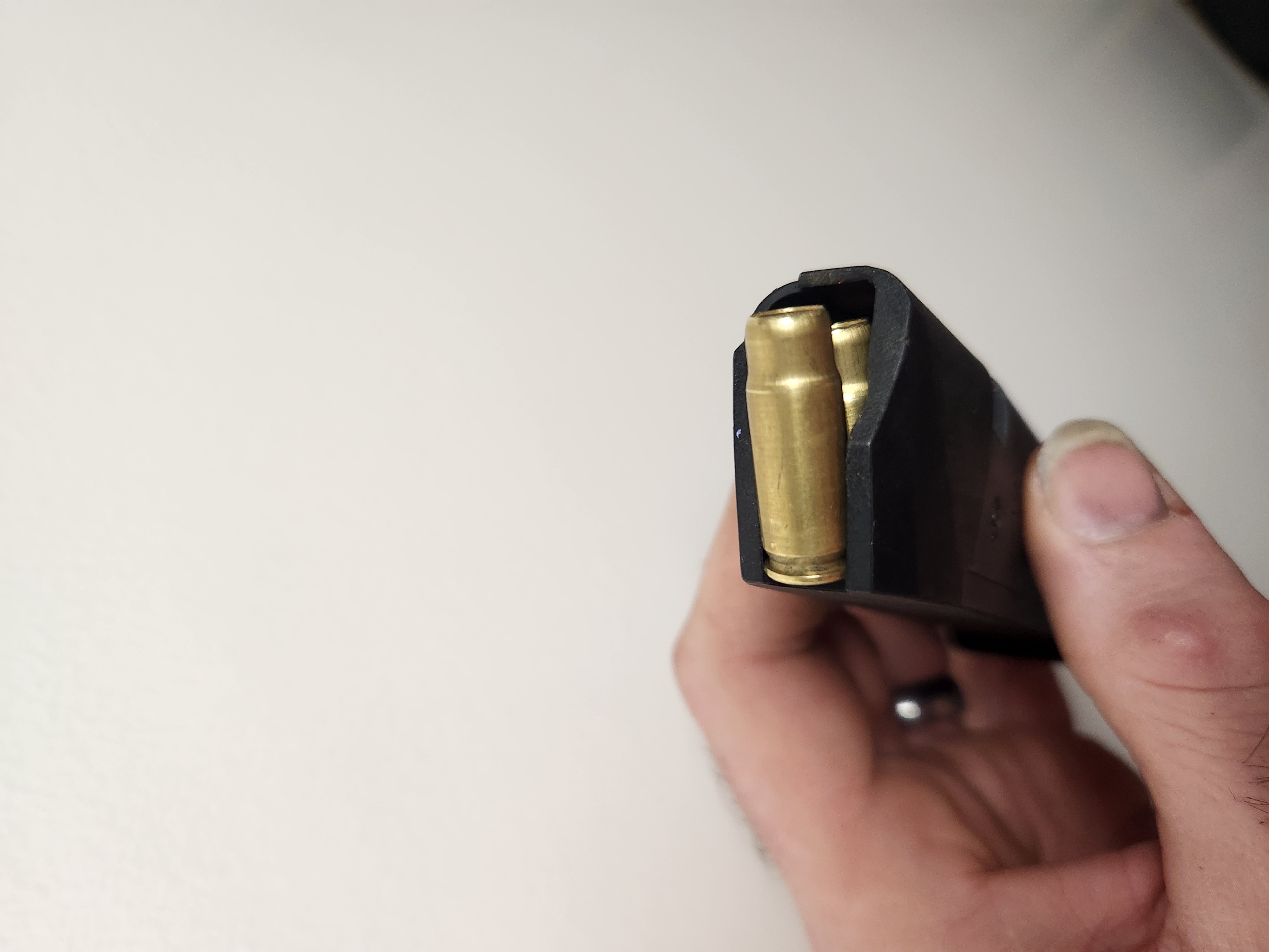

This should be fun. It's based off an article in a reloading magazine. 9mm shotshells that actually cycle semi autos, made from 223 brass.

Well, they didn't cycle my glock but I didn't do as heavy of a crimp as the guy in the video did so after 2 failing to cycle, I figure I'll go home tonight and crimp them as much as he did. 2.4 grains of tite group still seems like a small charge for what is essentially a 100 grain projectile, but what do I know.
Oh, and I learned that it would be much easier to prime and charge the cases, place first wad and then form the neck because it's hard to not distort the .355 cardboard wad past the .32 caliber opening.

I can make a simple die that does that necking. I'm actually using the one that I made for my 32naa to do the necking on these and it works perfect.
